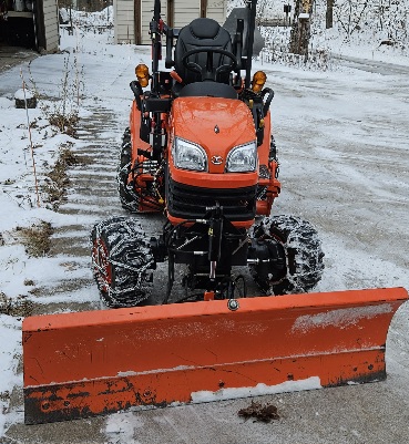

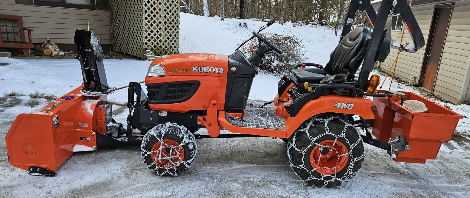

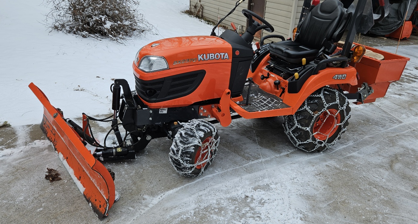

I may have a plow for my B2601. I'd like to hear from B2601 owners who have the K-connect setup on their experiences with it.
Does anyone who owns/operates a BX2830 snowblower have installed any type of electrical deflector kit?
I've a BX and the Kubota quick connect system (thanks to @Speed25, great guy). From experience, buy the whole front-connect setup at once so you know it all works together. Give the dealer your model and serial number; if you do and something doesn't work Kubota will make it right, down the road it's on you and can be a bit of a costly learning experience.
Several things need to work together:
  1. quick hitch sub-frame with hydraulic lift: pins to the tractor front and has a supported bearing which effectively creates a front-PTO.
  2. driveshaft: connects the mid-PTO to the rear of the sub-frame bearing.
  3. male quick hitch: the tongue that slides into implements like a plow or snow blower.
The snow blower comes with a mini-PTO shaft that plugs into the front of the sub-frame bearing, which again is effectively a front-PTO, and it works great! If you put it together in the right order everything is fairly fast and easy to hook up and get running (at least for me).
I looked into the cost of electric shoot controls...members suggest using the left-right motion of the FEL controls to run a hydraulic motor because it lasts longer and is more affordable (and they're correct, of course), so I'm doing that. I have a 3rd function control on the FEL and will add hydraulic chute tilt. (the forum members are really smart, not to mention helpful)
(thanks again to @Speed25 for the implements!)

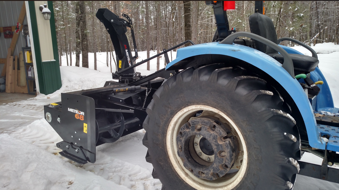

I sold my rear neck breaker snowblower last year. I don't miss it.
I was out this afternoon and a couple towns away i saw a Land Pride smaller rear mount snowblower for sale.
If I lived in Erie I'd have a front and rear blower.
