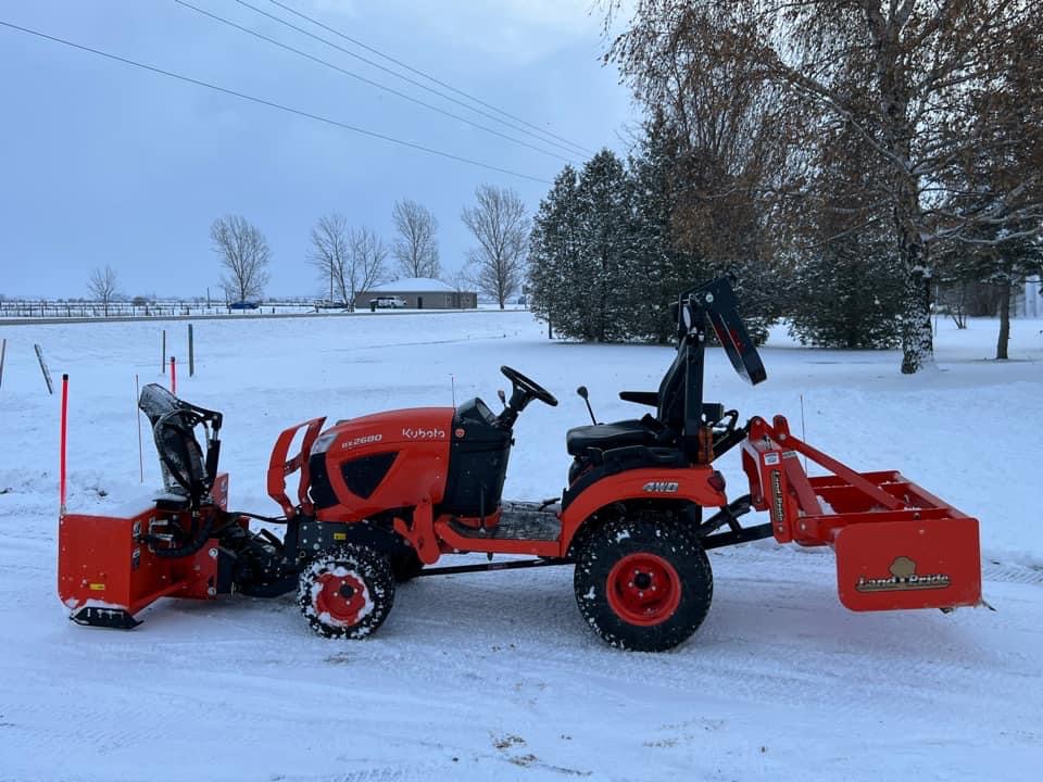

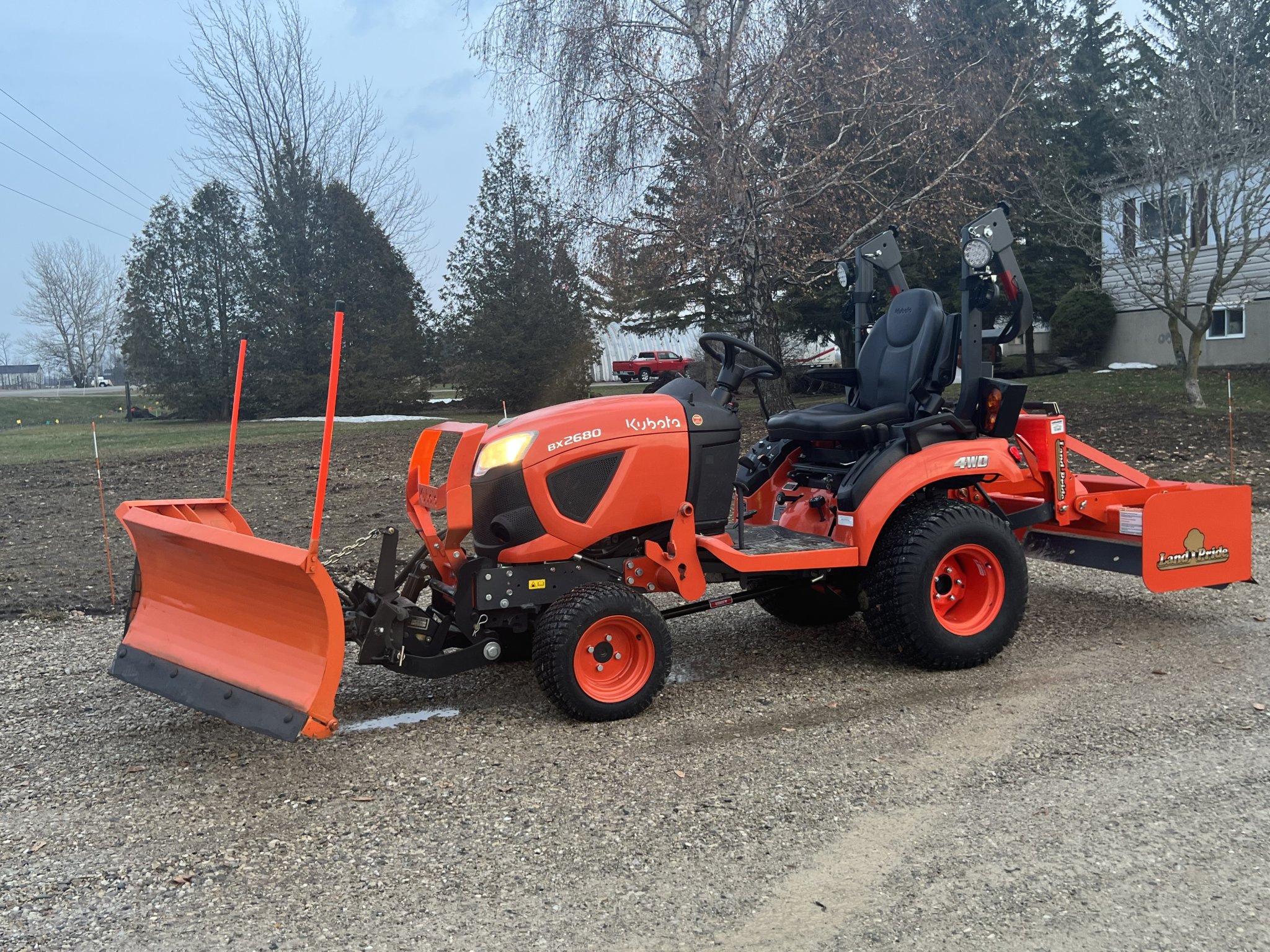

If you’re not a couple inches of snow I prefer to use a blade if we get more than I use the blower. With both setups I use a box blade on rear for back dragging from the doors etc. I also run loaded front and rear turf tires with no issues

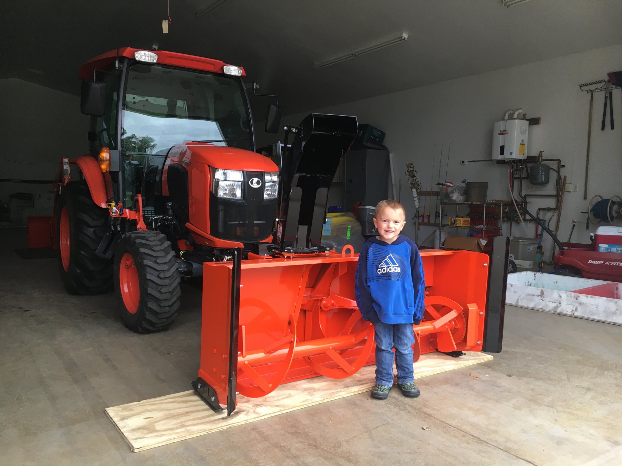

Excellent review of the options! When I moved to rural MN this would have been very informative. I went back and forth between buying a skid loader or tractor. Ultimately, I chose a tractor for overall versatility on my property. I found this L3560 and bought the front blower for it. I have 500 yards of flat packed crushed asphalt driveway plus a large circle area and an ice rink to clear around. This has been the perfect set up for me. I added LEDs front and rear and ballast tires. We get 4-5 feet of snow each winter. I have never broke a shear pin, nor have I had a single issue with this set up. Next year I’ll try adding the back blade or box blade on the back. Had every intention of doing that this year but they got froze in place by the time I thought of it. The only downside I’ve encountered is when there’s big early snow and the ground hasn’t frozen the blower picks up a lot of gravel! I did use the FEL and rear blade for the first snowfall this year for that reason and it took forever! I found it cumbersome and I just couldn’t do as good of a job. Maybe with a little practice it would get better. Regardless, I love the front blower on this rig. Store it inside all summer. A slight nuisance to remove the FEL and put the blower and frame on each winter but well worth it.

Drop those blower drag feet to their lower setting when the ground's not frozen yet. That raises the bottom a few inches above the soft ground and avoids a lot of gravel. The bit of snow left behind usually melts in early season snows. But I know that feeling hearing the sound of gravel flying out the chute. I've scalped my driveway's ridges aplenty doing that.

Now that’s a snow blower. Wow. I live in central Mn with a long driveway out in the country. After using side by side and a walk behind snow blower, decided my old arse had enough. Bought a BX1880. Picked it up before the last snow storm. The front bucket did good but need something else. A snow blower for this was out of my reach for now so ordered a pusher. Picked up a used back blade last week. Hoping this does the job but a snow blower is in my future.

LOL! Yeah it’s an unpleasant sound. The various hockey pucks that get launched throughout the winter make in impressive “thunk”. Fortunately, haven’t had one of those jam up the blower.
Since the above photo I’ve lowered the skid shoes as you mentioned. That has helped prevent the gravel spray.

what v plow blade is that?

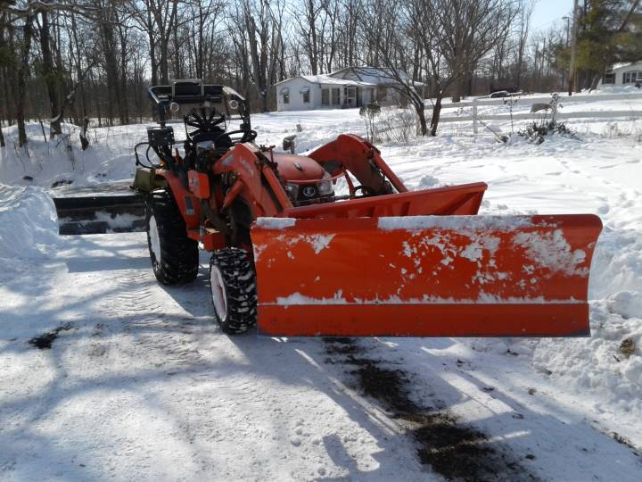

Not a fan of the FEL blade. In float blade bogs down & front axle floats off the ground. I usually just leave the bucket on and use the rear blade (swung to the side).
that is kind of wild ==I love my front blade. I had a back blade but the front blade is awesome. I have studded chains and loaded tires and I can leave the backhoe on the back it took a little while to get the hang of it but being able to lift the blade up high and push the snow back from the edge is great.
