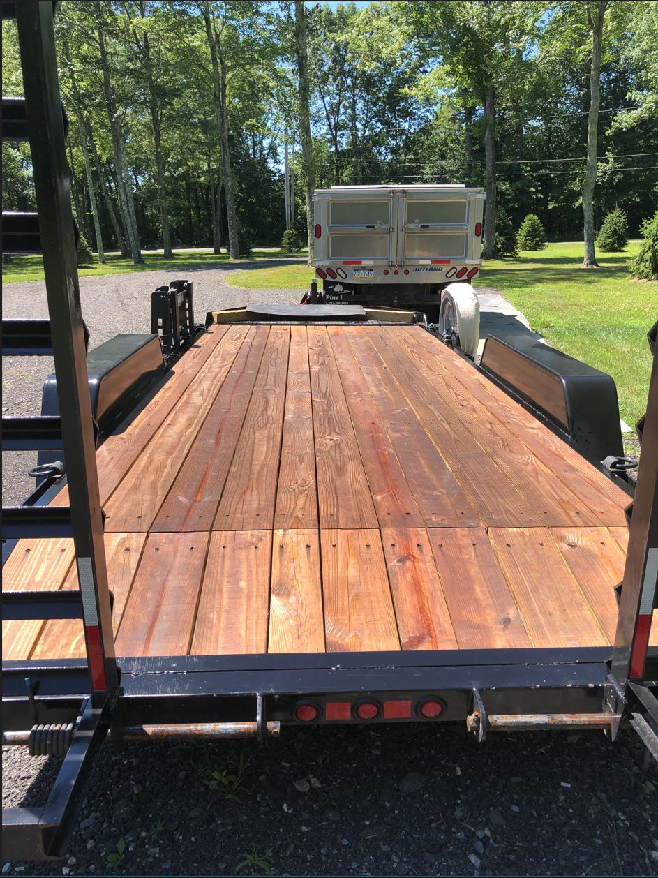

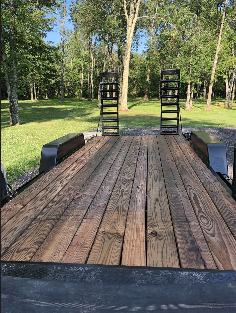

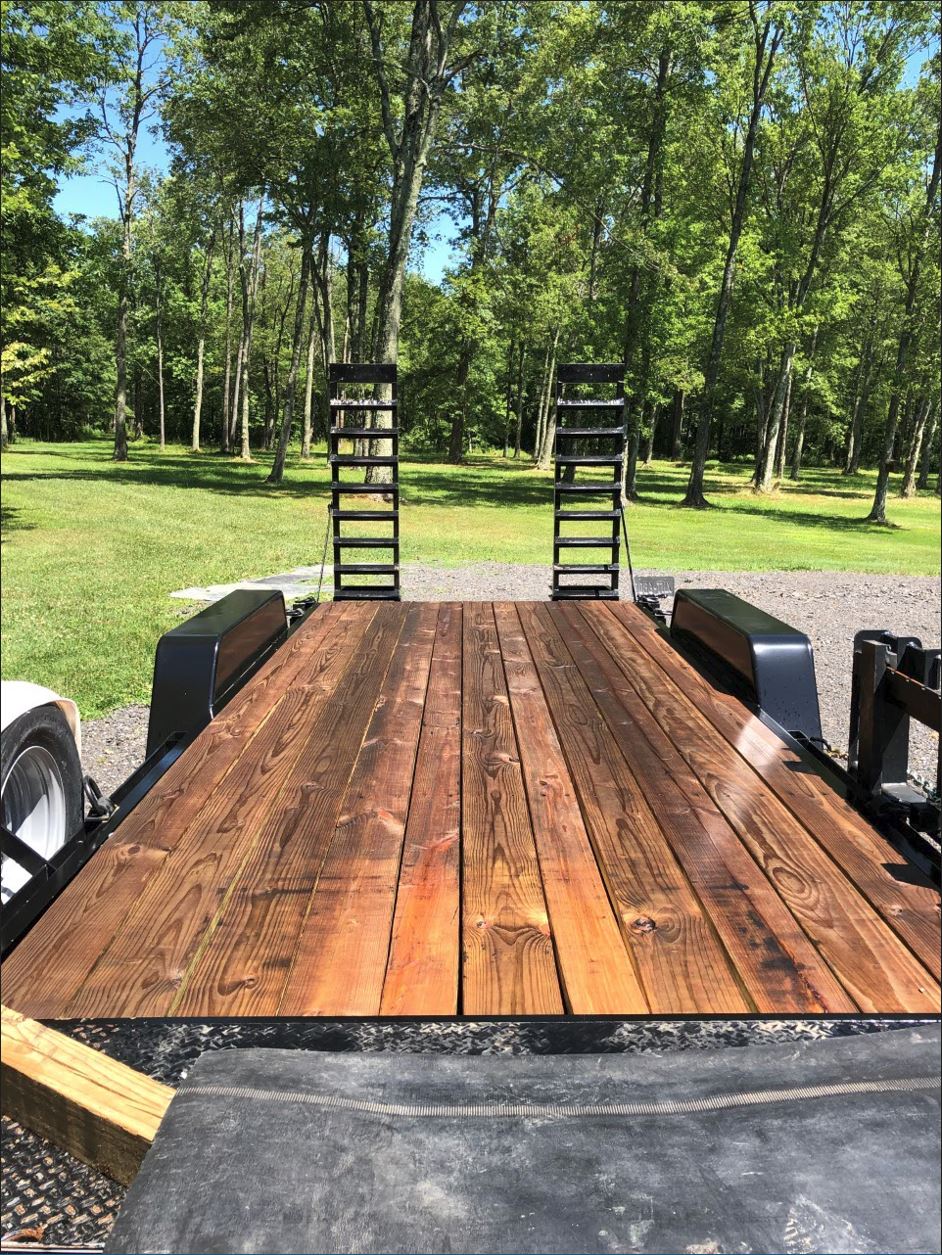

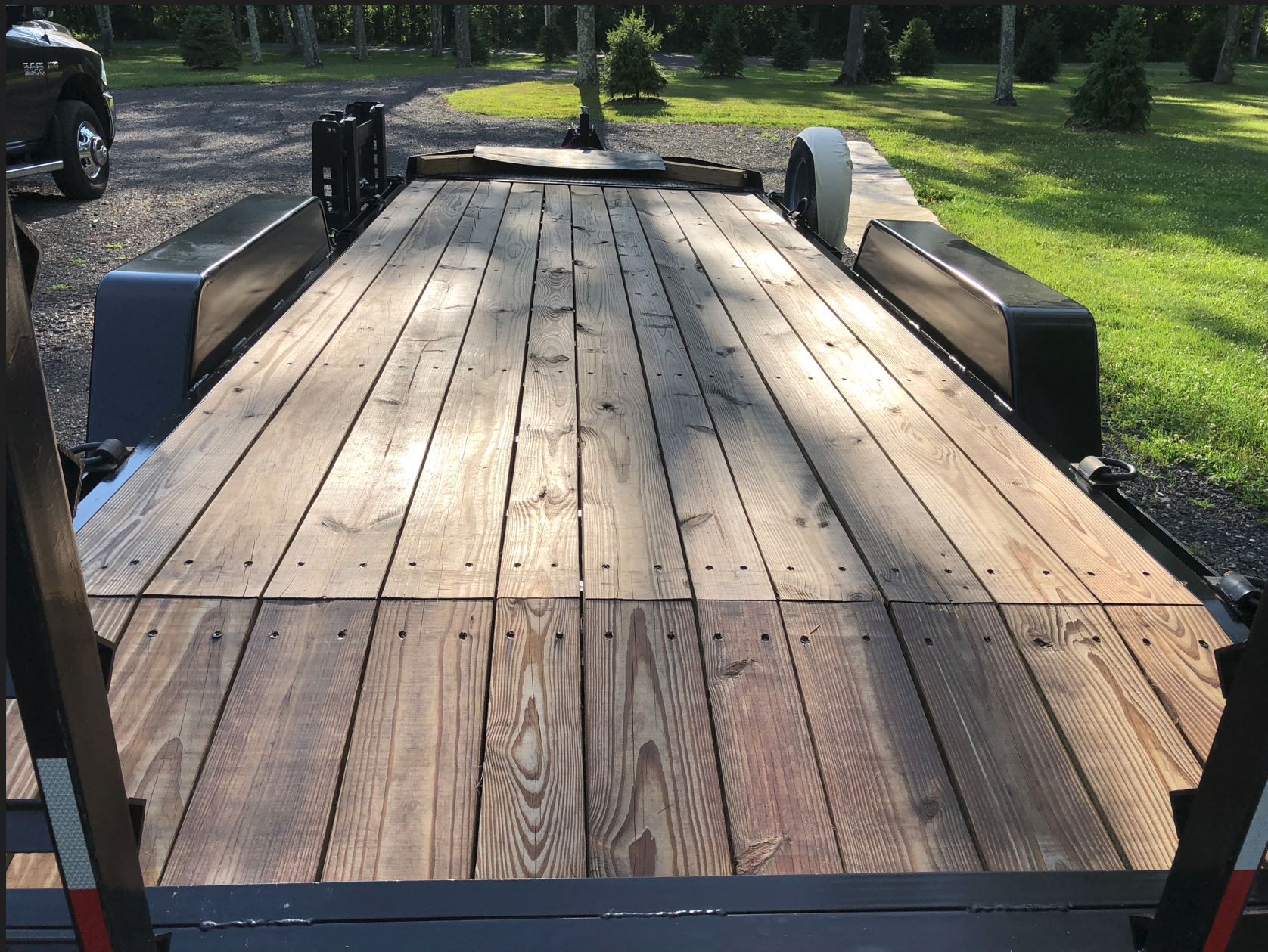

Here's a few pics of the new trailer after applying a coat of used ATF on the PT decking. 20 ft trailer took every bit of a gallon of ATF. Total cost, about $2 for a brush. Sorry, no tractor in this picture.
There is no greasy feel whatsoever on the deck boards after a day. The ATF soaked into the wood almost immediately. It would appear to me to be a better option than the used engine oil I used on another trailer. I'm planning on a second coat of used ATF before winter, maybe.
wet:
Dry (pics taken 4 hours later)
wet:
Looks good. Is there a piece of steel plate that covers the transition from the flat deck to the dovetail? My trailer has that to protect the wood at the joint.
3,695
6,005
No, unfortunately.
