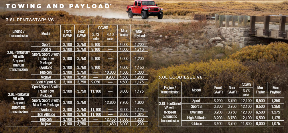

In addition to the good info above, also, keep in mind other factors when considering a tow vehicle.
GVWR - how much can the tow vehicle weigh (this number includes all occupants , cargo AND tongue weight) - basically everything in and on the vehicle including larger tires, tool boxes, cargo racks, etc.
CGWR - this includes the GWVR above + the trailer and cargo on trailer.
Based on screenshot from jeep gladiator brochure - the max CGWR for V6 gas is 12,800 lb (Sport/Sport S with max tow package with auto transmission and 4.10 axle.) The base curb weight for sport/Sport S with auto transmission is 4613 lbs (Second screenshot below).
12,800 (GCWR) - 4613 (base curb weight) = 8187lbs - so with the max tow configuration, you have 8187lbs for people + pets + bed cargo + trailer + trailer cargo.
Max trailer is 7700 lbs. If you tow 7700 (trailer + trailer cargo) then that leaves 487 lbs (8187 lbs remaining of GCWR - 7700 max trailer). That 487 lbs includes people + cargo + tonge weight. If tongue weight is 770 lbs (10% of 7700 max trailer), you're over weight by 283 lbs before sitting in the drivers seat or putting anything in the bed.
The diesel is less because diesel engine weighs more than gas engine and they don't account for 4.10 axle, they only list 3.73.
Many folks (including sales folks for auto dealers, trailer dealers and camper dealers) don't fully understand this towing and capacities.
Ever noticed a tow vehicle sagging at hitch and trailer being towed sagging at front at hitch? That's a good sign of trailer tongue probably is too heavy for the tow vehicle and tow vehicle is probably over GVWR. Weight distribution hitches can help spread load, but still need to take into account GVWR and CGWR.
Many try to compensate for this with air bags or added leaf springs to raise the rear up, but they are still probably over weight.
Being overweight (in any aspect of the above) can be dangerous or tow vehicle and others on the road.

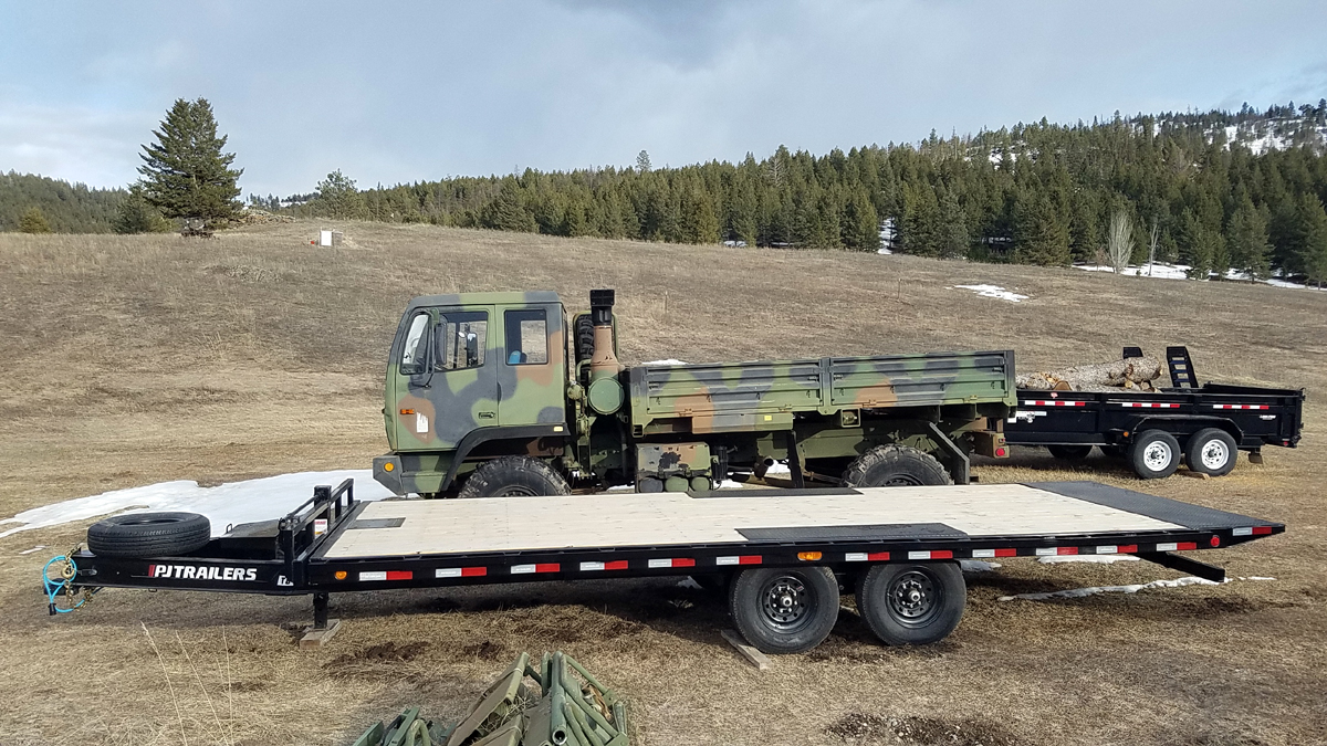

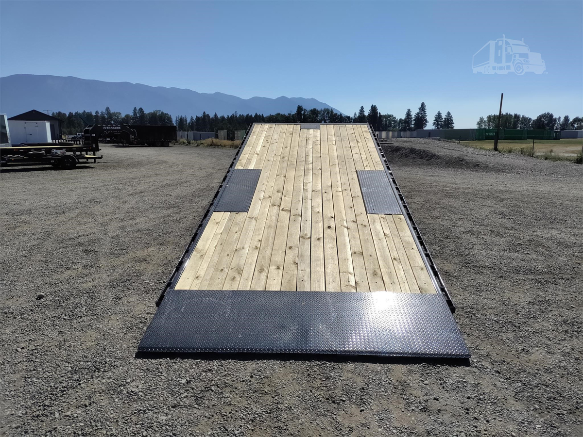

I bought a new PJ 22ft deckover hydraulic tilt trailer this week so that I can transport tractors and implements with a wheel spacing greater than 82". I plan to pull it behind the M1078 shown and the F250 Super Duty. I ordered another set of CURT hookup brackets that I'll weld to the tongue of the new trailer for those times it's behind the F250. I won't need to use them when towing with the M1078 since it won't even know a trailer is there!

For the record, those numbers are manufacturer's recommended values, not federally mandated values, or even state mandated values. A vehicle and trailer loaded well below manufacturer's recommended weights can be unsafe just as a vehicle and trailer loaded over those recommendations can be safe.

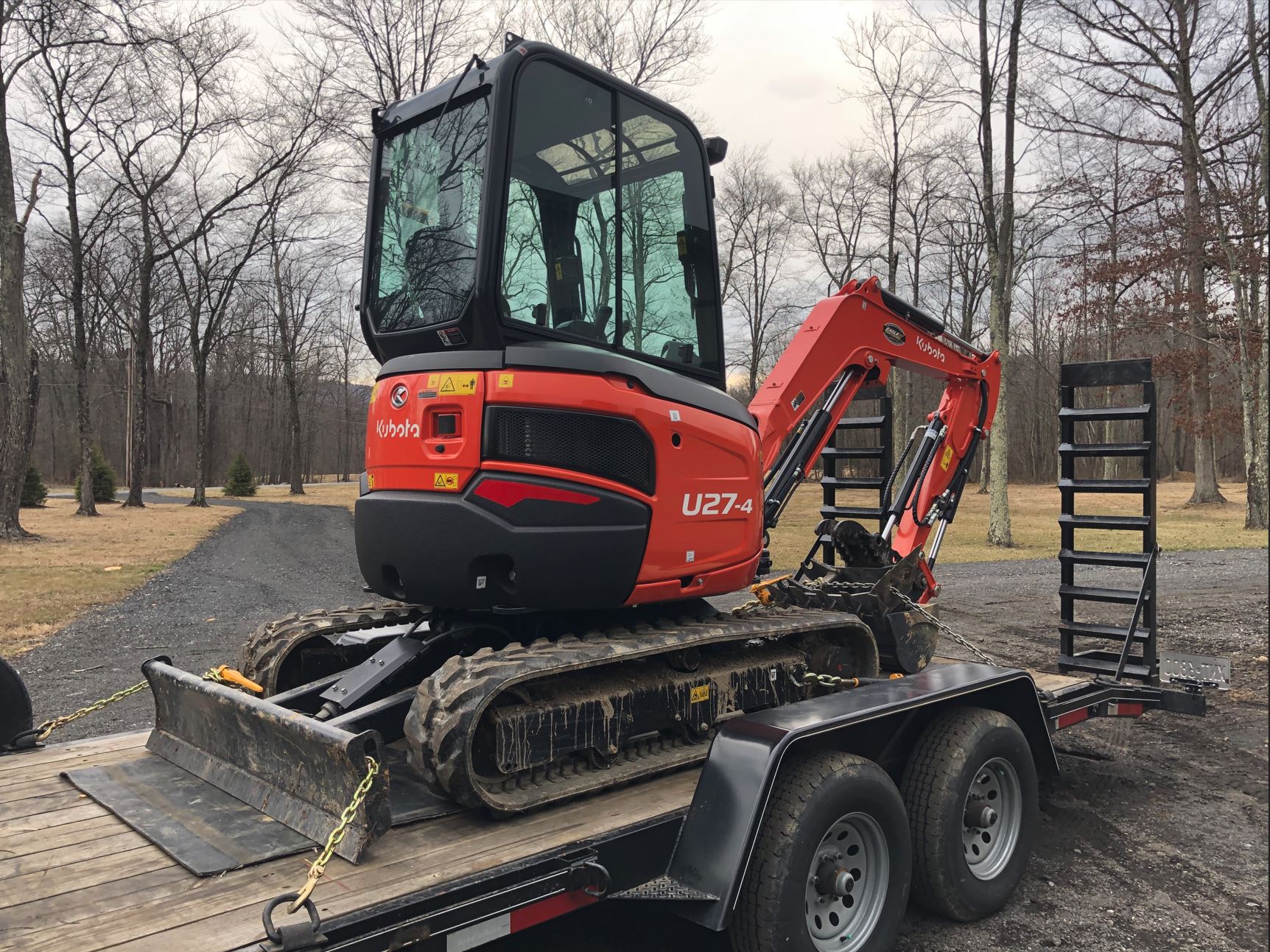

3 ton mini on a 20 foot 10K trailer. The only thing missing is the 3' grading bucket on the front of the trailer. Plenty of room...

That’s a slick set up…if we are being true to the name of the thread, it’s lacking one of your orange monsters. 🥶. Very nice trailer though.

That's a nice trailer. When I eventually upgrade my 16 footer I see a 20' deck over replacing it.

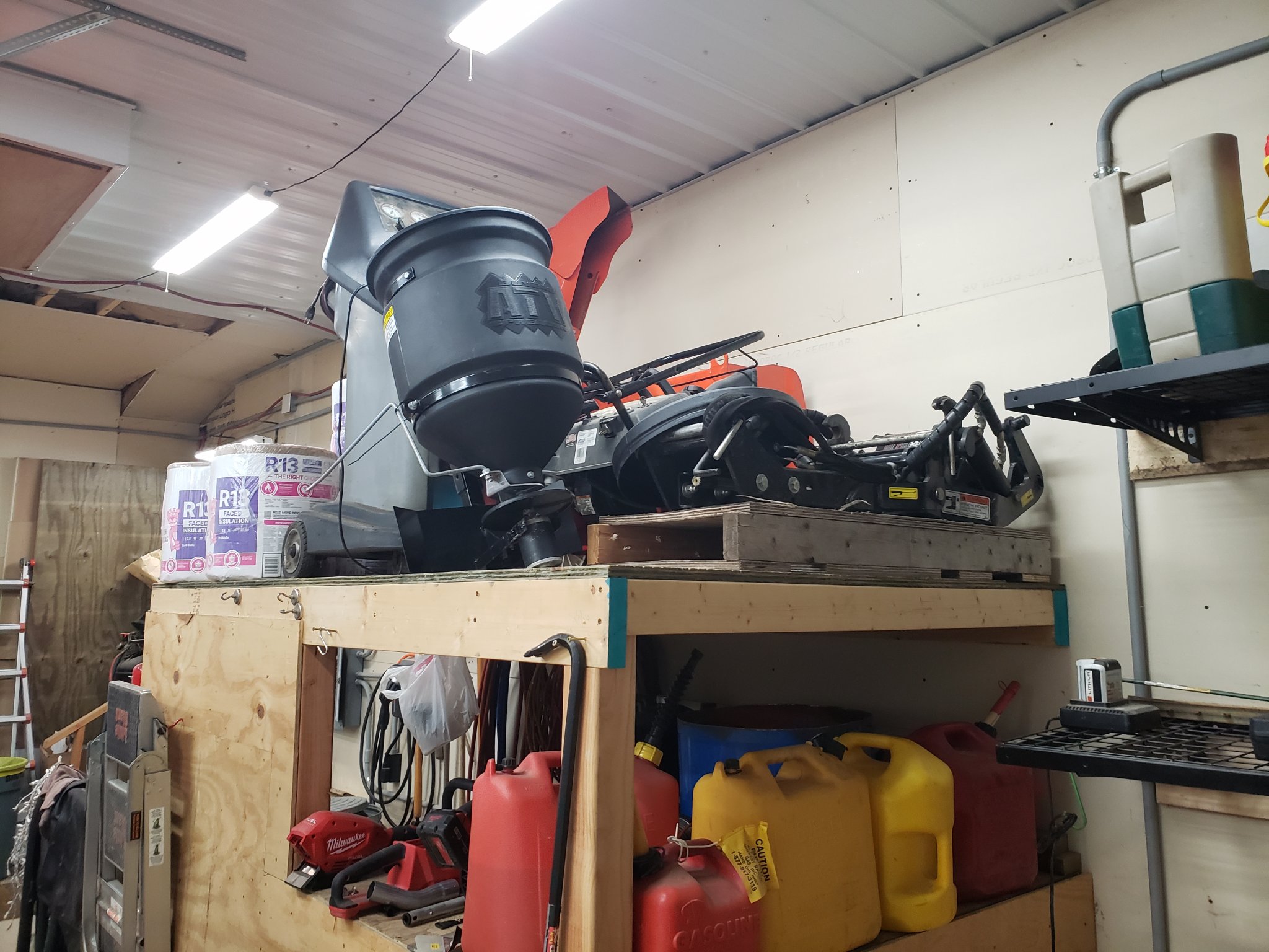

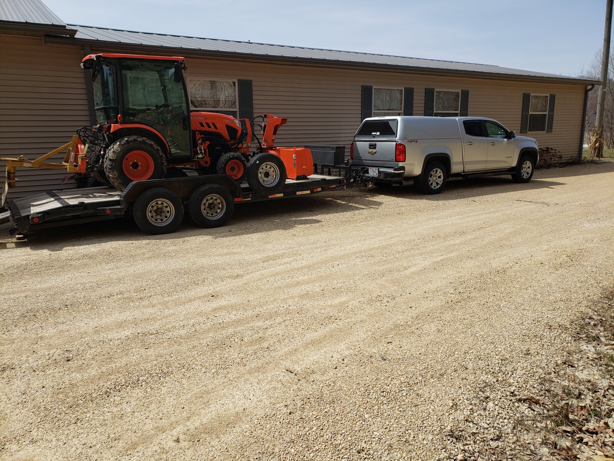

Had to take the tractor in for a recall(pipe rubbing on backhoe sub-frame) and while it was there installed a hydraulic chute deflector. Ordered just the cylinder and had hoses and couplings from summit hydraulics. Installed the loader and pallet forks and got all the snow blowers and such put away on the shelf for winter.
My truck has 181 hp and 369 lb.-ft. of torque, the all-new 2.8L Duramax lifts Colorado’s maximum trailering capacity 7,200 lb. in 4x4s, therefore I'm just a bit over this by a few thousand pounds. Before I get attacked, live in rural area, I go slow, use common sense, sway stabilizers/weight distribution , air bags on truck, don't haul tractor often, and spent all my money on tractor/implements.

Had to take the tractor in for a recall(pipe rubbing on backhoe sub-frame) and while it was there installed a hydraulic chute deflector. Ordered just the cylinder and had hoses and couplings from summit hydraulics. Installed the loader and pallet forks and got all the snow blowers and such put away on the shelf for winter. View attachment 99958
That's a great out of the way storage location. I got to play attachment tetris moving things in and out of my shed to put my blower away this afternoon.

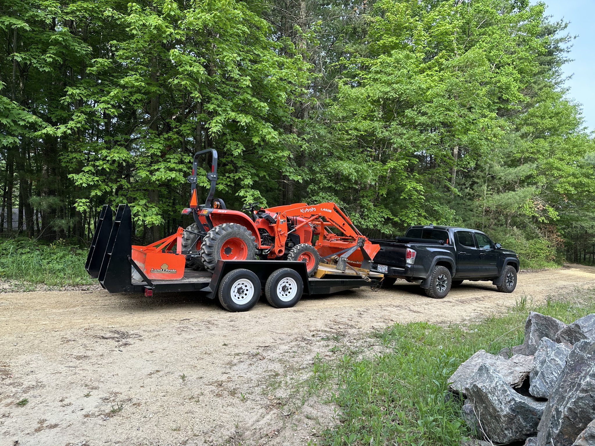

Took a chance on it and it blew me away how well this towed. I’ve always been in the “tacomas are good for <5k” camp, but airbags in the back are a game changer. It certainly wasn’t a rocket ship, but more importantly it was drama free and stopped really well.
Tractor is right around 4200 with the tires filled and the box blade. Mower is around 400. Trailer is 2k on the nuts last time I did a dump run. Had a cooler and some camp stuff in the bed and 4 people in the cab. Definitely overloaded, but never once felt sketchy.
