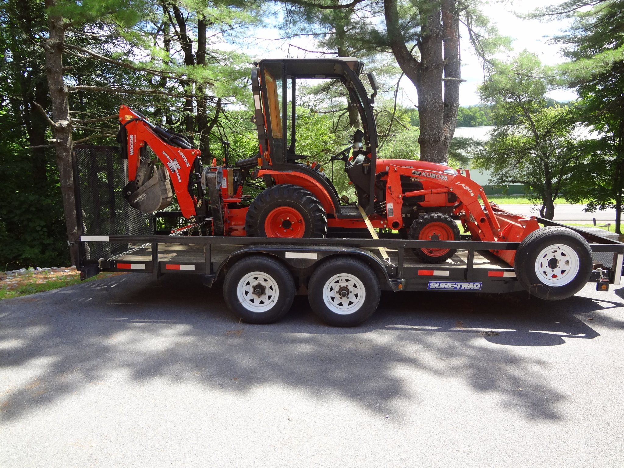

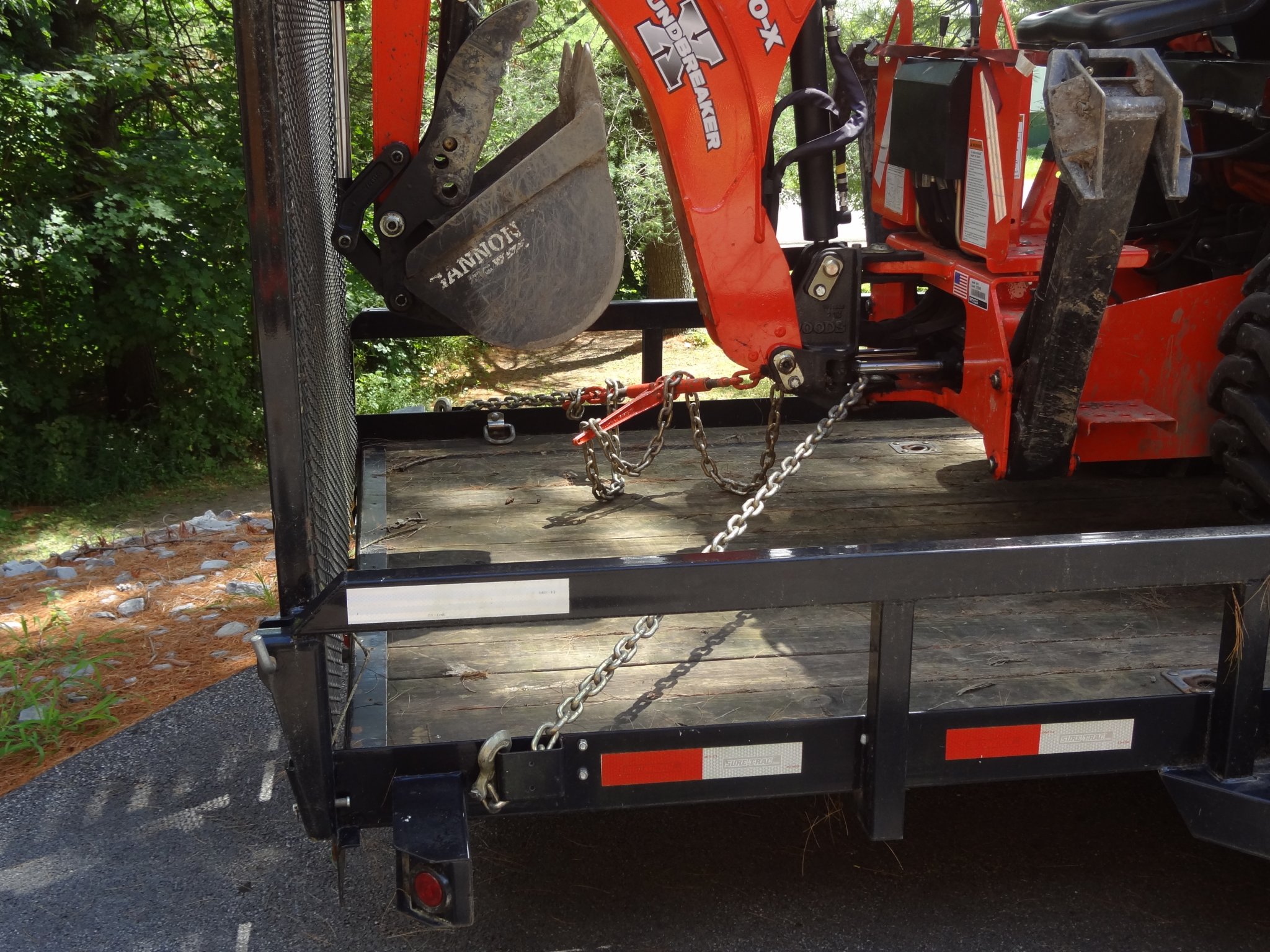

Finally, it got loaded on. Here's my B 3200 on a 18ft, 10k Sure- trac, and never any issues.

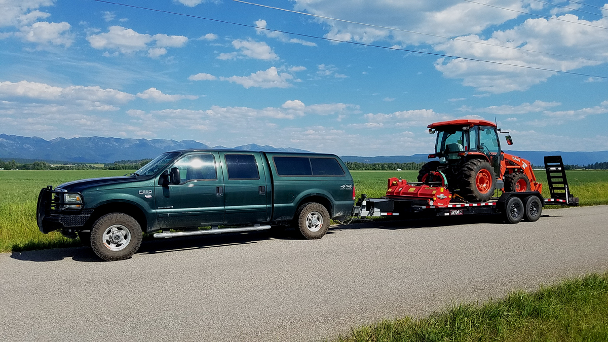

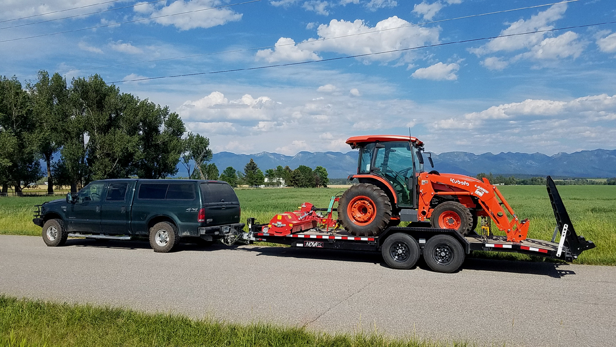

Here's the MX and Del Morino on the 22ft MidSota trailer yesterday near my friend's place along the river. I'm going to move the tractor about 12" towards the rear of the trailer when I take it home on Sunday afternoon/evening.
8,005
5,182
I hadn't got all the straps wrapped up, but I wrap them up to prevent them from flying around in the wind.
Trailer is 12,000lbs rated trailer. Trailer weighs ~2,700lbs. If I have the bucket and box blade on, tractor weight is ~6,500. SUV is rated for 9,200lbs of towing.
Trailer is 20 feet, split loading ramp, and brakes on both axles.
Loaded to 9,200lb. tow vehicle rated maximum.
That trailer definitely needs an Equa-l-izer hitch for any high speed towing with that particular vehicle!
