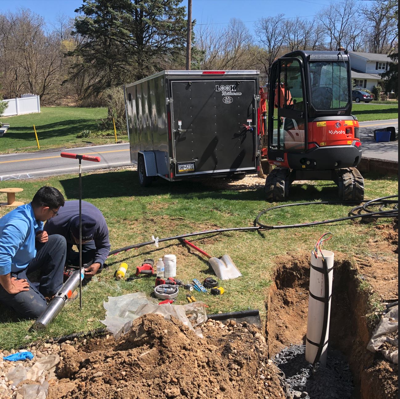

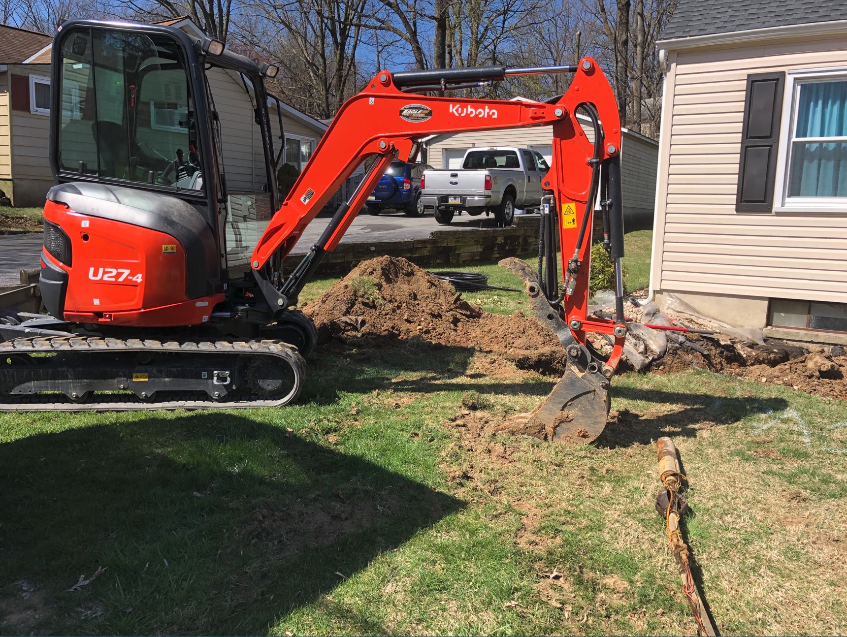

Just did this one a few weeks ago:
old:
new:
Really not that complicated. If it is in fact the pump itself, I'd replace the electric line (down hole) and the poly pipe as well. Just match up the length to the existing well (you really don't want it deeper or shallower). May want to replace the rope as well with new poly. You can transfer over the torque arresters (if your existing line has them).
edit: forgot to mention that if you have a steel well casing (and sometimes pvc like the one we fabricated above) you'll likely have to deal with a pitless adaptor. You need T pulling post (or with your skills, can fab one up).

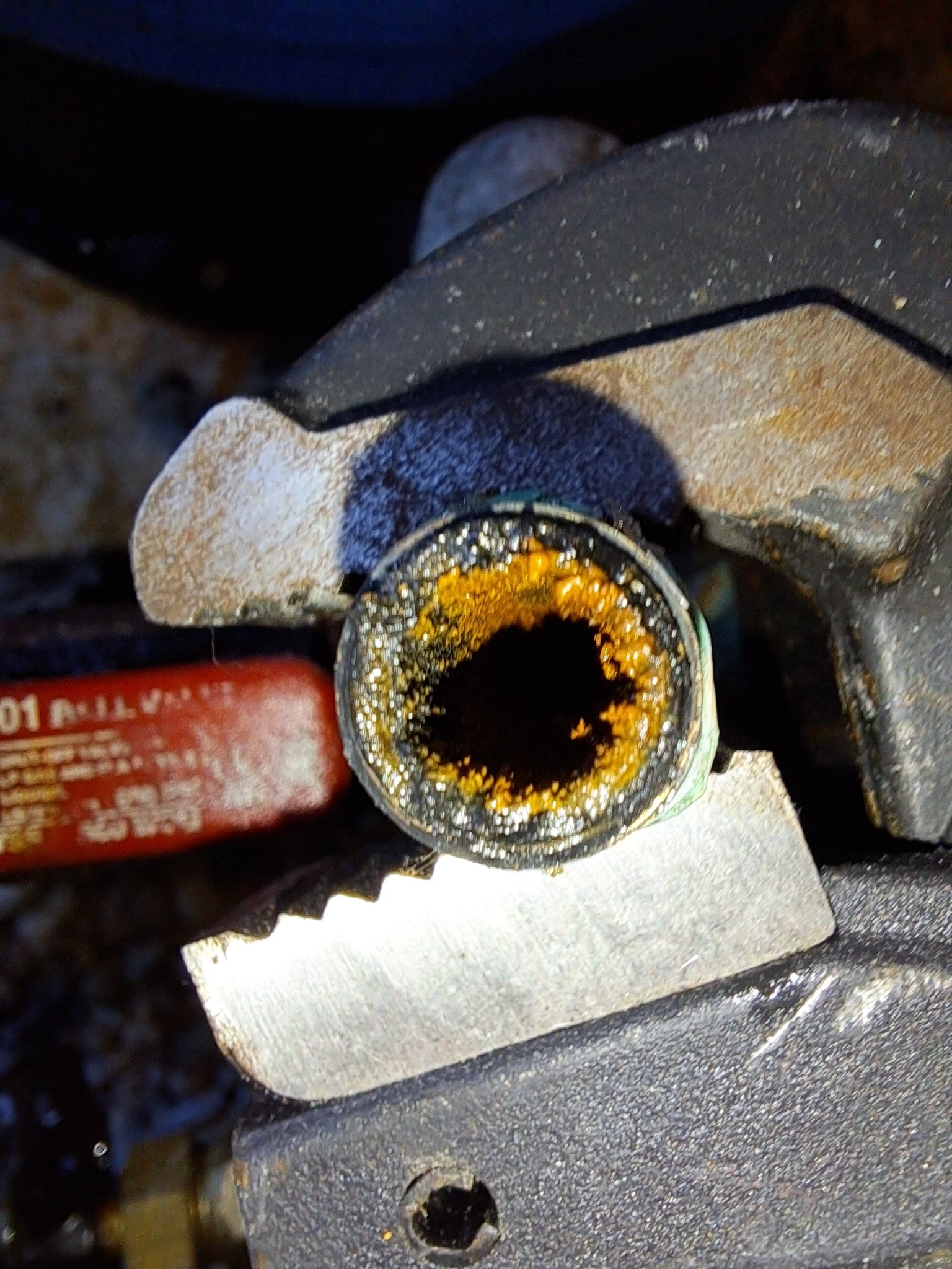

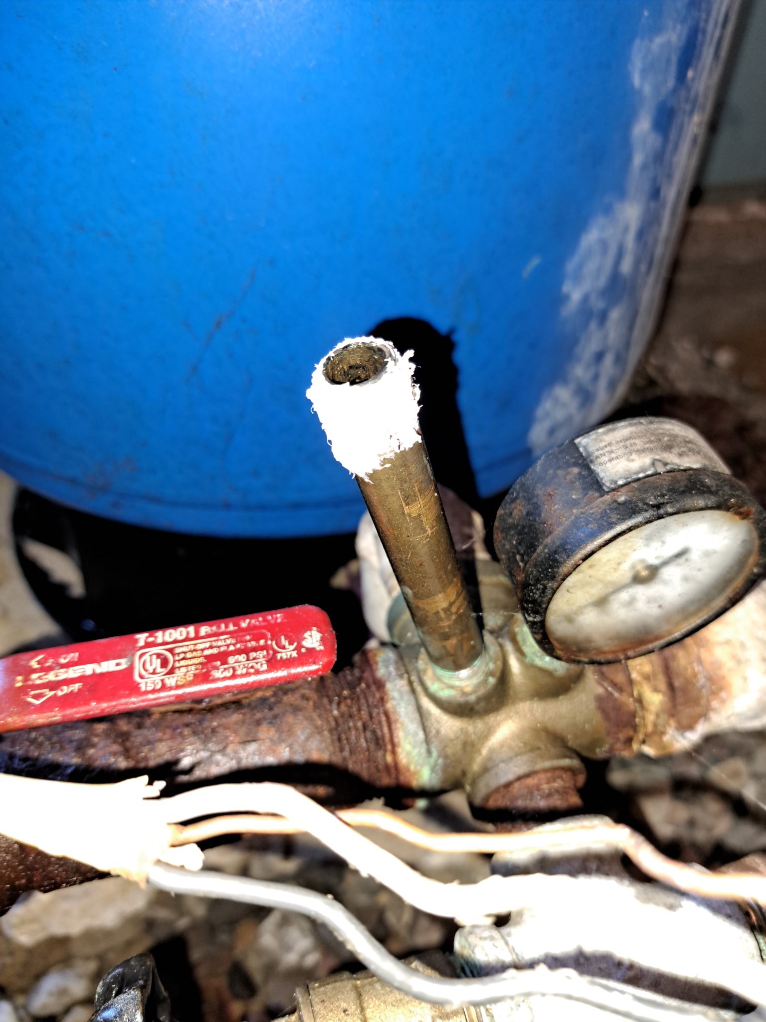

From the advice here, when I removed the switch, I inspected the pipe leading to the switch and although it wasn't technically plugged, I cleaned it out a bit, 20230526_081215[1].jpg
