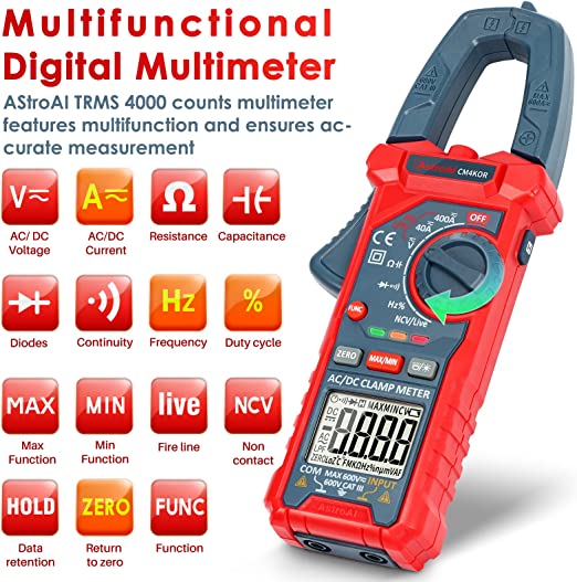

On a good note, I did get to justify a induction style ammeter to check the current draw. (y)
