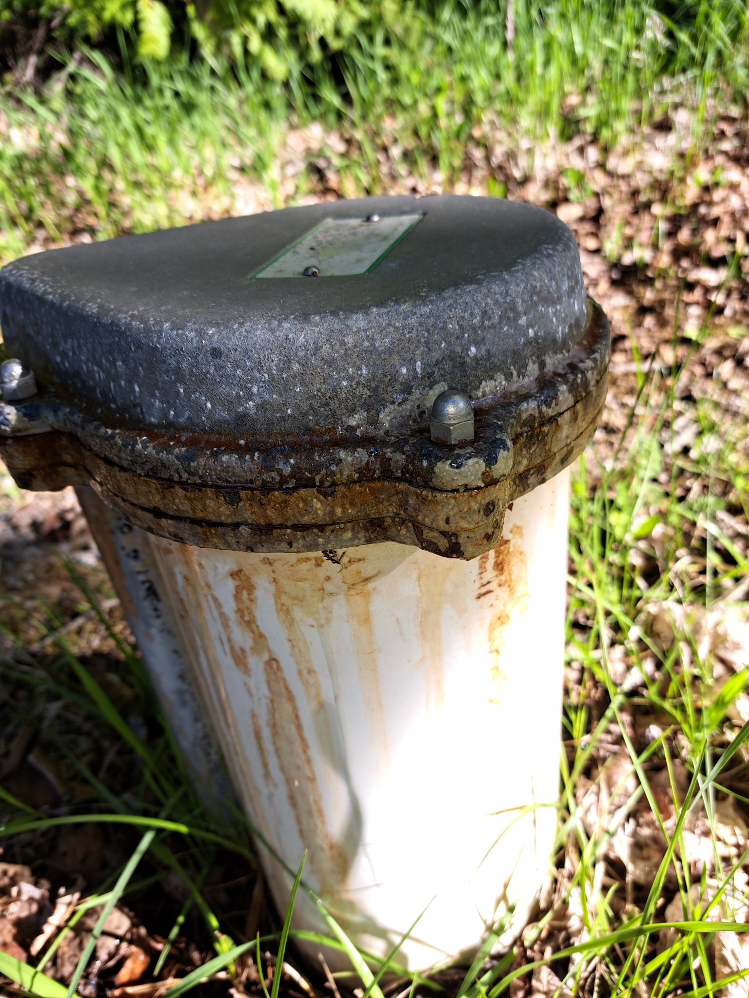

After checking all the faucets and a quick cursory inspection for a leak in the house, I walk out to the well head and find water leaking in between the casing and the cover.
  • Sad
4,111
5,563

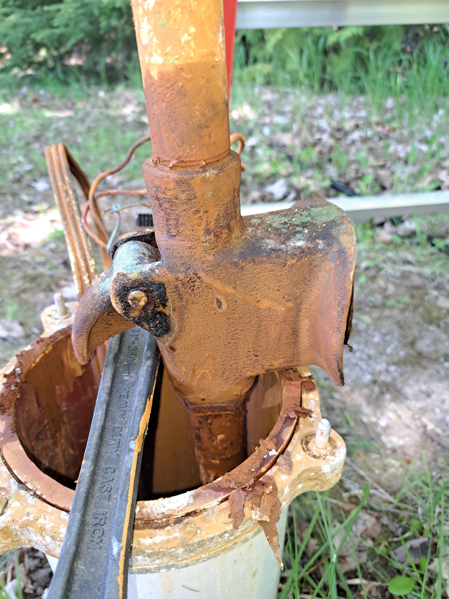

OK fellas, now we are in uncharted waters for sure!!!!!!
I pop the cap off and find what appears to be some sort of bar across the top and a pipe with a hole in the center and water is spraying up from something. I cut the power again and begin searching for the "mystery leak". It takes a few minutes for the leak to slow down so I can kind of see where its leaking from.
4,111
5,563
So with eyes on the problem, but a serious lack of knowledge, my mind starts racing through every scenario I can muster.
The well driller was kind enough to very clearly stamp their contact info on a plate and rivet it to the well cap, but no other info is on it.
So I figure that "doo hickey" bar is some sort of holding fixture, so I gently use the end of my pipe wrench to try and " lift it up a scosh".....Well after a lifetime of breaking sh!t, I decide to stop what I am doing and go back to the plumbing supply store and see if they can give me some advice.

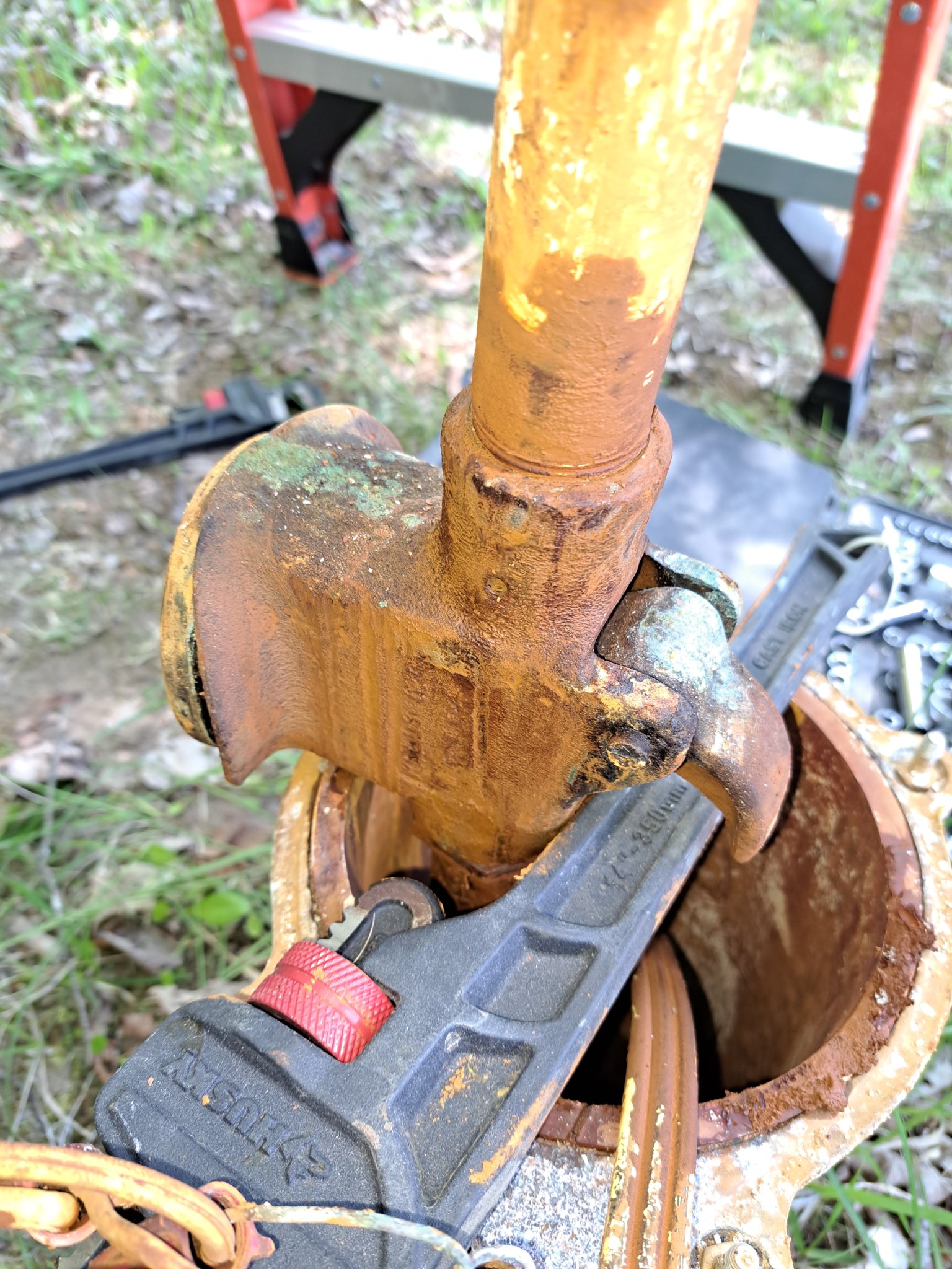

So it appears that my "pit-less adaptor" o-ring is leaking, which is causing my pump to cycle too often.
He tells me that I need to make a ""special tool".
Well although I have no problem making a new tool, I am about 270 miles from my shop..... so he offers to make one for me and takes a piece of pipe off the shelf and with a BFH, he lays it on the floor and puts a beat-down on the end.
Now he says to put the tool down there and unlock my "Fetzer arm" and then just gently lift it up, take a picture, inspect it for cracks and come back he will hook me up with everything I need.
Armed with my new knowledge I head back to try and lift up a well pump and 300 ft of tube/pipe/pump.....

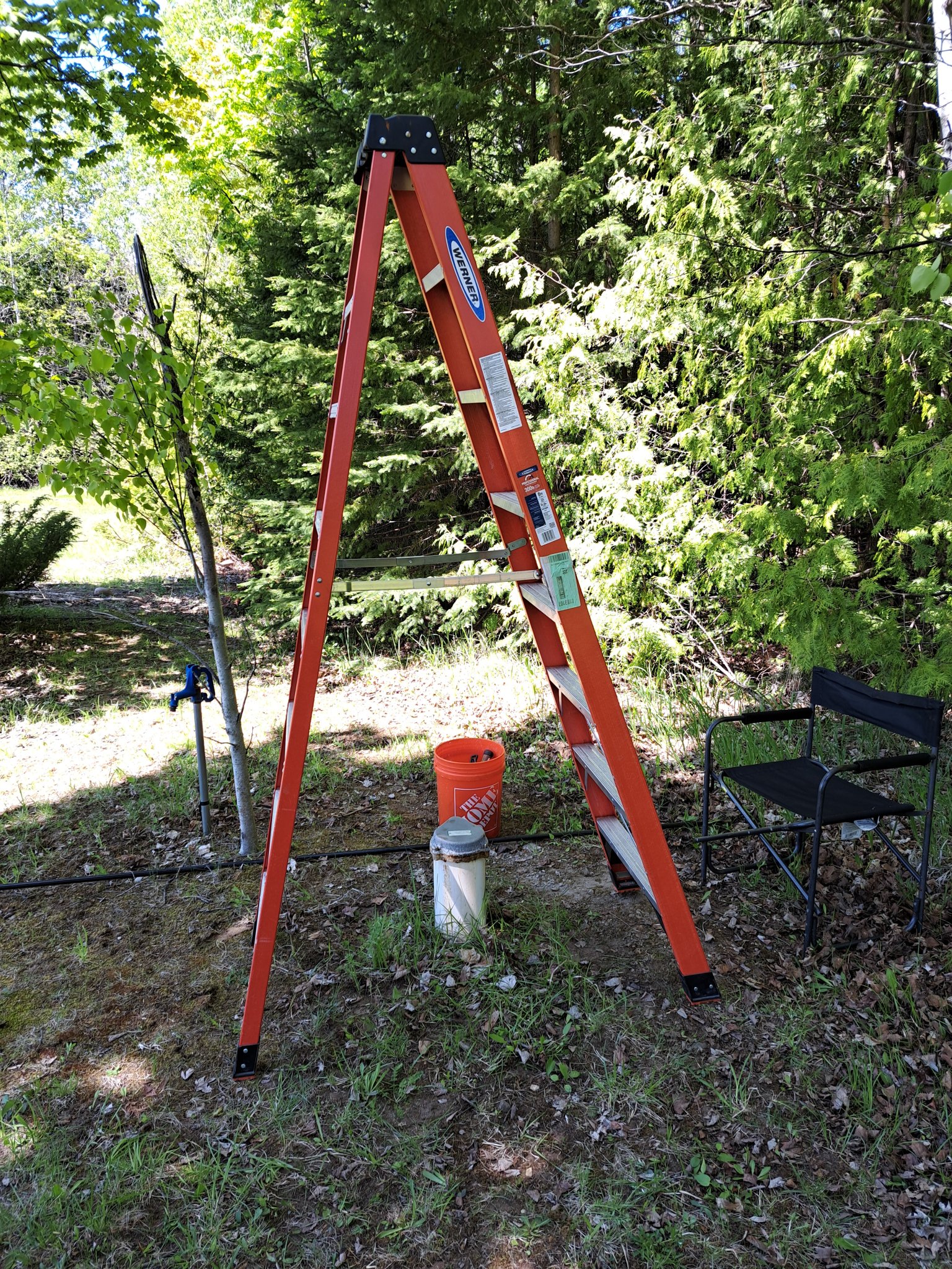

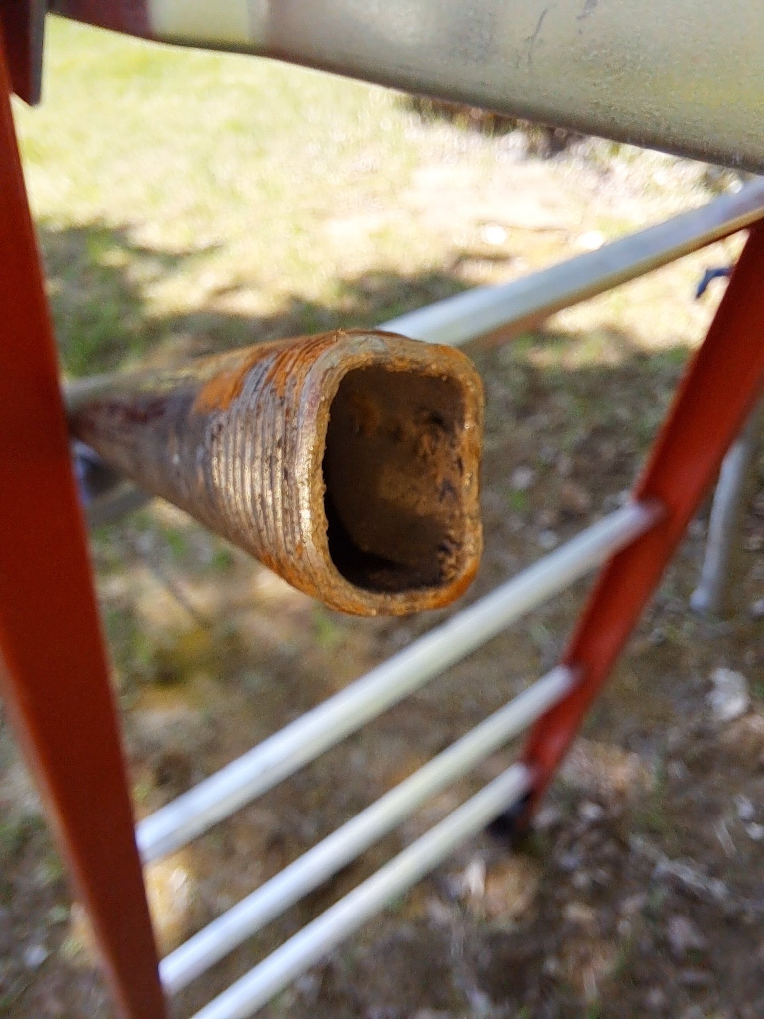

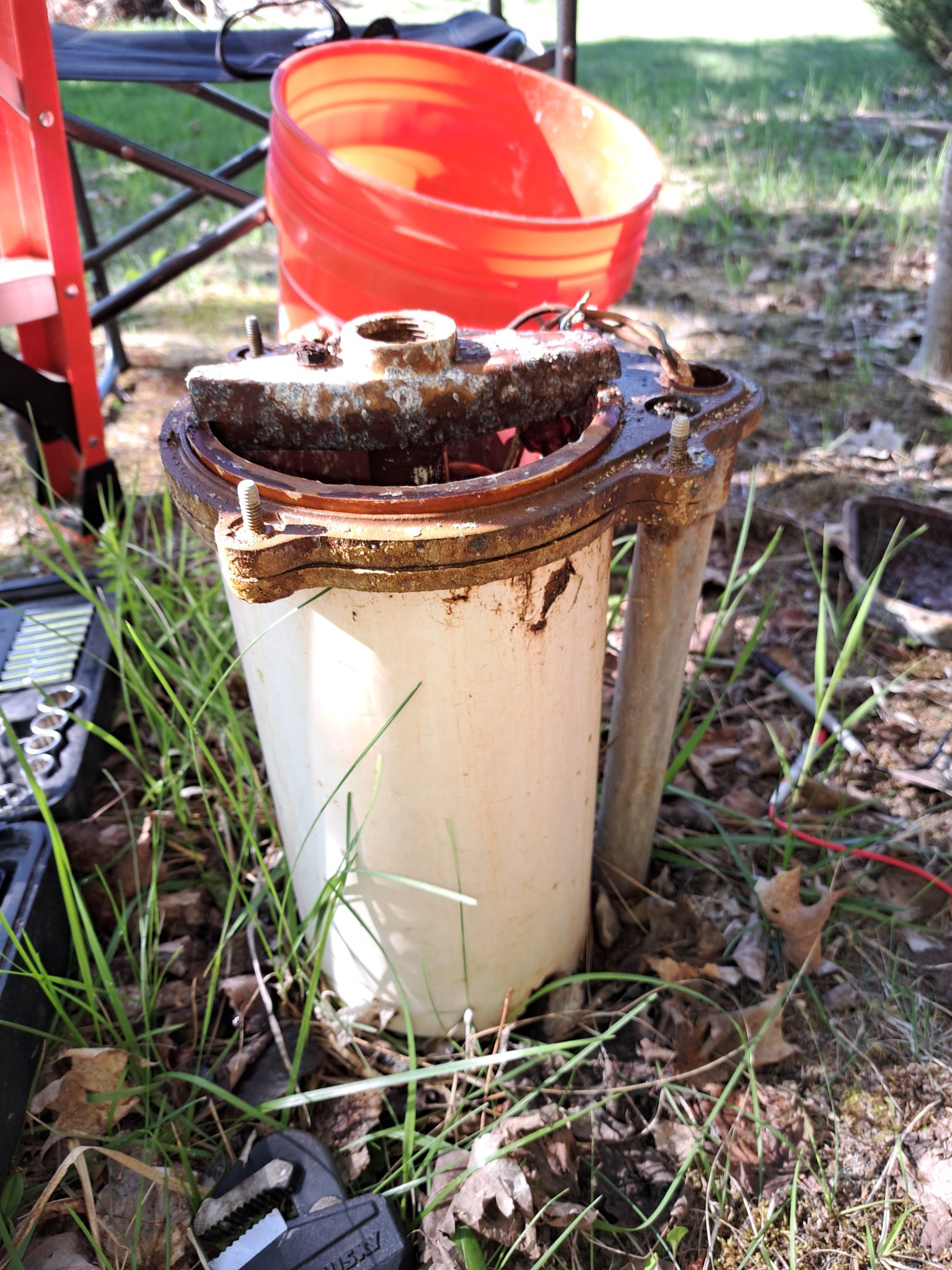

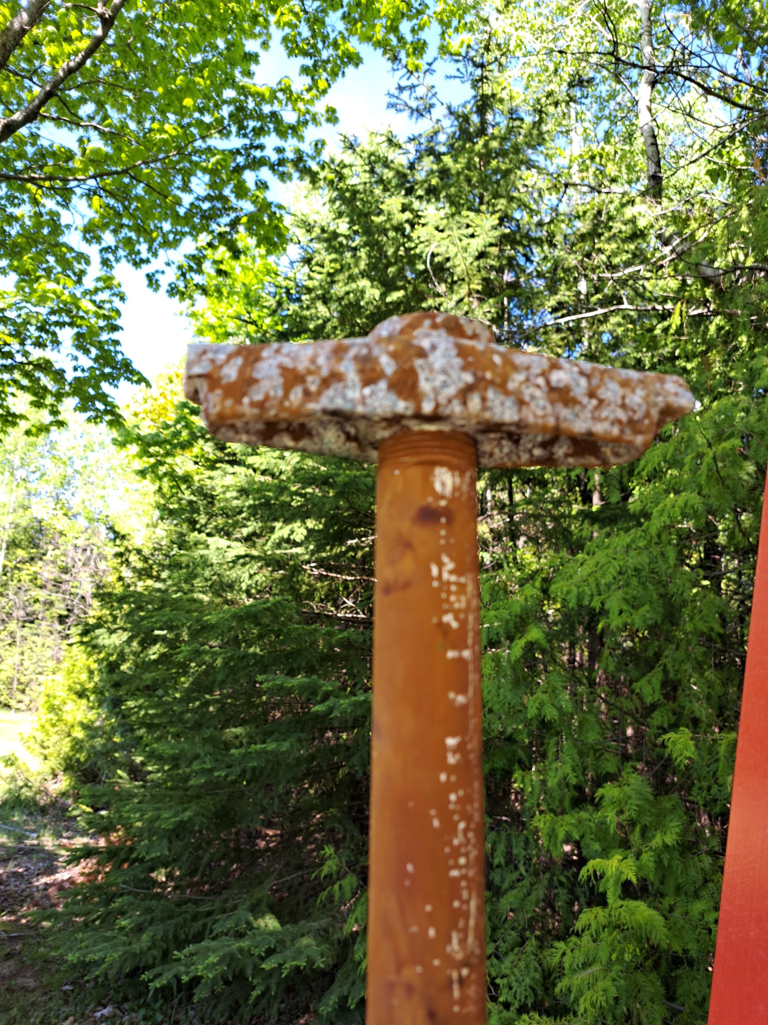

Here are some pics of my "well pulling" set up (picture my "come along" attached to the top rung).
The "special tool" was squished a little too much and wouldn't fit, so I used a hammer and pounded a 3/8" extension end into it to open it up a little.
4,111
5,563
Now for the Moment of Truth......Lifting up a heavy a$$ well pump, 300 feet of water and tubing......
After unlocking the "Fetzer arm", and taking 3 deep breaths like I was preparing to break the Mens World record by Deadlifting 500 Kg at the Olympics. I grabbed the "doo hickey" and........
It lifted up smooth as "butter"....It appeared to weigh like 25 pounds. šŸ˜‚ šŸ˜‚ šŸ˜‚ šŸ˜‚ šŸ˜‚
20230526_105826[1].jpg 20230526_105812[1].jpg 20230526_105851[1].jpg 20230526_105812[1].jpg
4,111
5,563

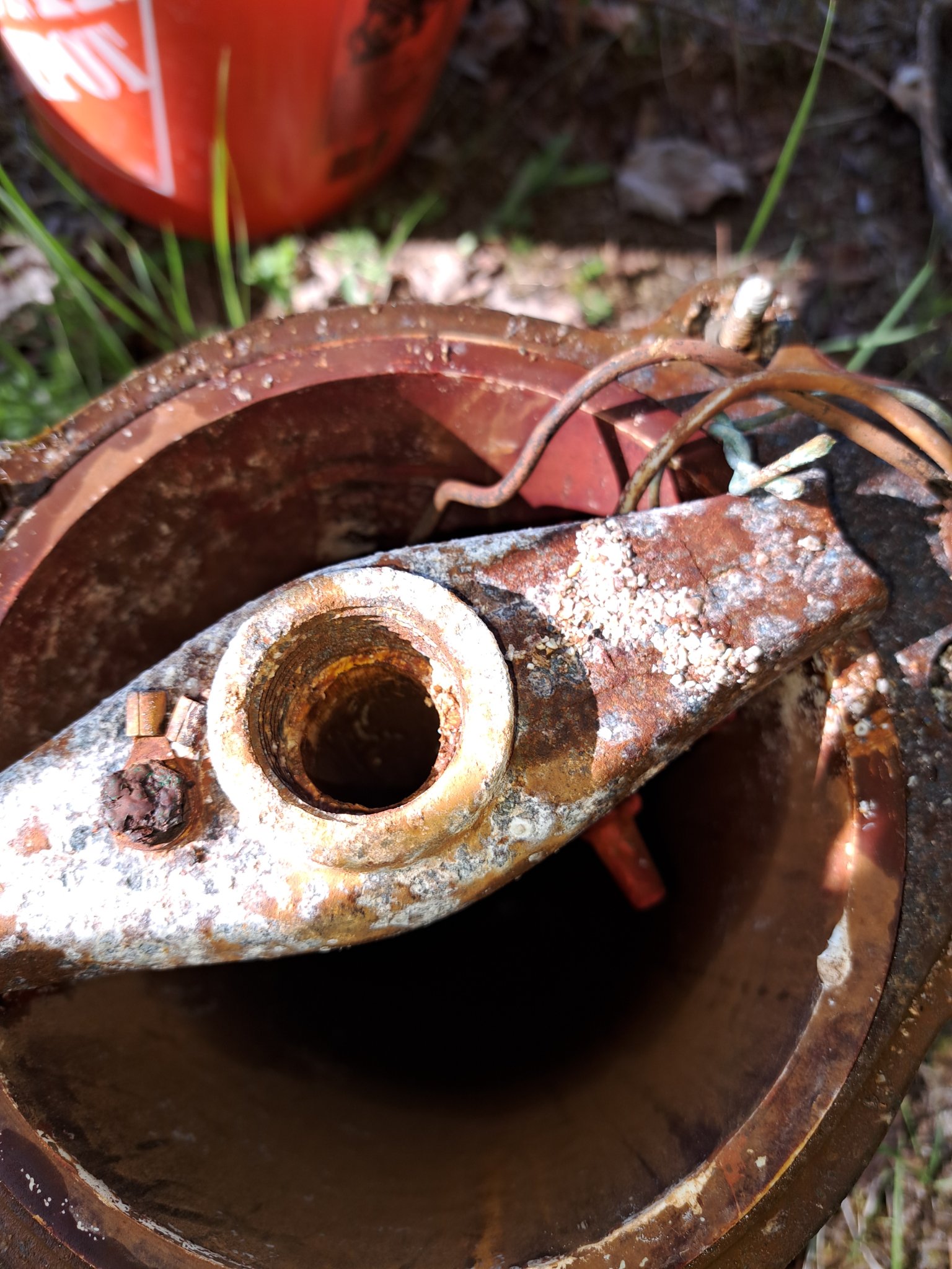

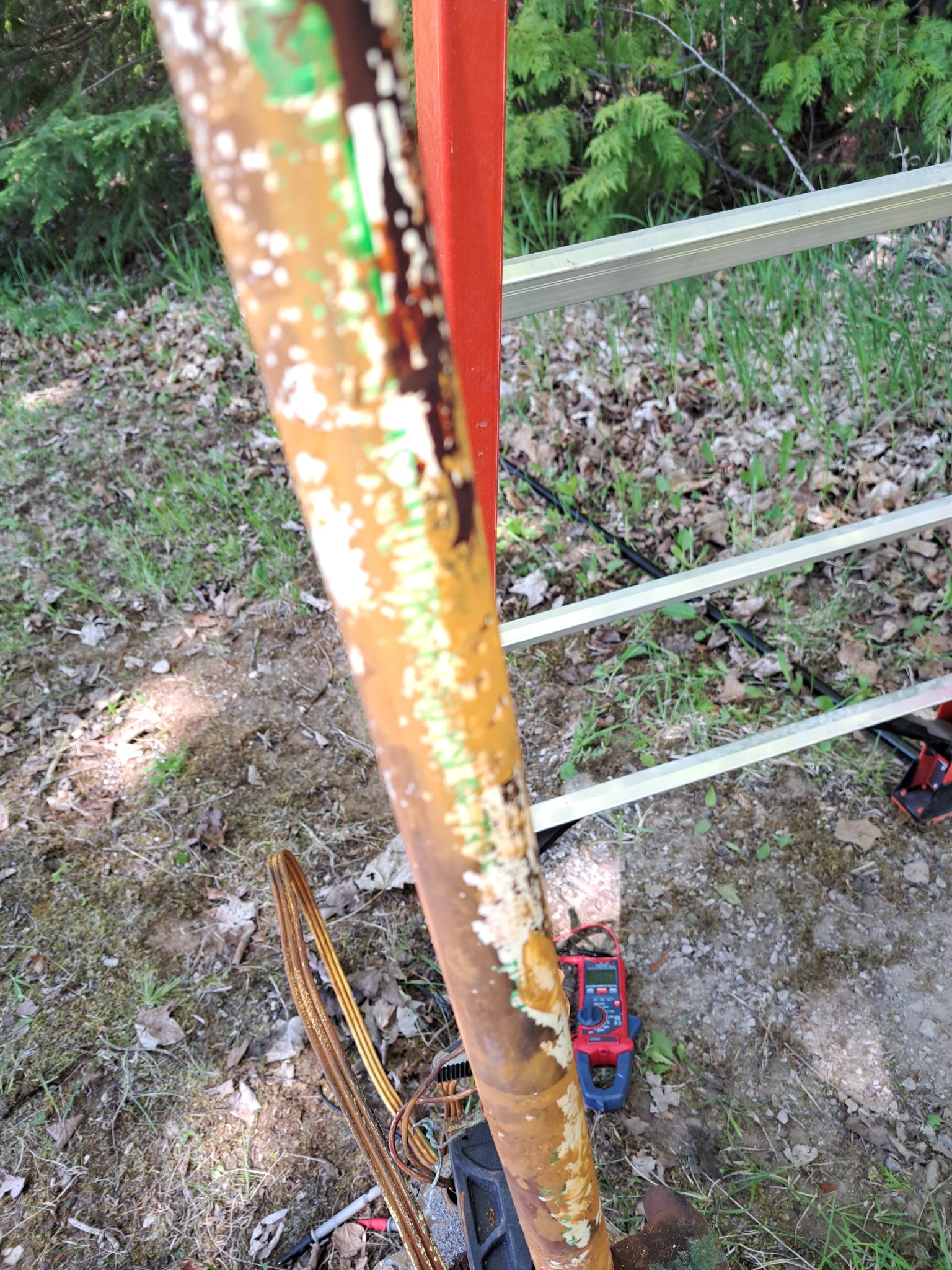

Now for the bad news......The entire pipe below the "doo- Hickey" and pit-less adaptor was PVC........
I just about sh!t a brick when I saw that.....Now I explain to the old lady that we can't put that back in like that, and that we have to pull it up and cut it off every 10 feet until we get the pump out and replace the PVC with "poly pipe" .......I went to the garage and grabbed the Sawz-All to begin surgically removing the pipe one section at a time...
Here are pics of the PVC tubing.....

To my surprise, that "PVC" is some sort of "Magical PVC" called "Drop Tubing" (I think) and he can't remember of ever having heard of anyones pump breaking off and falling into the well from the torque of the pump over time (this is what I had believed from watching Youtube videos)
He said it's good stuff and that he sells a ton of it.
"Happy or Ecstatic " can not begin to explain my feelings at that moment.
So for a $1.70 I put the new O-ring on and put her back together.
