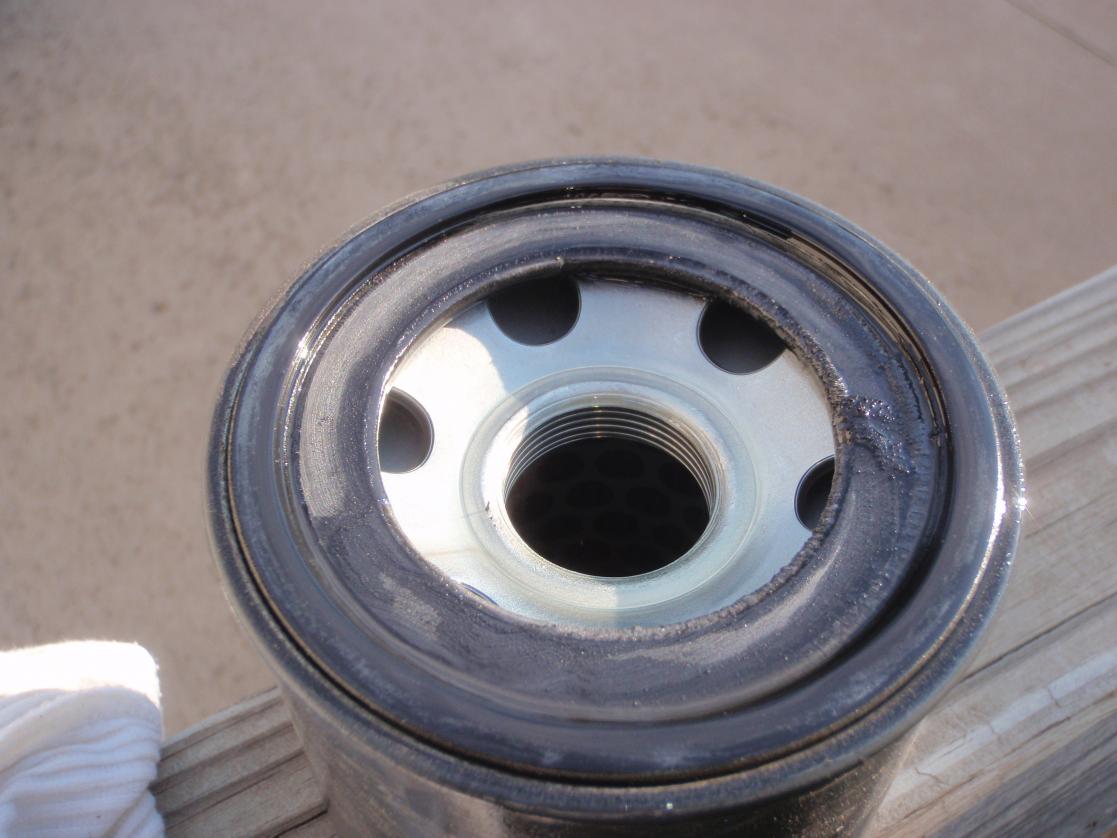

Just curious, what did your filter with the magnet look like? Anything like number 9's or more like mine and bluegills?
Yeah that fuel filter is messy, I broke my fuel filter body and I had fuel everywhere until I stuck a boot in it, I like bulldogs idea of installing a shut off valve.
I will post pics this weekend of my filters for you guys.

here is the hydraulic filter with 49.6 hrs on it.

Drew, that filter is cleaner than mine and I didn't think mine was bad at all.

Figured I'd post an update regarding the machining chips that was on my filter magnet at 50hr service a couple pages back in this thread. Here's how the new filter looked when I done the 200hr service. Obviously, they didn't do a good job flushing the chips out during mfg. Hopefully, this is the end of the chips floating around in there, but definitely supports the decision to run OEM filter with the magnets on them.

Yep. I am going to change the filter in 50hr increments from here on until it's clean.
15,014
7,729
If I had that much iron floating around after the second filter I'd be changing the filter every 4-5 hrs. until it's clean---not waiting for another 50!

Definitely some machining chips there...
Also get a magnetic drain plug or add one to the drain plug on the outside to attract metal that you can remove when you do change the fluids.
Good point, and I hadn't given it that level thought yet.
I'll order a few of them and change at 10hr intervals.
