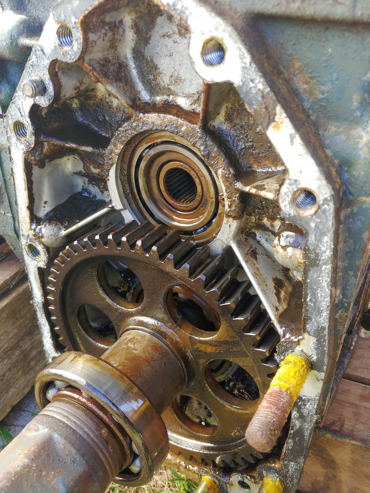

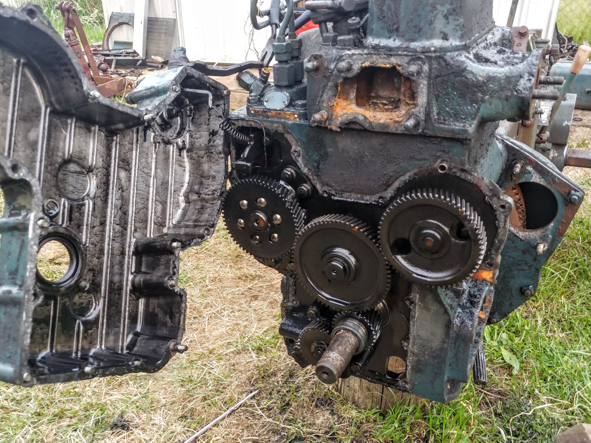

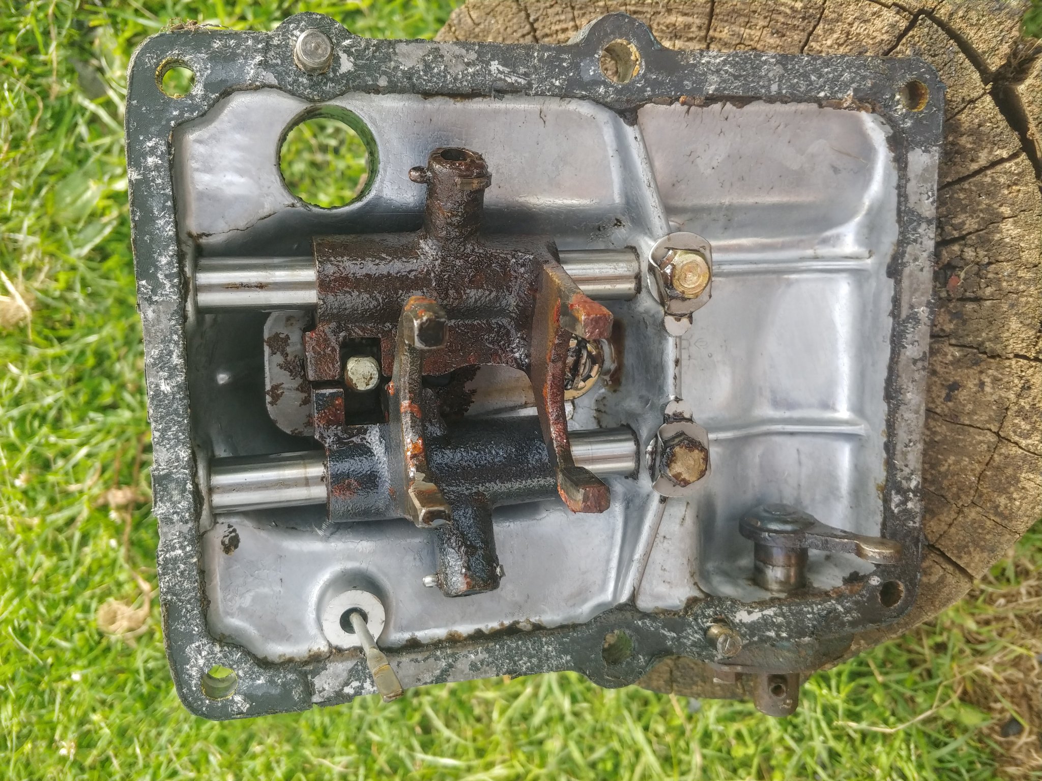

I took the gear case cover off. Mostly to help me get the oil seal out but also to inspect inside and reseal it. It had been taken off before and the original broken gasket was combined with gasket maker. I removed the remains of the original gasket and reattached the cover with gasket sealer only. Everything looked very good except for the lowest gear which I could very slightly wobble. I forgot to inspect that further though.

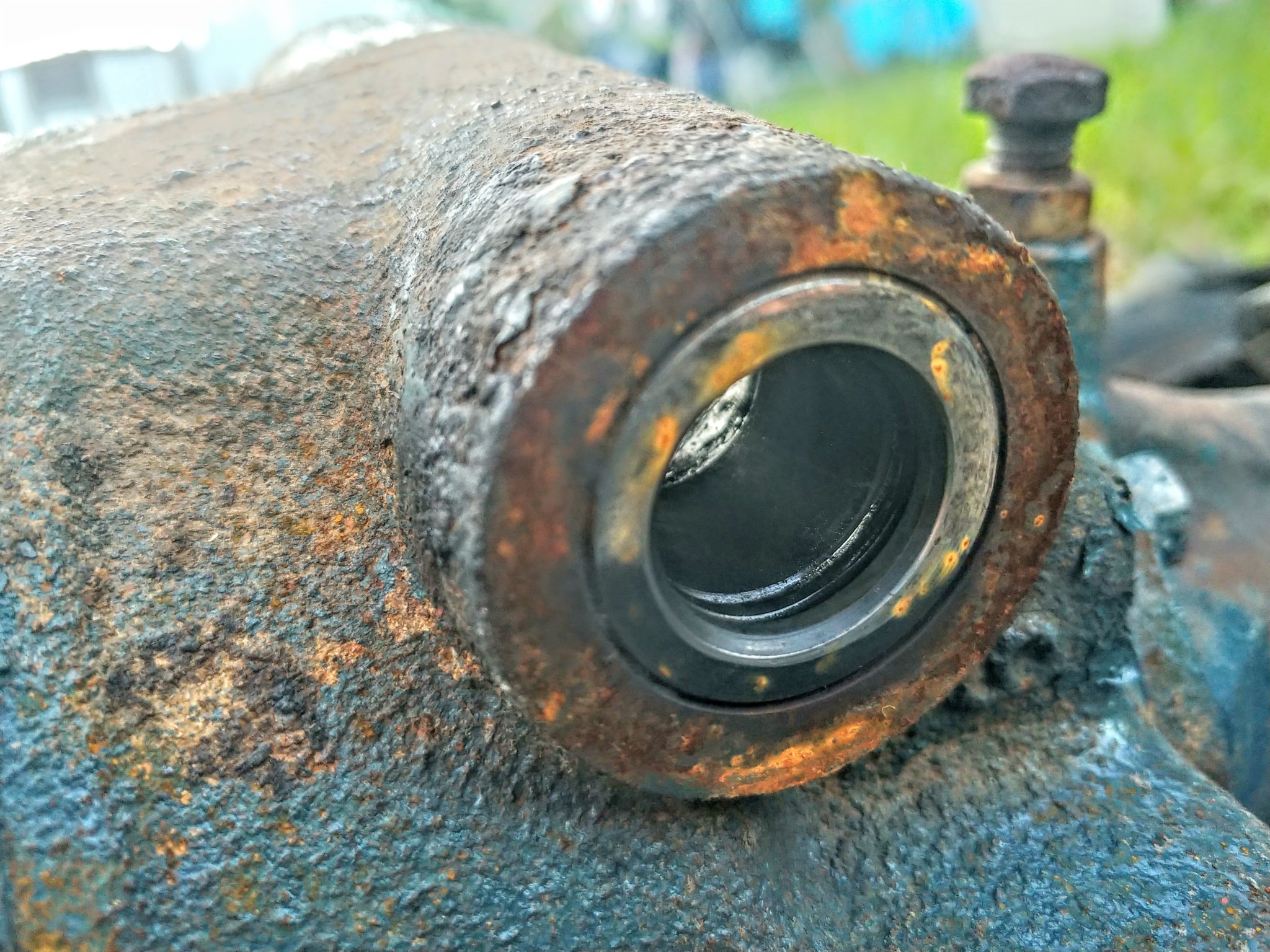

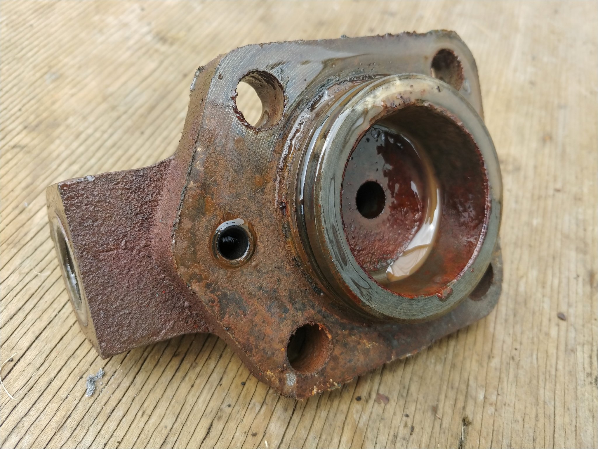

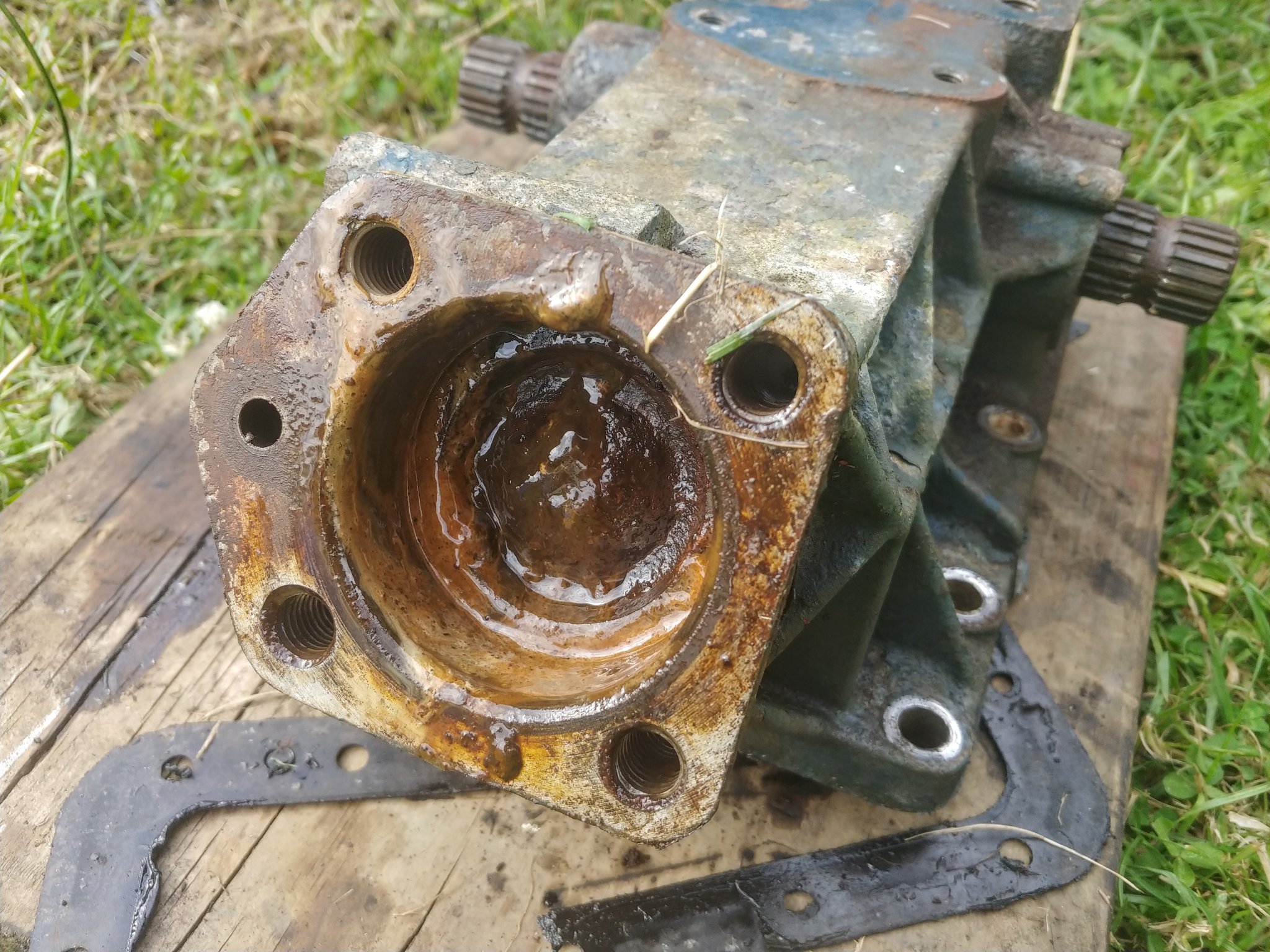

Yesterday I removed the piston cover/aux hydraulics connector. There was a lot of gunk inside. The small o-ring on the hydraulic inlet on the cap is about 7mm ID x 11mm OD x 2mm thick.

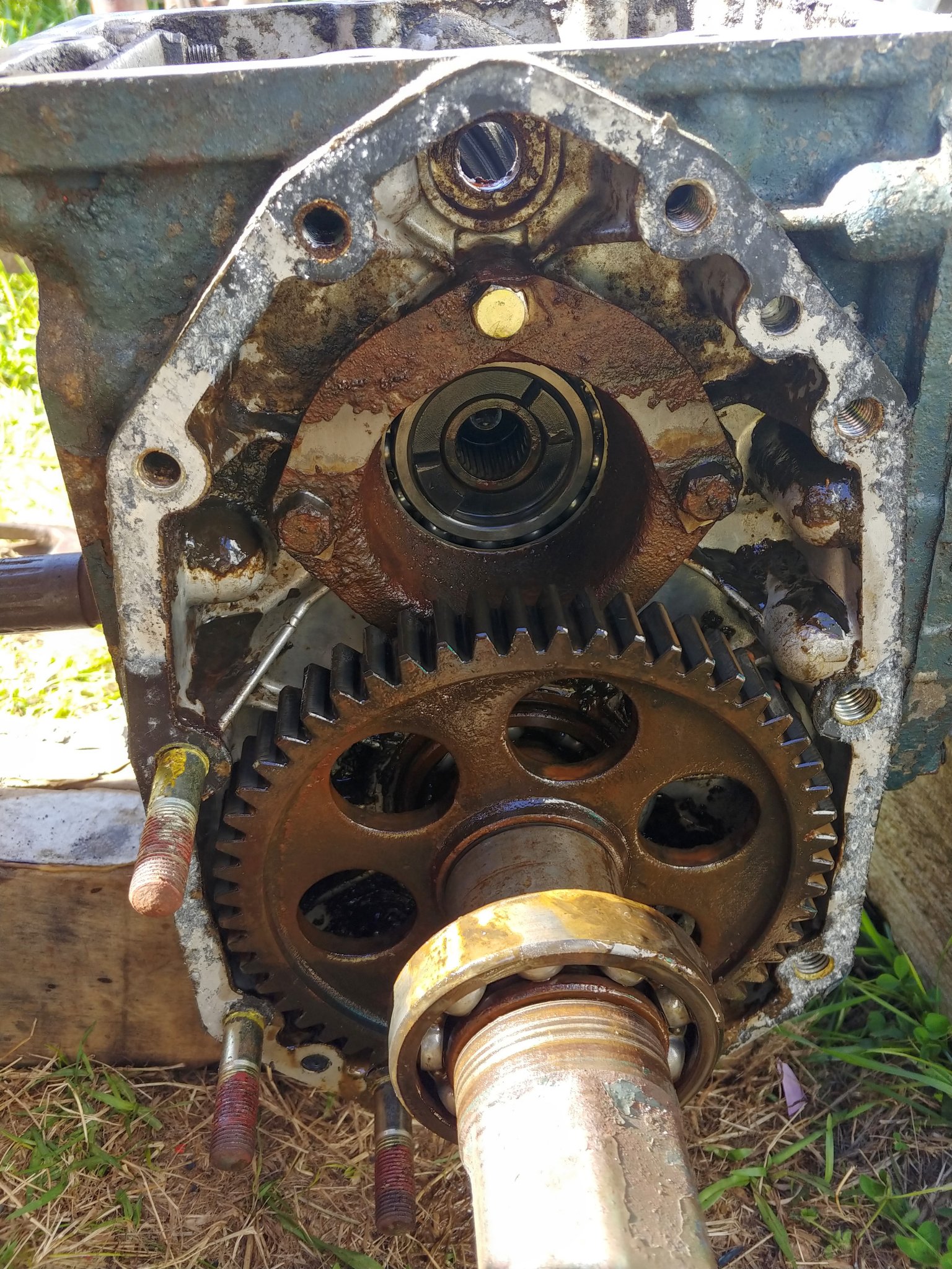

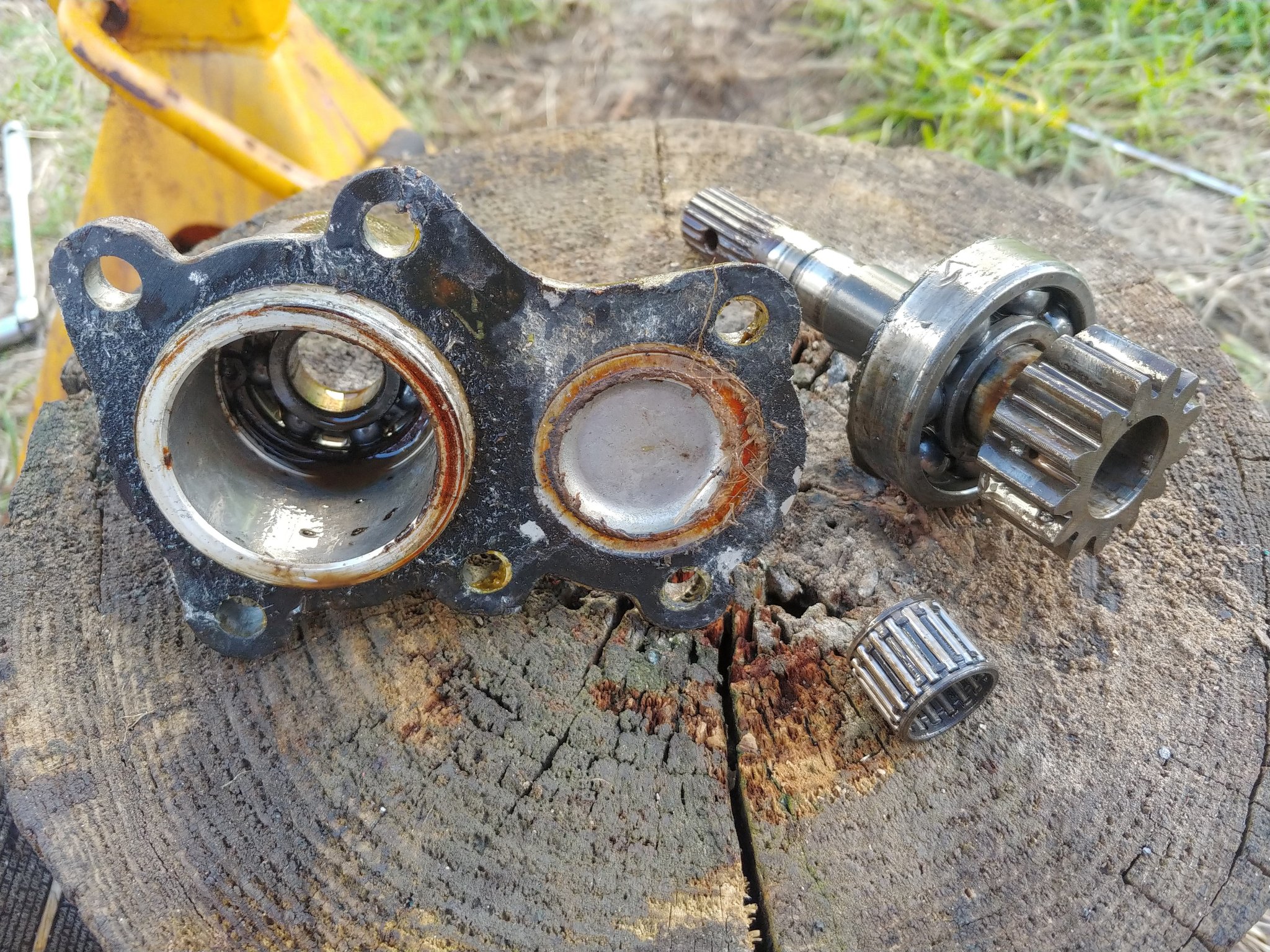

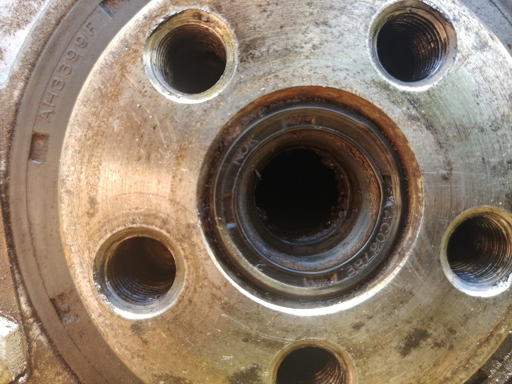

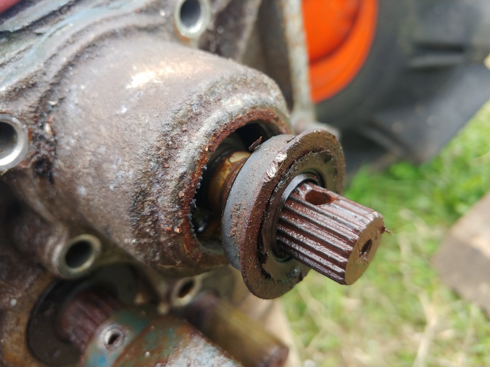

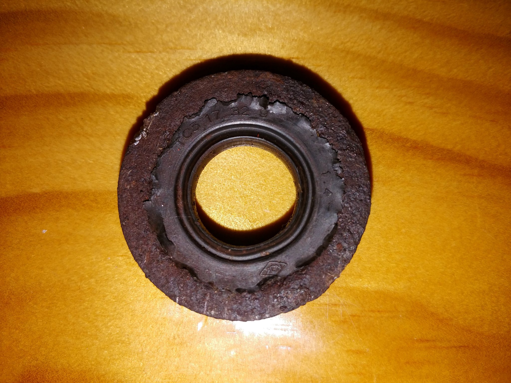

I also removed the cover and oil seal from the rear PTO. The oil seal is 25x38x7mm.
I went to Waitemata Hydraulics and Bearing supplies, Repco and Mitre 10. Waitemata Hydraulics supplied me all the o-rings and bolts I needed. I also got some hammerite blue paint to try. I was going to buy some castle nuts for the rod ends/heim joints on the steering but they were $32 each (!) so I left it for now. Maybe I'll obtain them on eBay. I also bought some new hydraulic plugs to replace the rusted ones.

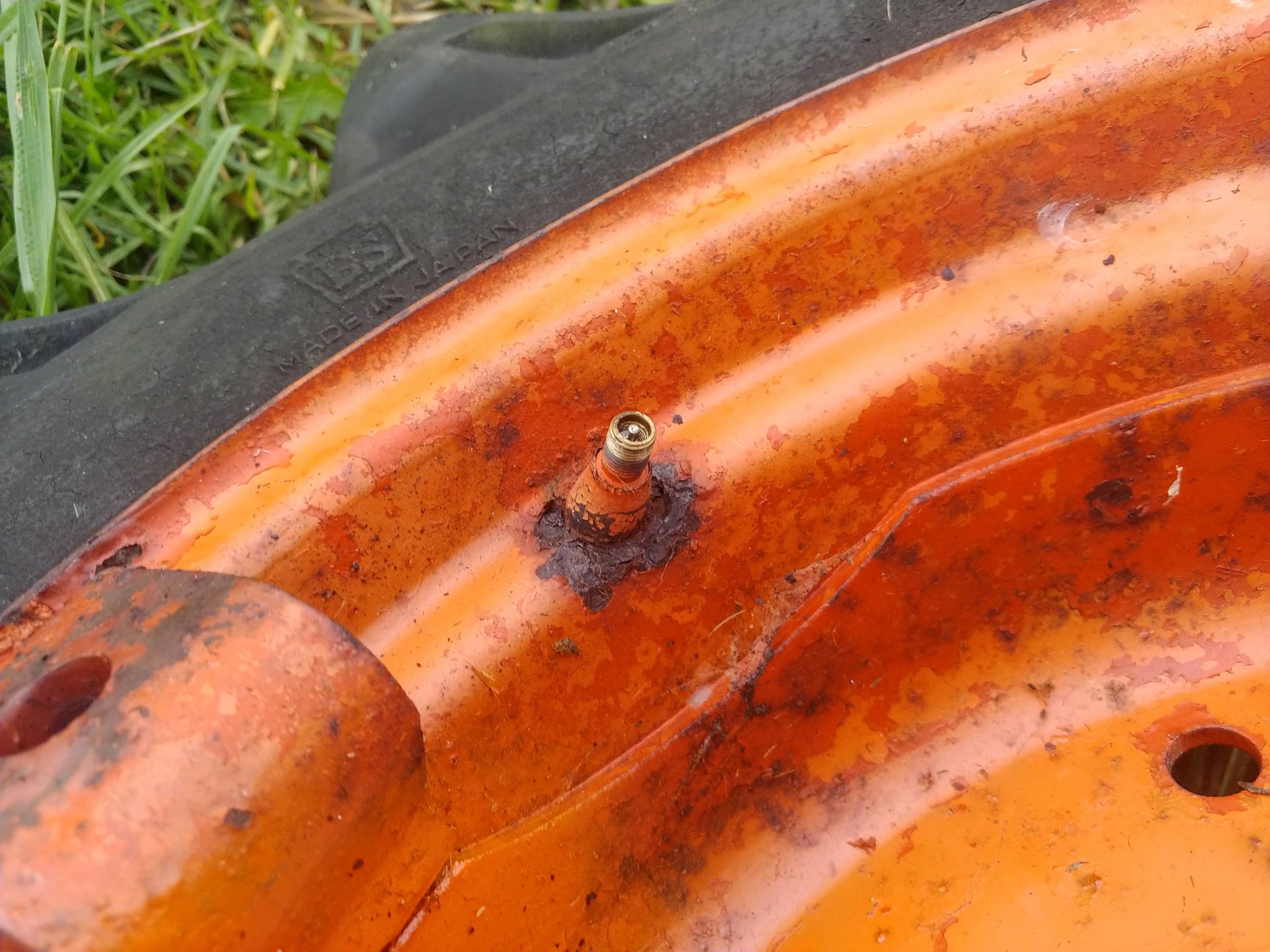

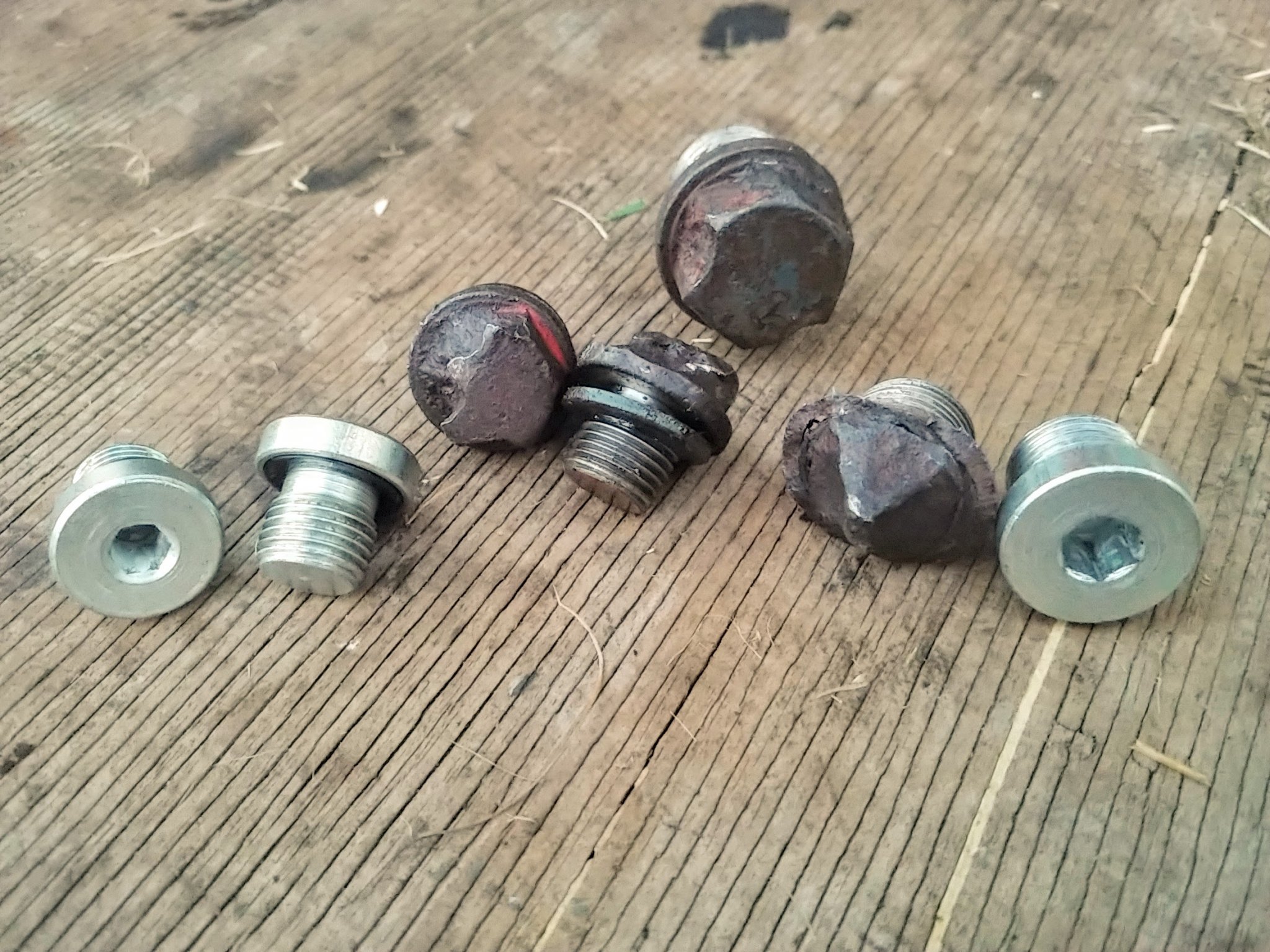

The new small plugs for the rear wheels are part B04INT 1/4" BSPPM captive seal plug. for $11.17 each. The middle size plug that goes opposite the bottom hydraulic hard line under the chassis is 3/8" and is $15.08. I didn't end up getting the large plug which is for the aux hydraulics near the piston as it was $22 and the old one is still usable. The seals in the new plugs are a bit different. instead of a steel washer with a rubber seal on the inside, they have a groove in the head and a flat rubber washer that fits inside.
At Bearing Supplies I got some more oil seals and a new bearing for the tensioner pulley. It was stock code C6203-2RS, ID 17mm, OD 40mm, width 12mm. I'm not sure if this is the original type. There were some shim washers stuck inside that were bent into a cone as well so it looks like this was replaced before.

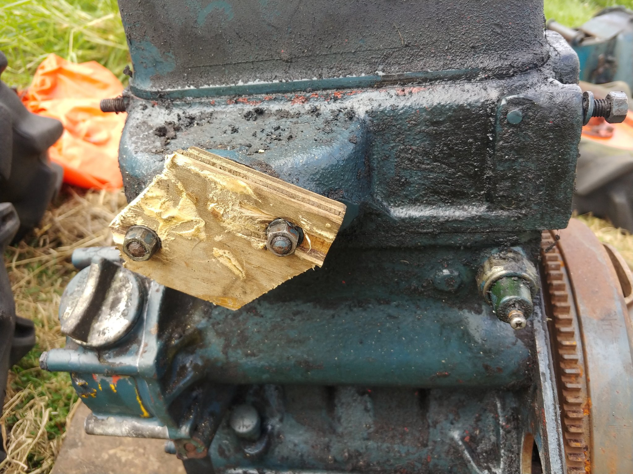

Here are some of the results of testing the paint I bought. The Rust-Oleum real orange is quite a bit more yellow than the redder orange on the engine cover. However I think the orange colour on this tractor has been repainted, possibly with the new kubota orange colour instead of old. The older colour beneath seemed more similar to the one I bought.
On the rear wheel almost all of the most recent coat of paint has flaked off. The paint I bought is actually a pretty good match for what I'm assuming is the original orange paint, just not so faded.

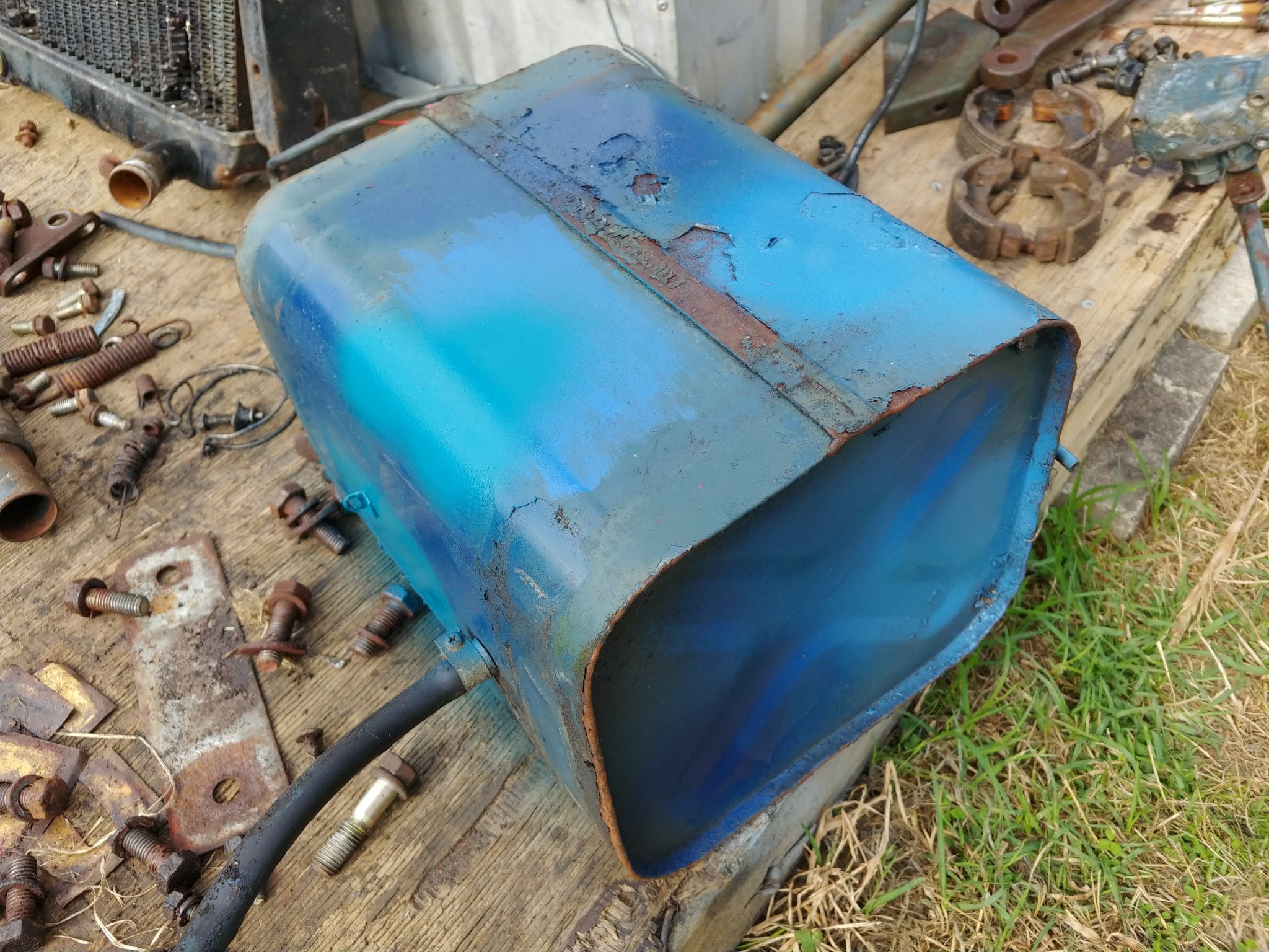

None of the blues were a good match. Top on the fuel tank with the brush strokes is Hammerite smooth blue. Dark blue is Plastikote pacific blue. the lighter blue on the right is Plastikote mediterranean blue. And the teal on the left is Rust-Oleum deep teal. I'm pretty sure the blue paint on this tractor is original. There are some kubota matched spray cans available at a few places here. But all about $40. I might just have to bite the bullet and go for one of those. Probably would have been cheaper than buying lots of low cost cans. But maybe I'll do a primer and first coat with different colour for now.

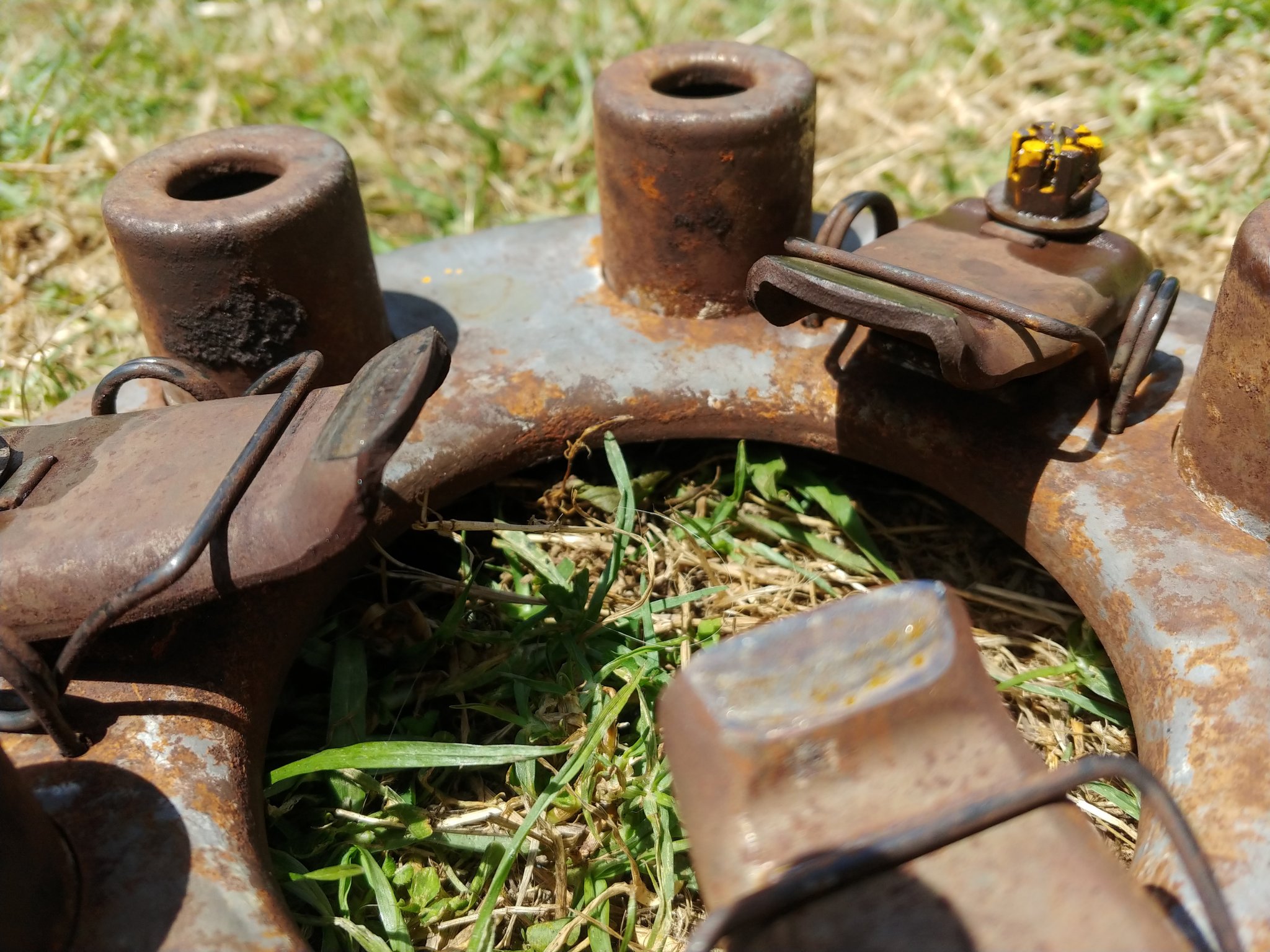

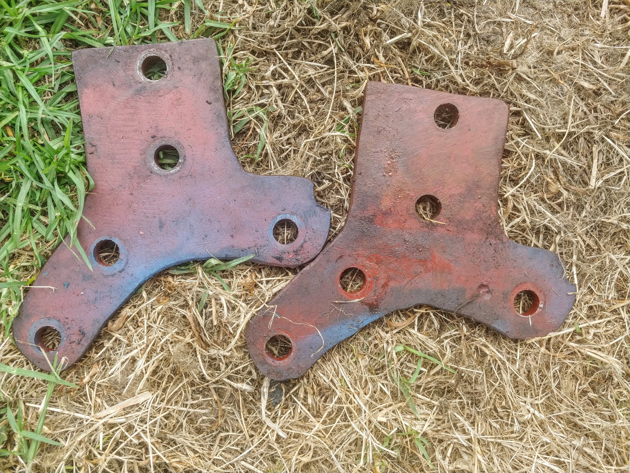

Here are the brake arms with Wattyl Killrust sungold yellow on the top and White Knight rust guard golden yellow on the bottom. Both are a bit more yellower than the original colour that was more orange. But they will do for now and can be overpainted later. The bottom one looked better and more glossy.

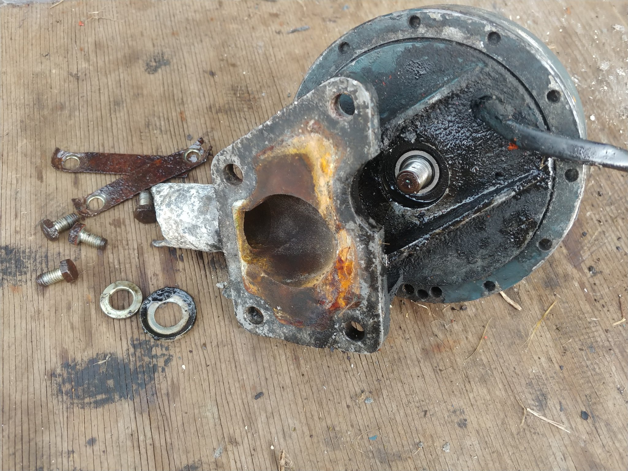

I removed the hydraulic lever. I'd recommend not pushing the lever too far - the ball bearing and spring will pop out as seen in the photo.

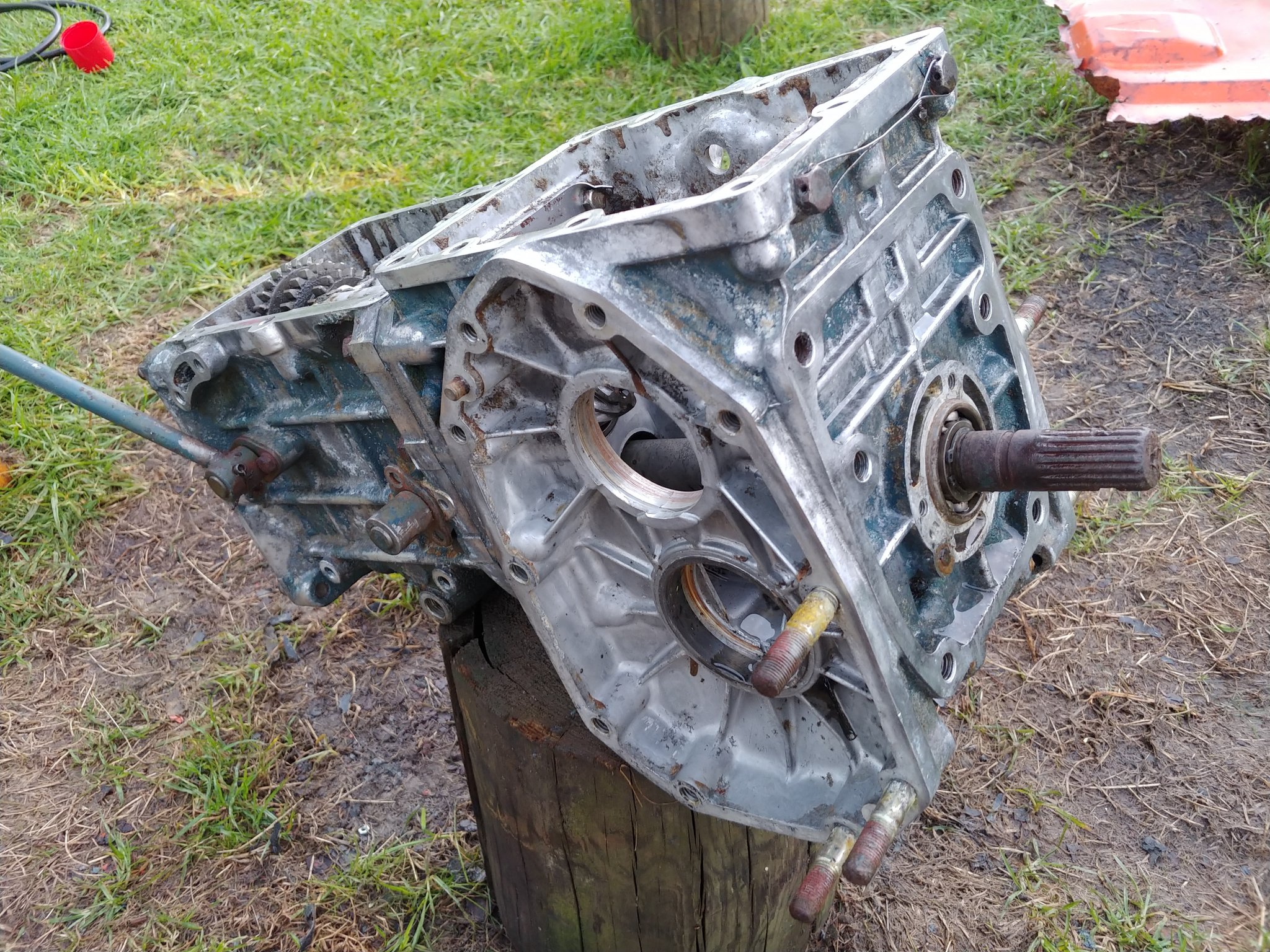

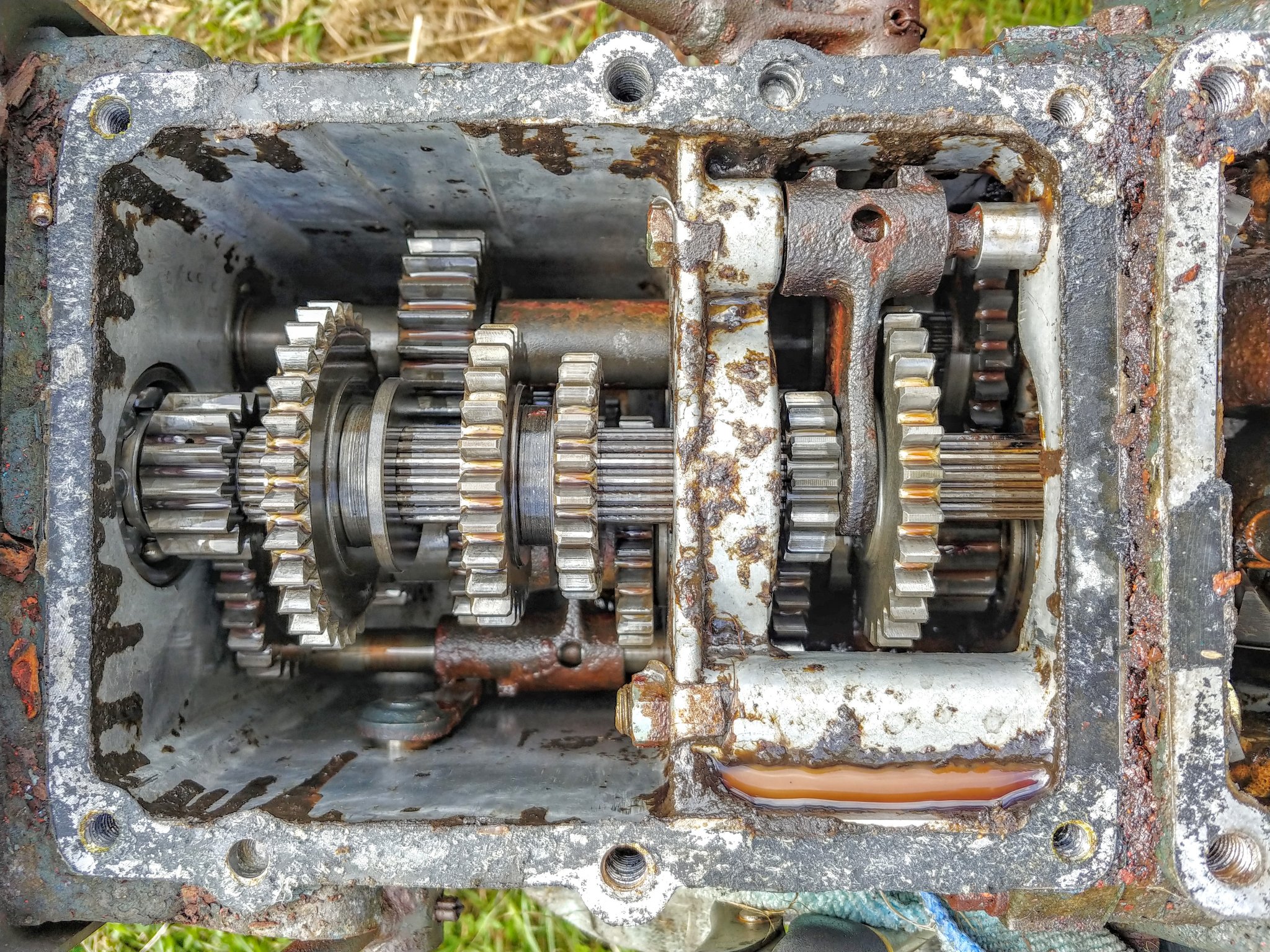

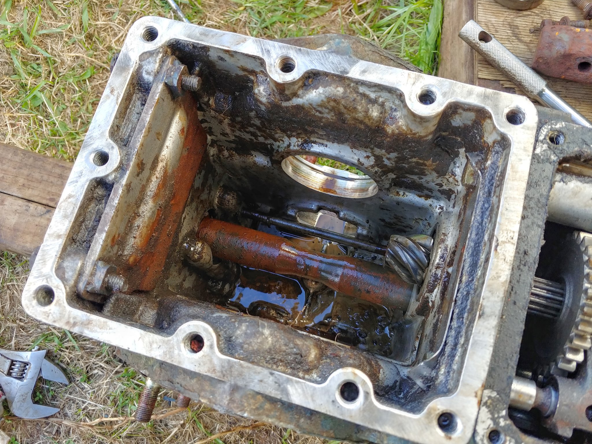

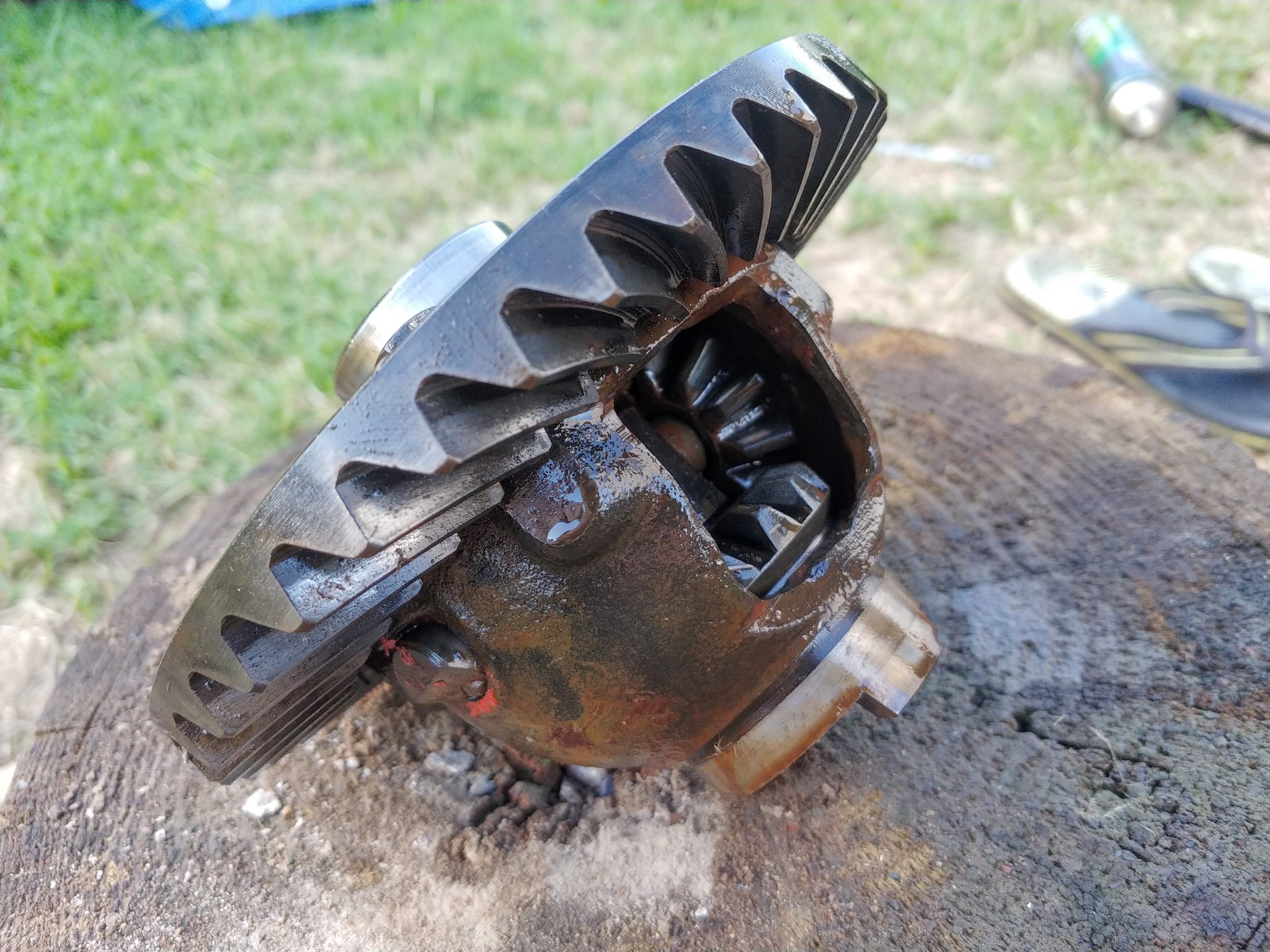

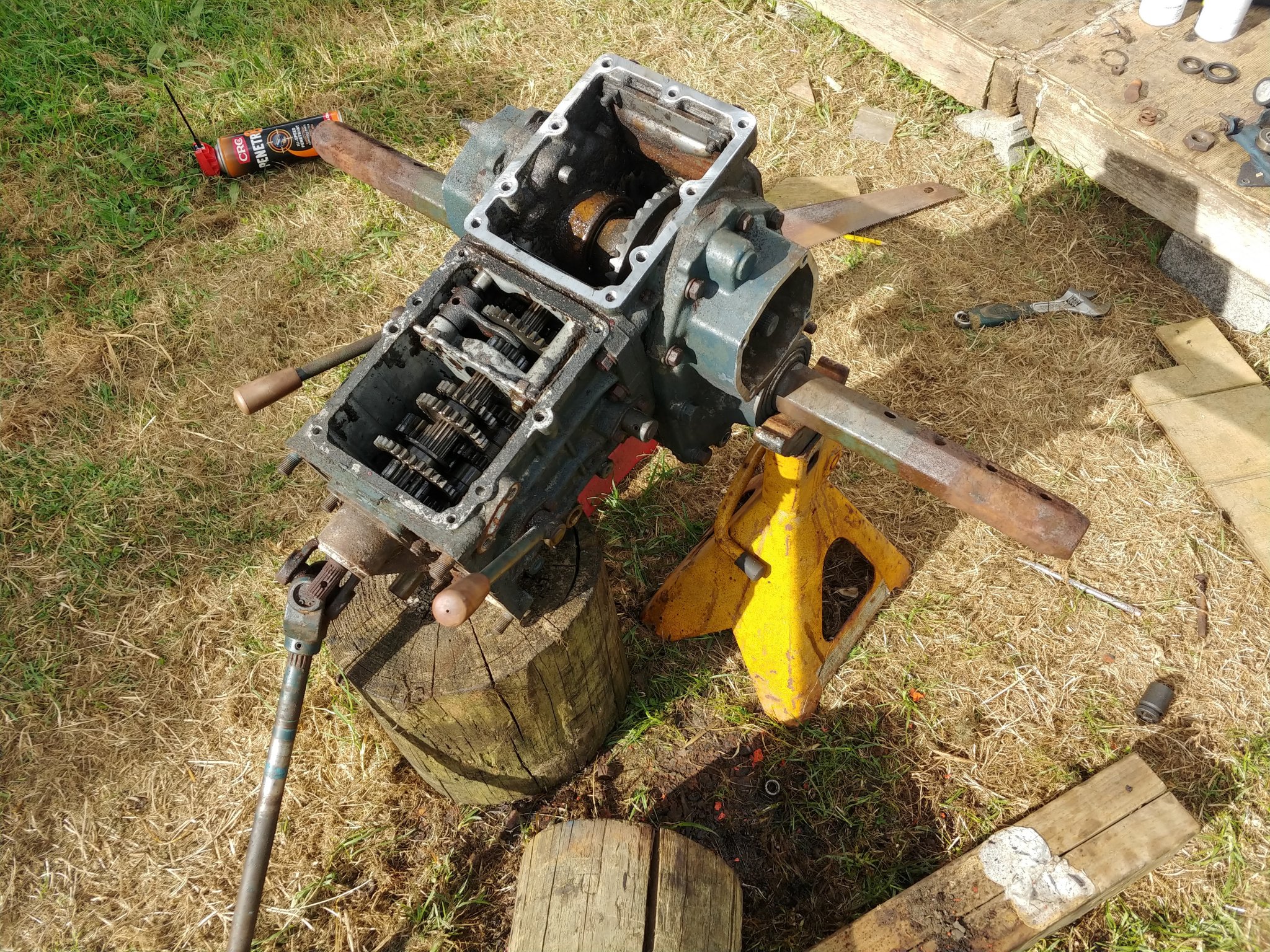

I then removed the diff and transmission covers. The gears look like they're in very good condition. But there's a lot of gunk and a bit of rust in the diff. I think this is because the oil is mostly circulating in the transmission and the oil in the diff is a bit more stagnant. I think that when I'm ready to put the covers on, I might water blast it, put some evapo-rust in, rinse out with water, use a water displacement spray and then immediately fill it with oil.

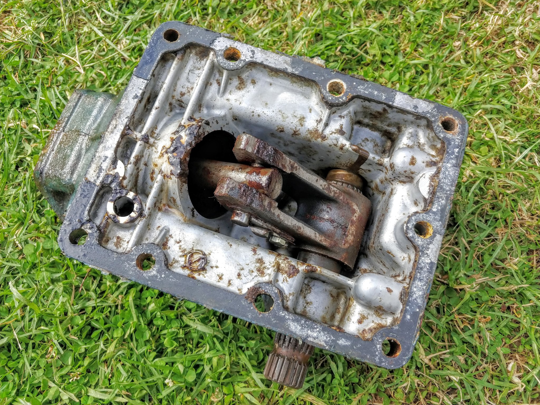

Here is the gear shifter. The rubber boot was there but was damaged so that might be how some of the water got in. Not sure if it will be easy to find a generic replacement in the right size.
This is the hydraulic piston for the lift arms.
That "extra lever" actually does move a gear back and forth on the PTO shaft. But it seems to be unable to lock into a different position as the gear rubs on something. I can't see what it does as it's at the very bottom and I don't want to disassemble the trans any further. Maybe it's not supposed to move. But then why add all the internal actuator components and gear? Both the parts book and the service manual are too low resolution to see anything.

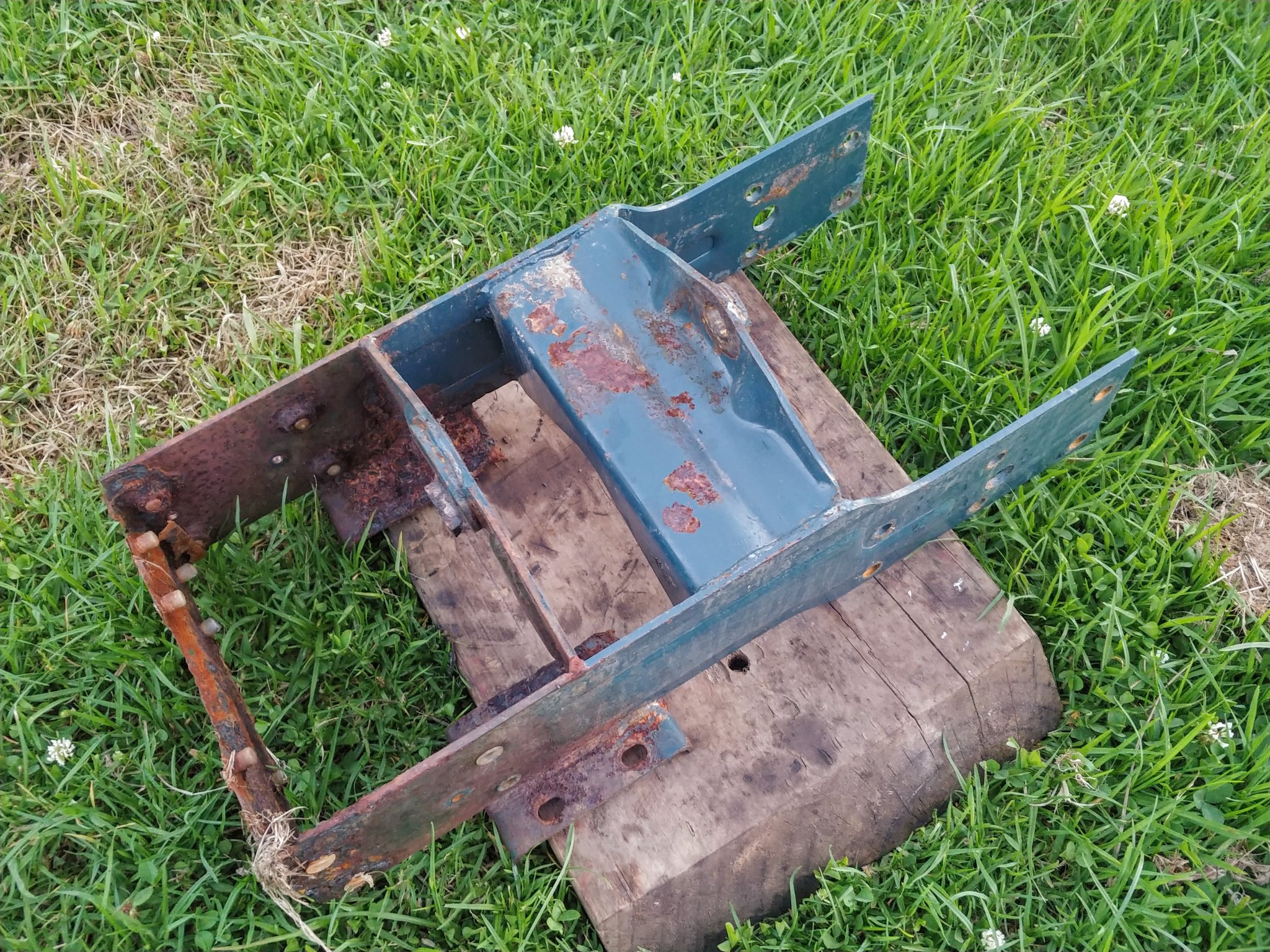

I haven't posted this pic yet, it is the brackets (non-original?) for the three point hitch.

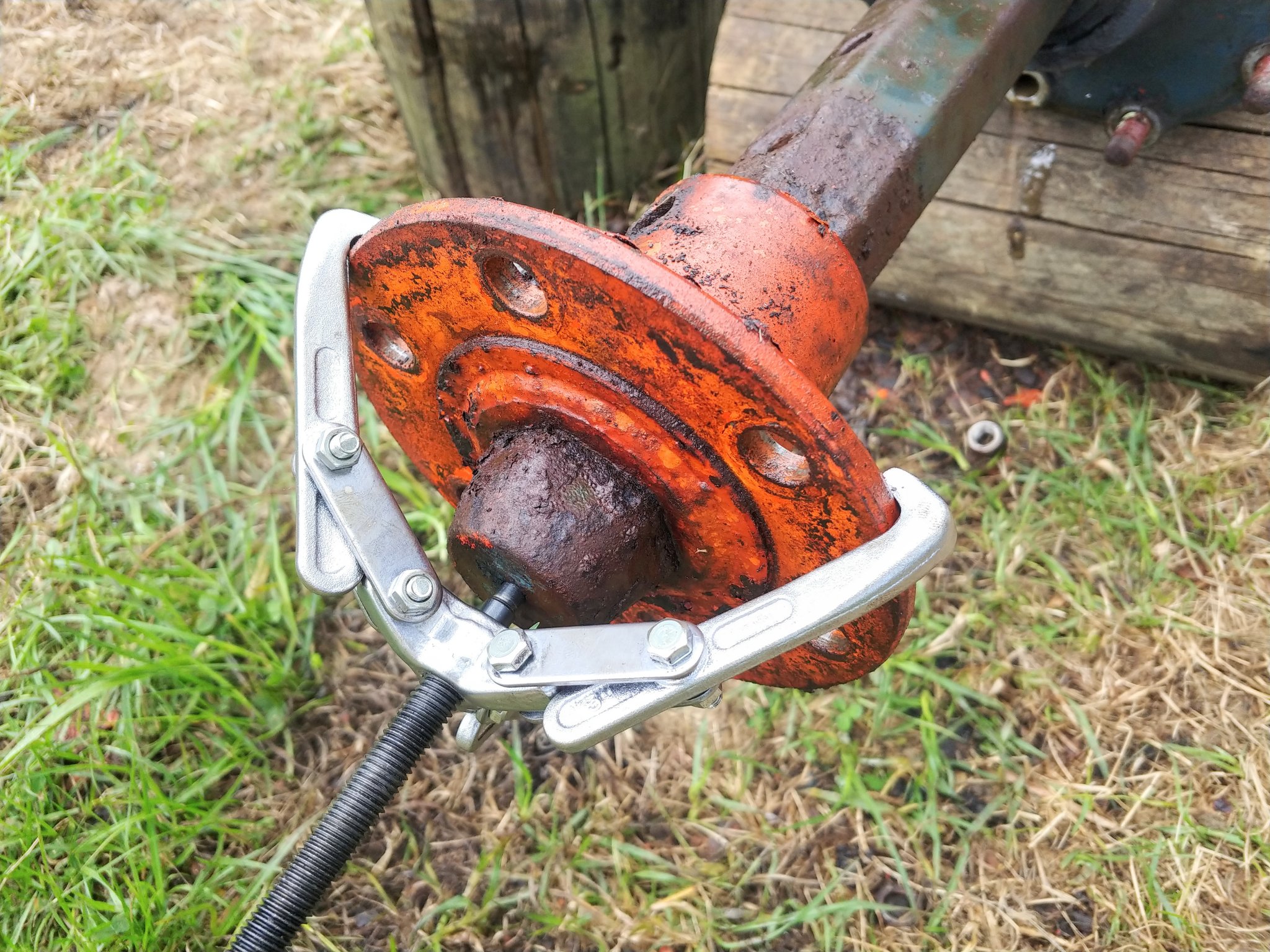

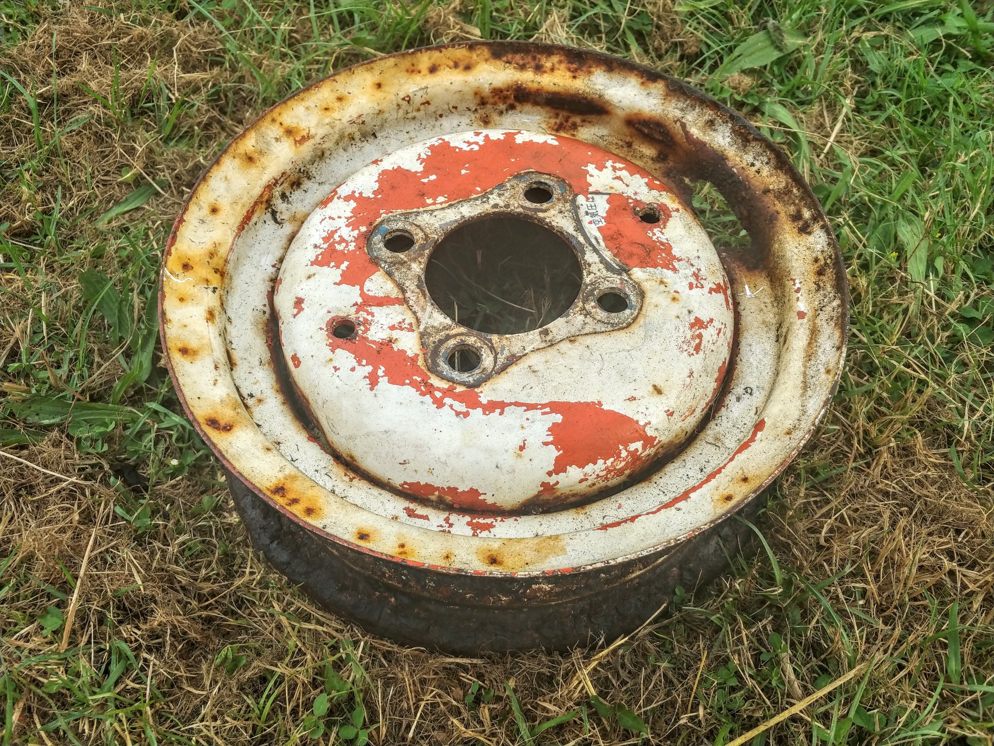

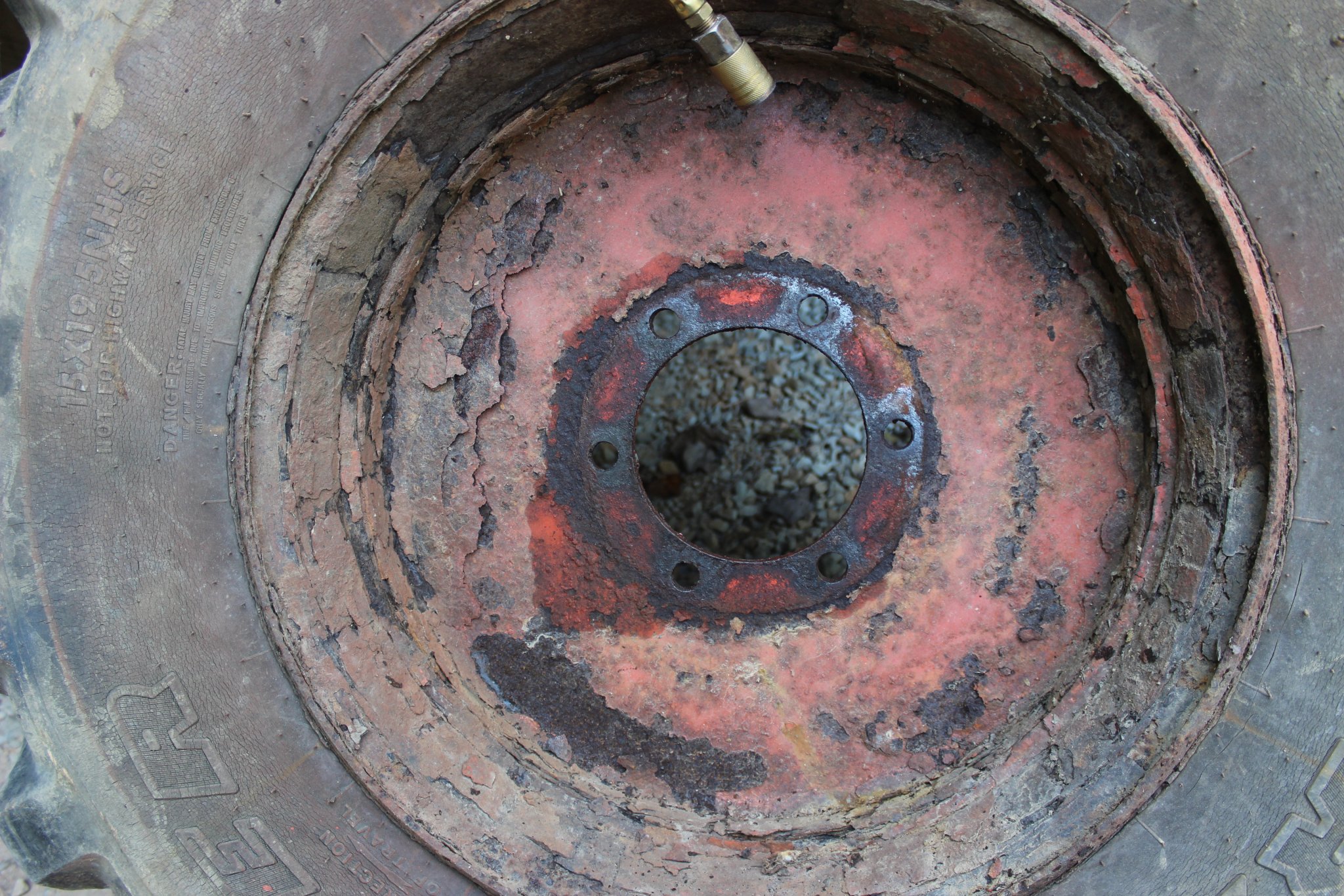

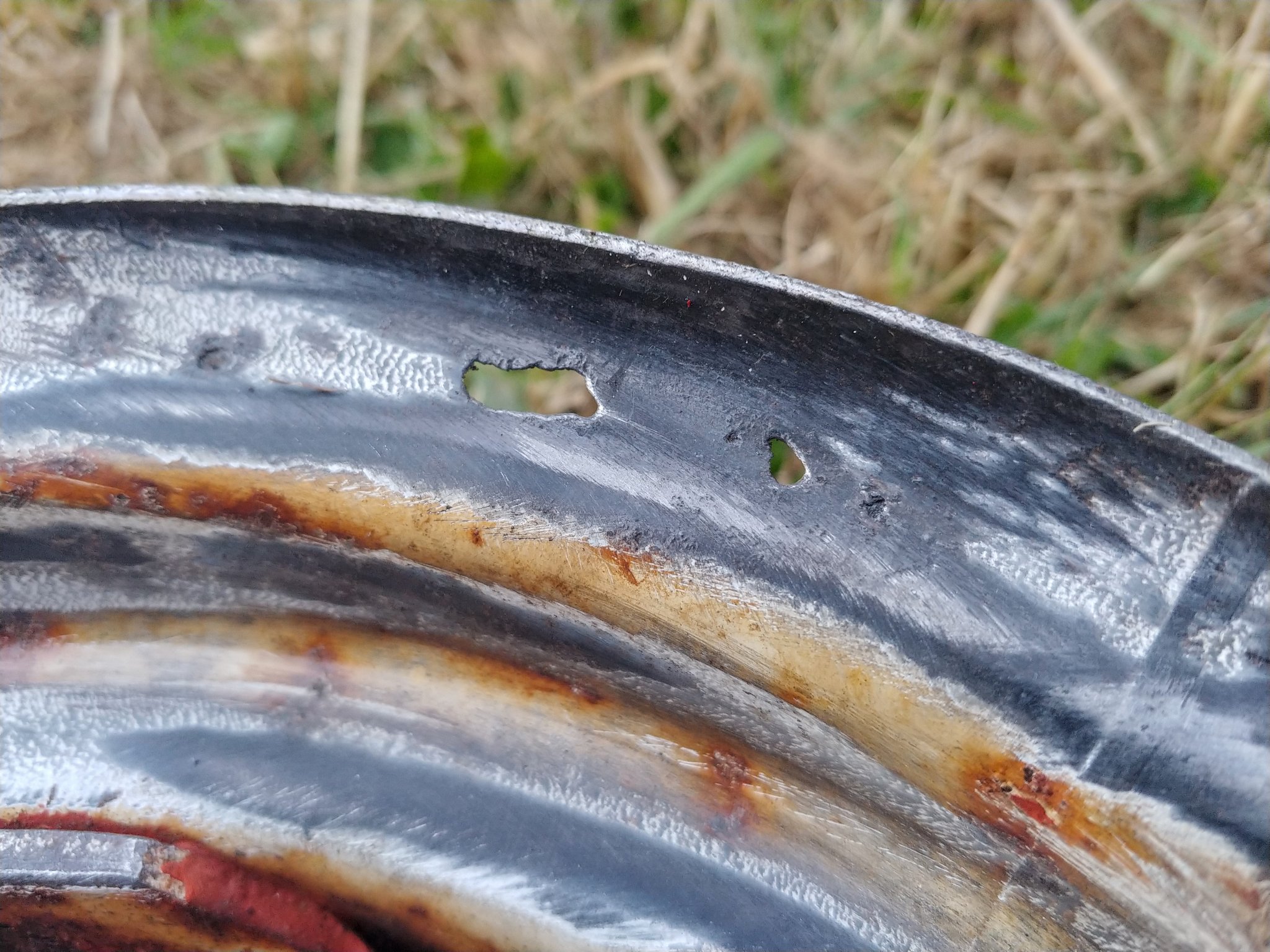

I removed the remains of the damaged tyre from the front rim and wire brushed it. There was actually more rust than I thought. There is a big hole on the inside and more smaller holes that showed up when the rust was brushed off. I know I can fix this but it will be a bit of work. The rim probably won't ever be as strong as it was originally but it probably won't ever be under too much stress.

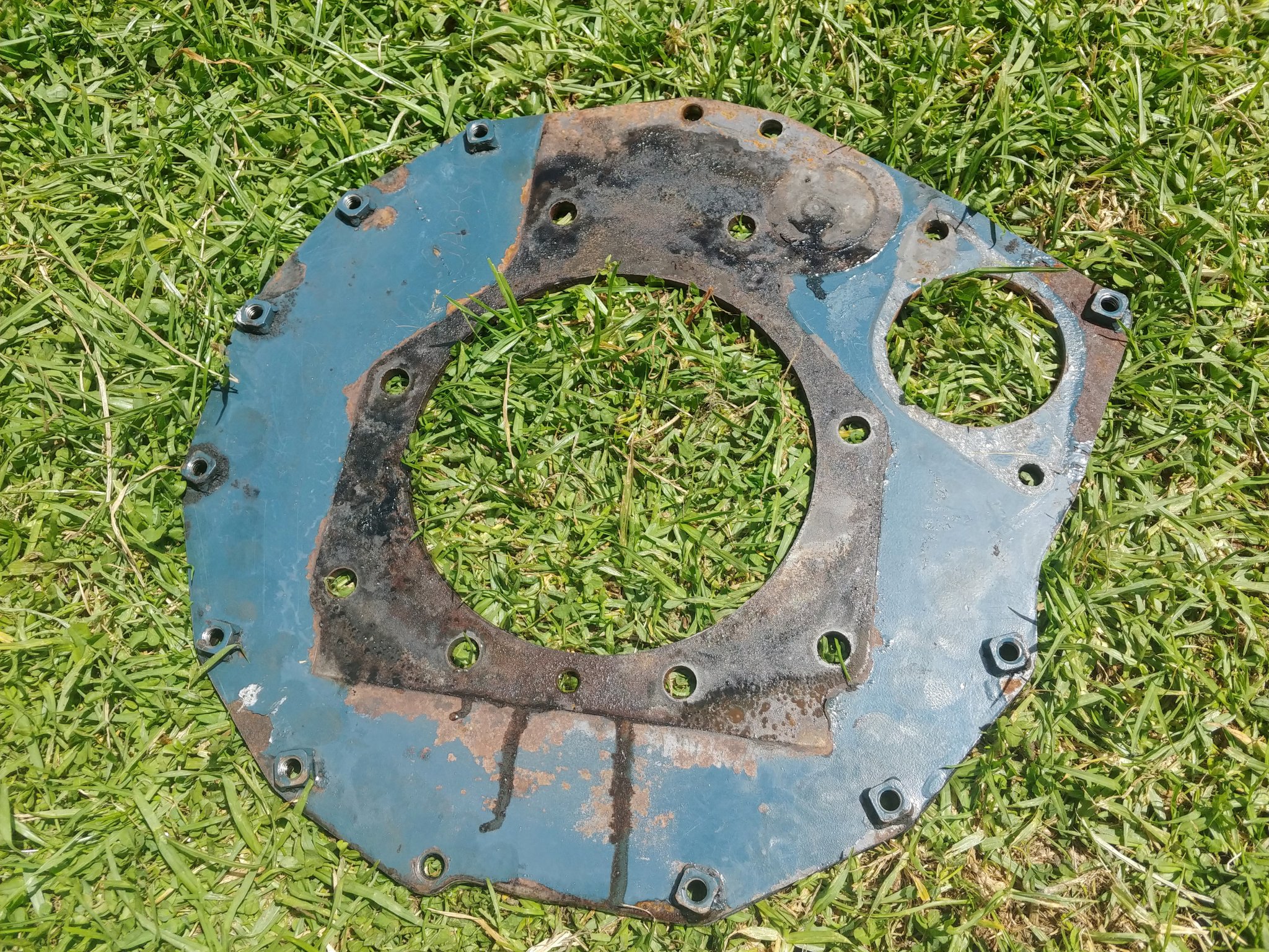

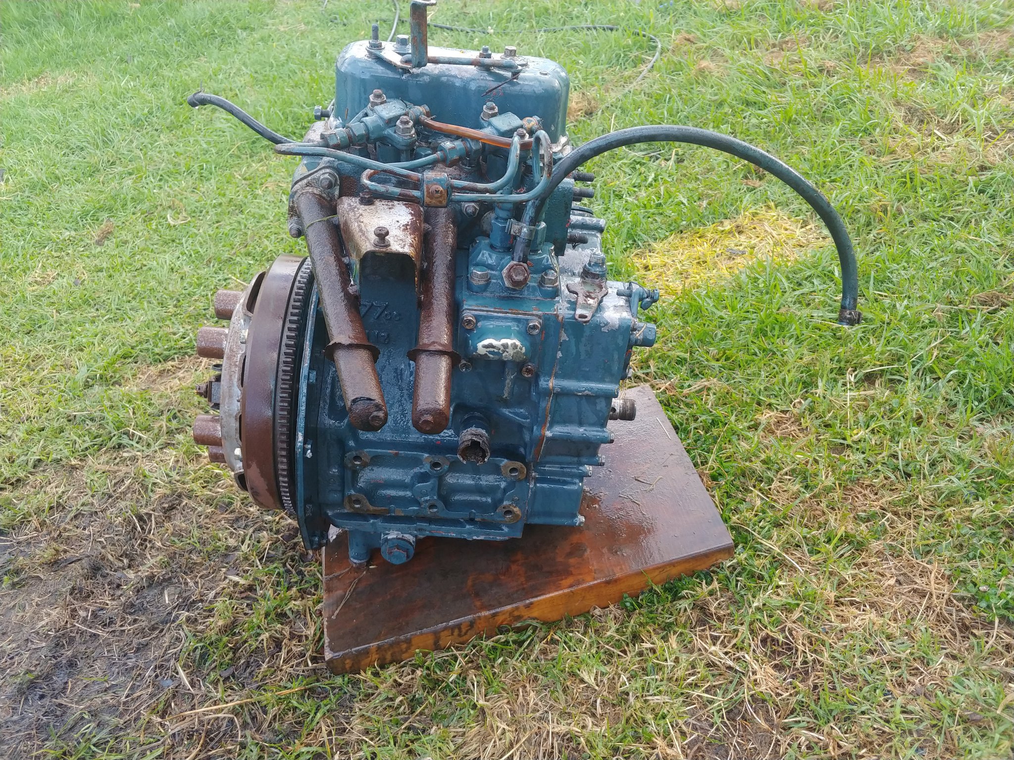

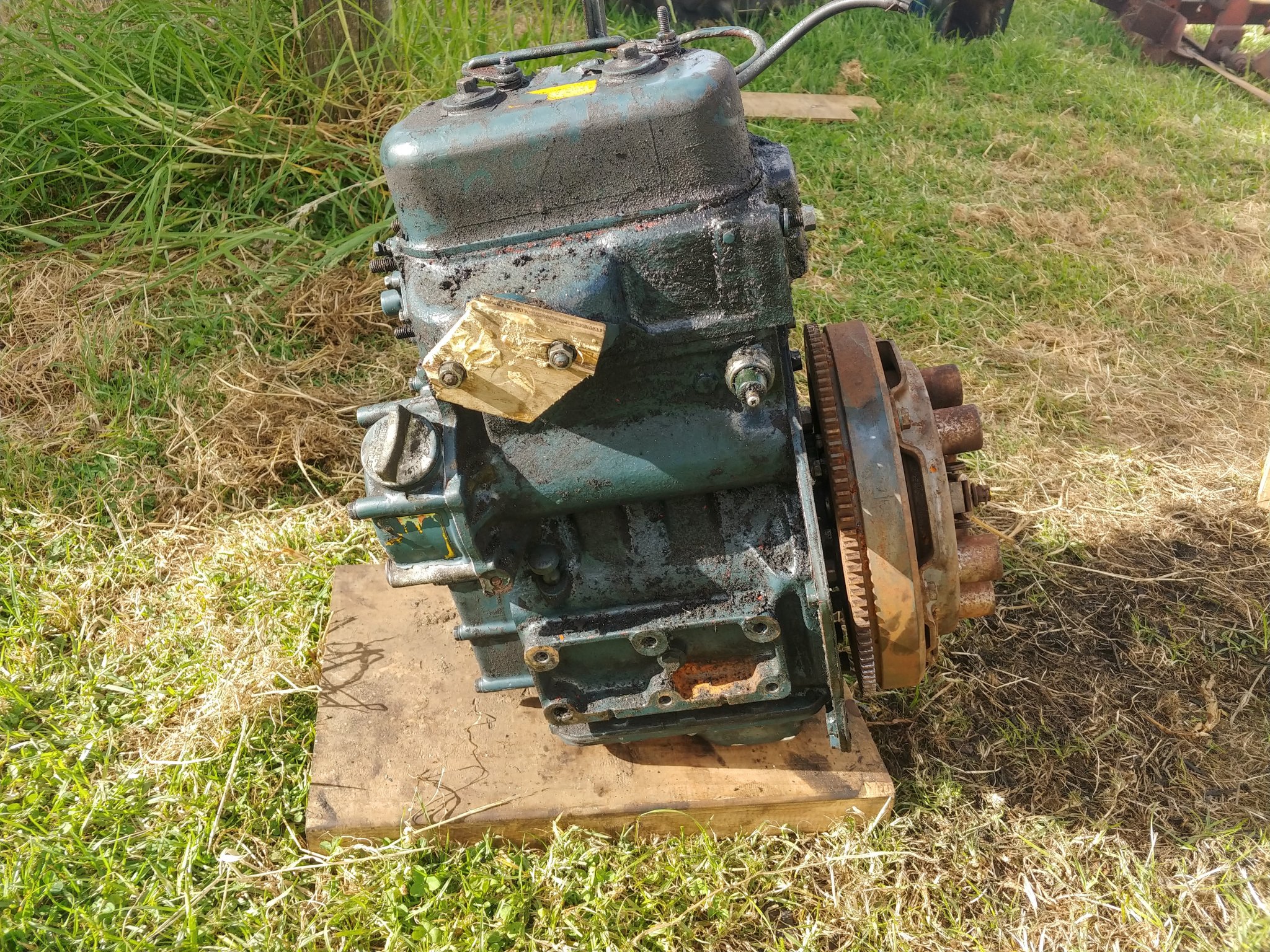

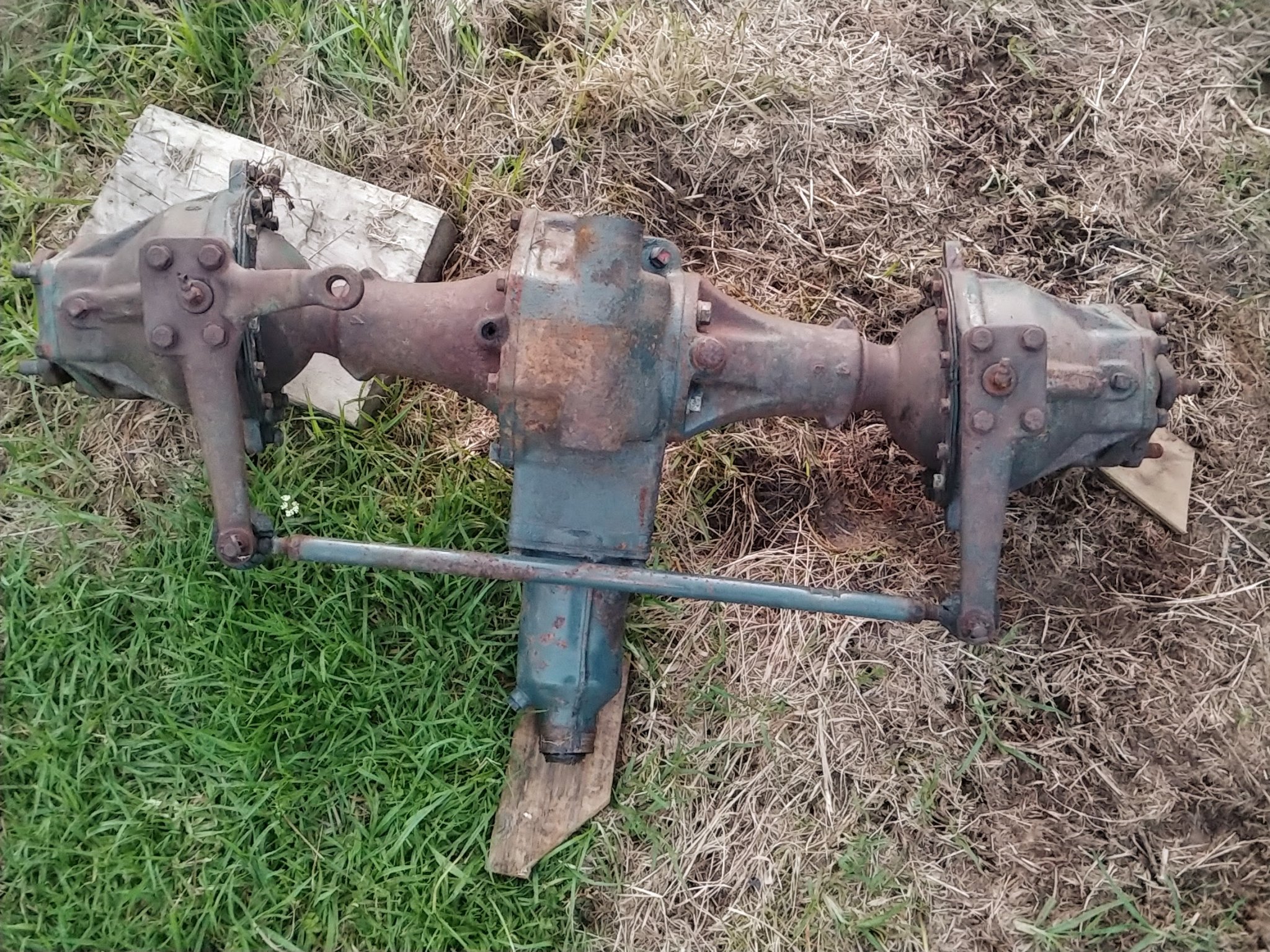

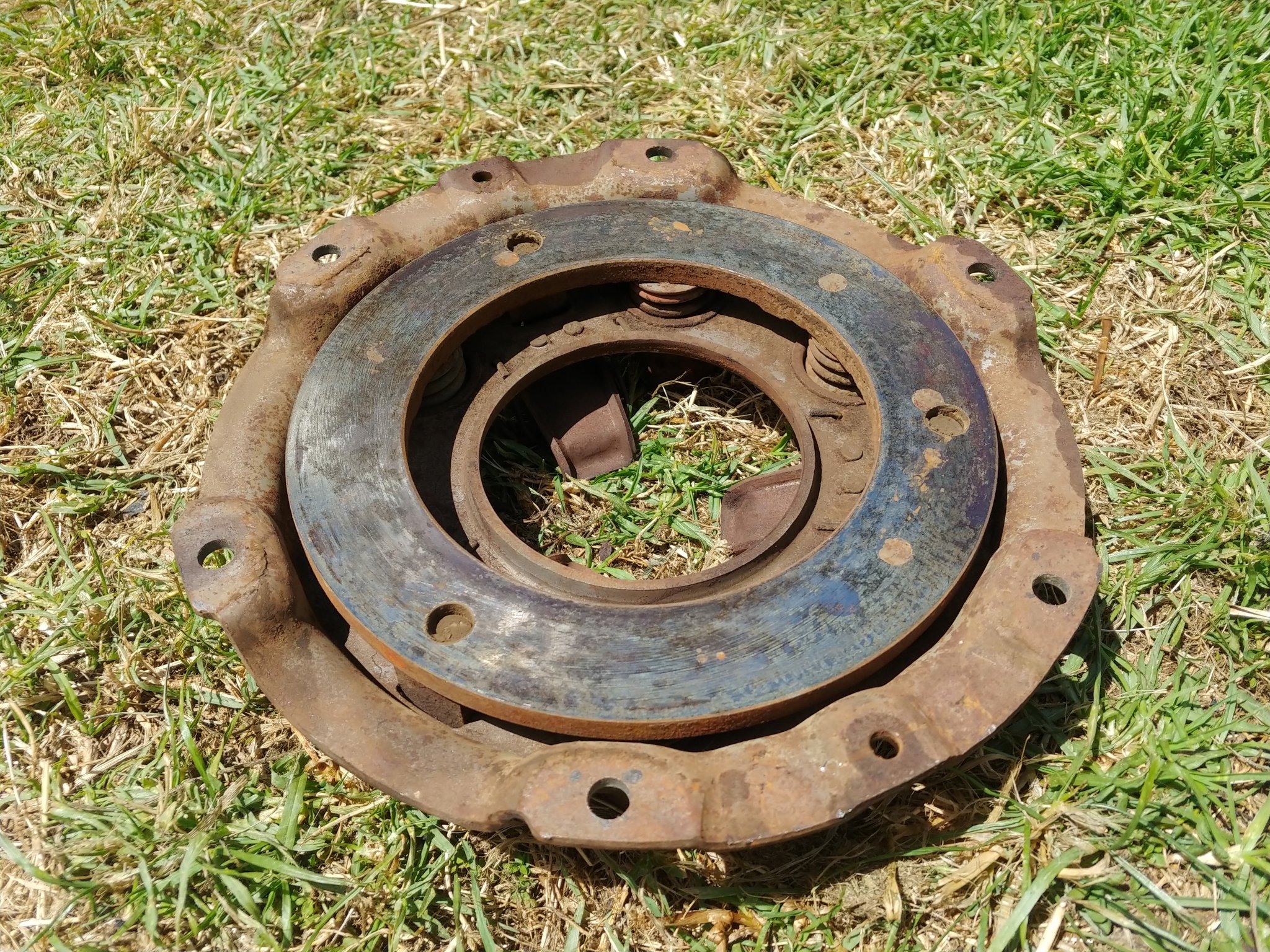

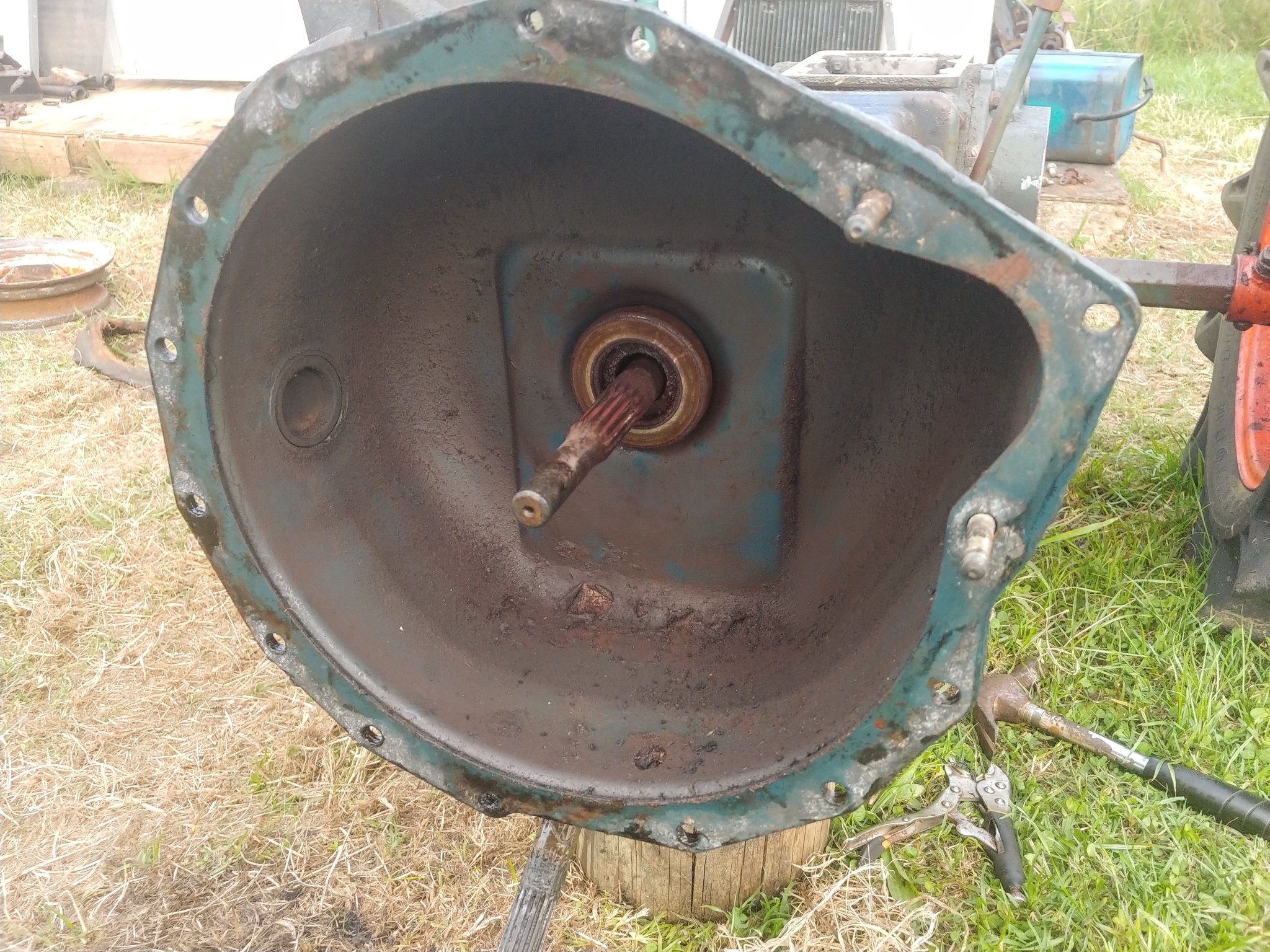

I removed the engine from the bell housing. I then removed the bell housing and main chassis from the transmission.

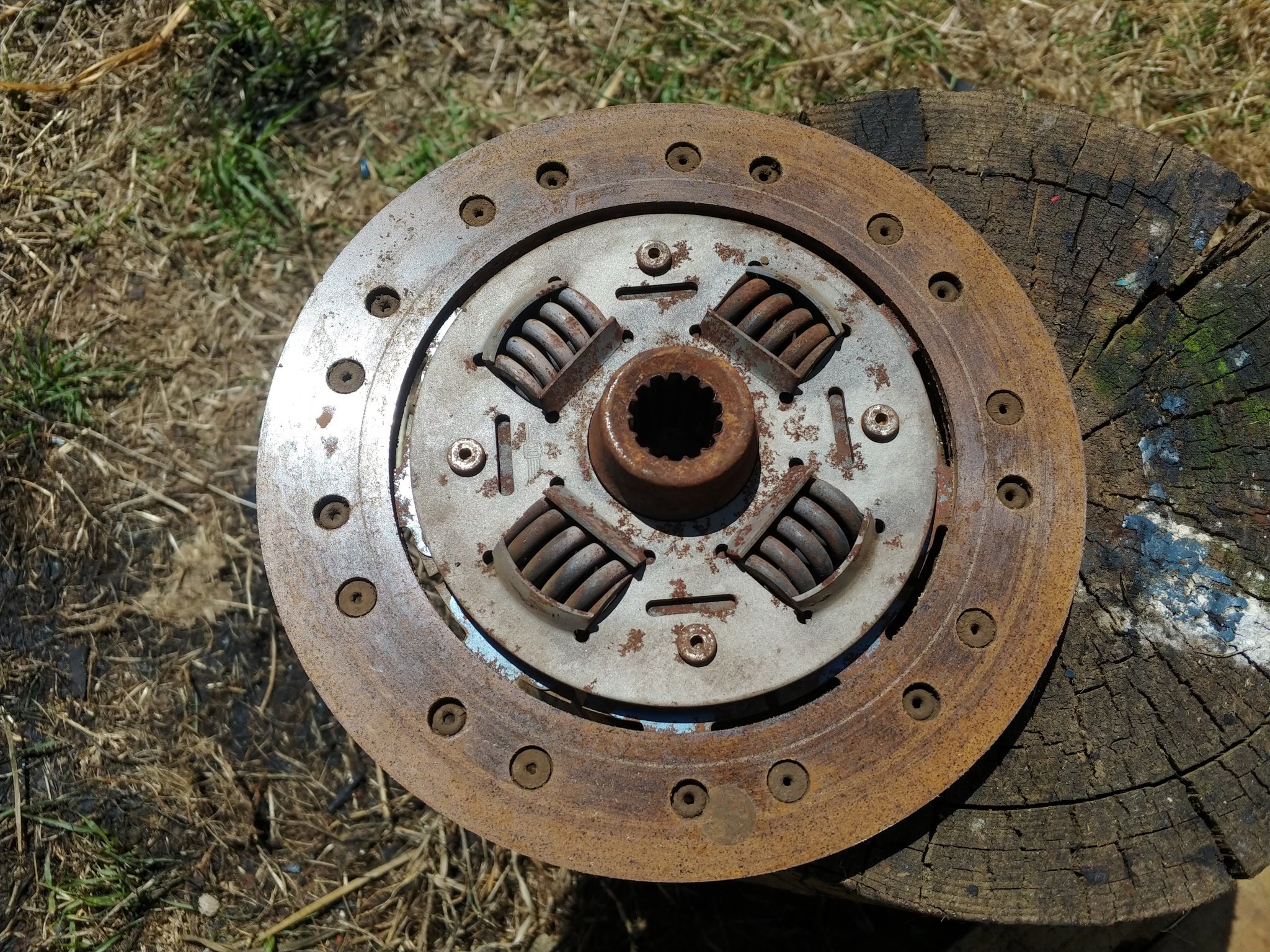

The clutch and bell housing look fairly good. A bit of surface rust. There was a tiny bit of play on the bearing that presses the clutch but I think it's not worth replacing. I wonder whether it would be ok to submerge the whole clutch assembly (if I can take it off) in Evapo-rust?
There's a bit of corrosion on the transmission and several seals that need replacing. Interesting that there's a PTO shaft here that can be connected to. Maybe for a centre mower deck? But not sure how it would go through the chassis.

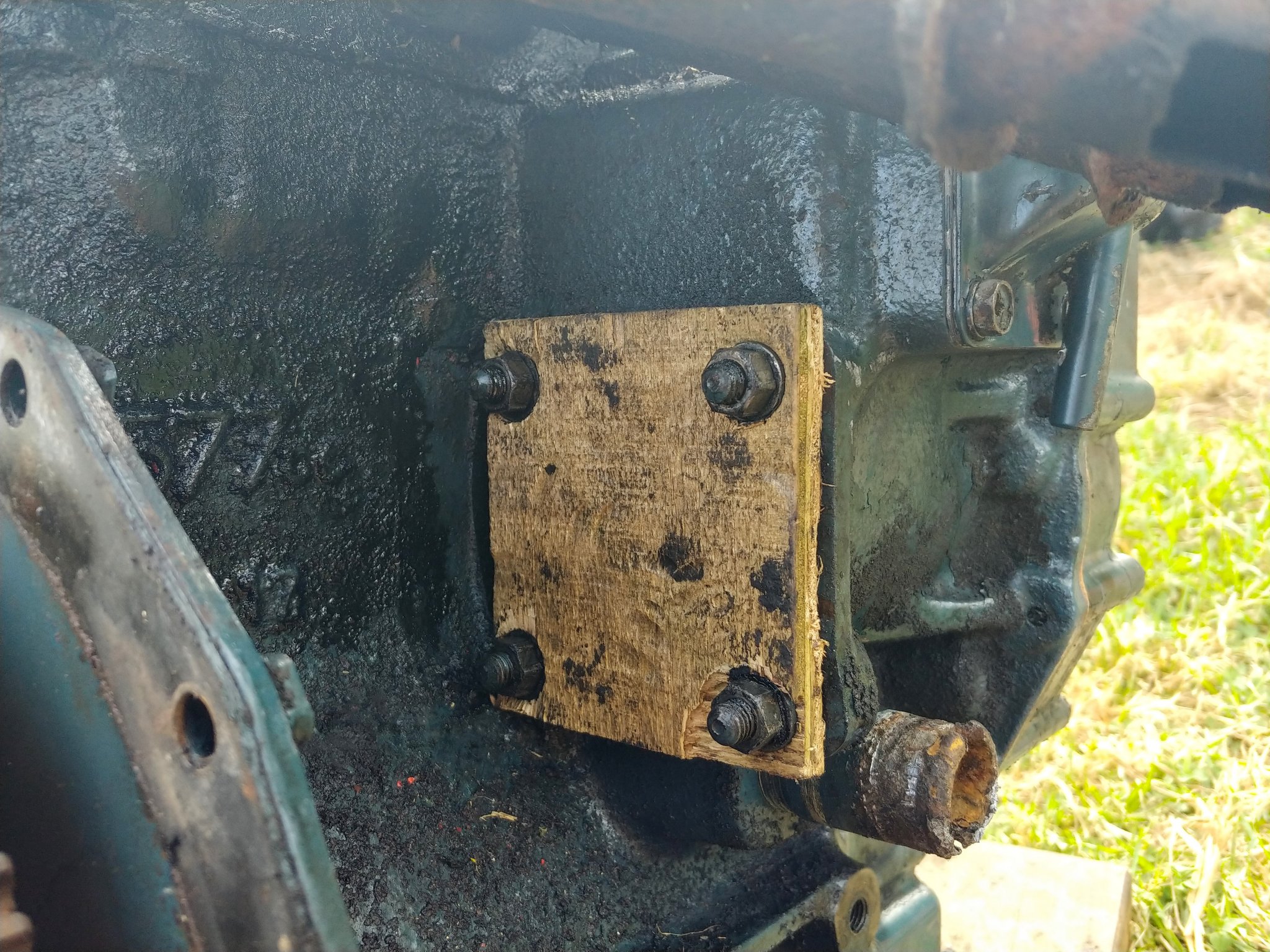

The chassis is quite rusty inside. I think it may be missing covers for the access holes? Edit: no, one of the holes is for the front wheel drive. Maybe the other is for a mower? I think there were bolt holes for a cover around at least one of the holes.
There's a seal on the front wheel drive shaft cover that needs replacing.

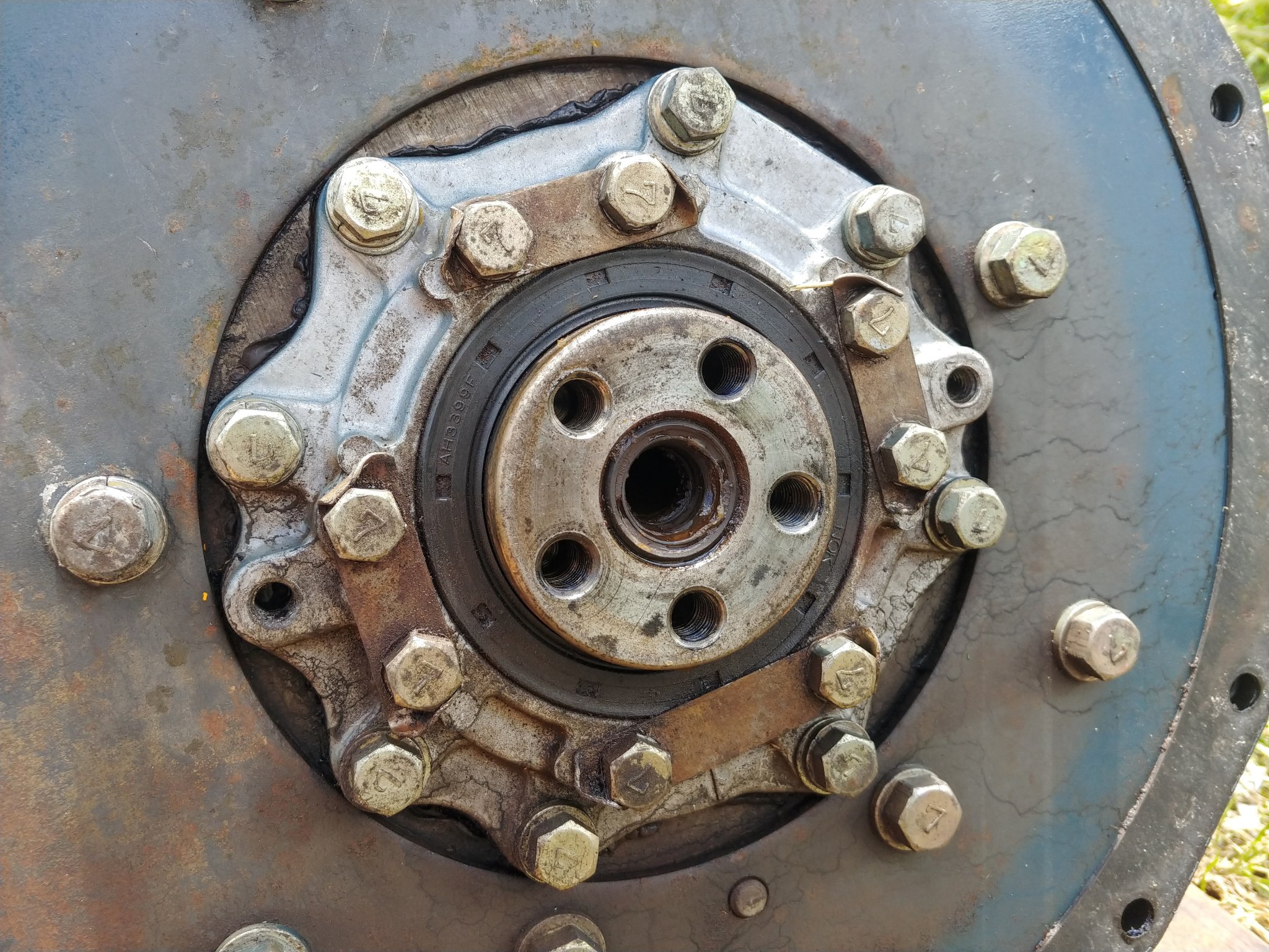

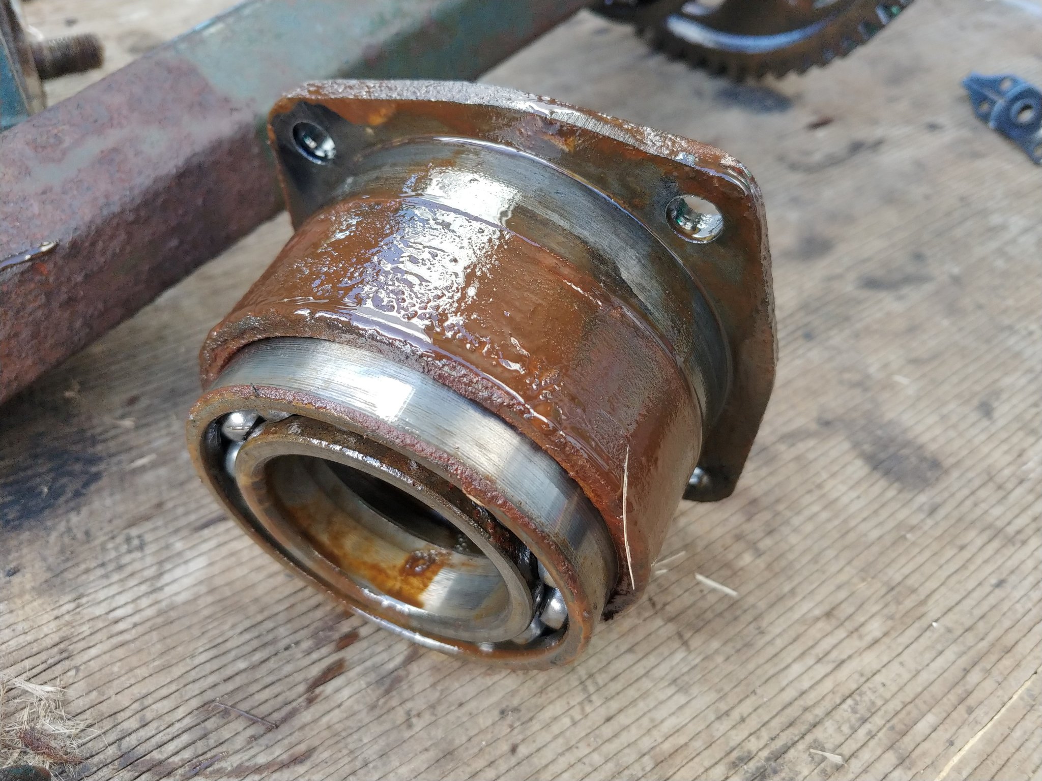

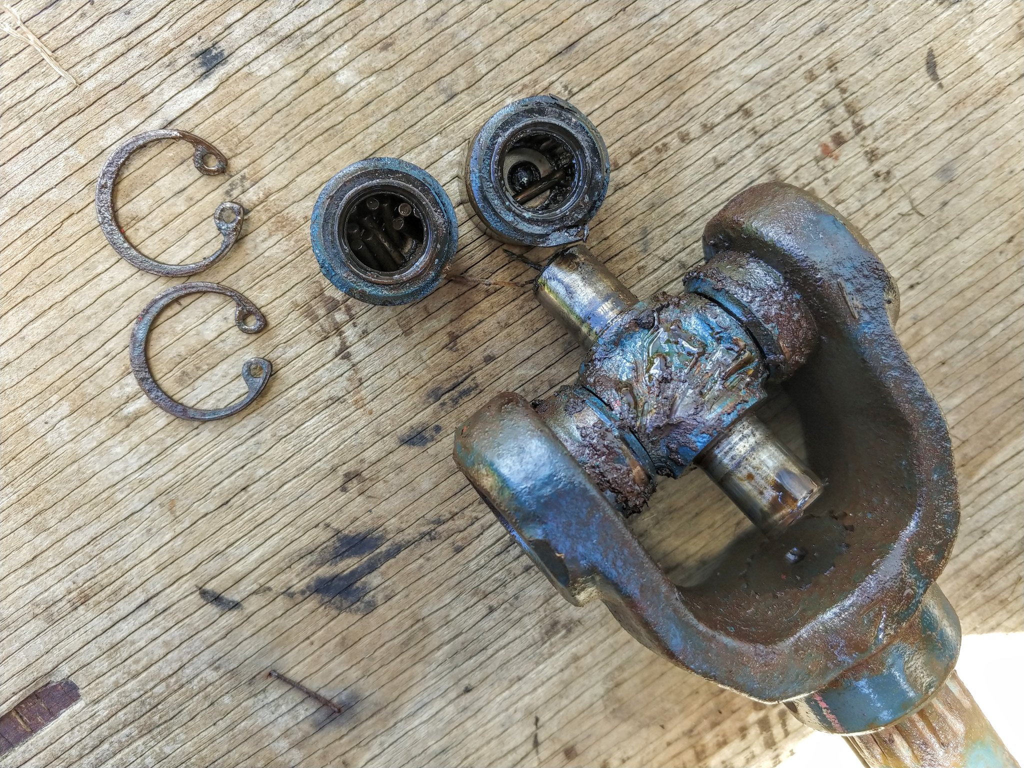

The main drive shaft has this attachment with a rubber washer in between. There was a whole lot of play. Not sure if it's supposed to be like this? I'm guessing probably not. Haven't read the service manual yet to see if it's mentioned.

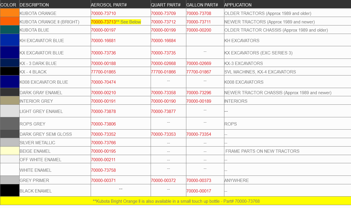

I ended up buying the Kubota blue-ish spray paint for the engine and NEW Kubota BRIGHT Orange for the tractor. For the frame, I used Rustoleum smoke grey and for some parts, I used my Squirrel grey powdercoating. I wasn't trying to concern myself with a historical reproduction however.
That is a good price on the muffler. The OEM muffler for mine was over $500 but I found a nearly exact replacement for about $150 by reviewing other Kubota mufflers with similar style on the D1703 engine and other tractors.
I think you'll be fine with the lift pump you chose. Least of the worries right now anyway.
That's a good score for Orings and such. I know the castle nuts are crazy priced. I had to replace both tierods on my L35 - they and the nuts were way overpriced. But I had no choice - nothing else would fit and work properly. That's just how it goes.
You're correct - Kubota does make two oranges - check out the attached.
Also with regard to the brake arms, if you wanted the arms to be smooth again, that would be an excellent use of the Bondo we'd discussed. There's no strength required and you could sand the rods and paint them so they looked new.
The rust on the gear boxes isn't bad really. You could indeed fill the cavities with evaporust, however the evaporust like other rust converting chemicals turn the rust to a carbon. The carbon should be removed else you will have carbon grit in the transmission. If you ignore the rust, and fill with oil, then the rust will eventually get loose and we're back to grit in the transmission. Perhaps a suggestion is to see just how much rust you can remove using a manual method (like drill and wire brush). But then the bearings could get the rust inside them. I don't know what do you think? Am I making too much of it?
As for submerging the clutch - here's the thing - evaporust leaves a residue that prevents flash rusting. That might cause the clutch to slip. Maybe only submerge the flywheel side and use a wire brush on the other (Fiber) side. Or not submerge the fiber.
The extra lever. Hmmmm, now that you can see the gears do you think it is a high/low range thing? Could it be a fast and slow PTO speed? Could it be a PTO reverser? Could that control the mower PTO? You're right, I can't make anything out from the terrible resolution of the manual either.

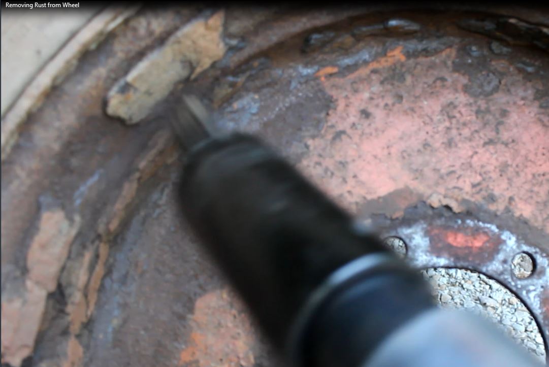

Do you have an air compressor? I could not have removed the rust from my tractor without an angle grinder and wire cup brush and an air-powered needle scaler. You do need a larger compressor.
NEEDLE SCALER - GUN TYPE

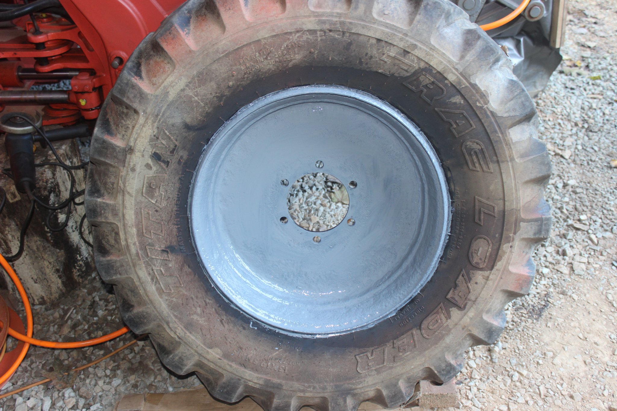

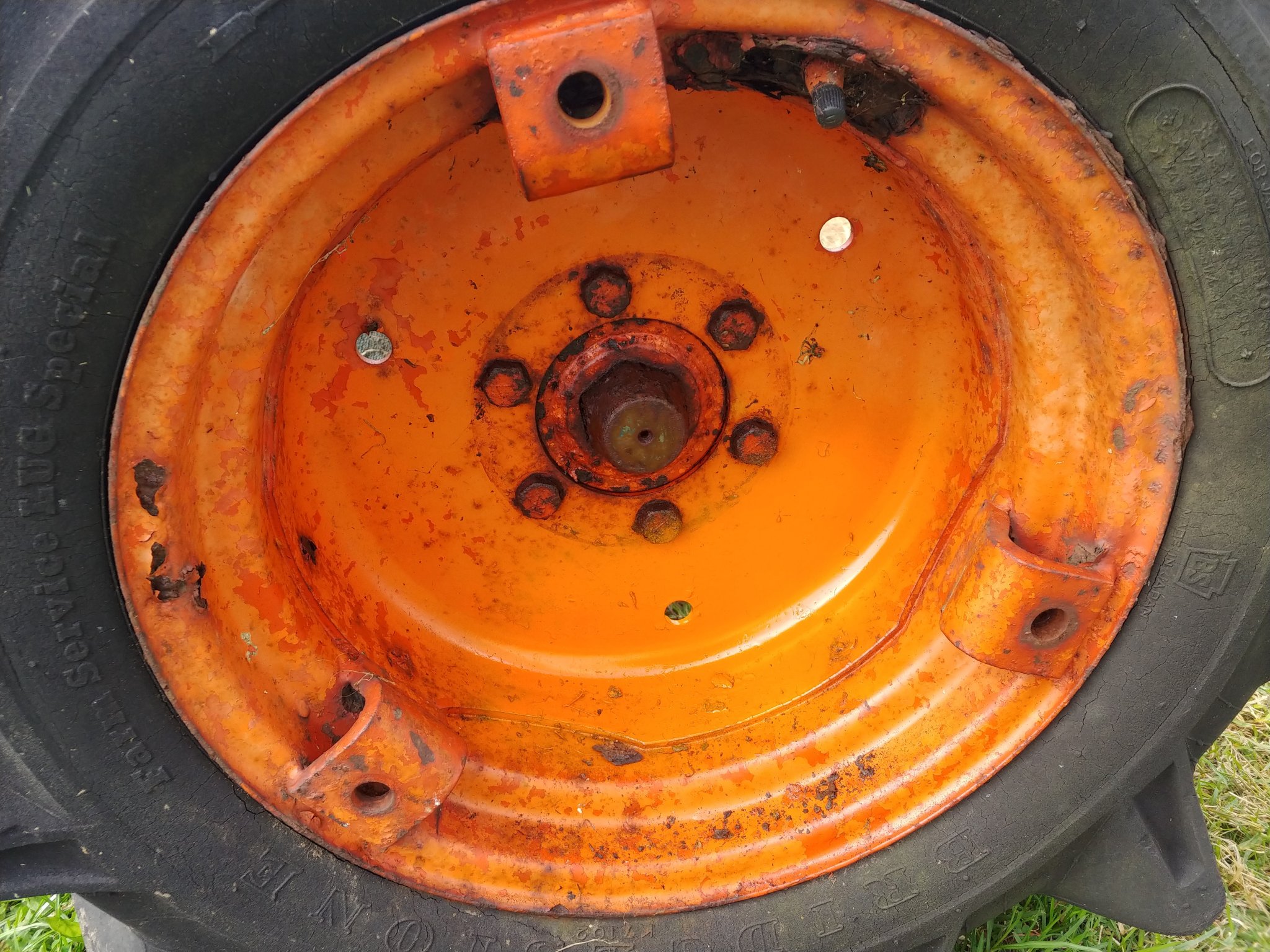

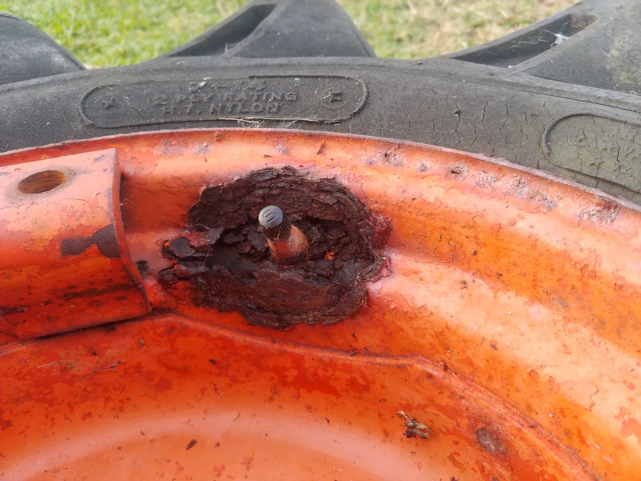

The wheel's hole could be patched with JB weld and some fiberglass tape if that's all it is. it the wheel is just weak and flimsy, then a new wheel might be needed.
I'm including before and after pics of one of my wheels just to give you hope they can look good again!
All 4 of mine were quite hideous.
If you can't get another wheel and/or you can't get the bead to be smooth for an airtight tire fit, you may want to look into an inner tube - Surely there must be an inner tube that can be used.
You're doing amazing work! Keep it up and don't let the small stuff wear you down!
That coupling in the last picture, in my opinion shouldn't be so loose.

The extra lever appears to have two positions. I really don't know what those could be. It doesn't control the centre PTO as that's fixed on the same shaft as the rear PTO. I may just end up disassembling the trans to take a look if nobody else knows.
That needle scaler looks like a useful tool. I think there may be an air compressor I could use but I can't justify buying a scaler at the moment. Hammer and a screwdriver gets the job done (slowly). I do have access to some angle grinders and a good range of wire brushes.
Good work on those wheels, they look a lot worse than mine although it doesn't look like those have holes in them.
I think what happened to the coupling is that the rubber is supposed to be thicker. But it's been compressed and expanded outwards so it's now thinner. I'm not sure I can obtain a new rubber peice right now so I'll just tighten it up. But it might result in a little less efficiency in decoupling engine pulsing from the transmission.

I also want some more info about the two way cock for aux hydraulics connection. I've made a thread here:

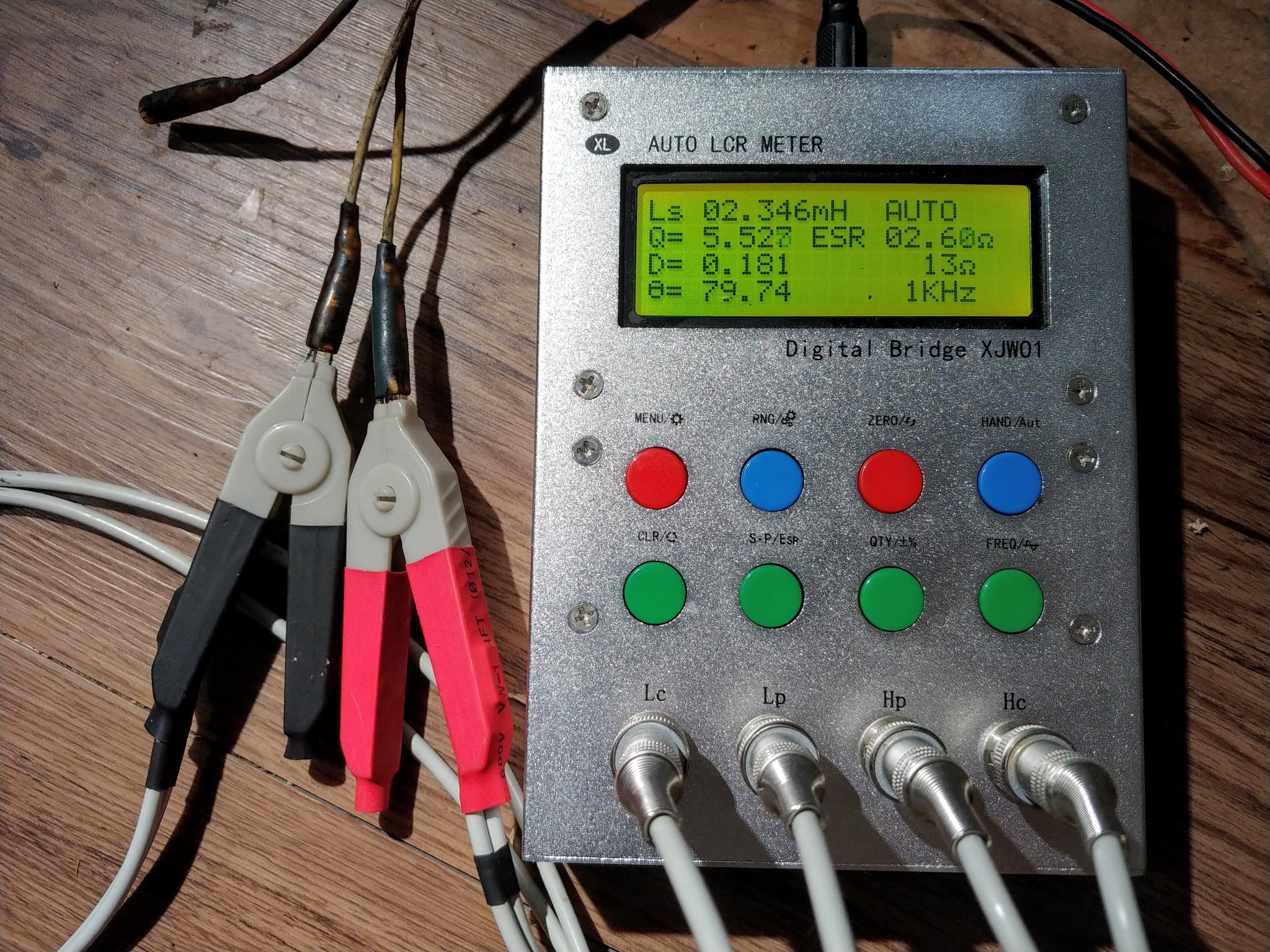

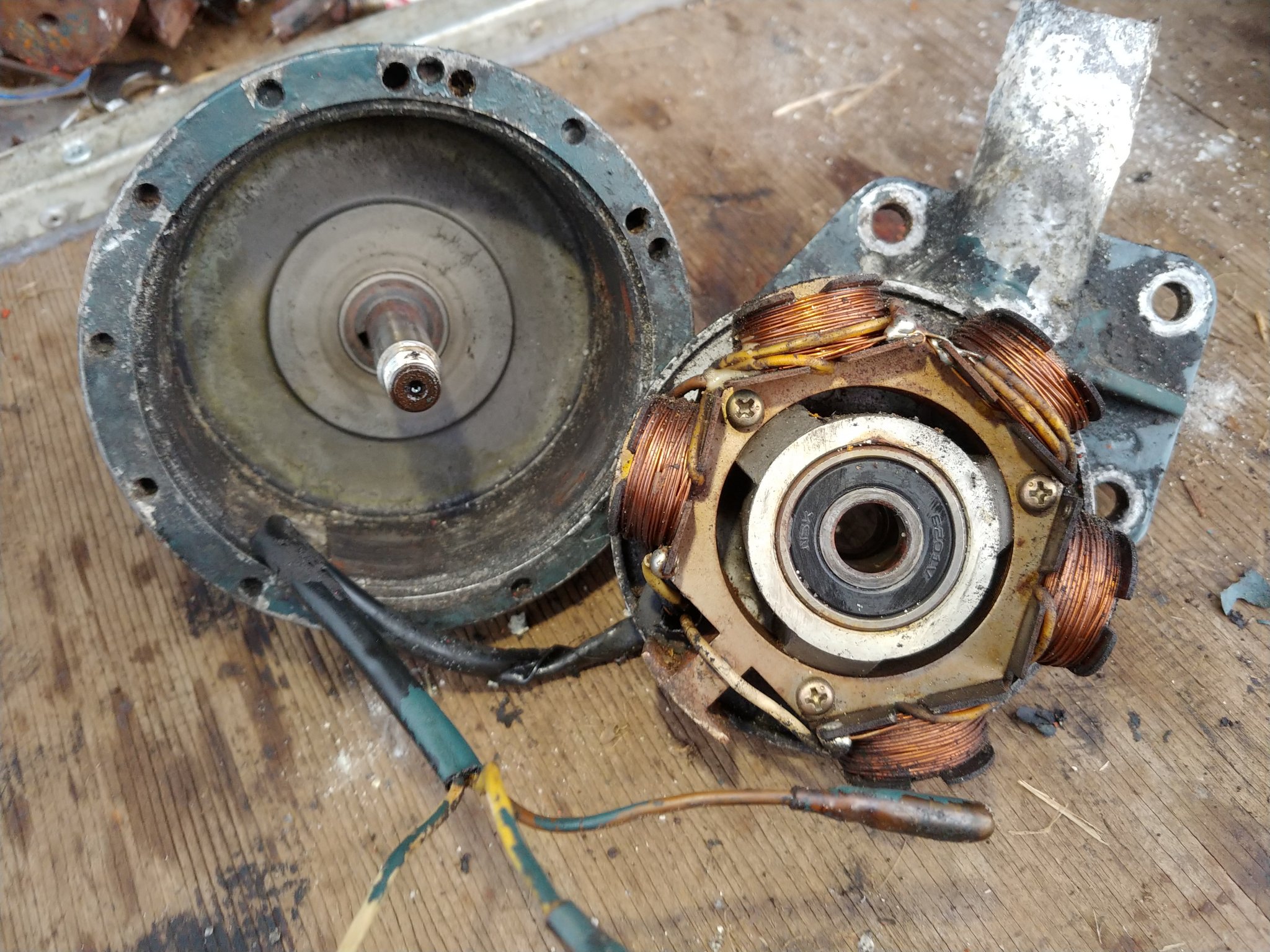

I removed the glow plugs (which both seemed ok), did a lot of research on them and made yet another thread:
Now back to my log. Here's what I did in the two or three days before it started raining.
I removed the seal on the transmission main shaft by gripping it with pliers and rotating it until I could get it out. It's a metal flanged seal which reads NOK TC5 17 32 9 1.4. It's 17x32x9mm. I'm not sure I can find an exact replacement with a flange so I may just put this one back.
I removed both rear wheels. The big bolts on the hub (just one on each hub on my version) that screw against the axle were very hard to remove. I used a lot of penetrating oil and an impact wrench (tightening then loosening) and I managed to get the right side off. The left side was still stubborn. I tried using my gear puller but it was a bit small and I just sheared a bolt off. After a while I managed to knock it in with a hammer which then allowed me to use the impact wrench to remove the large bolt. Then I slowly knocked the hub off the axle.
Both rear wheels had a bit of rust around the valves. But not too bad.
I made a cover for the air intake and hydraulic pump area out of wood. And I temporarily re-attached the exhaust manifold.

I gave the engine a waterblast. The Aeroclean degreaser I used seemed to work pretty well compared to standard degreaser. It's a bit expensive though. Here are the before and after photos.
There's quite a bit of paint coming off the aluminium parts. I might take them off again so I can properly strip them and apply etching primer.
I gave the front axle and chassis a bit of a clean too.
I removed the outer pressure plate, enabling the clutch plate to be removed and exposing the flywheel.
There's a bit of wear on the clutch fingers. I'm not sure how flat they're supposed to be. I wonder if the clutch release bearing is not so great after all. New clutch fingers will cost $60 NZD. And a new bearing might be about the same. I don't think I'll replace it yet as I've never had an issue with the clutch.

I removed the flywheel which exposes the rear engine seals. The large one (part 09560-00006) is NOK AH3399F which I believe is 66x88x9mm (I've also seen it listed as 8 or 10mm thick). It looks OK but I wonder if it's still worth replacing as it will be getting a bit old now. The small one (not clear but maybe 09400-16267?) says NOK AC0678E 2 which is 16x26x7mm. It seemed a little damaged on the outside - maybe while I was removing the engine? I'll replace this one.
I removed the engine to bell housing plate. The gasket on this (only on the plate to bell housing side) seems in pretty good condition.

I'm pretty happy with the orange paint I've got. I prefer the older Kubota orange to the newer one, at least on this tractor. I found a dark grey paint which I liked. White Knight Squirts Metallic Charcoal Gloss. I've decided to paint the tractor dark grey, and paint the engine and radiator black with engine enamel. It won't look original but hopefully it will still look good and will protect it for some time. The engine almost doesn't need paint and could do with just a clear coat, but it should look just that little bit better with all the scratches covered.

I removed the rear lift arms piston from the aluminium block and had a look at it. The o-ring was completely square - it should be round. There's a couple threads about replacement of these o-rings - here and here. They are on a B7100 and B7200 respectively. The first one doesn't use a back up ring, but the second one does. The o-ring for the B6000 is part 04810-08500, same as for the B7200. The parts book doesn't seem to mention a back up ring. I wonder if I should add one? I might bring this question to Waitemata Hydraulics when I next go there. Edit: one more article here.
I think I remember there were sometimes a few issues with the three point hitch like it dropping slowly and not being that powerful. The combination of changing out the o-rings and cleaning the filter will hopefully make that much better.

My thoughts on the rear seal are the same. I'd hate for you to do all this work only to find out the rear engine seal is leaking.
The rear wheels have that nasty rust around the valve stems - but the tire is holding air - correct? Do you know if there's a tube in the rear?
I would hate for you to bang away at the rust only to open a hole. That's what happened to me on a freeze plug held together with rust-magnetism.

One last thought is the clutch. I'm no expert but the fingers don't look worn to me. They look pretty thick - as thick as the rest of it anyway.

Putting magnets in the transmission is a good idea. Hopefully they might just stick on to a drain plug without moving as the surrounding is aluminium.
I don't yet know if the rear wheels have tubes yet but it looks like they might. I think the the holes are not too big in the rear wheels so I might use some fibre reinforced body filler for that. The front wheel really needs a plate welded in.
Yeah the clutch fingers are still fairly thick. From a few pictures I found it looked like maybe the surface touching the clutch release bearing was supposed to be a bit rounded rather than flat though?

I took the front axle pivot pin out. It seems to have a little bit of play against both the chassis and the bushings in the diff. I think maybe all the surfaces are a bit worn including the pin but it's not that bad.
The o-rings inside the bushes do look a little flat.
I took the front wheel drive universal joint apart. I can't remove the other half of the joint from the transmission case. It's rusted onto the shaft. I tried borrowing a two jaw gear puller but the centre pin didn't stay in the hole on the shaft and the jaws kept slipping off. Maybe a smaller gear puller would work.
I removed the left and right axle covers.
The axles can just be pulled out from the diff along with their bearings.

There is a little chip on the four wheel drive engagement thing.
I took the diff and bearings out. There was a little play in the left and right side small gears so they may need a shim.
I took the first shaft out along with the cover.
I'm not sure I can take any more of the trans apart without splitting the diff off. And I don't want to do that until I know if I can get a hold of a new gasket because I don't want to mess with the spacing there.

I took the alternator apart. I've seen a few different terms used on this forum (e.g. dynamo) but since this is a permanent magnet alternator, I think it is called a magneto.
First the fan is taken off with four bolts.
The nut on the other side is removed along with a lock washer and conical washer (not sure if it's supposed to be conical?)
The stator (with windings) is only held in the rotor (bell with magnets) by strong magnetism at this point. I used two flat head screwdrivers on opposing sides to pry it out (being careful not to scratch any windings) and then pulled it out with my hands once it was far enough. The bearing is an NSK 6201V which I believe is 12x32x10mm. There are a whole lot of replacements at Bearing Supplies ranging from $2.5 to $11.
There has been various information I've found here about the alternator, charging and lights system, some of it accurate, and some of it less so. Here is my attempt to explain it.
Here are some readings from testing the alternator at 1kHz. There is 2346µH inductance and 2.6Ω impedance between the white and yellow wires. There is 961µH and 1.39Ω between the brown and yellow wires. There is 1448µH and 1.83Ω between the brown and white wires. Getting closer to DC, the impedance/resistance at 100Hz is around 724mΩ, 305mΩ and 441mΩ respectively.
The alternator is a single phase AC permanent magnet type with a tap at 2/5 of the winding length. You can see in the earlier photo that the windings are not symmetrical. There are six mechanical stator poles but only five have windings on. The solder joint on the left is the yellow wire, the one on the bottom is the white wire. If you look closely, there is a solder joint at 2/5 of the way around from the yellow wire which is connected to the brown wire.
These equations are almost correct, but not quite as the tap isn't at *exactly* 2/5:
~2346µH x 2/5 = ~961µH
~2346µH x 3/5 = ~1448µH
The impedance at 1kHz doesn't match the calculations so well, but the DC resistance matches pretty well.

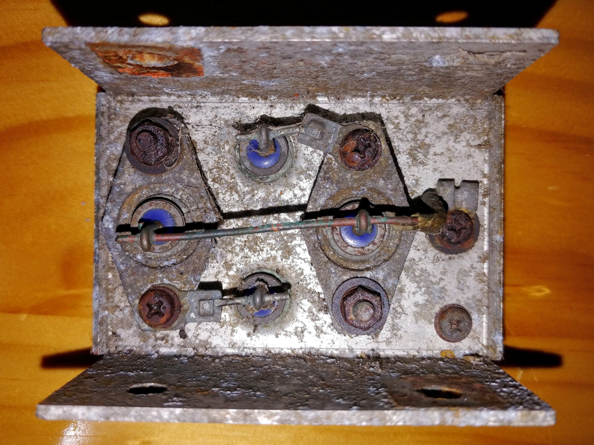

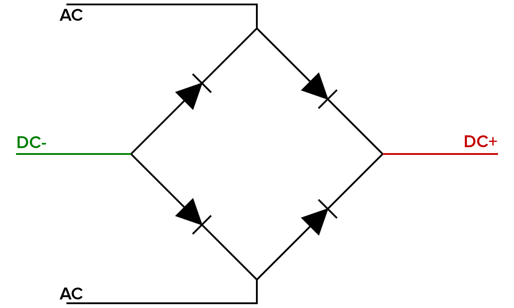

Now we'll look at the "regulator". In fact, this is not actually a regulator but a solid state discrete bridge (full wave) rectifier.
Here is the rectifier as seen from the back of the dashboard and in the same orientation as seen on the wiring diagram. Top right is E (Earth). Right is B (Battery positive). Top left and bottom right are AC. Polarity of these doesn't matter since it's AC and it's being rectified.
This is a look at the innards of the rectifier. The blue things are diodes. A bridge rectifier uses four diodes. One in each direction for each AC input and the other leg connected to the respective DC output. The two large things that stick out are electrically isolated heatsinks. You can see that the negative side of two diodes is connected to the case and E (earth) terminal and the positive side of the other two is connected to the B (battery positive) terminal.
The alternator is wired up so that the brown wire (2/5 tap) is connected to one AC input of the rectifier. The Yellow wire is connected to the S terminal of the light switch which is also connected to the other AC input of the rectifier. So normally about 2/5 of the alternator winding length is connected to the rectifier and only 2/5 of the maximum power is available.
When the light switch is turned on, T and B are connected together, which joins the lights to the ignition (positive) terminal on the starter switch. G2 and S are also connected together. This in effect joins the white and yellow wire, putting the brown to yellow (2/5) and yellow to white (3/5) windings in parallel. This should increase the maximum power to 5/5 and I think the open circuit (maximum) voltage might increase by 25% (from 2/5 to 2.5/5).
This is all done so that the battery is not charged at too high a rate or voltage when the lights are not activated, and giving more power when activating the lights. It's a bit outdated. The better solution would be to have a simple solid state regulator module which includes a bridge rectifier and regulates the output voltage (and possibly the output current), simply drawing as much power as it needs at the time.
I already have one of these regulators that I bought a while ago. The JFT 149F 14V EQ140 for $13 shipped on eBay which is 14V and 1000W maximum. Like the original rectifier, it has the same four connections (three terminals and the case is for earth). It's much smaller than the original and is capable of far more power. An even smaller regulator could be made or bought. Edit: actually this is not quite the right regulator. It only has one AC input and the other terminal of the alternator is presumably connected to ground meaning this would only be a half-wave rectifier.
WIth a four terminal full wave regulator/rectifier the alternator wouldn't be connected to the light switch and would be connected straight to the regulator. The yellow and white wires could be connected together and connected to one AC terminal with the brown wire on the other like the original setup when the lights were turned on. Or the yellow wire could be connected to one AC terminal with the white wire to the other and the brown wire left disconnected.
Both methods would use the full windings, but the second one would have a higher maximum voltage. It would need to be confirmed that this higher voltage isn't above the regulators maximum rated input voltage though.
It would also be relatively easy to rewind this with the perfect open circuit voltage and with more power by using the sixth stator pole and maybe cramming a bit more copper in it.

So you went and took down the gearboxes - can't say as I blame you on that. Once you assemble, you've know what you've got in there and have the expectations set rather than crossing your fingers and hoping! They look pretty good - I hope that all the bearings are in good shape. The rubber stuff - Orings and seals are just consumables eh?

If that uni joint isn't bad, then maybe leave it alone? Neither of us has a complete machine shop. Although is there an equipped auto shop that can split it for you? I'm sure you've thought of that already.

The wheels are a pain, but at least you can utilize tubes so not to worry about air leaking. Once you get them in good shape whether with bondo or welding, they will work - at least they aren't bent, twisted or useless.
View attachment 71477 View attachment 71476
View attachment 71478 View attachment 71479
View attachment 71481 View attachment 71480
View attachment 71483 View attachment 71482
