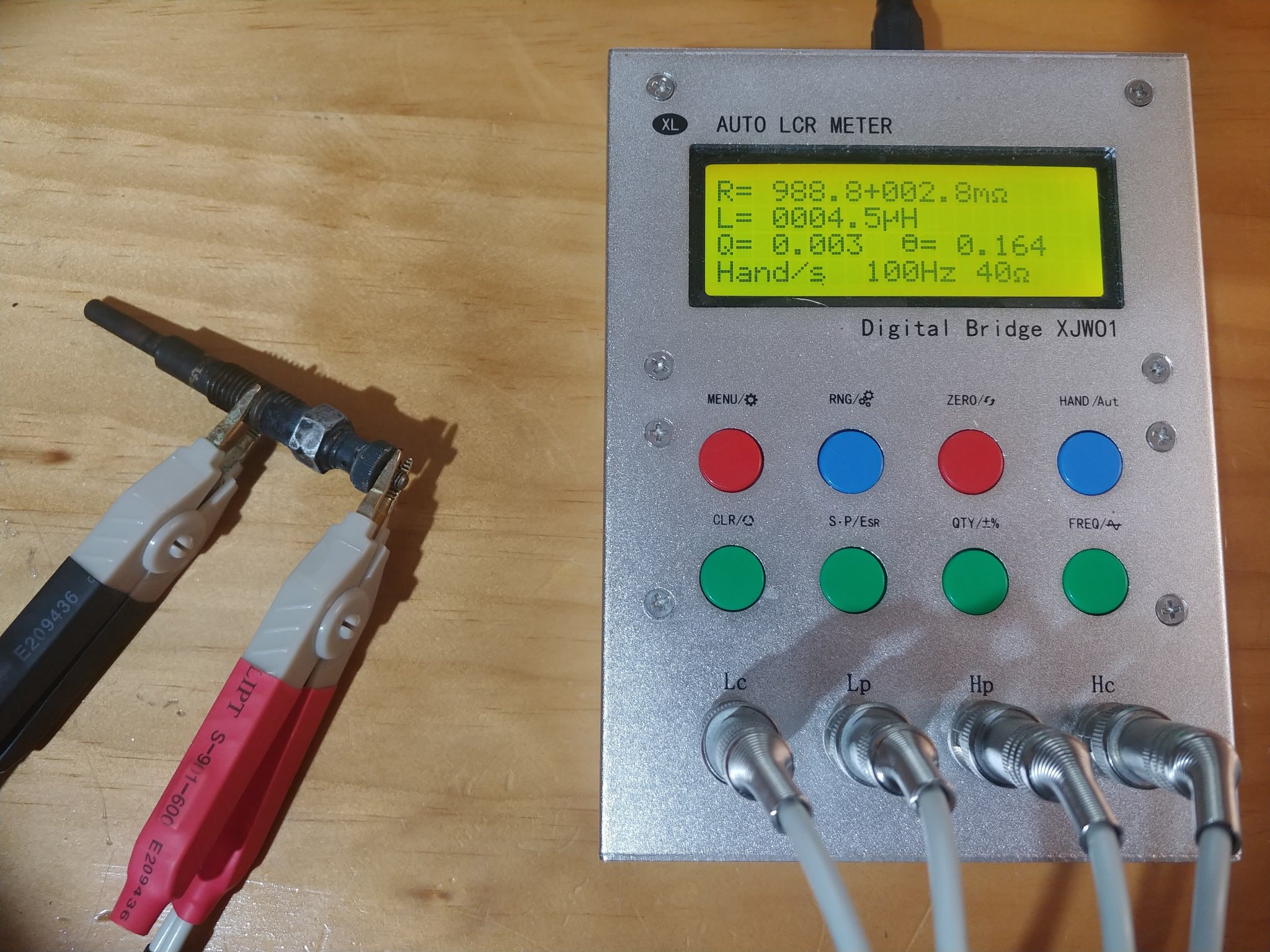

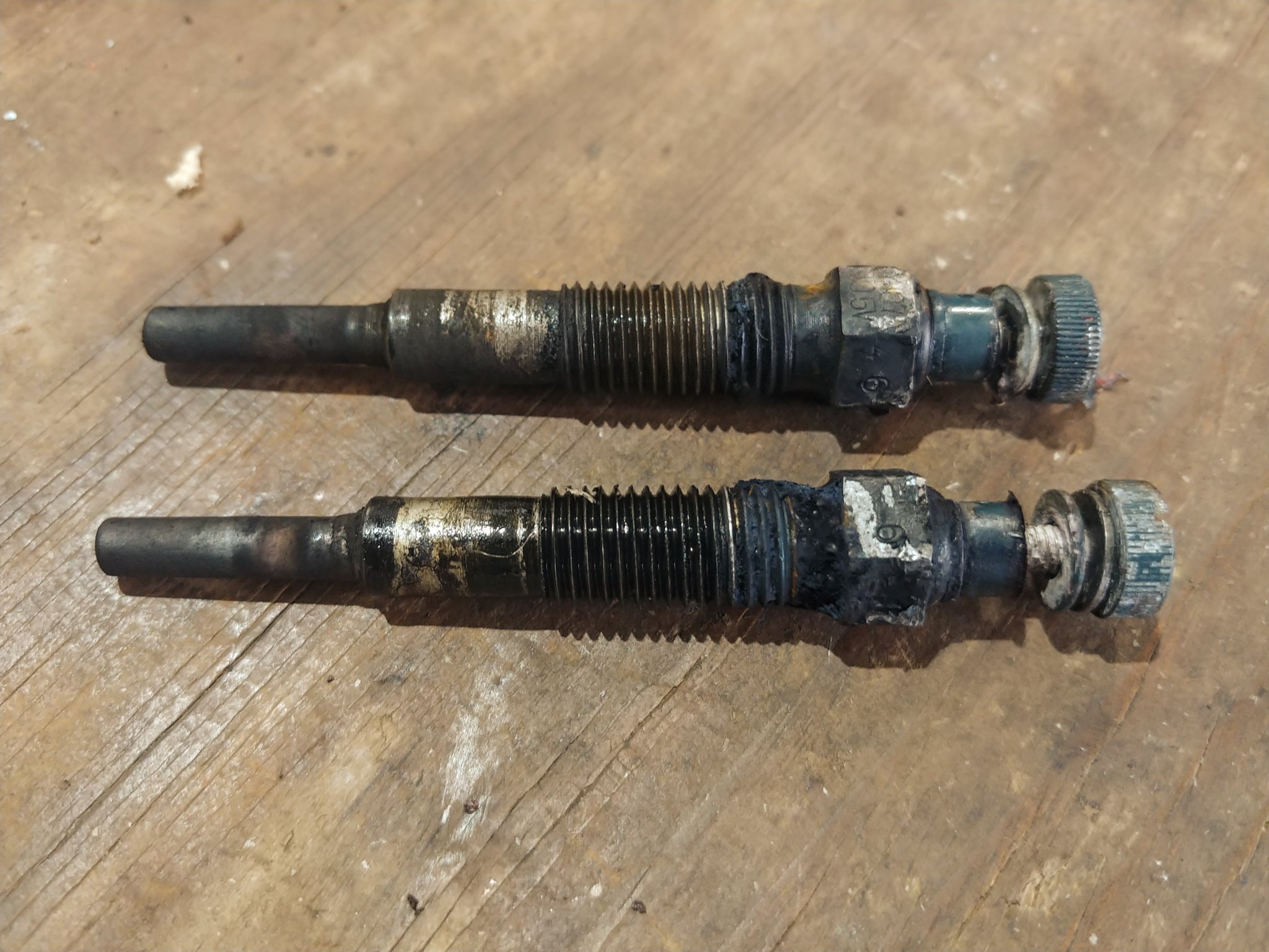

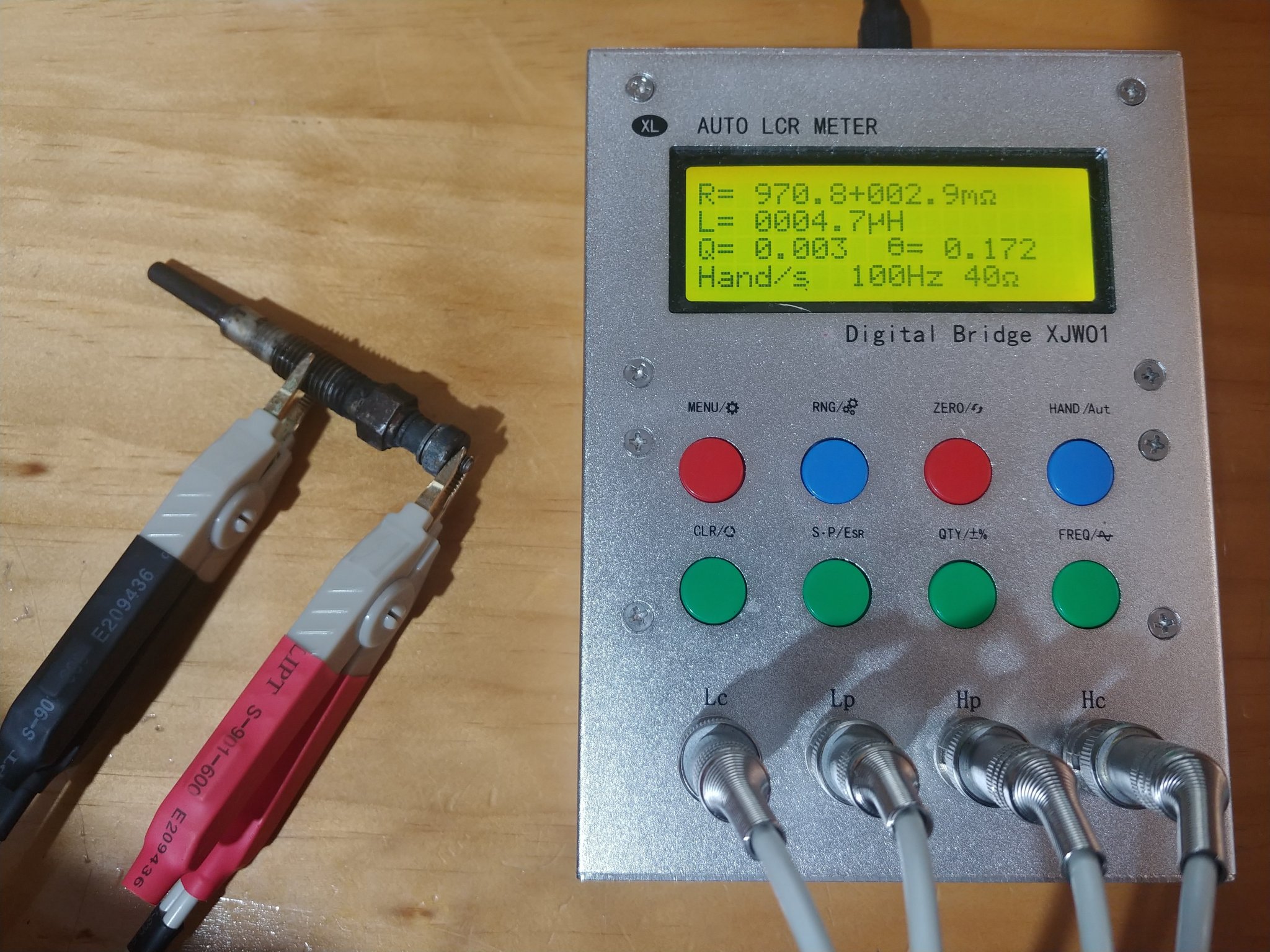

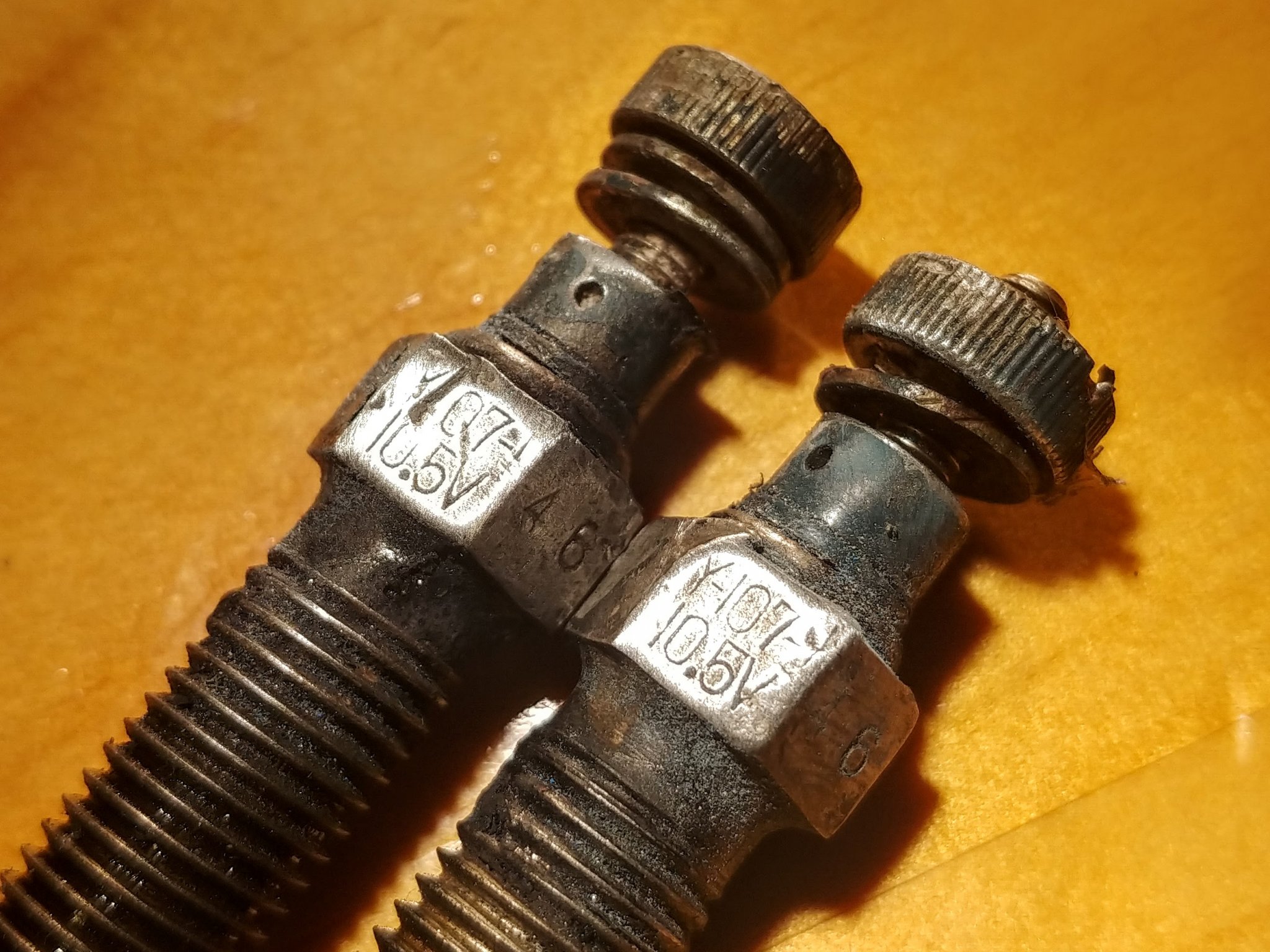

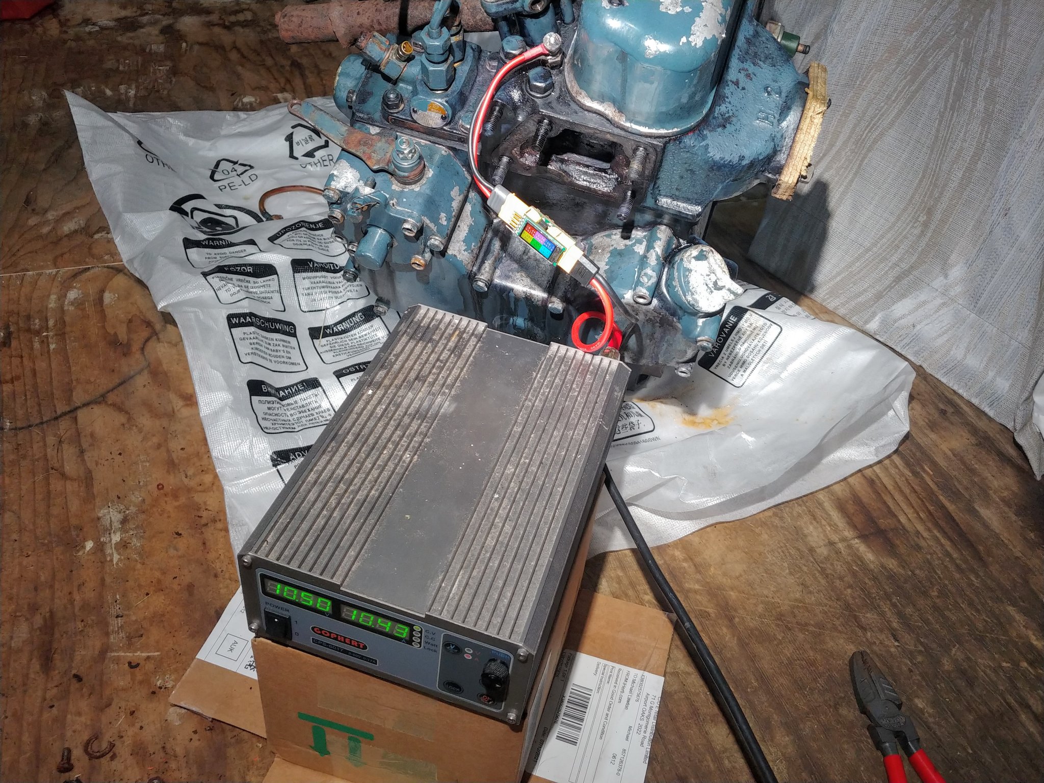

These are the original glow plugs from a B6000. They say Y-107-1, 46 and 10.5V on both of them.
They measure 971mΩ and 989mΩ which would make for 10.8 or 10.6A current draw respectively at 10.5V.
