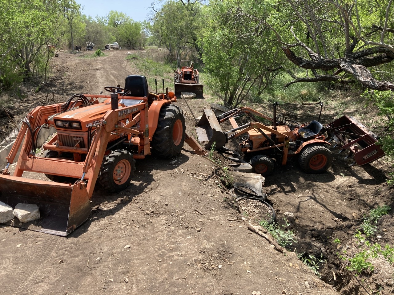

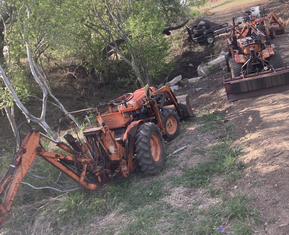

I operated two different b6100 4wds over the weekend, one with loader and box blade, one with loader and backhoe. One has 22x8x10 front and 29x12/5-15 rear, the other has 6-12 front and 8-16 rear. You can tell what's going on immediately when you touch that 4wd lever. It doesn't want to come out of 4wd when making any kind of hard turn, just like your diff lock doesn't want to disengage under the same circumstances. None of it has ever broken. I run these things hard. I avoid hard turns while in 4wd. Also avoid putting max power through only the front end (pull up on something as hard as you can with loader which unloads rear tires and then push/pull on it). But I use 4wd all the time because it's the safest way for me to operate on uneven terrain since it hooks the front wheels to the back brakes and gives you 4-wheel braking. I am reaching down and flipping the 4wd lever, the high/low range lever, and the steering brakes interlock thing all the time.
I highly recommend just learning to feel out the machine and learning to use 'mechanical empathy' rather than nitpicking the specs to death. Like I said, the tire diameter (technically 'loaded radius') is what matters, not the 'size' that's written on the tire. Thing about that is tractor tires all marked the same size AREN'T the same to begin with, and then depending on how much weight is on the tractor AND the surface it's currently sitting on, leaning etc, the tire diameter/radius CHANGES dynamically.. constantly..
The fudge factor here is huge because it has to be. Tire radii change in use, and vary from manufacturer to manufacturer, and even change with tire pressure. Even if the manufacturer gives you a 'loaded radius' spec, which some do, it depends on the weight on the tire and good luck finding out what weight number they used to measure or what that end of your tractor actually weighs sitting still, which barely matters because it moves.. and changes.. and you aren't going to run the pressure they used on the spec sheet which was probably max when what you actually need on a tiny Kubota is probably 10-15psi in fronts, maybe 20 with a loader, and honestly 5-10 in the back if you aren't carrying a bunch of weight.
So there's no way to think yourself into the perfect set of tires. You buy something in the right ballpark, run it, and nothing bad happens, and you move on.
