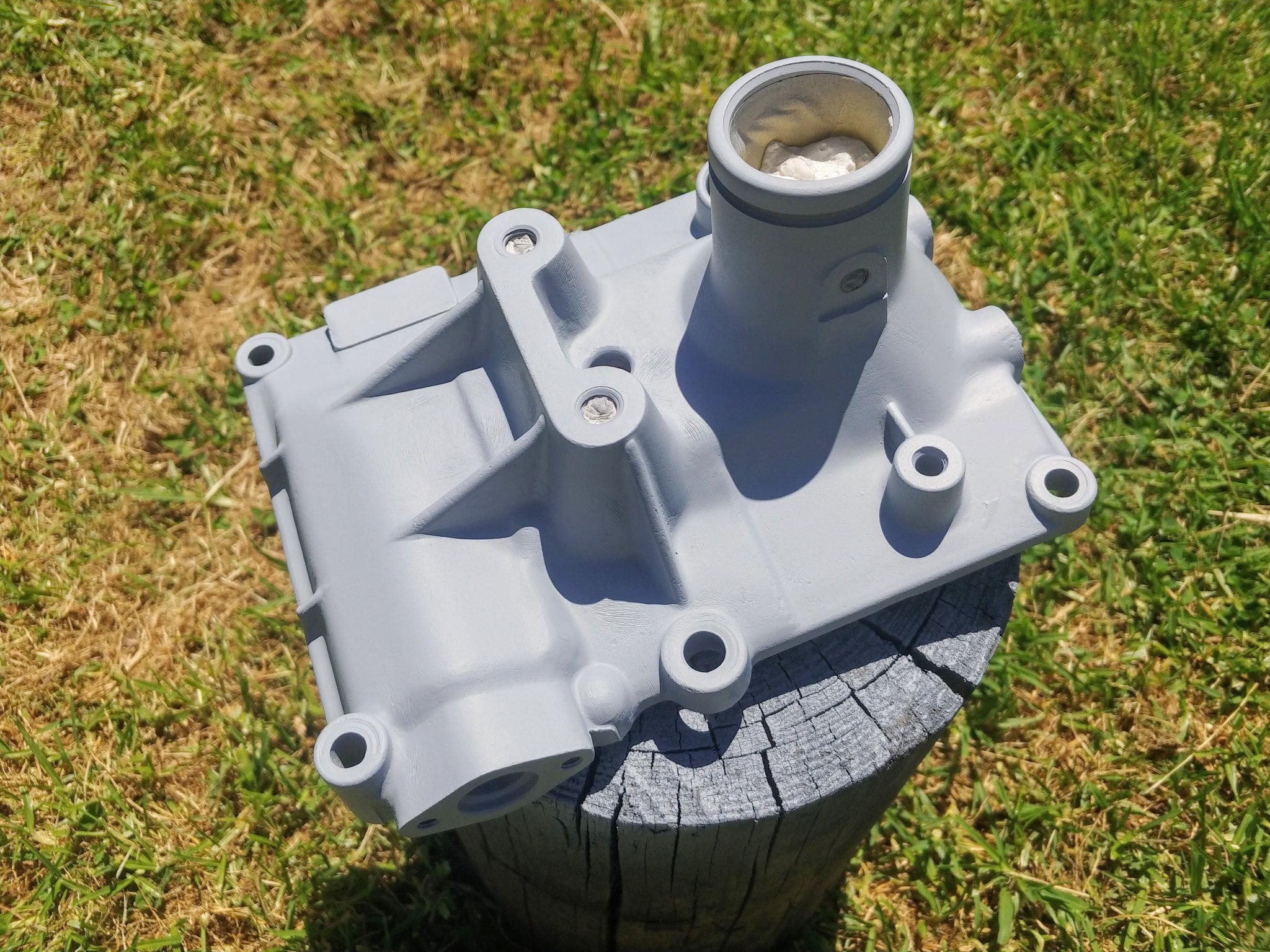

For aluminium parts, I've been using White Knight SLS Etch Primer, two coats of White Knight Squirts Metallic Charcoal Gloss, and one coat of Rust-Oleum Clear Gloss 2X Ultra Cover.

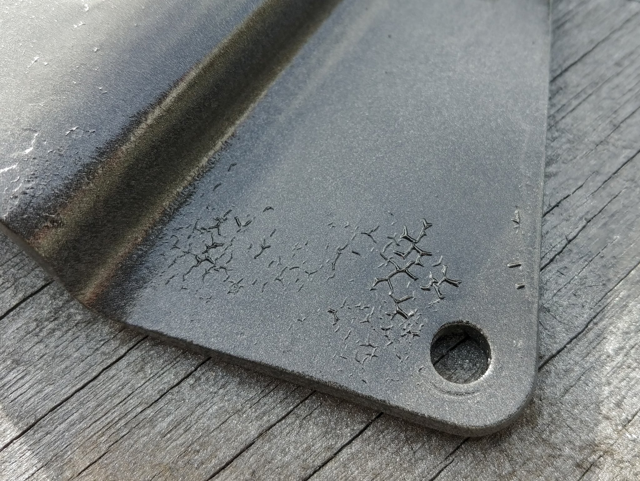

I tried the charcoal gloss acrylic over an epoxy enamel on one part, but it ruined the epoxy in the same way as paint stripper does. So for steel parts I've been using exactly the same as above, but with Rust-Oleum Black Flat 2X Ultra Cover Primer.
For steel parts that aren't usually visible or might be scratched easily I'm using CRC Zinc It, Black Zinc and then Clear Zinc.
I've been using the Rust-Oleum clear coat on the proprietary bolts/nuts and trying to buy new hardware for everything else.

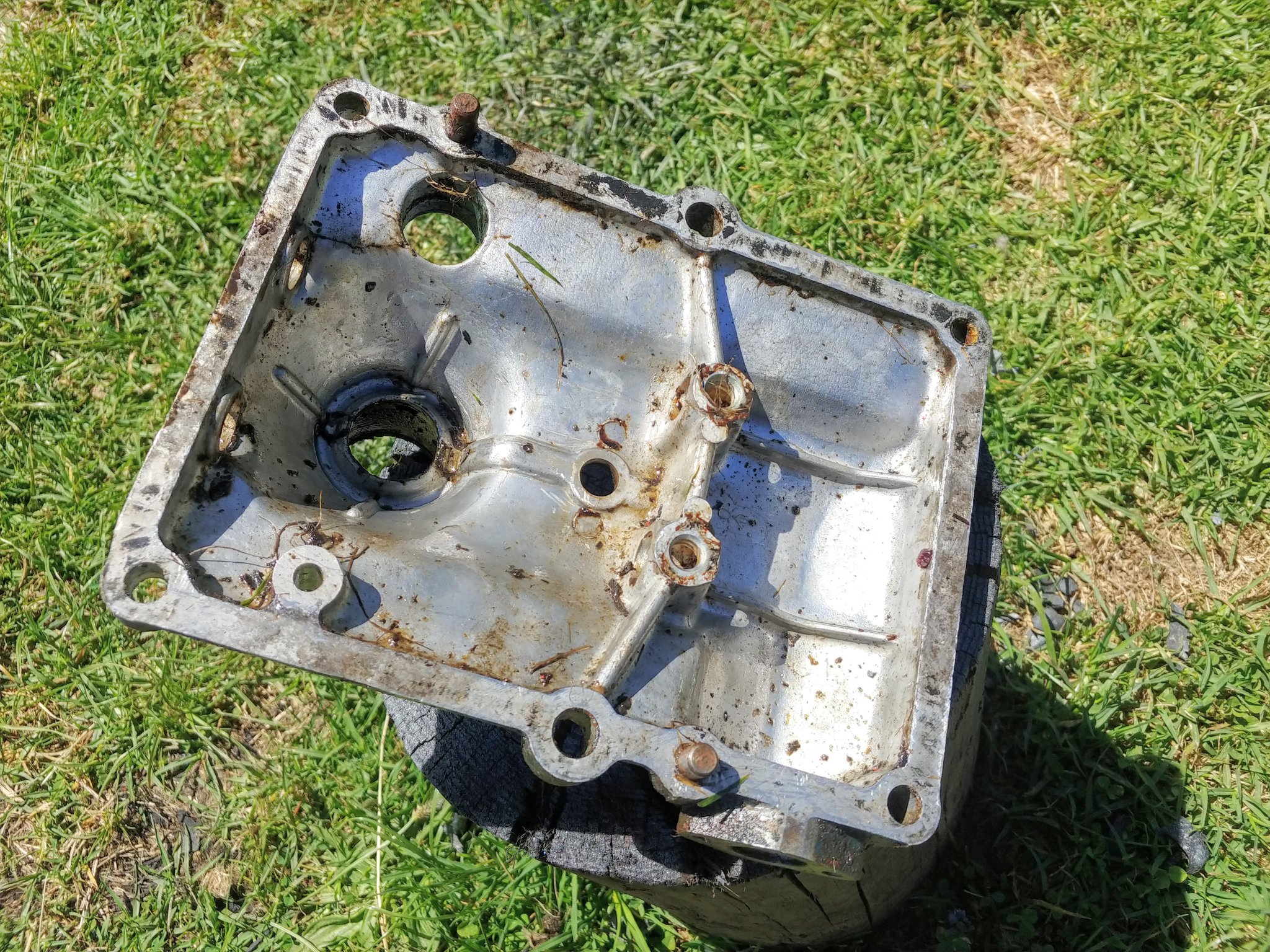

Here's the full procedure of prepping and painting the trans cover which also included disassembly and reassembly with new o-rings and split pins:
20211224_110904_HDR.jpg 20211224_140657_HDR.jpg 20211224_142630_HDR.jpg 20211224_194750_HDR.jpg
And for the underside:

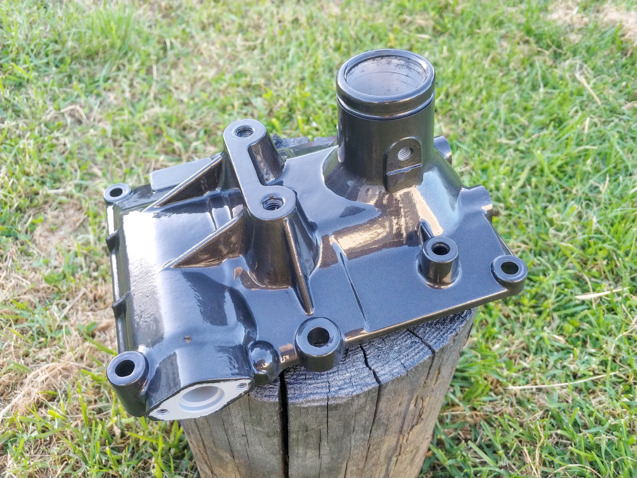

The finished trans cover:

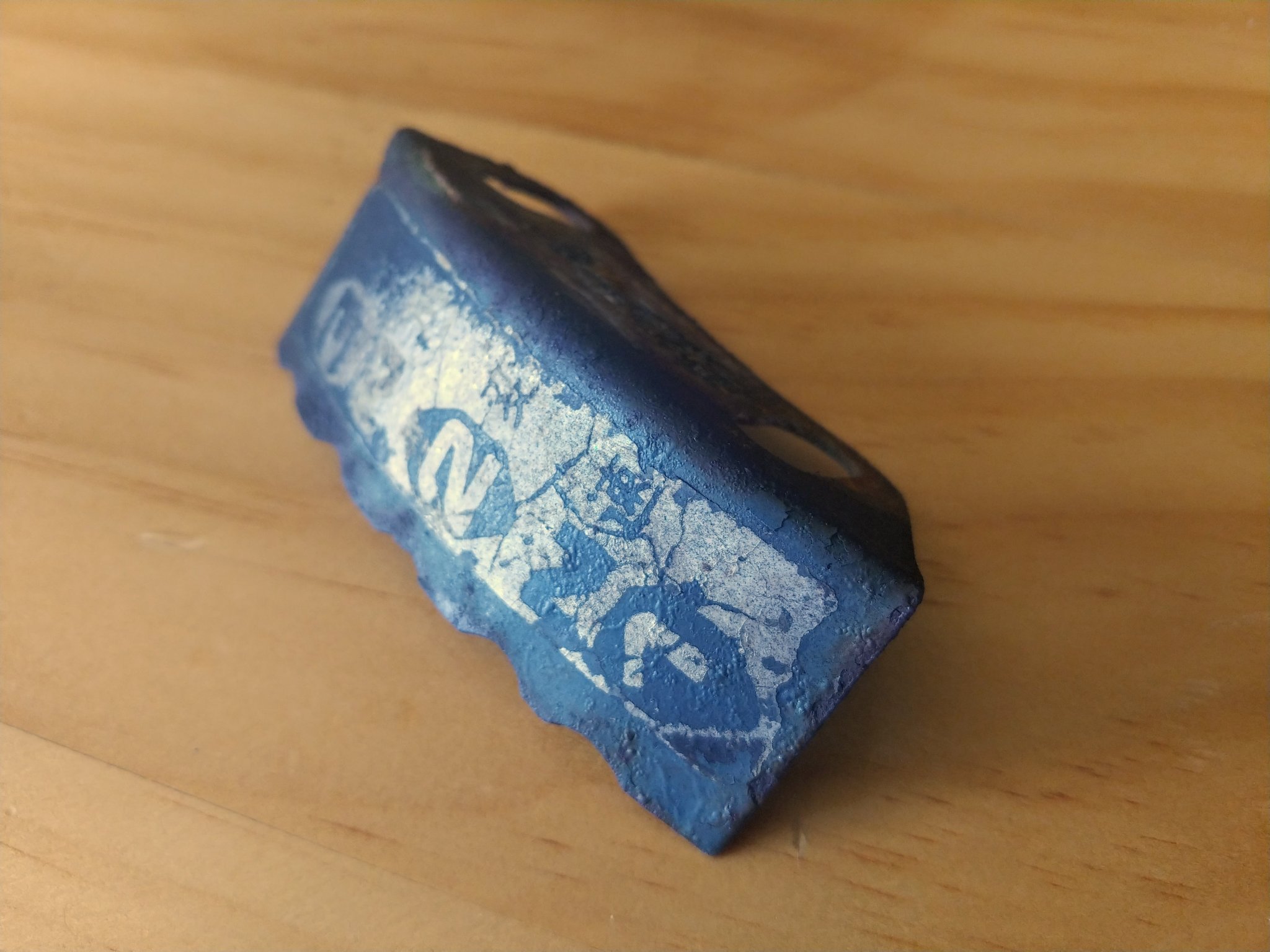

I bought a decal sticker pack off eBay here: https://www.ebay.com/itm/324348120712?var=513899544929

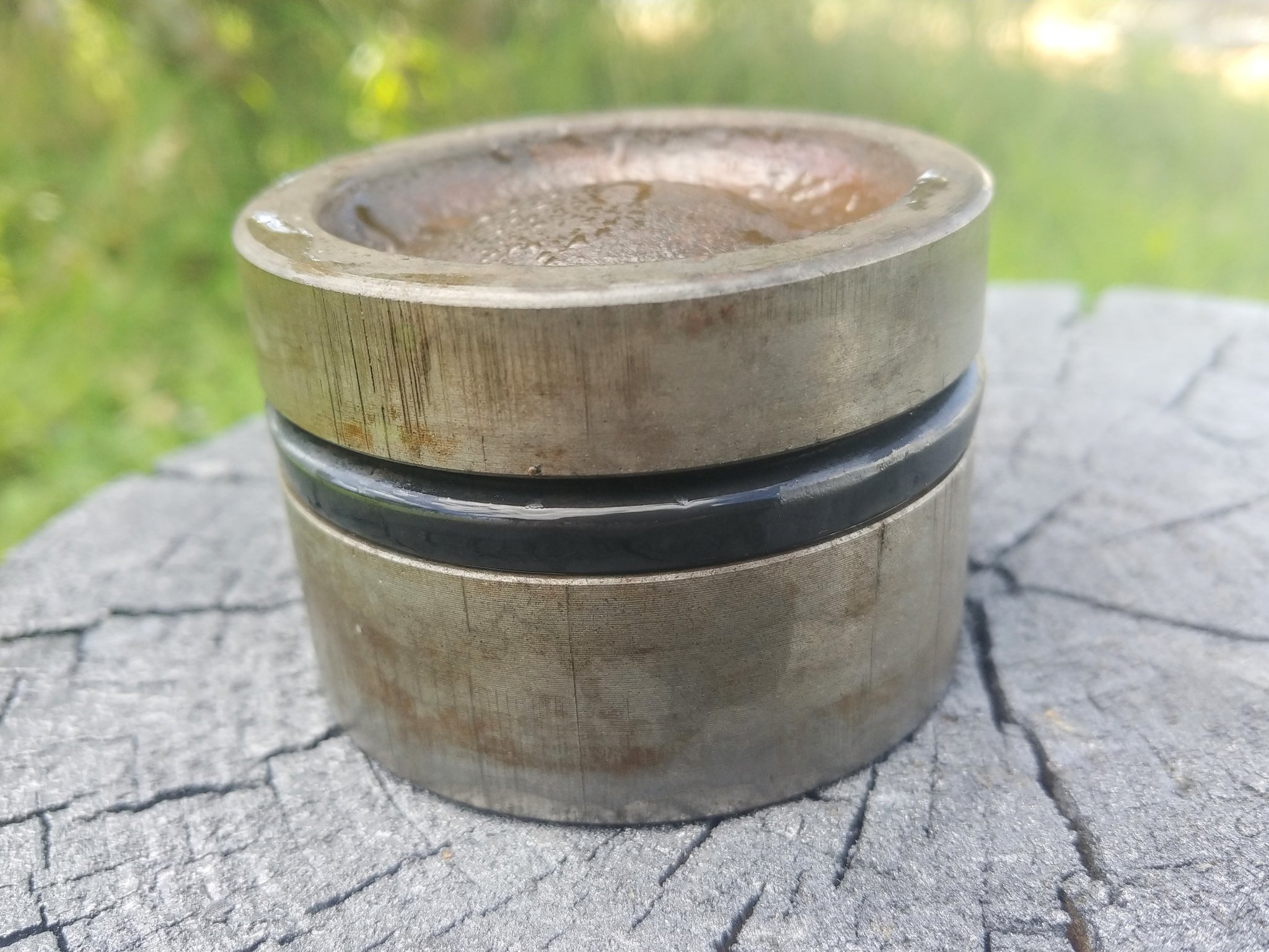

The hydraulic cylinder cap. I've been putting a light spray of CRC Zinc It on any steel flange faces.

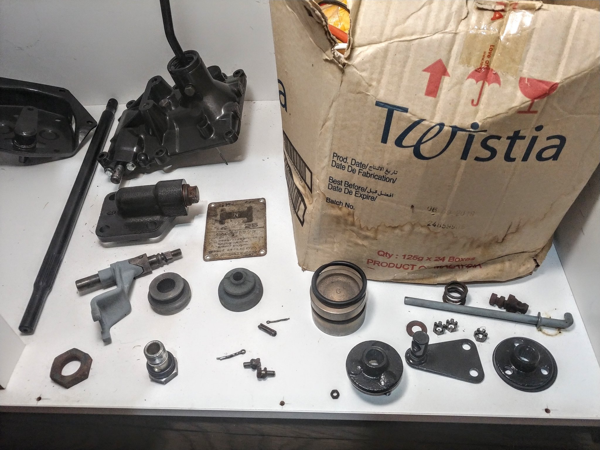

My cupboards are starting to fill up with cleaned and painted parts:

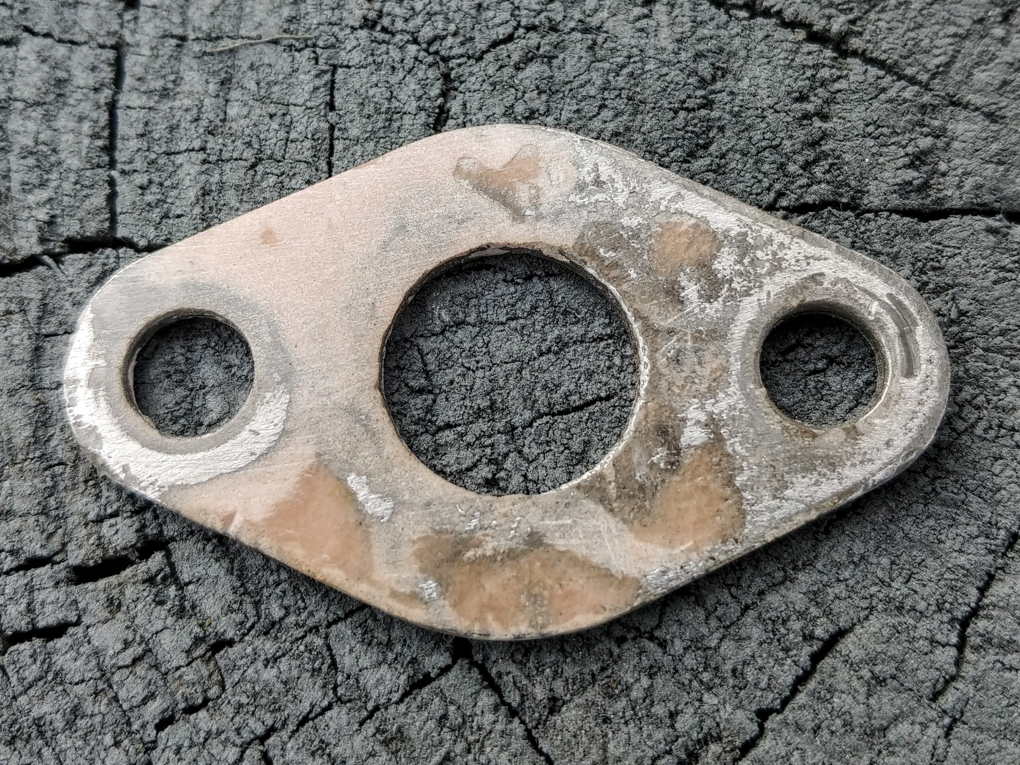

The o-ring on the hydraulic cylinder is in very bad shape. Waitemata Hydraulics didn't have one big enough so I might have to get the genuine replacement part.
I contacted the local Kubota dealer before christmas and asked for price and availability for a long list of parts. I haven't heard back yet.

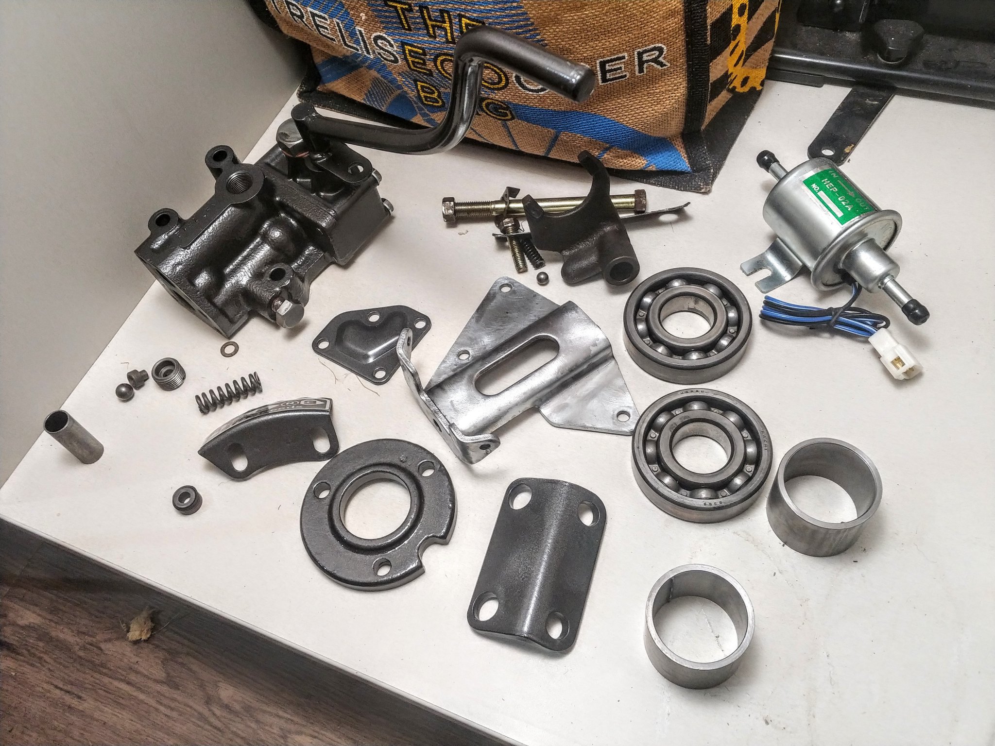

The painted brake covers and actuating arms:

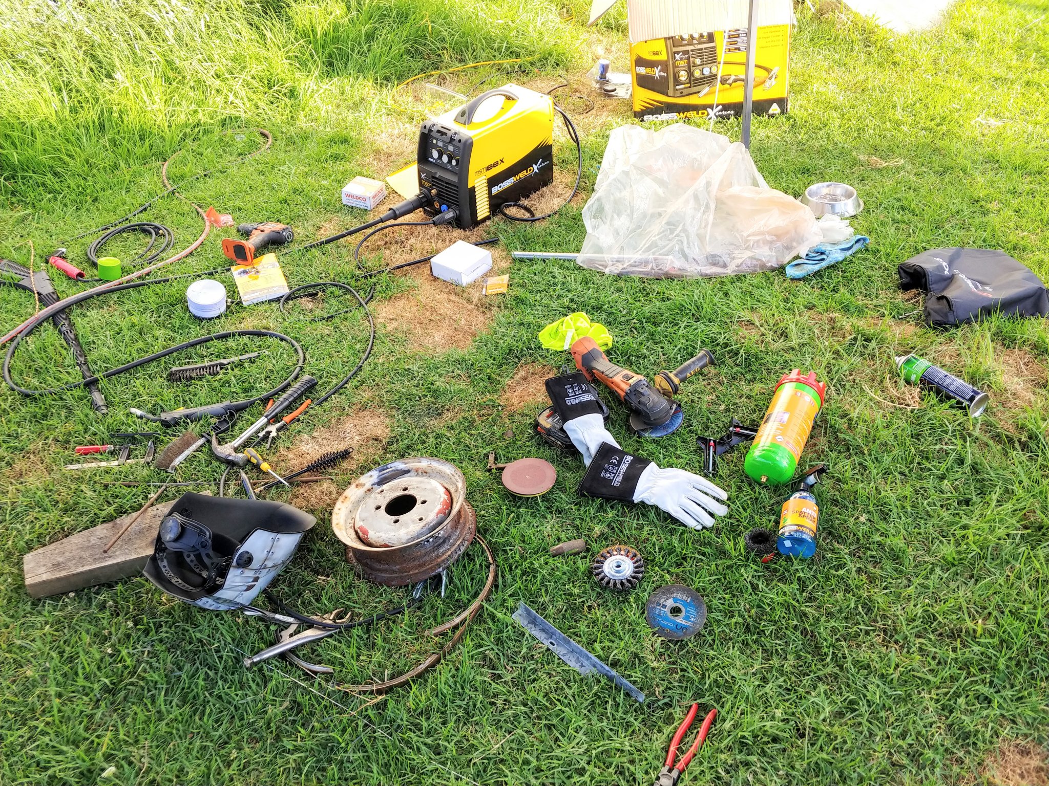

So my dad did buy me a welder for christmas. It's a pretty sweet present! It does gas and gasless MIG, stick and lift TIG. The small disposable cylinder of argon didn't last long at all when doing TIG and the gasless MIG doesn't seem that great for thin stuff, so I really need some argon or argoshield to continue using it. There's a big cylinder of argoshield on the farm but I'm still not sure if I can use it yet.

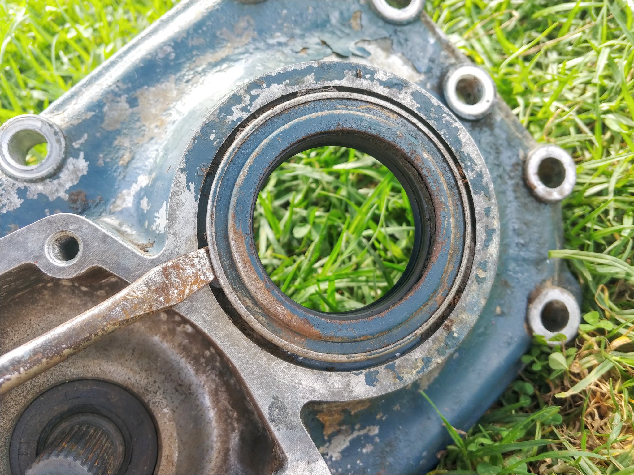

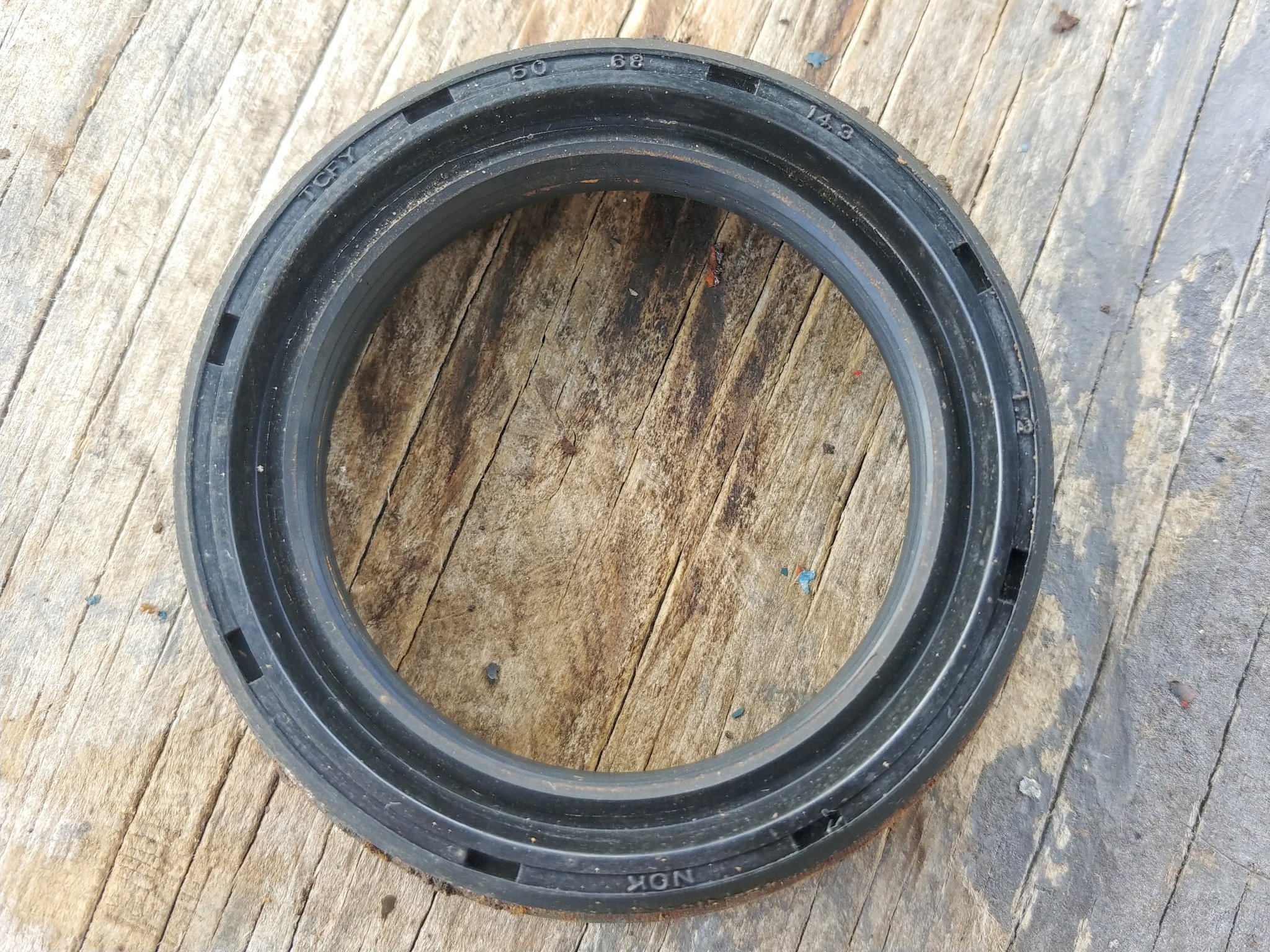

The rear axle oil seals can be taken out of the diff side covers by gently prying them out with a screwdriver. They say NOK TCFY 50 68 14.3 1.2.

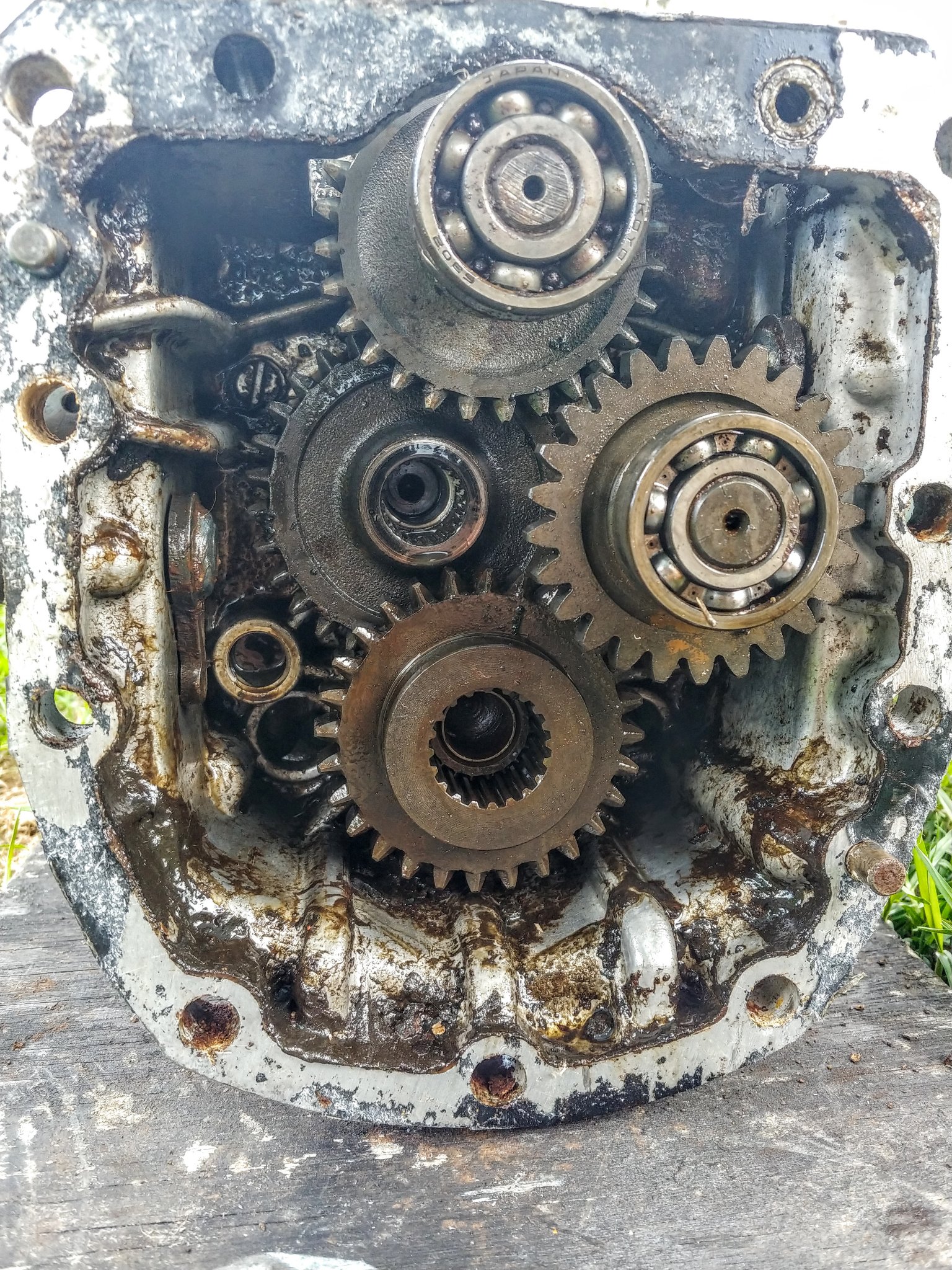

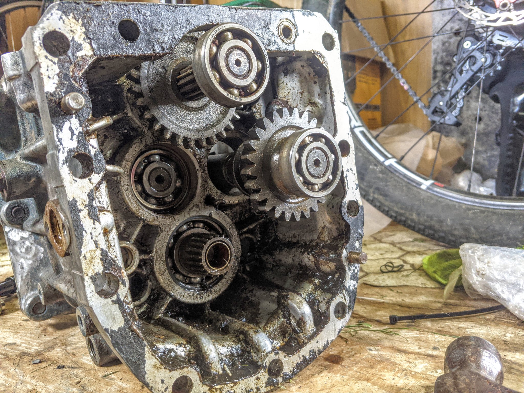

I ended up splitting the diff and trans.
This is the front of the diff. The shift fork and 28T gear are the ones driven by the mystery lever. I haven't yet found it in the parts book, but there is a thin rod extending from the diff below the shift fork that prevents the gear from shifting into the second position (not visible in photo). The rod is visible running through the diff case on the photo after I removed the diff gear on post #37.

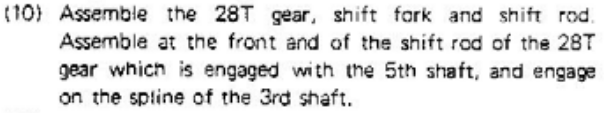

These parts are mentioned in step 10 of the diff/trans assembly in the service manual.
These next photos show the trans progressively without the 28T gear, with the 28T gear, and then with the spiral bevel gear pinion.
Here is my interpretation of the mystery lever and what it does. I haven't actually tested it yet so I could be wrong.
So usually, the power comes from the input shaft, goes through the PTO speed selector and into the third shaft. The third shaft outputs to the small middle "PTO" at the front of the trans. The 28T gear usually sits halfway between the third and fifth shafts, and transmits the power with the splines on the inside. The outer teeth of the 28T gear are not actually engaged with anything. The fifth shaft is the rear PTO.
If the small rod is removed, the 28T gear can be moved into second position. This disconnects the fifth shaft from the third shaft. Now the fifth shaft (rear PTO) gets its power from a gear on the spiral bevel gear shaft (output to the differential gear) by using the outer teeth of the 28T gear. So the rear PTO is perfectly in sync with the rear wheels. It will be in neutral when the main gear (for the wheels) is in neutral and the speed will change based on the main gear selection, even going in reverse when that gear is selected. The PTO speed change lever will only affect the middle PTO which will now be independent from the rear one.
I'm not really sure when you'd use this. I'm guessing it was only for a specific implement sold at the time of purchase so the extra lever could be installed and allowed to work.

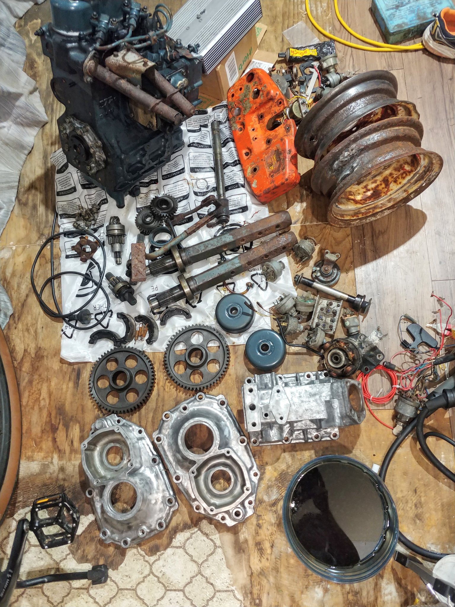

I've moved most of the important parts inside my home, with a few still out in my shed. It's mostly the bigger stuff or old hardware I'll replace still sitting outside.

As far as the mystery lever goes, are you saying then that:
-- Position 1 of the lever makes the rear PTO turn at same rate as the rear wheels AND that the front PTO runs at a different speed from the rear PTO based upon the PTO speed selected?
-- Position 2 of the lever would make the front and rear PTO run at the same speed based upon the PTO selection?
Curious what you find out. Keep going - anxious to see the build!

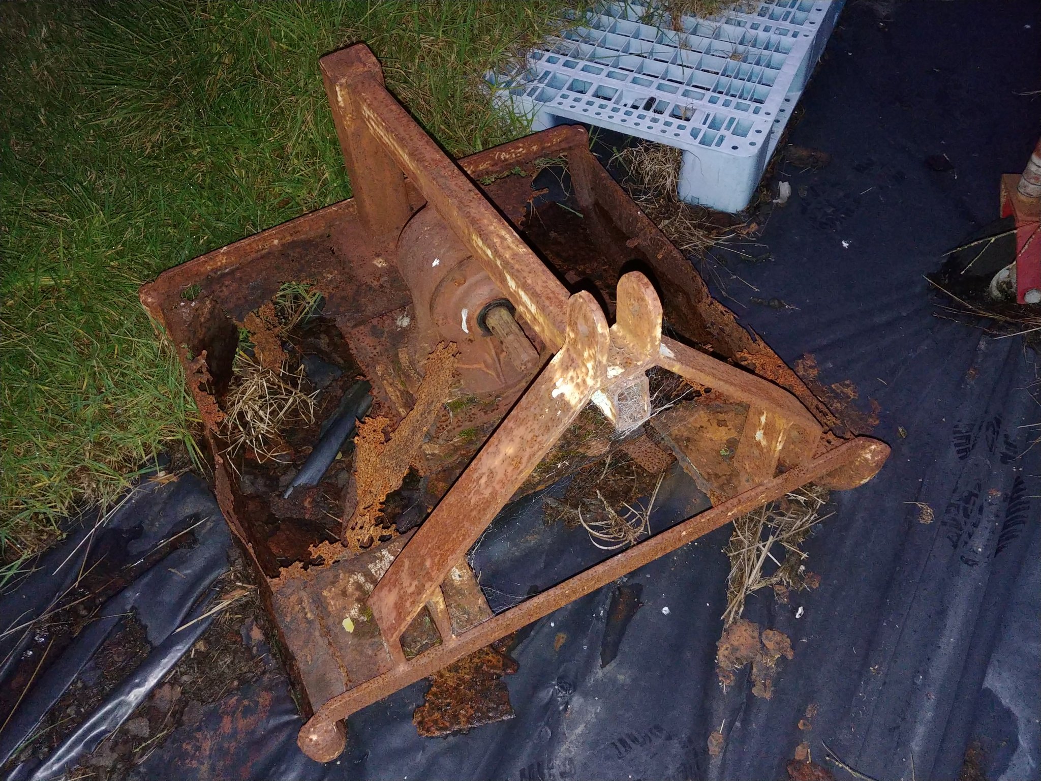

I found the mower that went with this tractor. It looks salvageable.

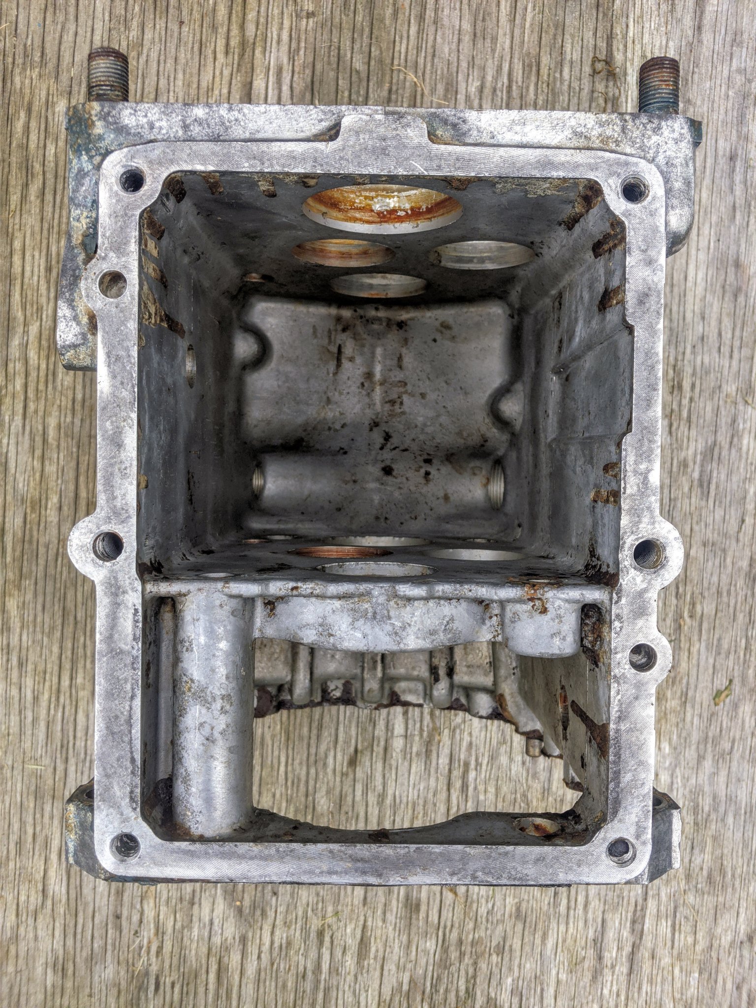

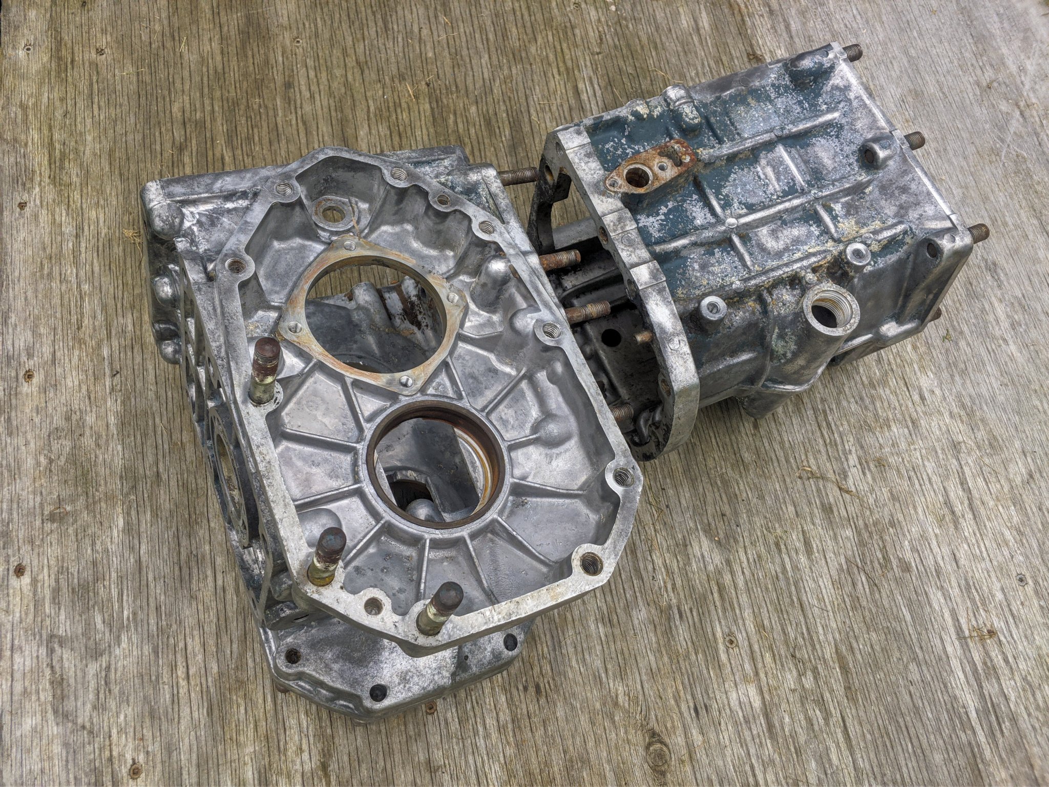

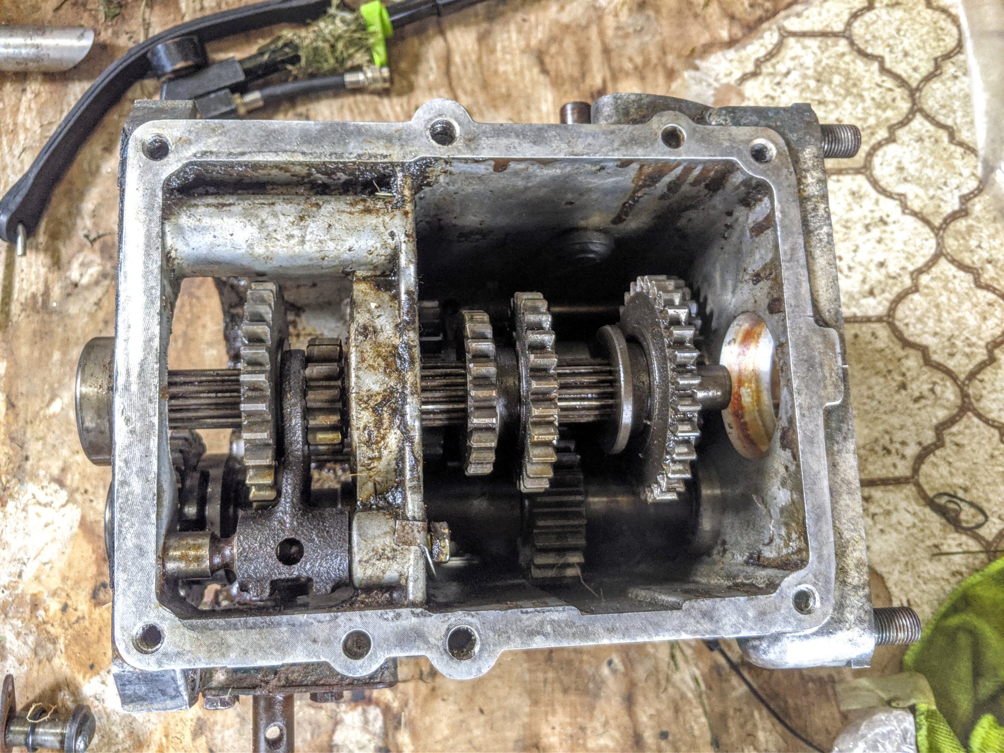

A couple of photos just before I started disassembly:

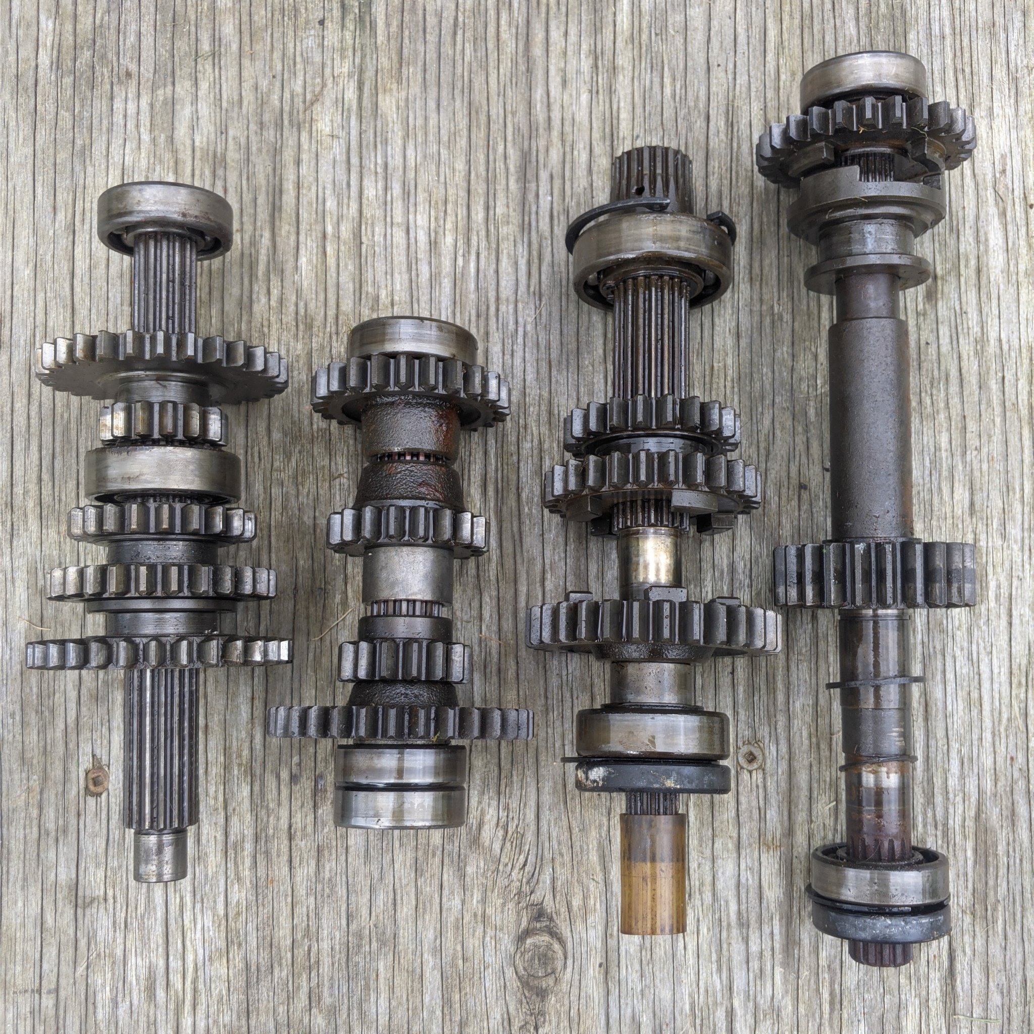

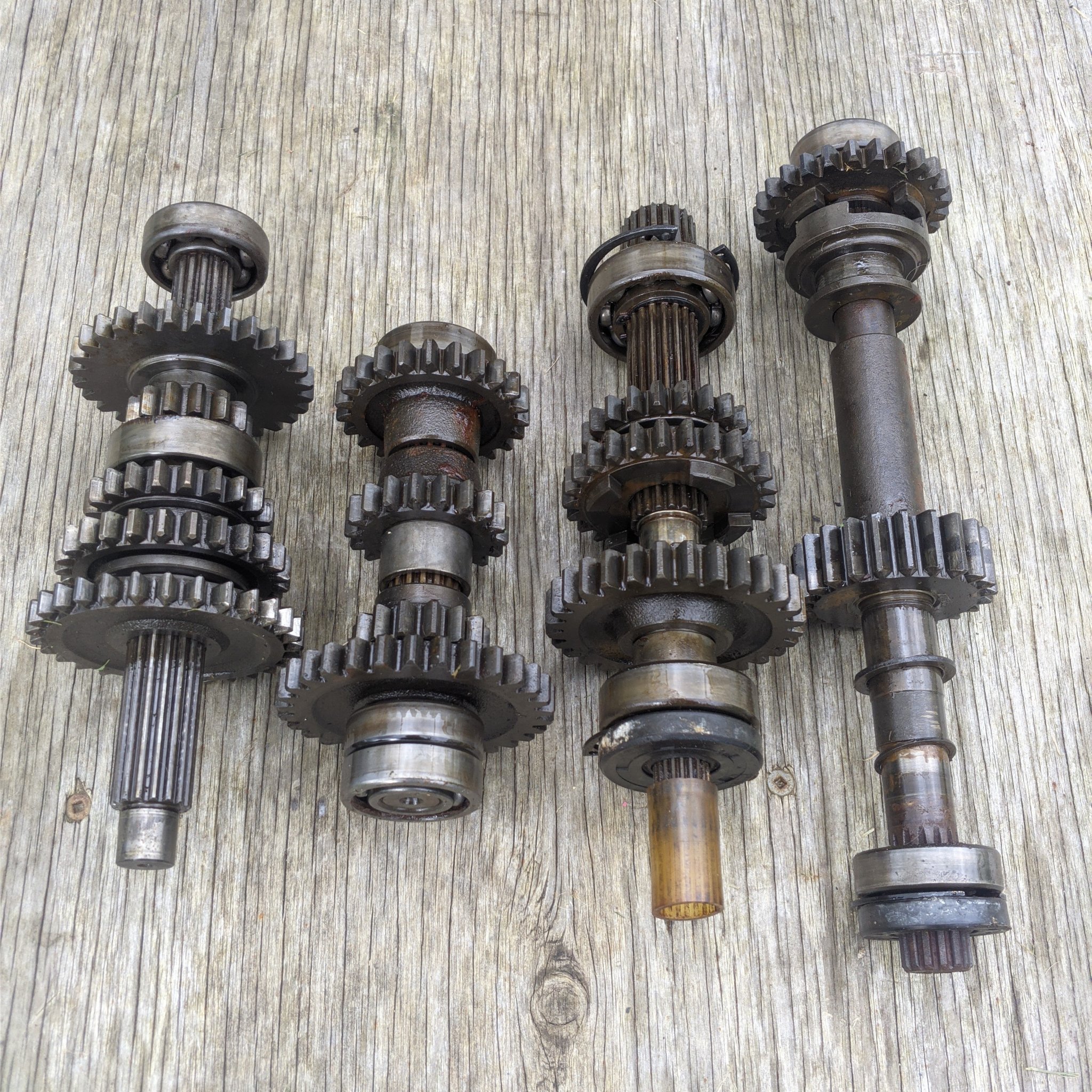

The service manual could be a bit clearer with the trans disassembly instructions. I managed to get all the shafts out but there were a few snap rings that needed to be removed from the middle of some shafts, not just the ones retaining the bearings at the ends. I removed the reverse shaft from the rear.
From left to right: 1st shaft, 2nd shaft, 3rd shaft, reverse shaft.

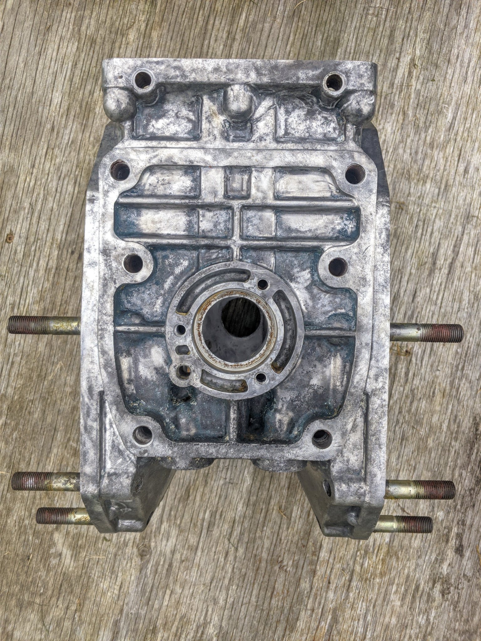

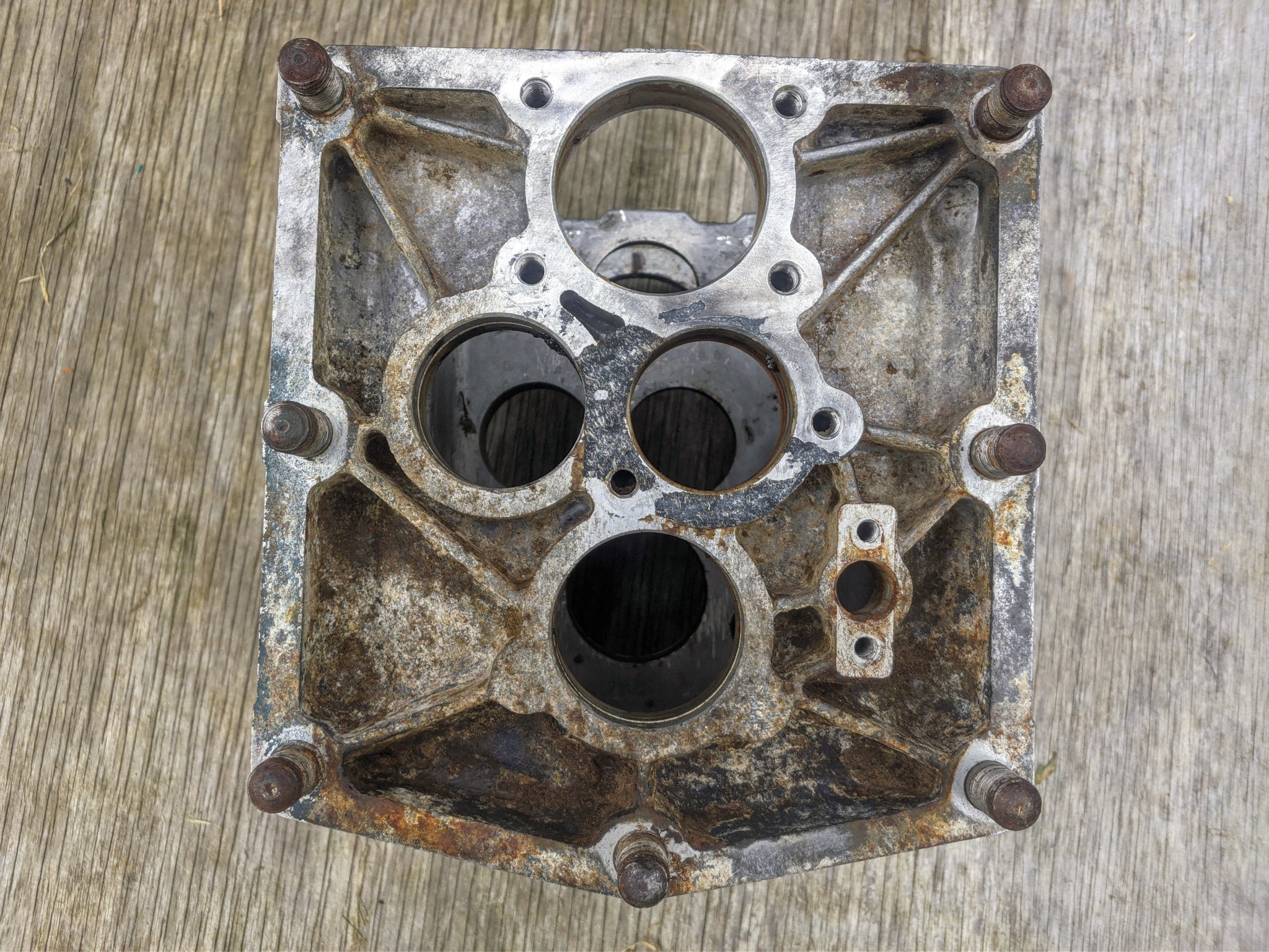

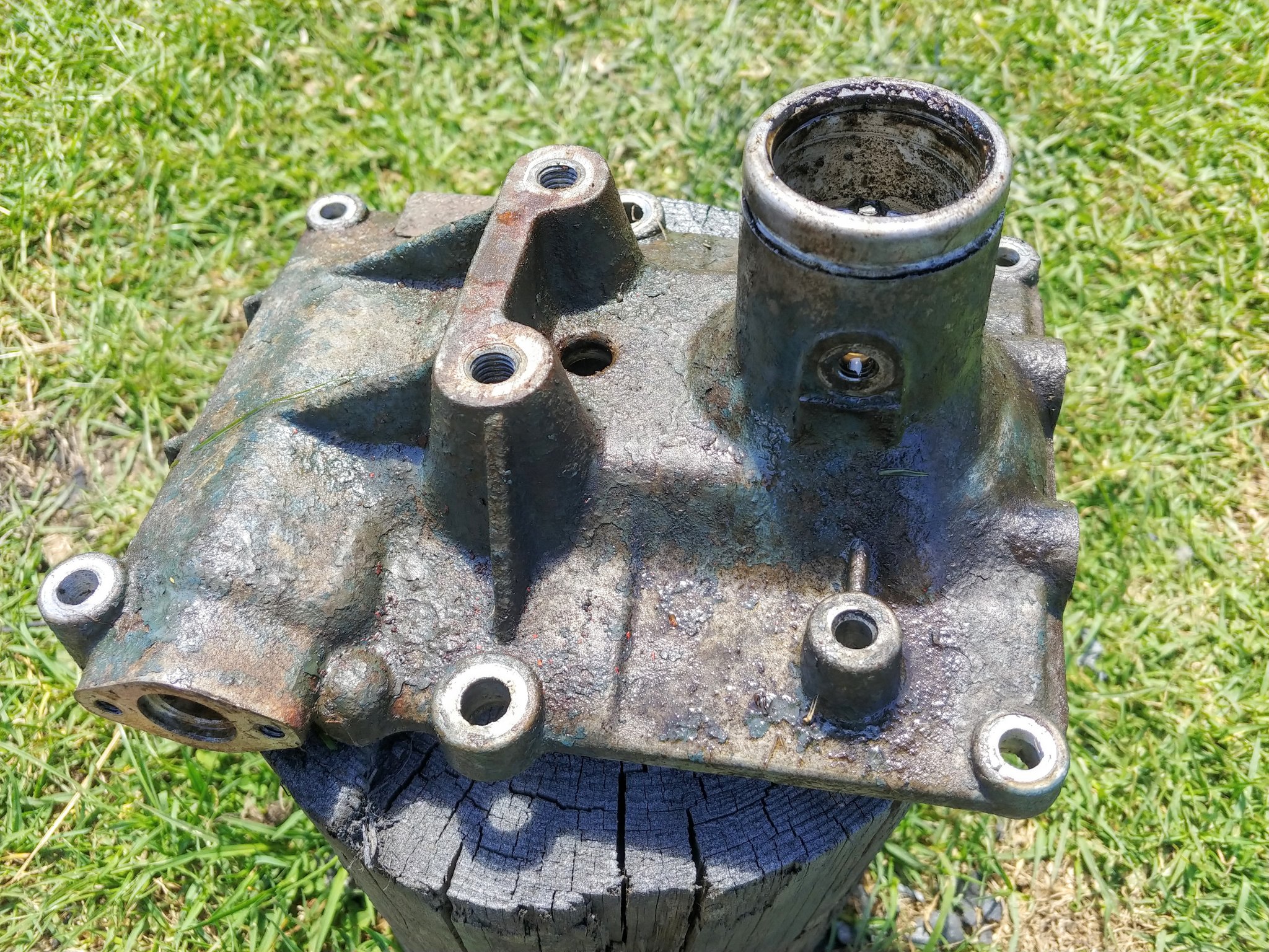

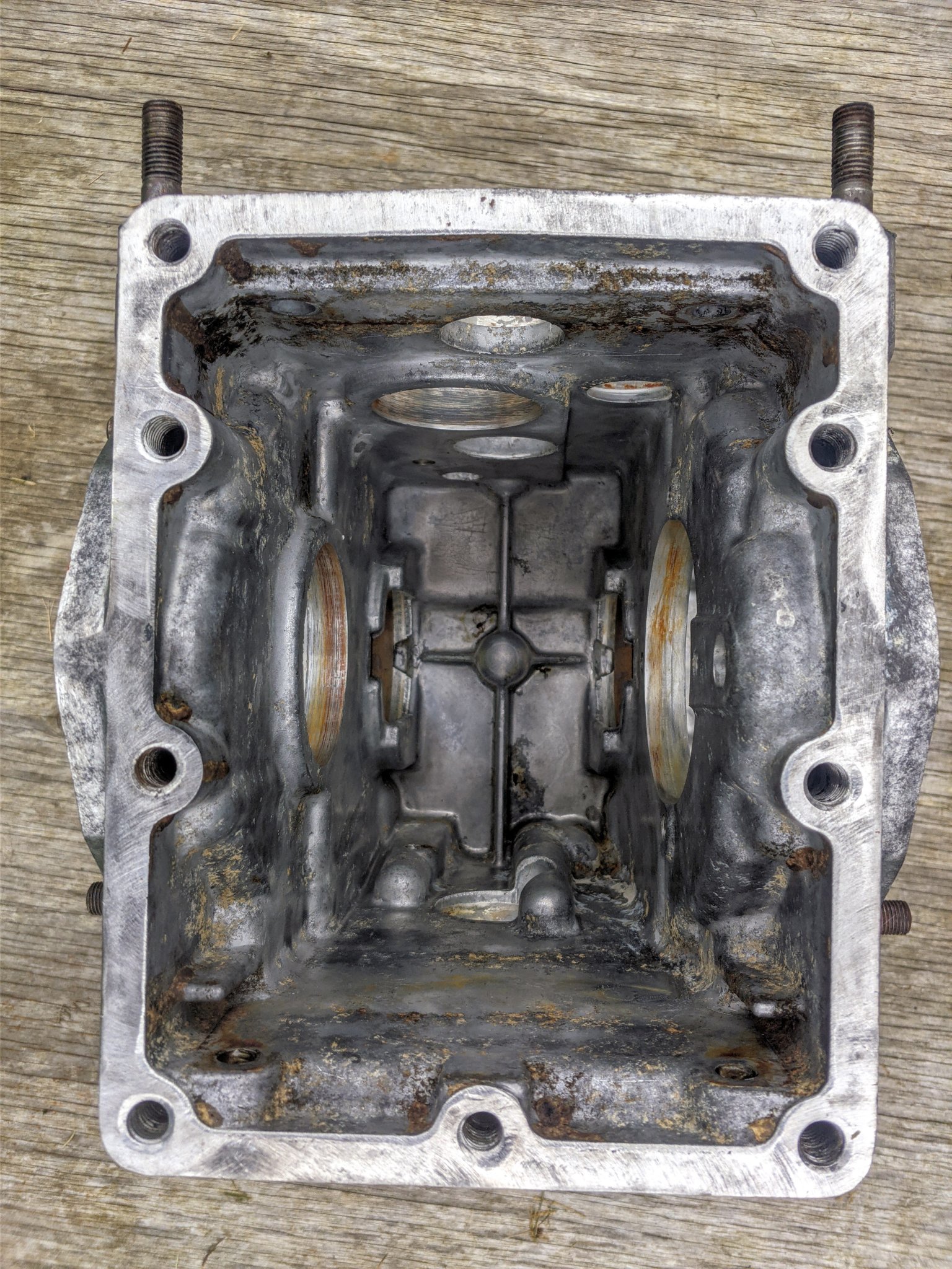

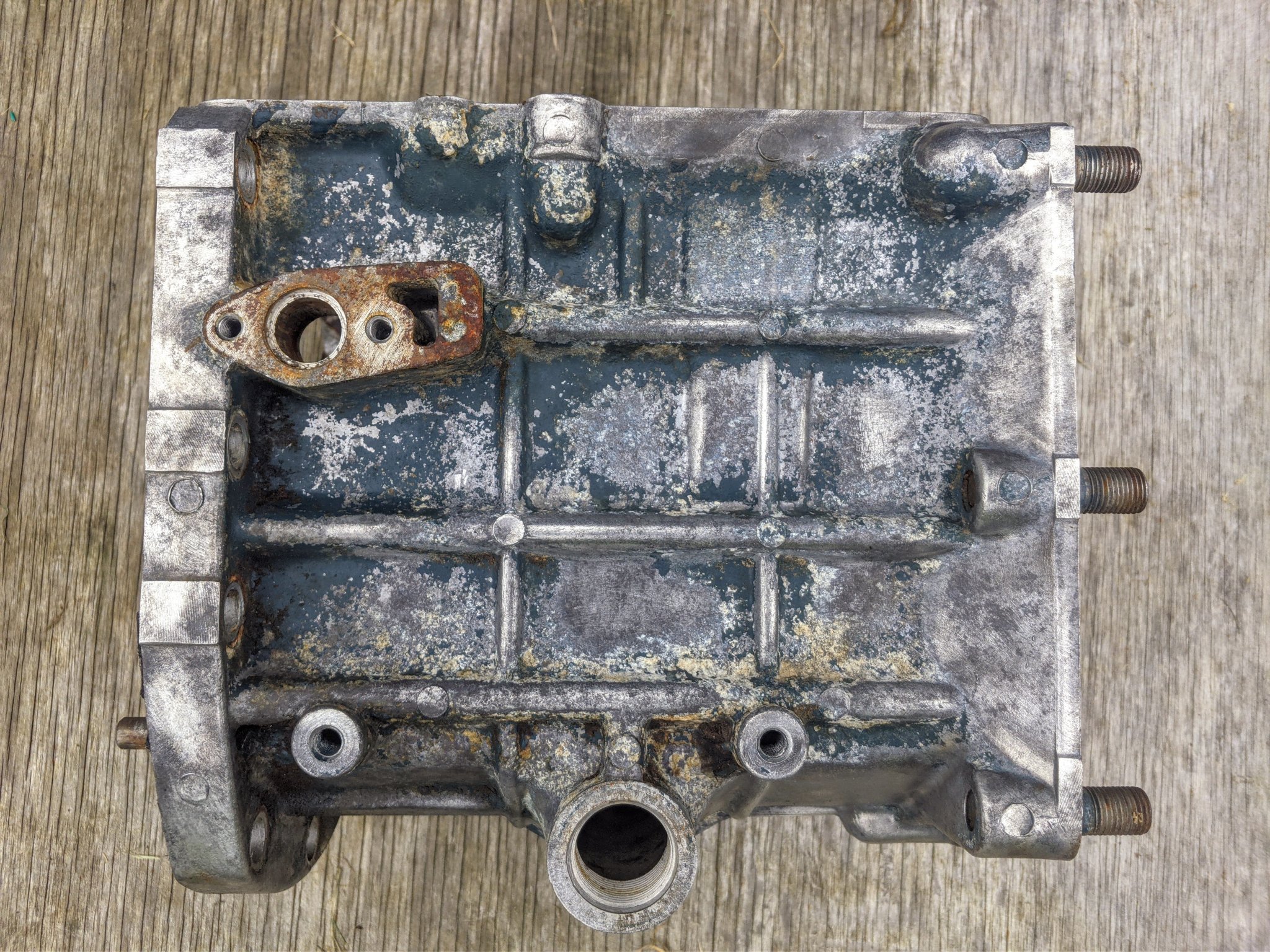

Some photos after waterblasting the trans
IMG_12-10-2022_11-44-11_8.3.252.jpg IMG_12-10-2022_11-43-47_8.3.252.jpg IMG_12-10-2022_11-43-37_8.3.252.jpg
And I'd already cleaned the diff
Yes, if you replace "front PTO" with "centre PTO". My model doesn't have an actual front PTO. And I found there are a few other threads on here that mention the centre PTO, it seems to only be on some models and the consensus seems to be that it was for a small mid mount mower.
