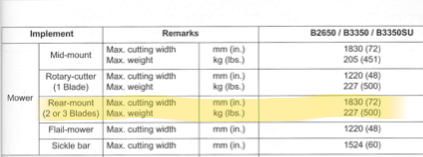

Its a B3350SU. I don't know how I can be mis-reading. The website says 500 max and so does my manual. See attached!

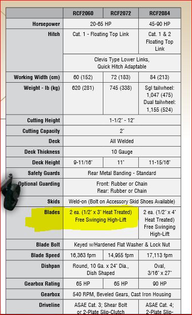

This might be a twist for you, but stick you head under the mower deck and count the blades, 2 right! Specs backs it up.
So on blade count 72" is max width, but yes you would be 120lbs over weight.
Take it to a scale and weigh it, I wouldn't be surprised if it wasn't less then they state in literature. ;)
So if your issue is SPIN UP, then they should take care of it based on the Blade count!
A Rear Mount Mower is different than a Rotary Cutter. You can use up to a 72" rear mount mower (finish mower) on a B3350 but only up to a 48" for a Rotary Cutter on a B3350.

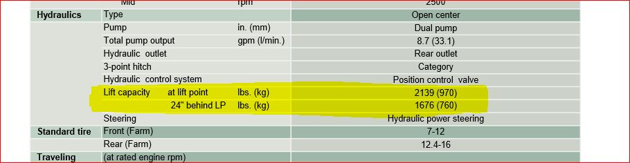

Just received a new B2601 today and was reviewing the owners manual. Is very much as gelliot says. While page 3 (Specifications) clearly says that my 3pt max lift force is 1808lbs (at pins) and 1411lbs (24" beyond), page 6 clearly states the tractor is incapable of using any implement heavier than 705 lbs (the backhoe-- most are under 500 lbs) without risking tractor "failure" (that is not covered by warranty). It also says a 48" rotary cutter is the widest usable on my tractor.
Given its almost impossible to find a recent Kubota owners manual in electronic form for advance reading prior to tractor purchase, seems fair to hold the dealer accountable for selling an implement that could void the warranty (unless that was made clear and would expect a signed document to that effect).
This is partially on the Kubota marketing department who wants to advertise the highest possible specifications vs the Kubota support department who wants to limit their liability by derating those same specifications. Suspect you see similar situations with other tractor manufacturers and you see it when reading the fine print from the big-3 on their trucks.

Here are the two relevant pages on implementation limitations from the B2650/B3350 manual.
More phone and email tag with my dealer on Friday. I've had my machine more than 1 month and still haven't connected up an impement to the PTO, at least I have the FEL but winter is coming and the field will not cut itself. He actually asked me to send him these two pages as well as he didn't have a spare manual for the machine either? ..... and still no hint of an approved implements list from Kuboda. Would have thought that would be readily available, even if it just contained the brands they owned / marketed with the size limitations. Starting to think Kuboda wrote this as an easy warranty trap door that most users would fall through
