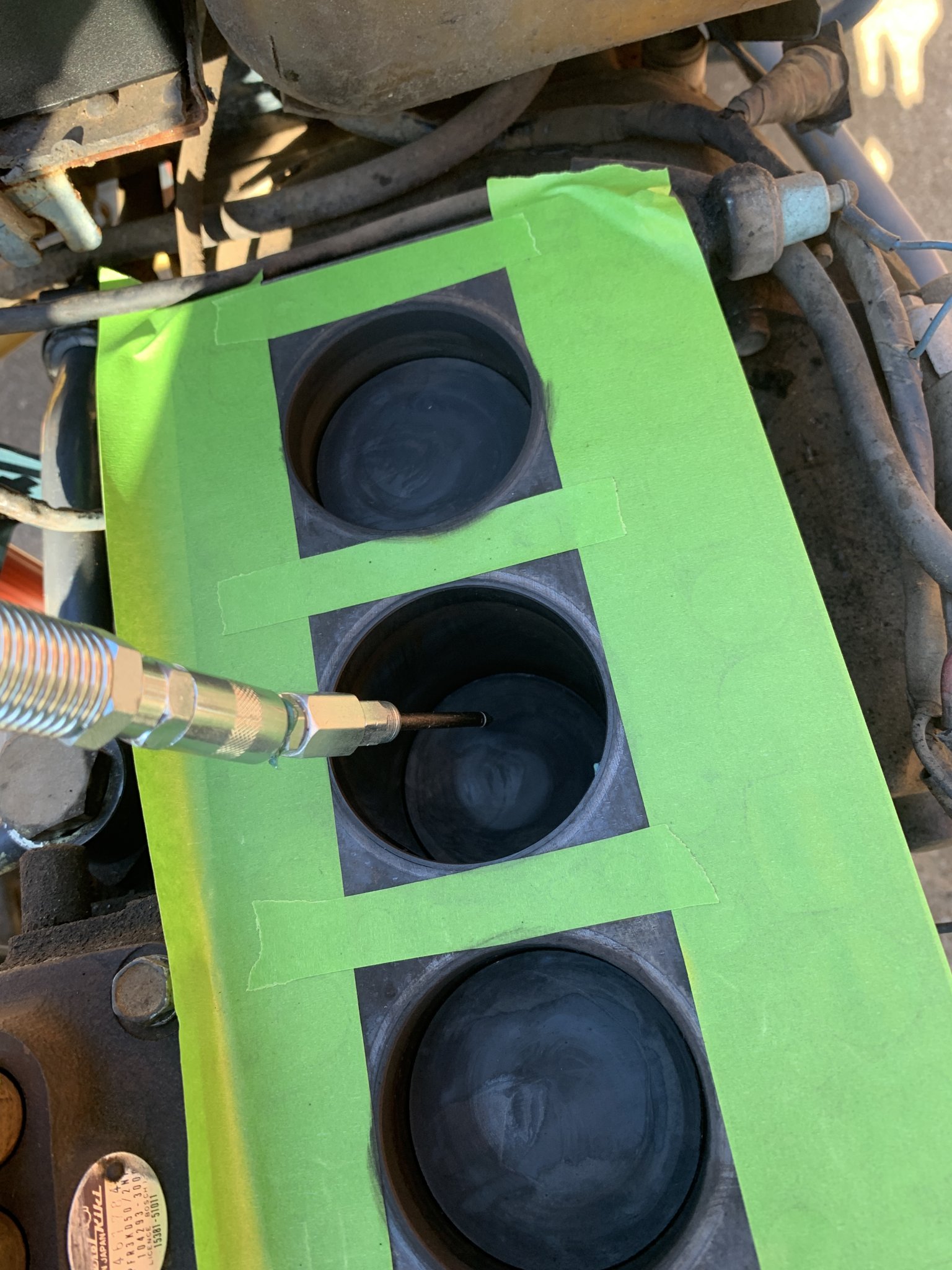

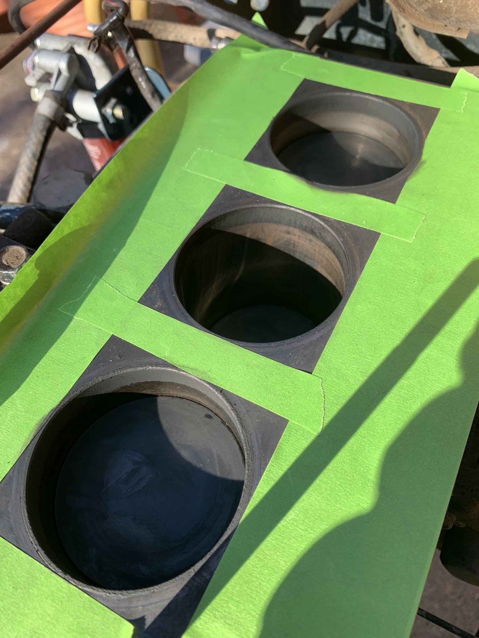

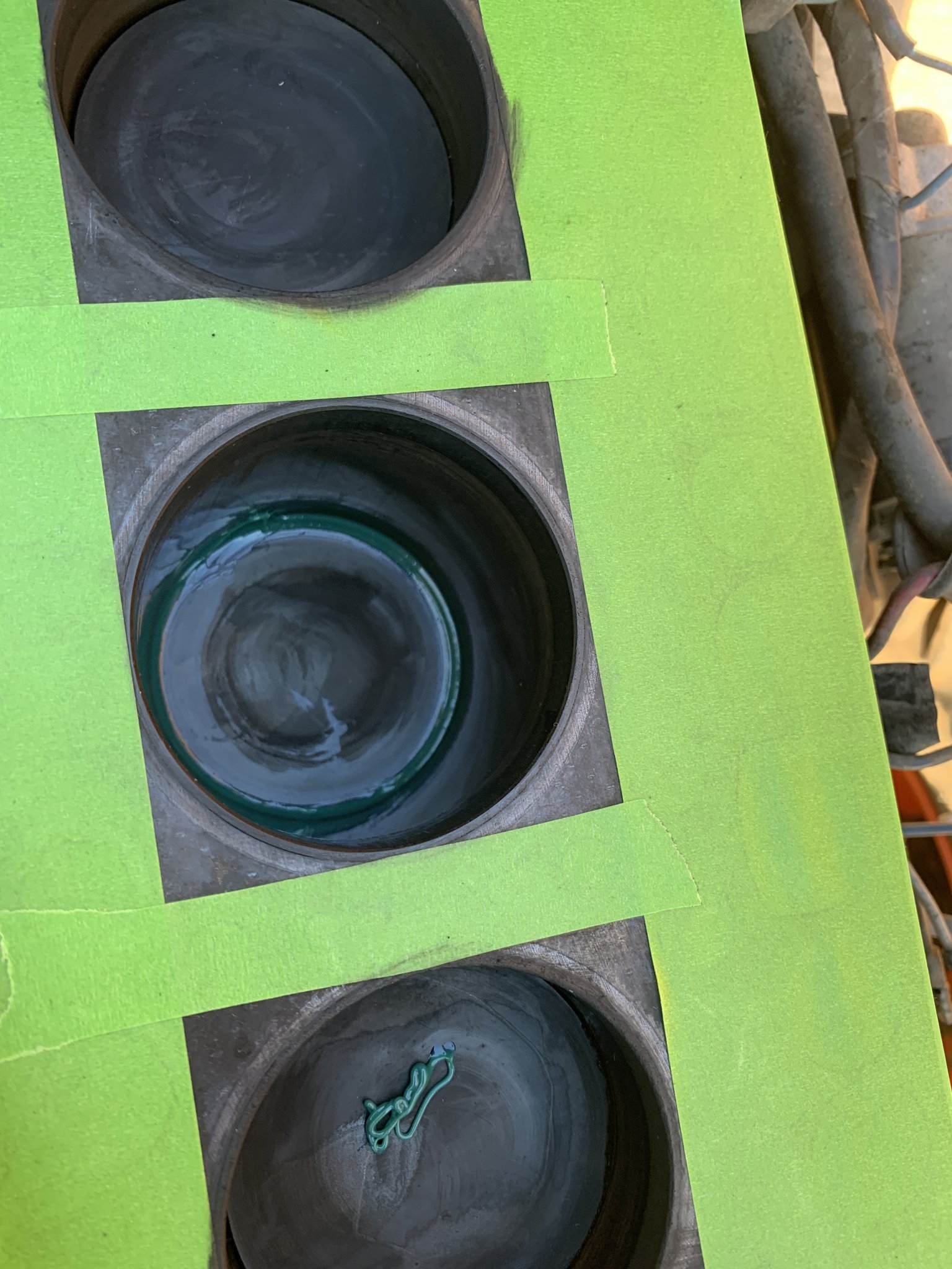

Arkansas, US
Clean and mask off all the cylinders, and deck surface. This is to prevent debris from entering the water and cam/lifter jacket. Position piston at the bottom of the bore. I inject grease with a needle greaser to get it packed in around the piston crown.

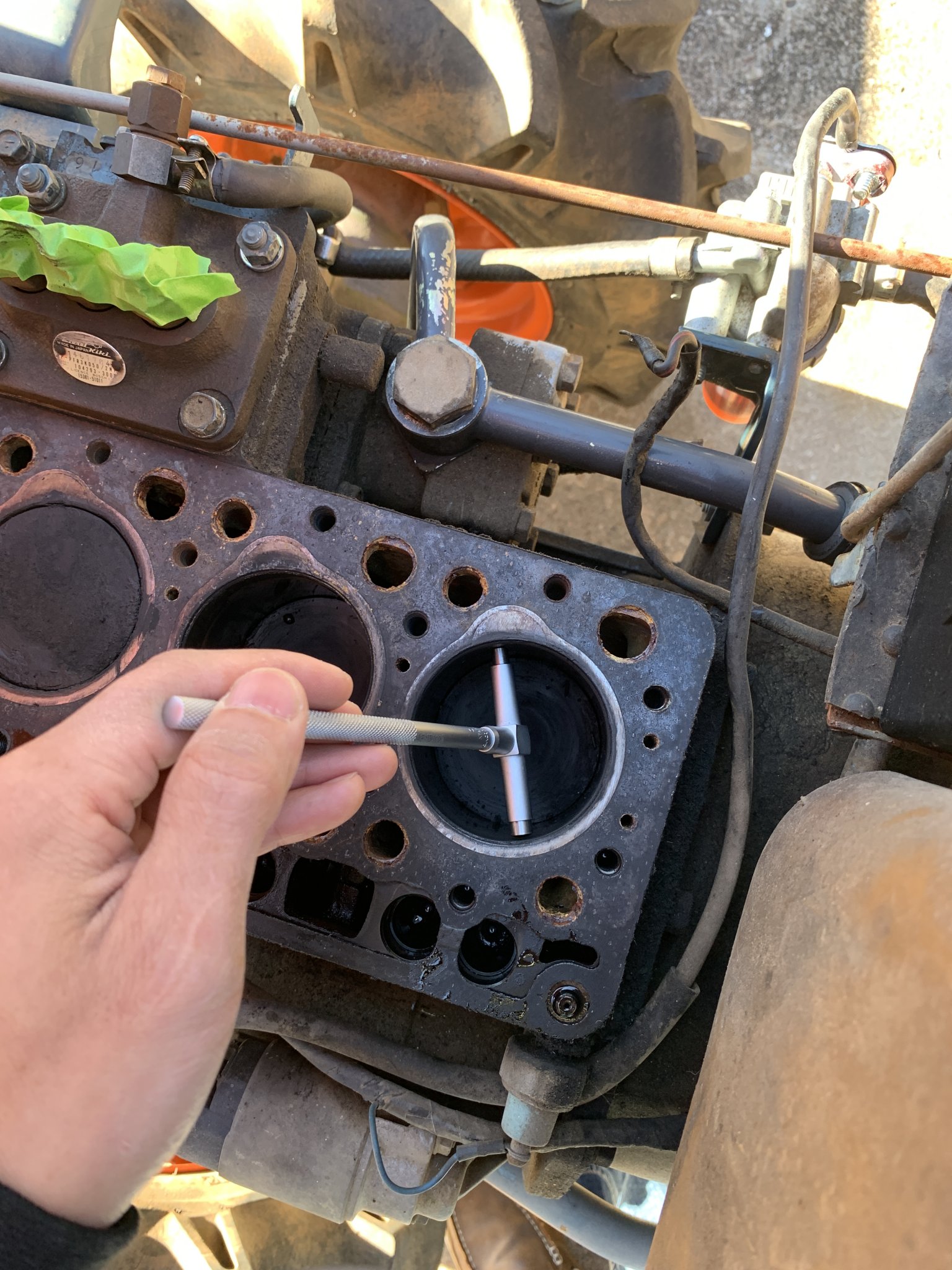

Arkansas, US
I use wd40 to lube the ball hone. Make sure it is sized appropriately for your bore. Run it at about 1/3rd trigger speed on most hand drills. Ensure to run the drill as the hone enters and leaves the cylinder. You are trying to run the hone at the same rotational speed, as you are in and out of the bore. This creates a 45' crest angle on the cross hatch.

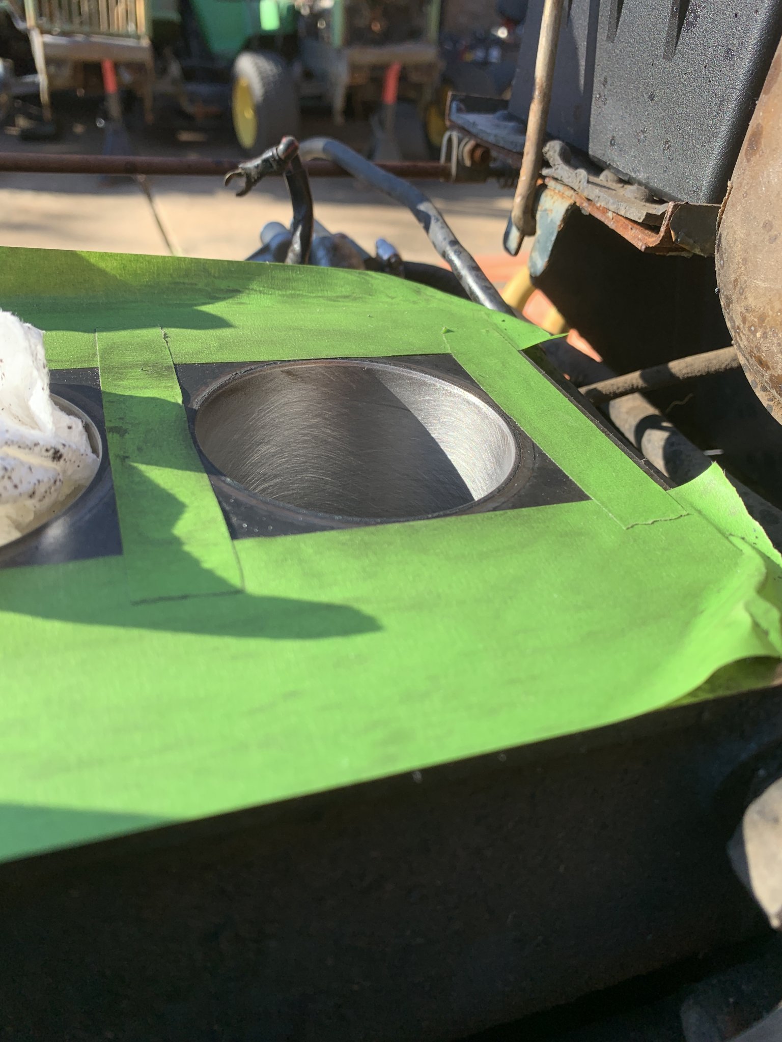

Arkansas, US
You should only run the hone long enough to remove the carbon trace, and get a good uniform hatch pattern. Usually no more than 15-30 seconds. Very little if any measurable material is removed if done correctly. I clean the bores with a carb cleaner soaked paper towel. This is the messy part as it takes several new towels to get the bore clean 4-6. Once the hole is clean, spin the piston up a 1/2 inch then back down to get the grease ring. Once you solvent clean the cylinder, then I use wd40 to wash lube the cylinder.
This is the most controversial part of this process. I know you will never be 100% surgical here, but if you can get the 99%, that is good enough. Think of all the carbon packed in those rings anyway. And by the way, you will notice the wd40 breaks up all that carbon/grease when you move the pistons up and down a few times. It is not abrasives, you already removed that...
