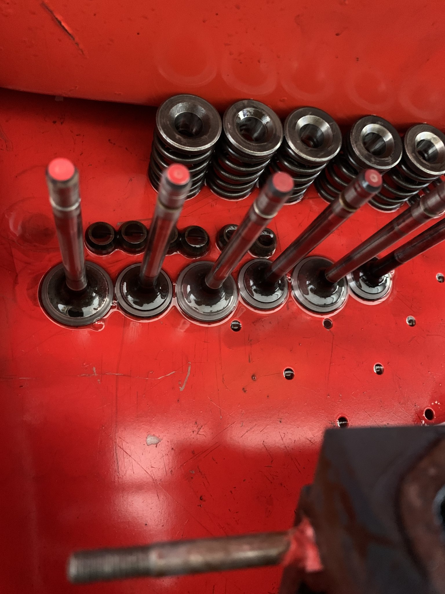

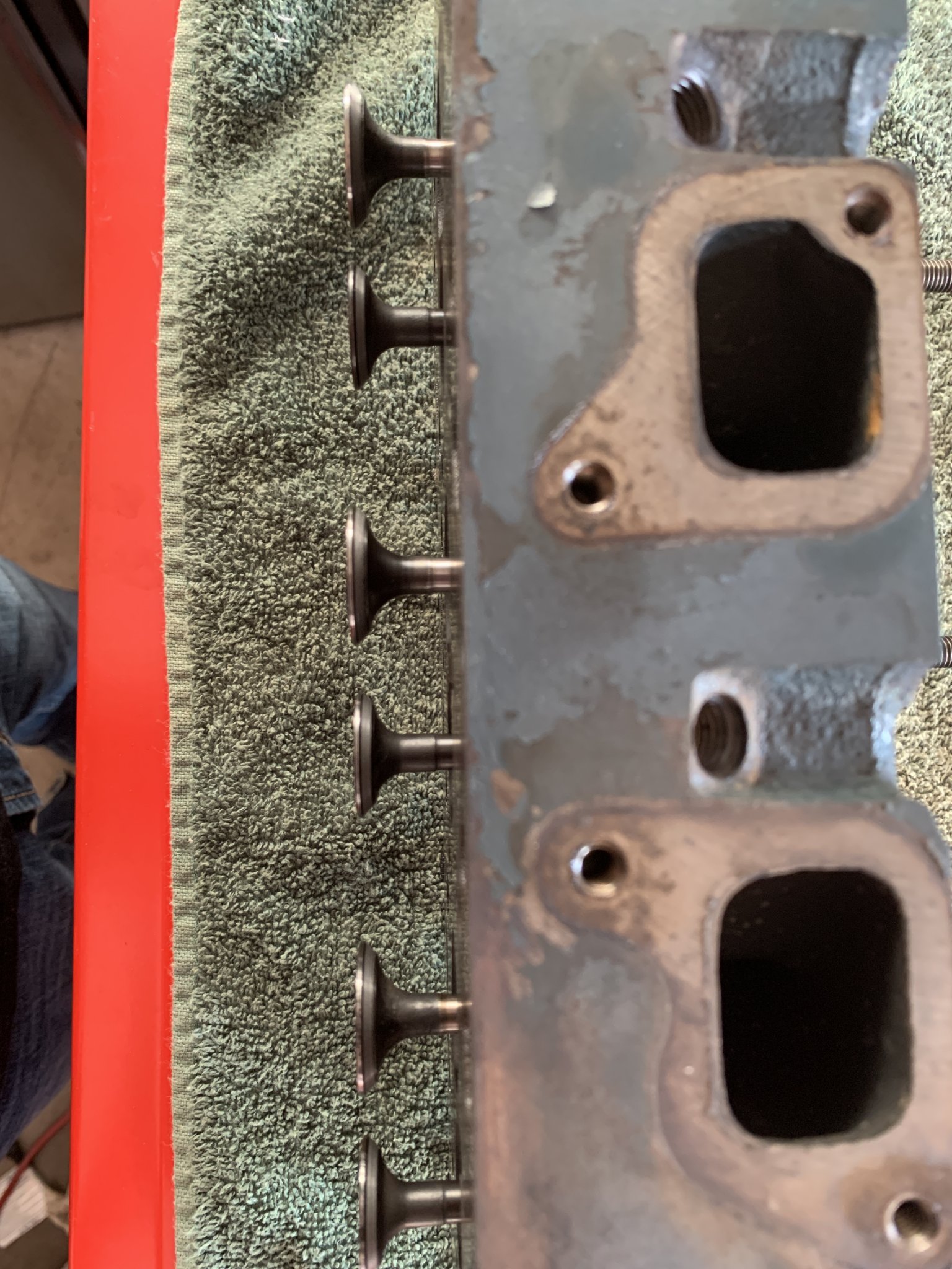

Valves lapped with both coarse, and fine compound. Head cleaned.
