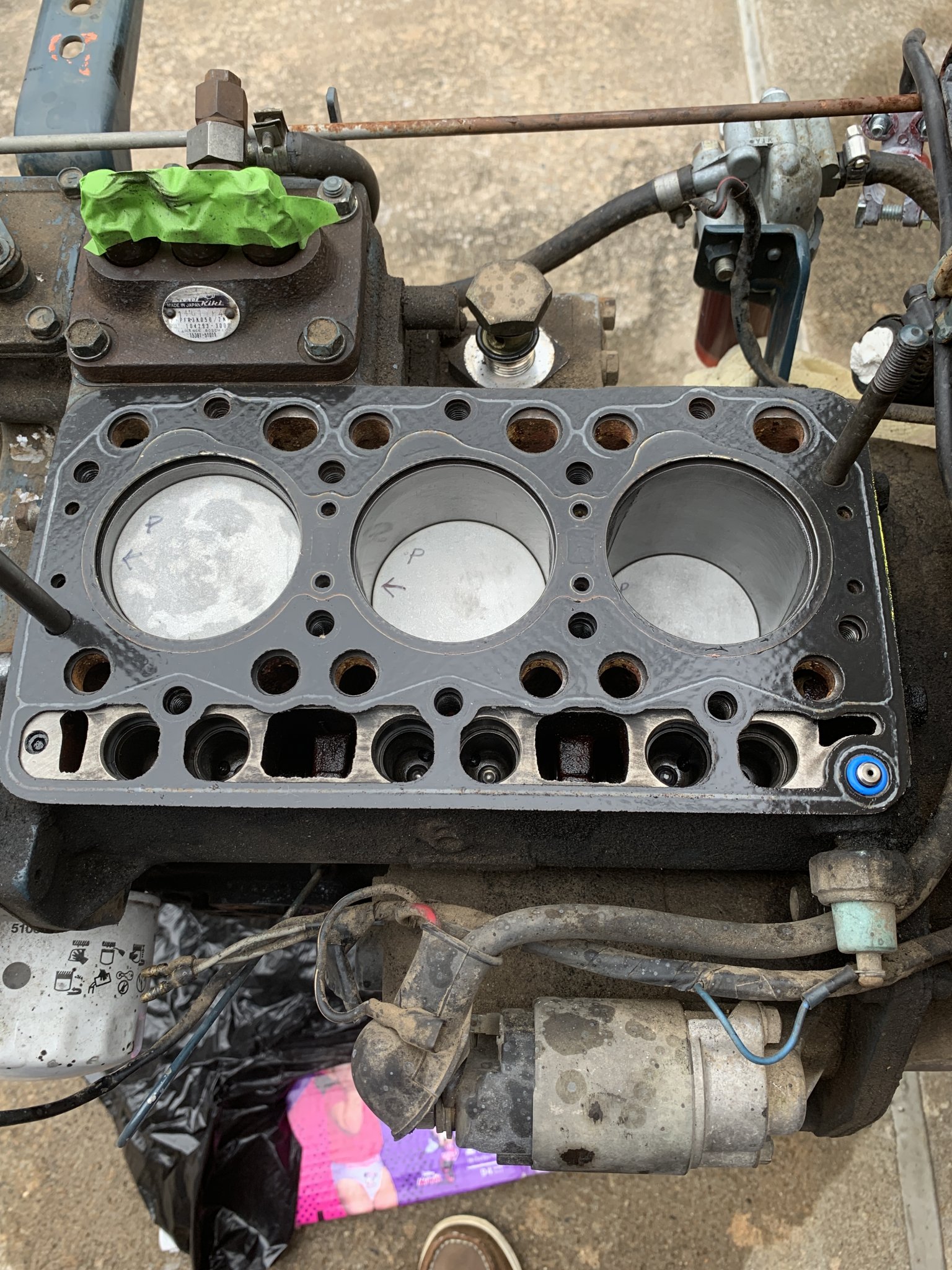

From the pics, it looks like the pistons/rings have failed to control oil…which has glazed the cylinder walls and contaminated the valve-stems. A differential compression-test would have revealed this defect and all this wasted work accomplished so-far could have been saved.

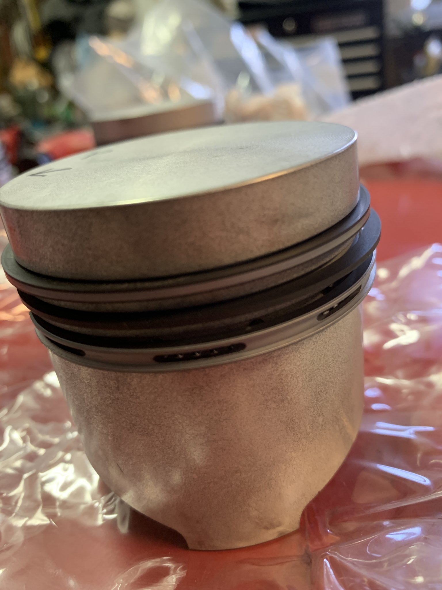

New parts showed up. Anyone doing these, pay very close attention to ring/piston orientation.

Moly rings hold oil and take some ungodly amount of heat but have one enemy. DIRT. One piece of grit from the hone will eat those rings alive. You have a zero percent chance of getting all of the grit out with the pistons in the bores.
