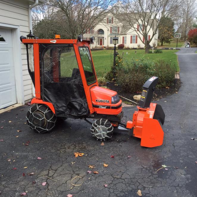

Thanks. Because of Global Warming, I got the Sims Cab on e-bay. It was in rough shape. The blower had a lot of wear as well. So I sprayed the blower and the cab. Then I used Slip Plate for the blower. You can brush it on, but I sprayed it. Don't know if you have ever seen it, but this version is designed for snow. It's basically graphite paint. So,when you get the heavy sticky snow, it doesn't clog anymore. I tried it last year from a spray can, and it really worked. Now this pic does not show the finished product, my 10 y/o made me put flames on the side of the blower. Not that's style'n, lol

And the envelope please...it snowed on Wednesday. Not bad, only 5",s.
It SUCKED!
On the paved road it was great, but on the driveways where it's had been seal coated, to was like being on ice.
Would not have mTtered if I had 4WD. SO, am I better of putting AG tires on this beast?

Ok, so I am not dropping 15k to get AWD. I have both rubber and chain. For blacktop that gets coated every year, I have found rubber to work the best as I always get a clean pass.
So, Can I add more weight to the rear? Chain has nothing to grip to on a sealed driveway.
If you get your driveway coated every year I don't see the big deal of some scratches in it but I completely understand not wanting to scratch it. I know where your coming from with the ice like feel of the seal coat. A neighbor next to my folks has a steep driveway and they get it coated every year. I laugh all the time watching that poor sap try to climb his drive with a Prius :p. Like someone said before, your best bet is to get your rear tires loaded. That would solve your worries about having too much weight on the axel because the weight will be directly to the ground and not sitting on the axels. Combined with the wheel weights that should do the trick. Very nice looking machine! Does it have heat in the cab too?!?

I think you need to add more weight to the rear end. You say you've got wheel weights, great, but they are not adding weight to the axles, so find a way to add another couple hundred pounds on the back end. Other wise, when you've got the blower lifted, the back end wants to come up, so it'll just spin spin spin...
I cleared my 200ft driveway for years with a Bolens 1050 10HP 2WD garden tractor with front mount blower, made in the 1960's. Had wheel weights & chains plus 150 pounds hanging on the back plus my 200 pounds on the seat. worked great, but it had diff lock-up which helped a lot.
Pete
This is the answer! Read it a couple more times...

Ag tires will be worse than what you have- less surface area to grip, and in snow/ice, the more biting edges, the better.
You need to counter the weight of the blower. If you can't do that effectively, then your setup isn't going to get it done.
Kubota selling them has nothing to do with you. The setup works fine within the realm of what it was designed for. You are pushing that envelope, and have entered the territory of why Kubota has so many models- to meet other needs. A 4WD tractor will offer two things, among many others- more weight, and the weight of that blower will be pushing down on powered front tires. It would make a lot of difference.
