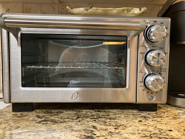

This topic has jinxed me. Yesterday an element failed in the toaster/oven.
These things are sorta throw-away items so $44.98 bought a new one.

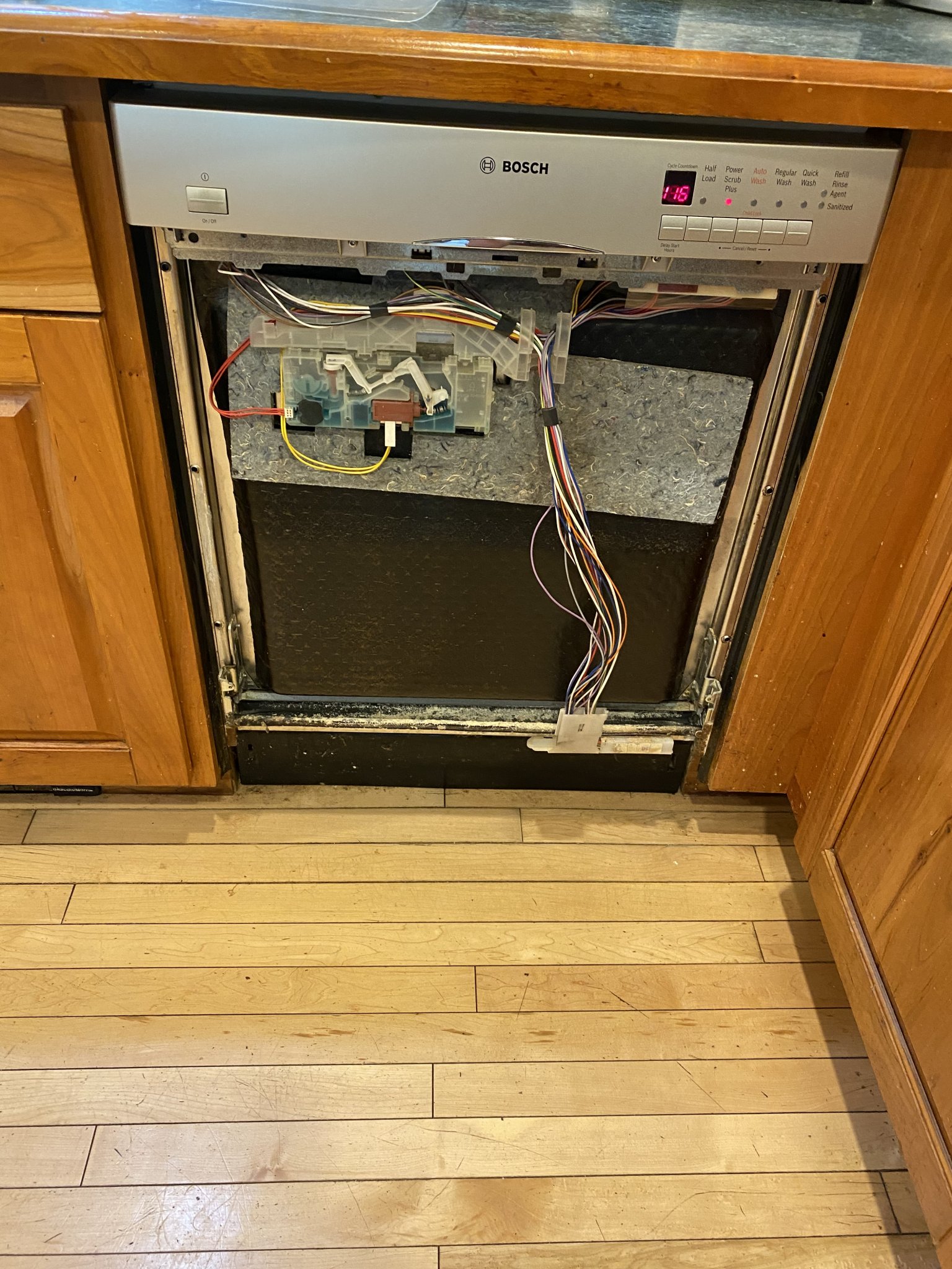

We had some minor flooding last night, the dishwasher door latch went wonky, and the Cable Box lost all sound......all at the same time. 🤬
Add those to tweaking my back that morning....😧
Flooding was contained by my redneck diversion ditches and swales...still have a driveway....
Took the dishwasher door all apart. Was able to fix the latch for now...$55 for new part if it doesn't hold. Was a joy with my back screaming at me....

Guess I did jinx myself too.
Old latch didn't hold. Took it apart Monday night to order new part ($55).
While doing so, broke both of the small holding tabs on the plastic control panel cover.....($120). 🤬 :oops: 🤬 Yep, I used some bad words, most directed at myself….
Those have been a problem on this dishwasher. The replacement is #4.....:oops:
Www.Repairclinic.com got me back in business....I don't like the prices, but their parts are great. Never an issue. Definitely recommend them for OEM parts at a fair price.
Ordered Monday night and here Wednesday afternoon. Quick service too. Important for appliance parts.
Will run a couple wash cycles before putting outside cover back on.
