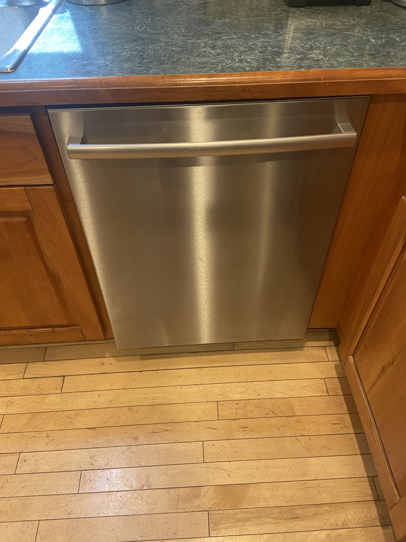

Bosch dishwasher. While I had the old Bosch apart many times over the years, it was a good machine.
This one is not one of the fancy series like the old one, but seems to be pretty good. Amazing how quiet it is.

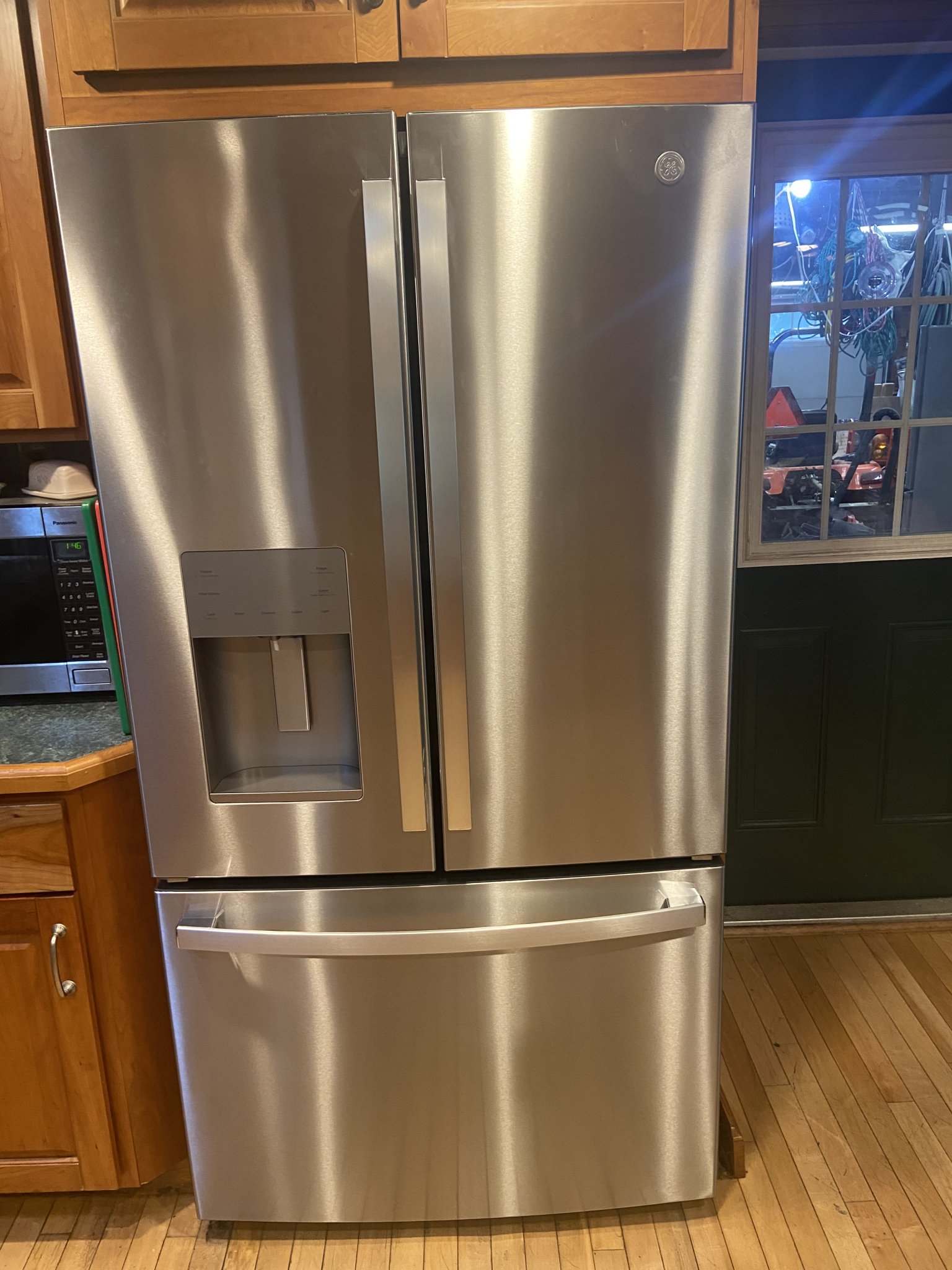

Second GE Refrigerator. The “beer” fridge in the garage is a GE. Seems to be a good one.
The owner of the appliance store said there’s no such thing as a good ice maker. Repeatedly replaced the ice maker on the Maytag/Whirlpool fridge. The Whirlpool had some problems over the years as well.

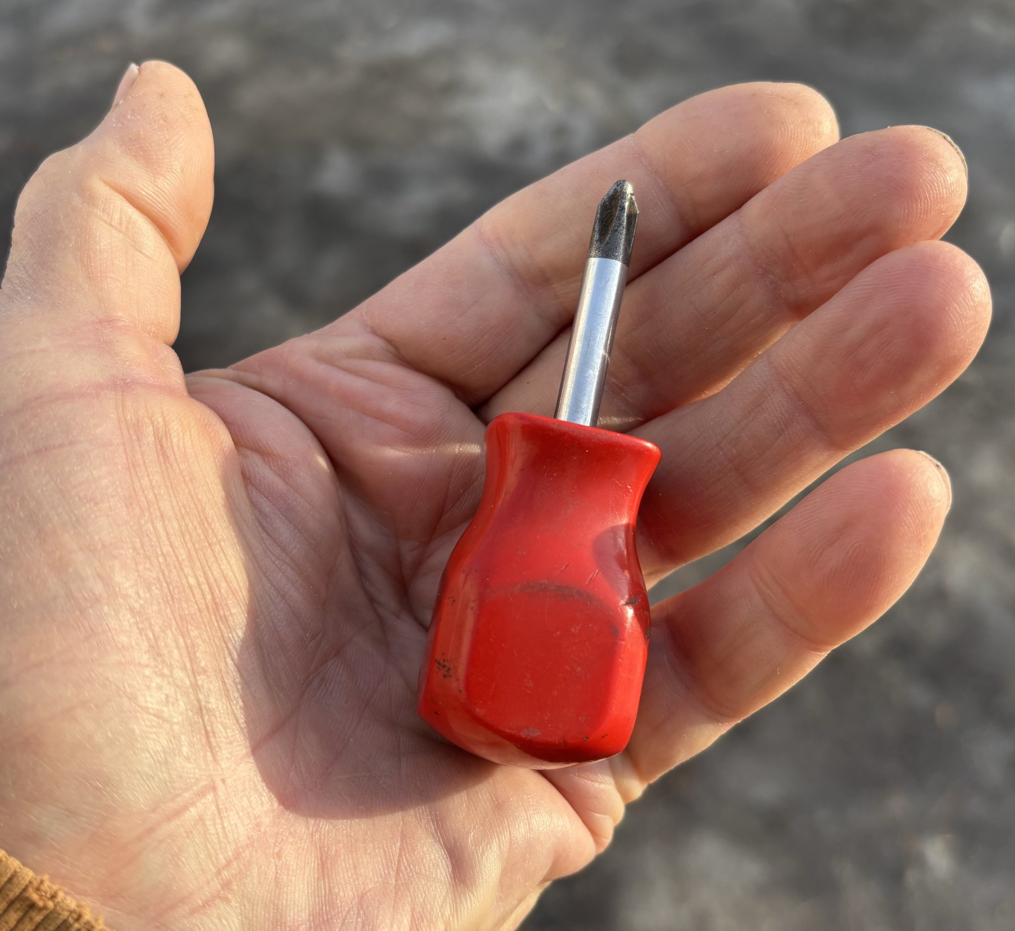

Last Jan/Feb had been so cold here that this used to be a full sized screwdriver!

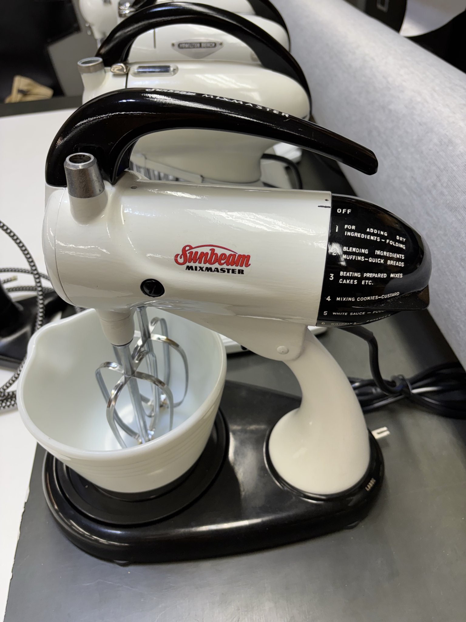

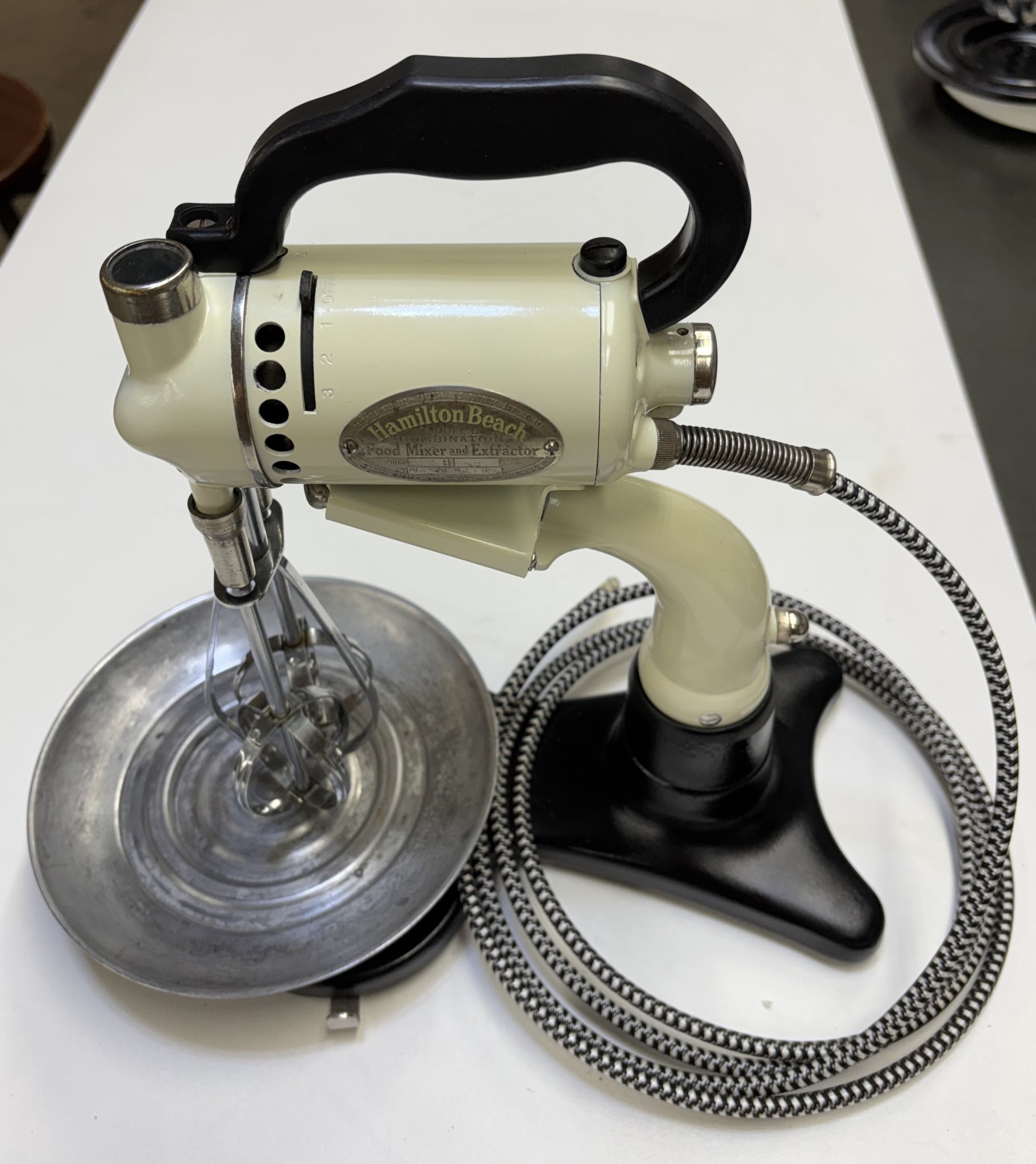

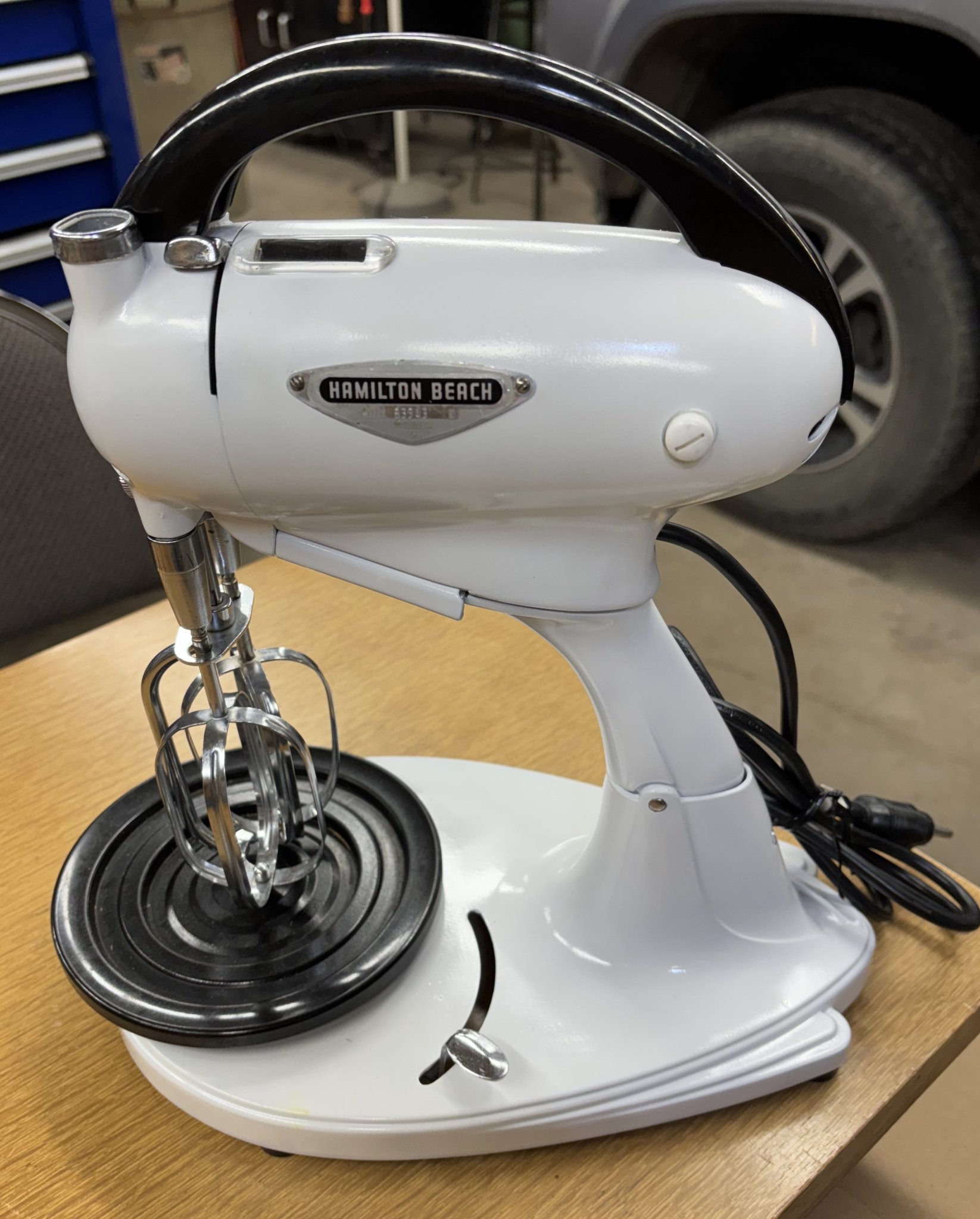

It was time to empty some "project bins" and stay in the shop as much as possible. In addition to restoring the old fashioned malt mixers, the vintage stand mixers are kind of fun to bring back to life. These get stripped to the bone, sandblasted, parts painted and baked, commutator lathe turned, new brushes, new rubber feet, oiled and motors run in for a bit. Essentially they are just about new old stock again.
I'll redo them for family & friends. Some are given as gifts to those that could use them. And I have sold a few. With only one exception, all the mixers need is a complete stripping of old hard grease and the rest of process mentioned and they'll run like new again. The one exception must have led a very hard life, as its metal gears had been completely worn out and the commutator damaged excessively from never changing out the brushes.
Here's a few pics of the latest group of finished mixers dating from the 1930s to 1950s:
Group of Rebuilt Mixers.JPG Circa 1930 Hamilton Beach Model B Mixer.JPG Hamilton Beach Model G Mixer.JPG Circa 1950 Sunbeam MixMaster.JPG
