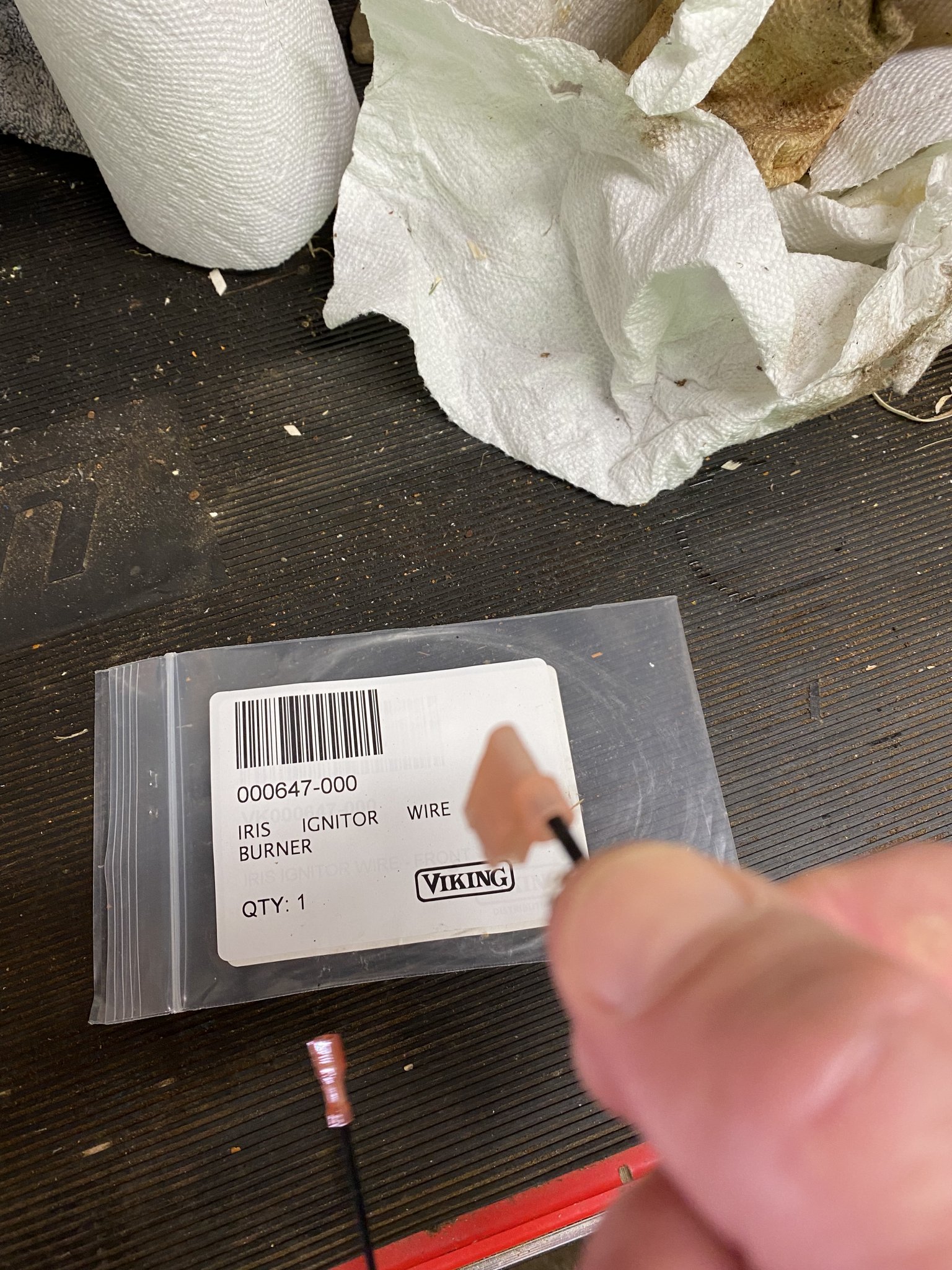

Our 12-year old Viking Professional Rangetop (propane) had a starting issue with one burner.
Thought it was starter coil ($90). Didn't fix it. Keep old one as a spare.
Ignitor a little wonky, and wire to ignitor had some heat damage at spade connections. A little scrub, scrub and wiggle, wiggle. Works good as new, but there is some damage...
Figured good to have a couple ignitors on hand, as well as the wire connections......
The ignitor is part of the $133 burner base. Found a replacement ignitor-only for $20, without the base. I'm okay with that.
Get this, the WIRE is $22....WTF?!?!?
$22 for a 12" piece of wire with 2 spade connectors?!?!? Maybe 14 gauge...
Both spades are a little special; one a 90* flag, and the igniter end small, but something I can get in packs 50 for $10. I'm betting I have a suitable wire here already.
As I had the cook top all put together again, I bought the wire online so I have an example to go by. I whimpered when doing so....I whimpered a lot.
You can bet I'm gonna make my own hereafter....

the 'wire' I assume is the ignitor wire ? If so, it is 'special' NOT regular house wiring wire. It'll probably be stranded, tinned, have high voltage insulation,maybe teflon so 'dbl sheathed) (10-25 KV),special crimps( again HV rated...).. at $22 not a bad deal in the grand scheme of things AND you did GET the parts !

Jay - I’ll be curious to see what the wire looks like when I get it.

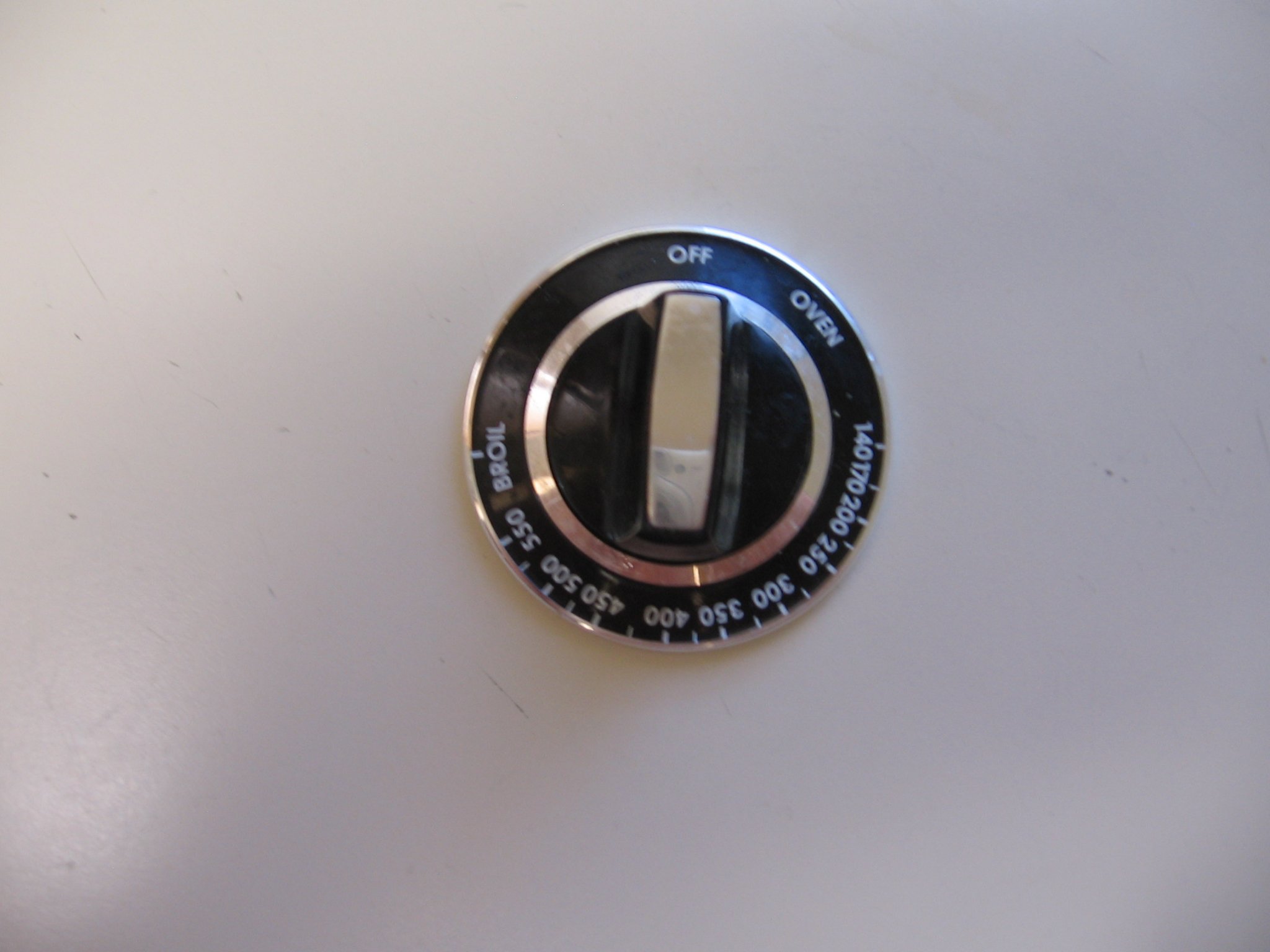

I recently was asked by the wife to replace the oven control knob on our Whirlpool gas range/oven.
(The temp numbers were worn off.)
Went to the local parts warehouse and was told it was in stock, $48 plus tax. Went online and found it for $58, plus shipping. Shocked, I called a little Mom&Pop shop, and they had it for $22, and when I grumbled a little, they sold it to me for $18 plus tax.
I guess I got into the wrong business years ago.
The numbers etc wore off on my 50 yr old cooktop a few years ago, so I took some white nail polish and covered the area and then wiped most of it off, leaving the numbers in their depressions and the tick marks highlighted. When dry I covered with clear nail polish. It has lasted about 5 years.

The numbers on this knob were silk screened on, (poorly) with no depressions to fill.
If I still had access to the full machine shop at work, I would have set it up on a rotary table and used a pantograph engraver to simply engrave new tick marks & numbers. But alas....

fwiw when it comes to 'ignition wire' I've always just used the wire we sell for oil burner ignition. It's high temp rated and insulated for well over 10 kilovolts. I've also used automotive ignition wire (with copper conductor). I have a multi-lifetime supply of spade terminals.

I kick myself for not taking a picture of the wire when I had it out.
It really didn’t feel or seem special, but point taken given it’s purpose. Honestly the spade connectors looked run of the mill.
Hopefully when it’s delivered we can figure it out.
Appreciate the help.

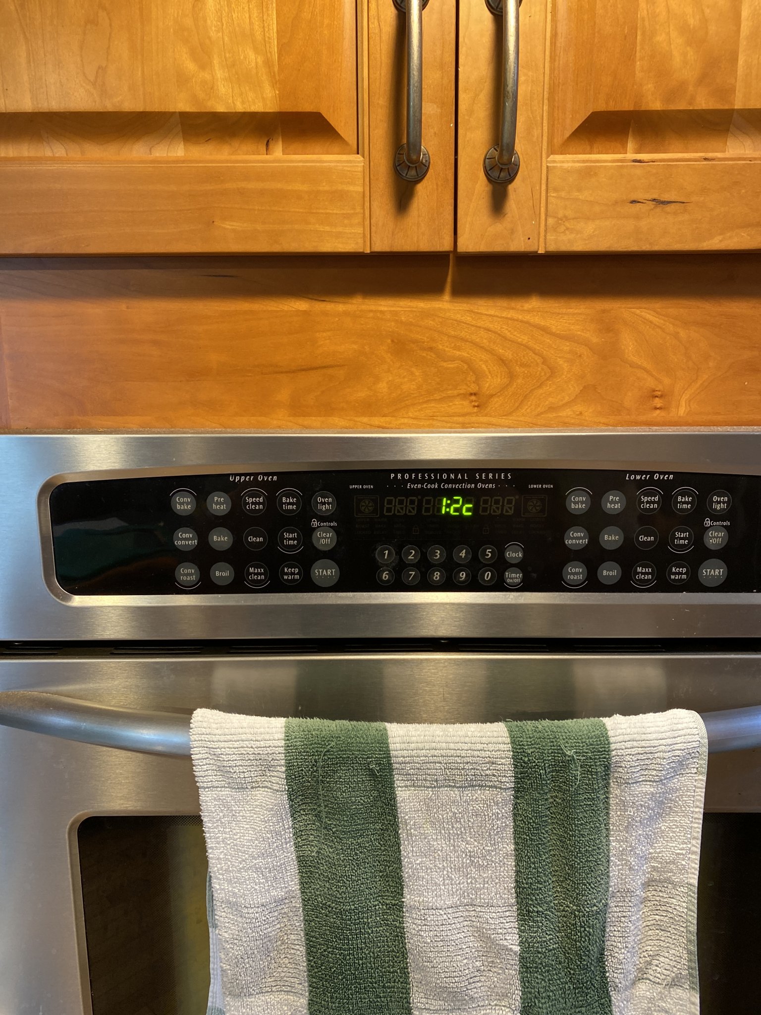

Jay - I’ve got a wall oven that I just know will have panel issues sooner or later. Matter of time…..tick,tick, tick…. The numbers are working; camera just didn’t capture it all.
I have that exact wall oven and was think about the same thing every time I look at it. It's going on 14 years old so it's time is likely coming.

Trust me, no expert. The connectors are not special.
The wire is maybe 16-18 gauge…2.25mm OD with insulation.
The cover is shiny and has a texture to it I don’t see in “standard” wire.
