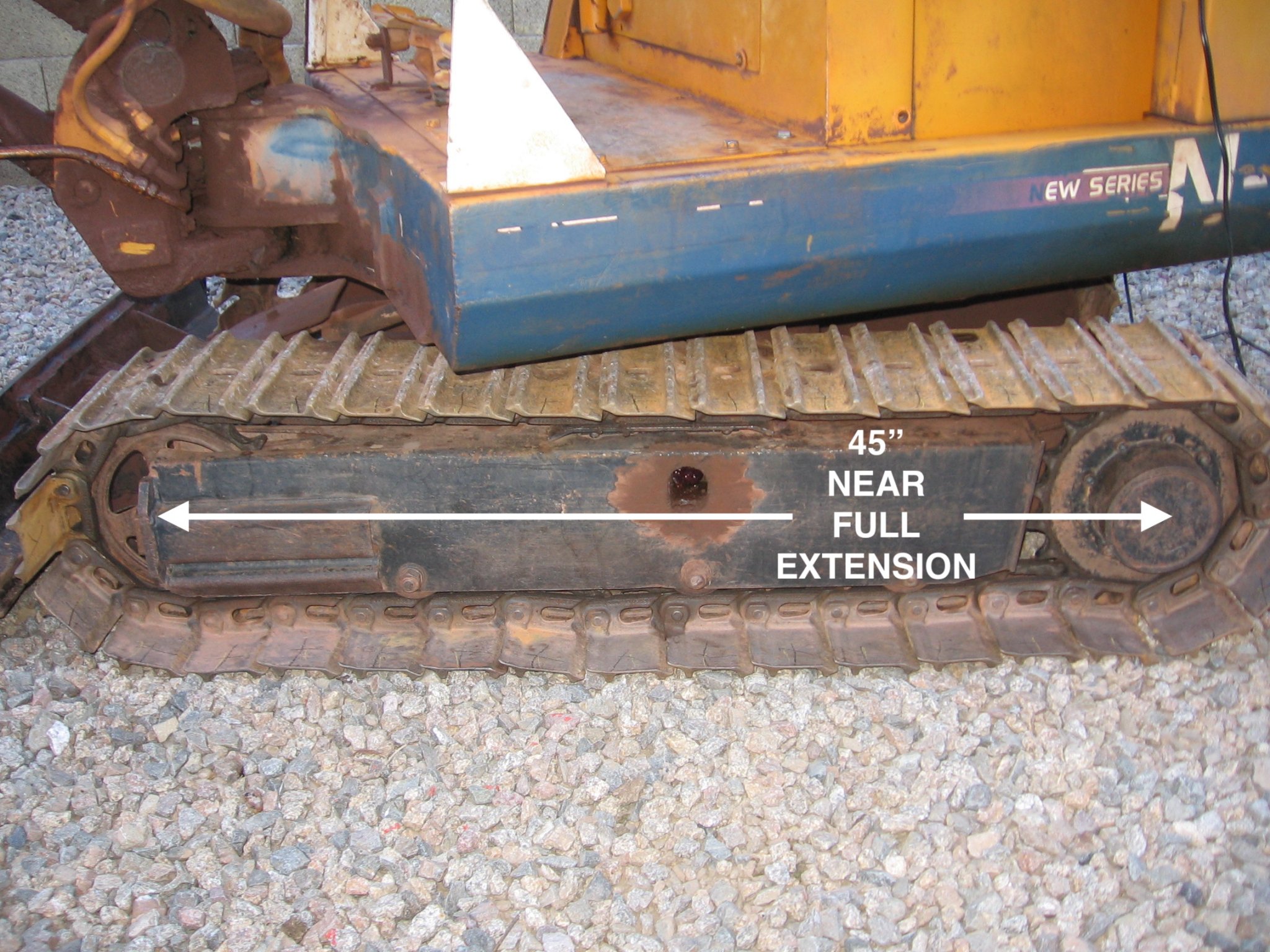

I assume the center-to-center distance will be the same:
this is about the same, i have new tracks on and at tension its about 112cm ~44 inches. but for the life of me, i could not count the idler teeth, id say its quite similar. theres 2 teeth inside each rubber "slab", so id say its the same, seems that its the same under carriage..

The track size & picture is very helpful, it appears we both have the same track drive system, as you say.
The vendor I was planning on buying from sells two tracks that are supposed to fit this model, (230x48x66, and 230x96x33) but could not tell me which one I should order. They guessed I should order 230x48x66, but after studying your pic, I'm sure I need to order the size you stated.

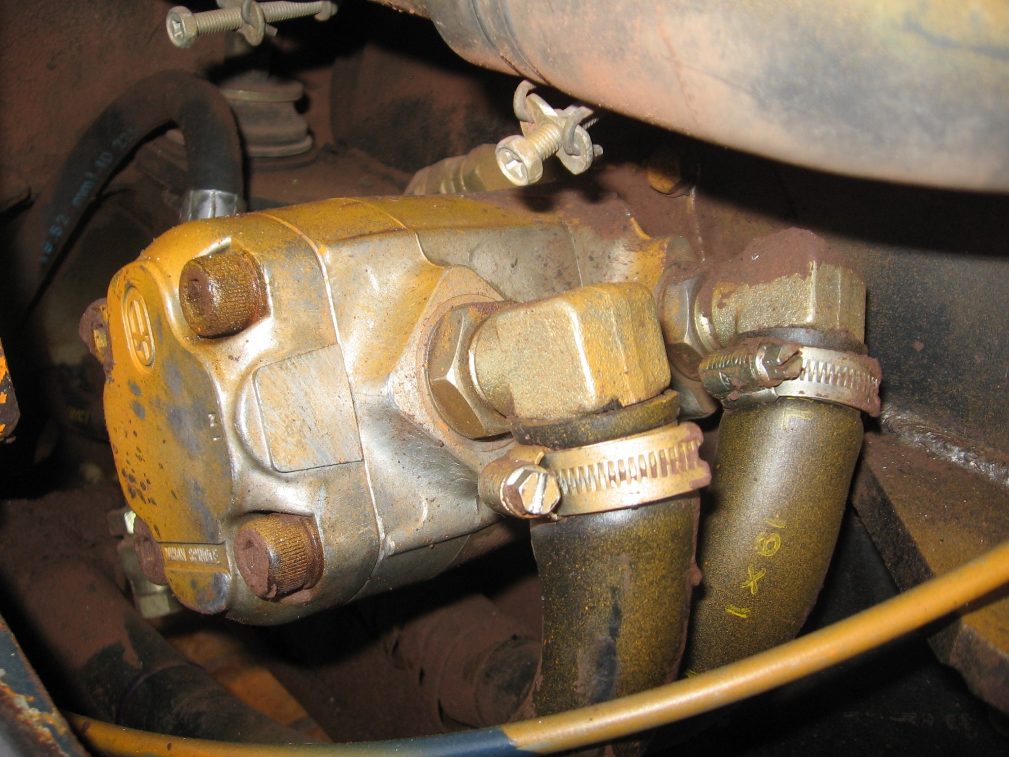

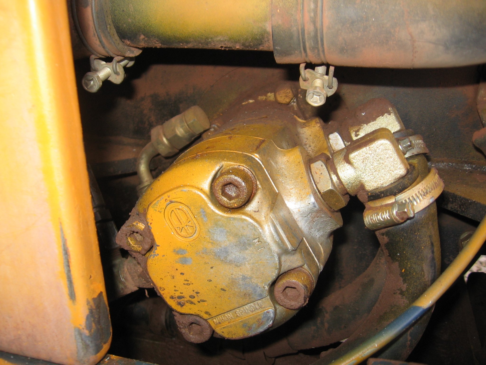

Took pics of the hydraulic pump, but I could not find any model numbers, capacities, or anything on the pump, might be where I can't see it or covered by dirt/grease.
On the end of the pump were the words "NIHON SPINDLE"

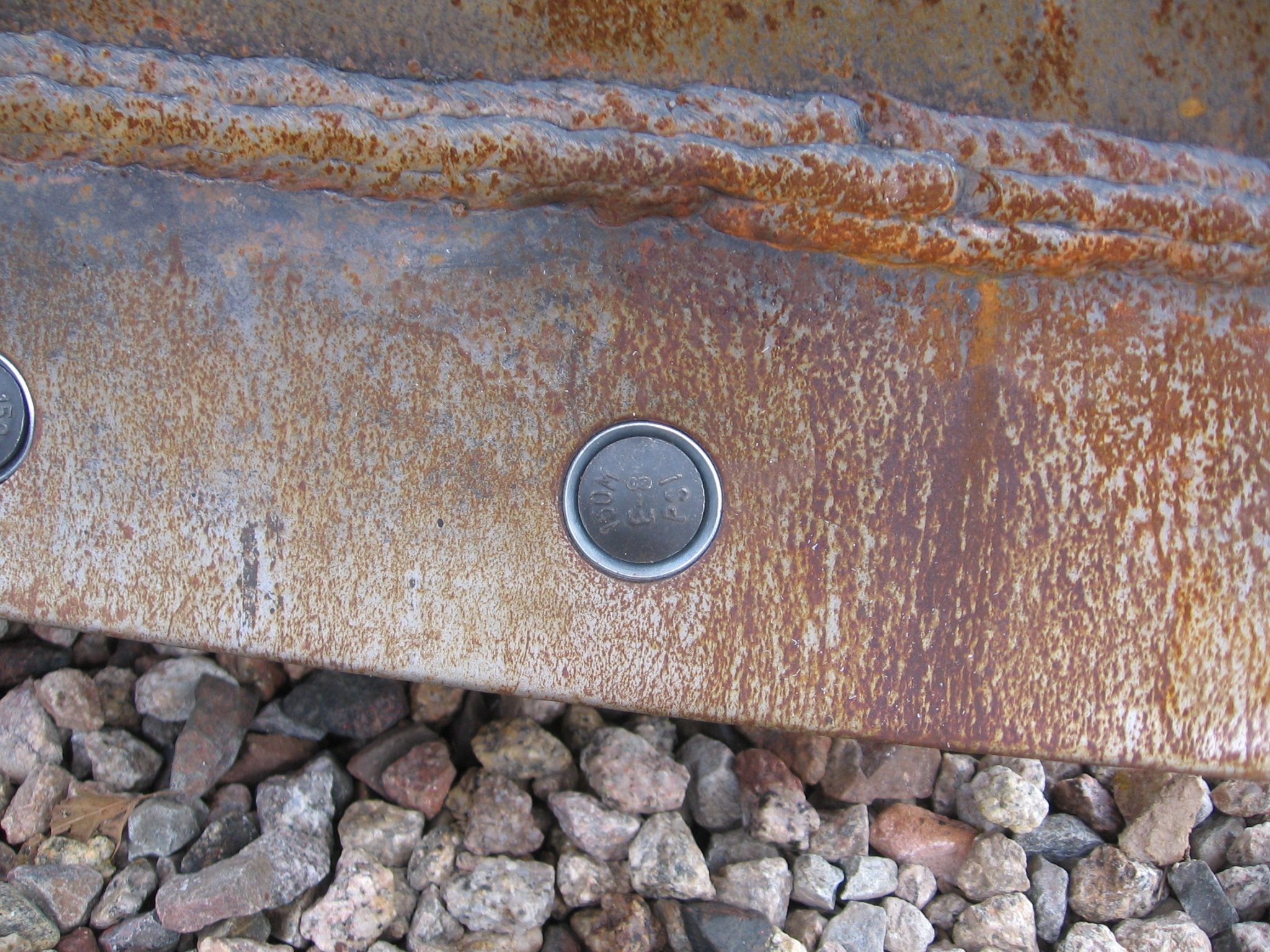

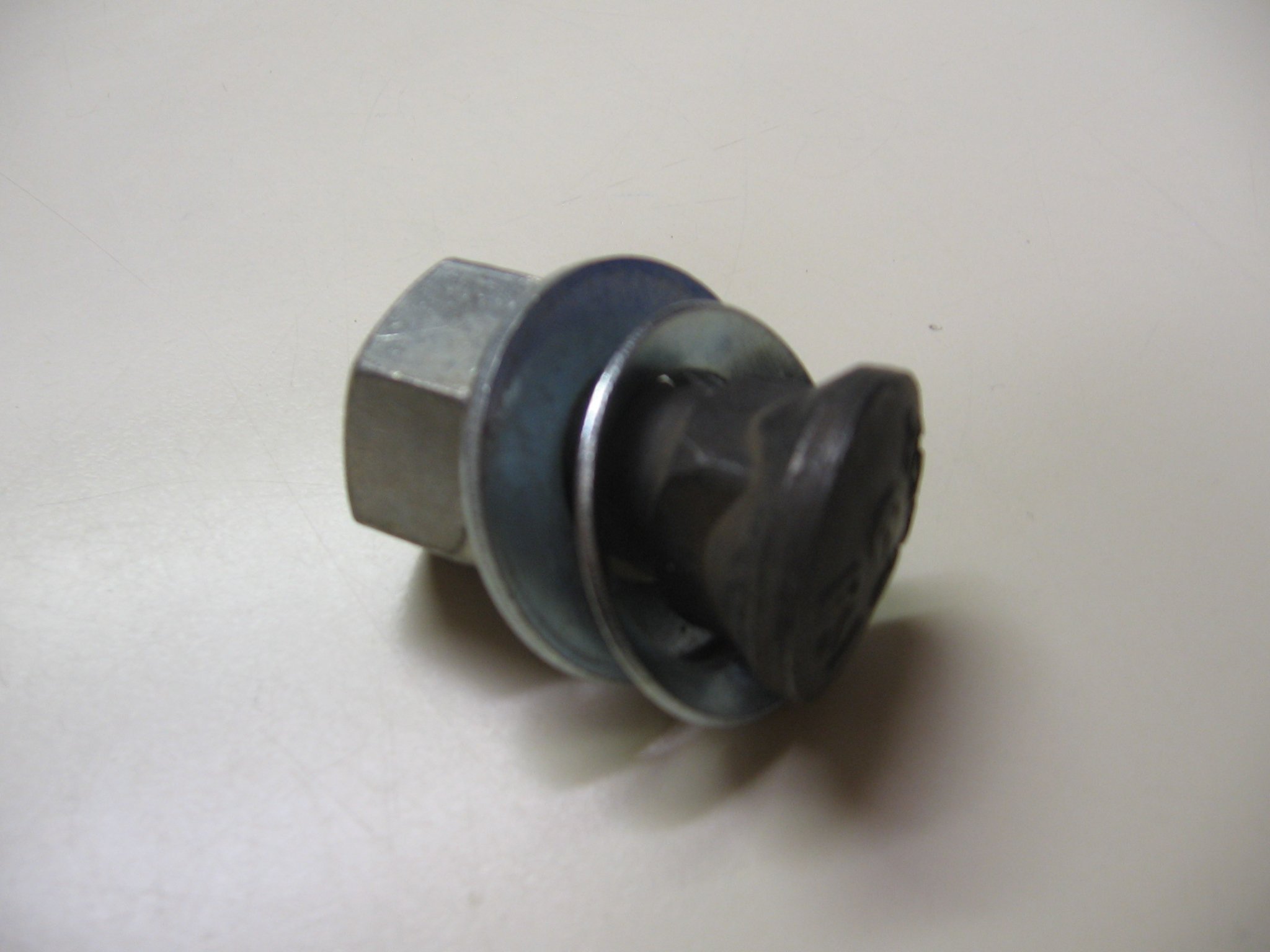

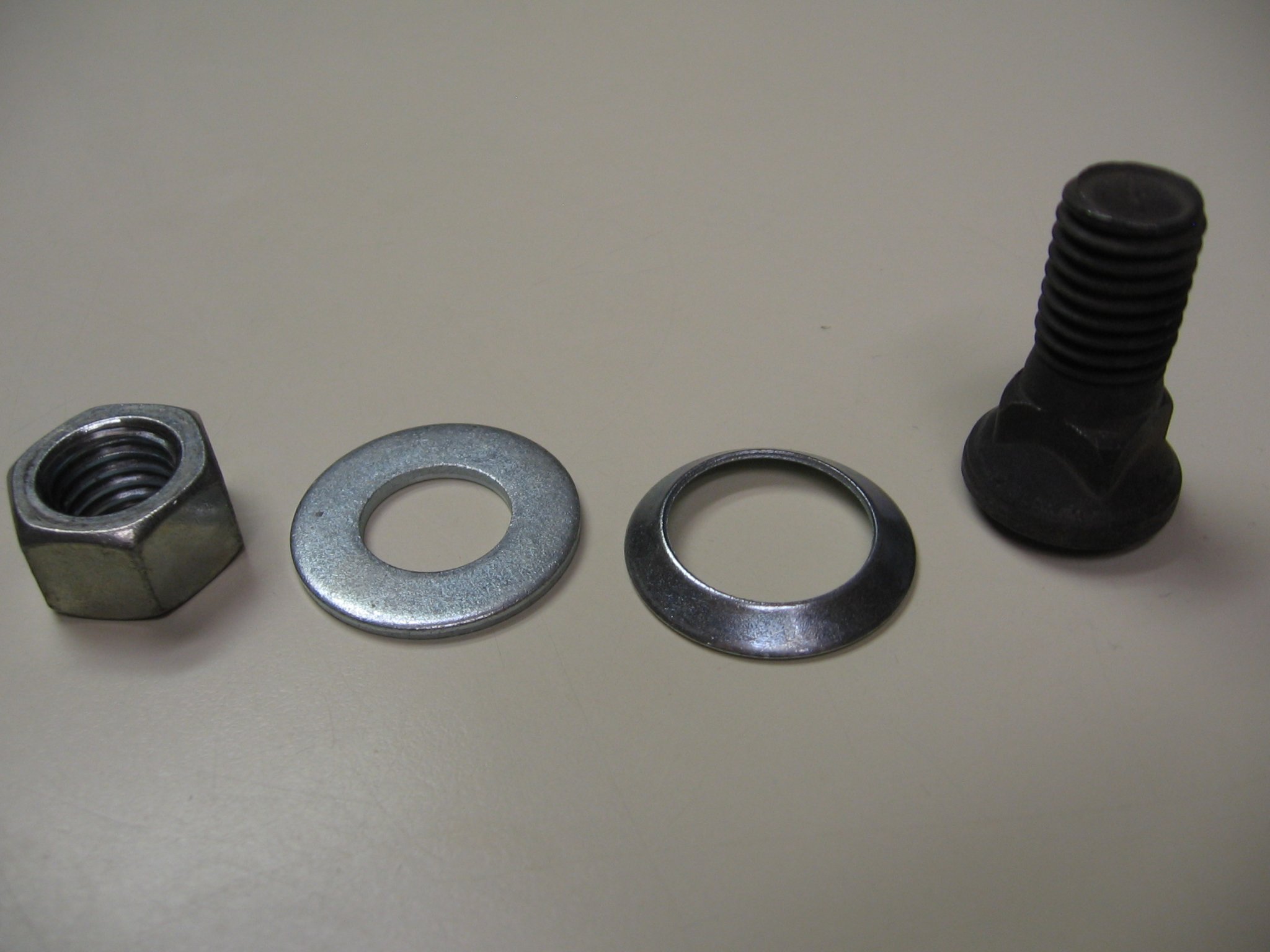

The PO had a shop replace the lower half of the front blade, and they used a portion of a scrapped road grader cutting edge. Works well except for the plow bolt holes. PO said that pushing anything fine like sand would sent the material right through those holes, or gravel would get stuck in them, & when pushing brush, sticks would invariably get stuck also.
I hunted everywhere for plow bolts big enough to fill the holes, but no luck, so I used some smaller ones from the stash. I fabbed some cone washers, and plugged the holes.

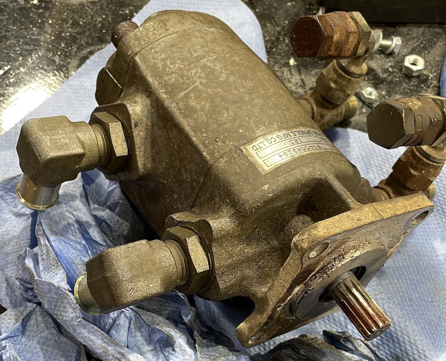

i took the pump out the other day, the type label is in the upper corner towards the front of the machine, its quite well hidden. on the outside it looks very similar to mine, its 12 spline 14mm diameter shaft with 63.5mm bolt spacing and RH rotation.
Nihon Spindle
PAA55RD284
i have found PAA66RD268 but its 2x5,3cc unit and feels quite small for this machine.. should be more like 2x 12cc or something similar.. (would somewhat match with 2x5 & 1x20cc)

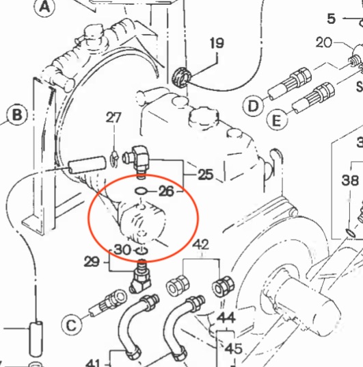

ok, maybe there is a 3rd one after all, browsed the manual and that might be it?
need to open up the machine some more and check behind the engine :D

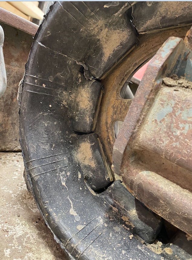

if it helps anything for the track problem, here is a closeup from the tracks showing little bit of the inside of them
these are tracks i have mounted currently if its any help

according to seller these fit
HANIX 150N, HANIX H15.1, HANIX H15B.2, HANIX H15B PLUS.2, HANIX N120.2, HANIX N150.2, HANIX N150.2R

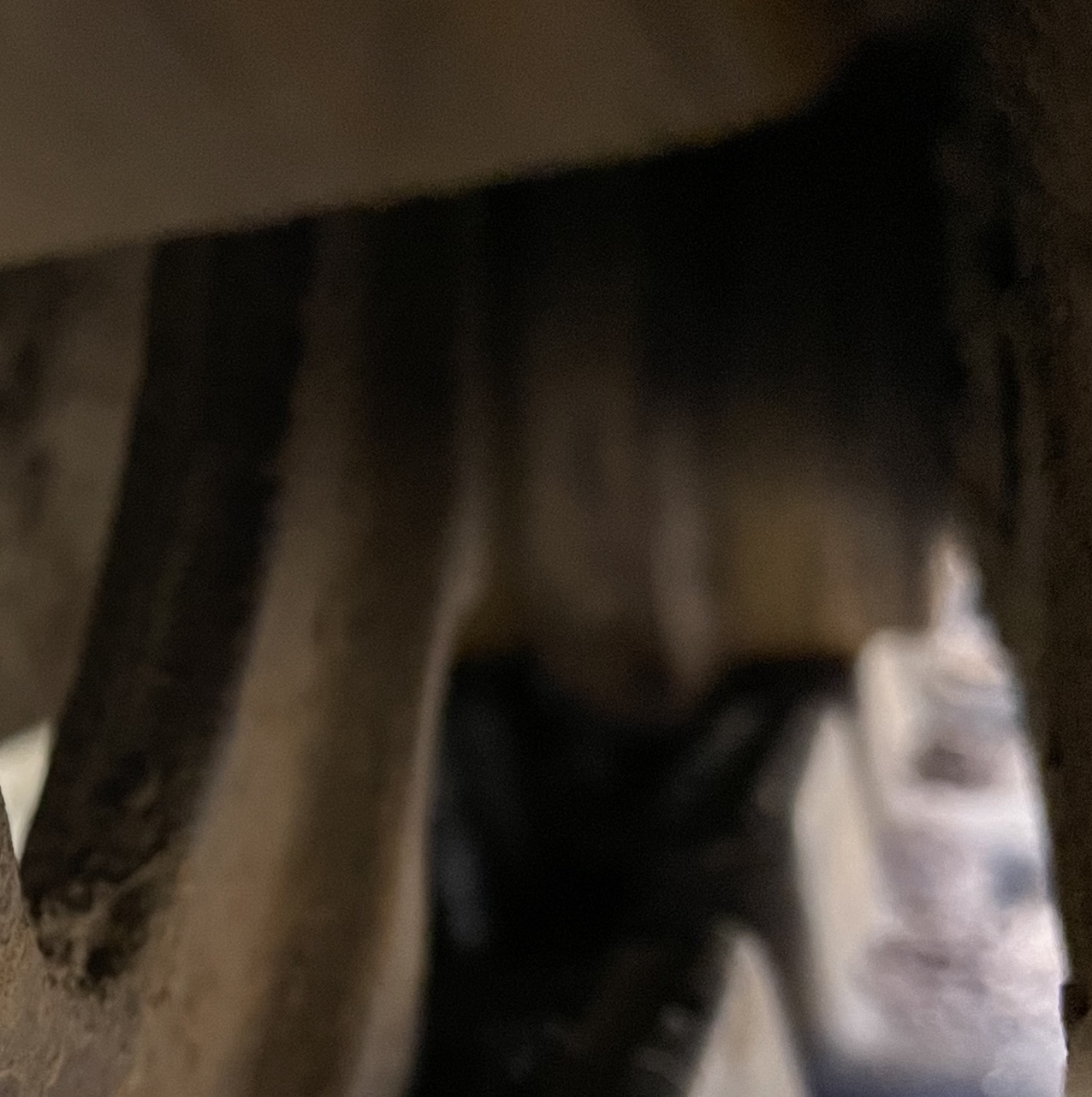

Lots of these tracks are the same size (track width x pitch x number of pads) but can vary in the guide roller configuration. Some have a groove or channel in the track and rollers with a ridge in the center that rides in the groove. Others are reversed, with sort of a spool type roller and a ridge (or two) on the track.
I need to verify which I need before ordering, but I'm a lot closer than I was yesterday. :)
this thing of mine has rollers with ridge that rides inside the groove, heres a worst picture i could ever take but if you imagine hard enough you can barely see one roller in the behind there :D

i went and checked the machine and there is hydraulic lines going where that pump is on the drawing, so there is something.. :D

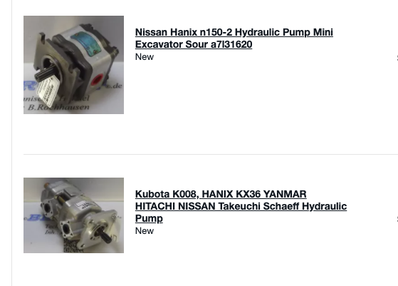

quess these are the ones, single pump is between the seat and engine.. need to take the access hole open to see whats in there, but on ebay i found these
never would i have imagined there would be one if i wouldnt have had those manuals :)
