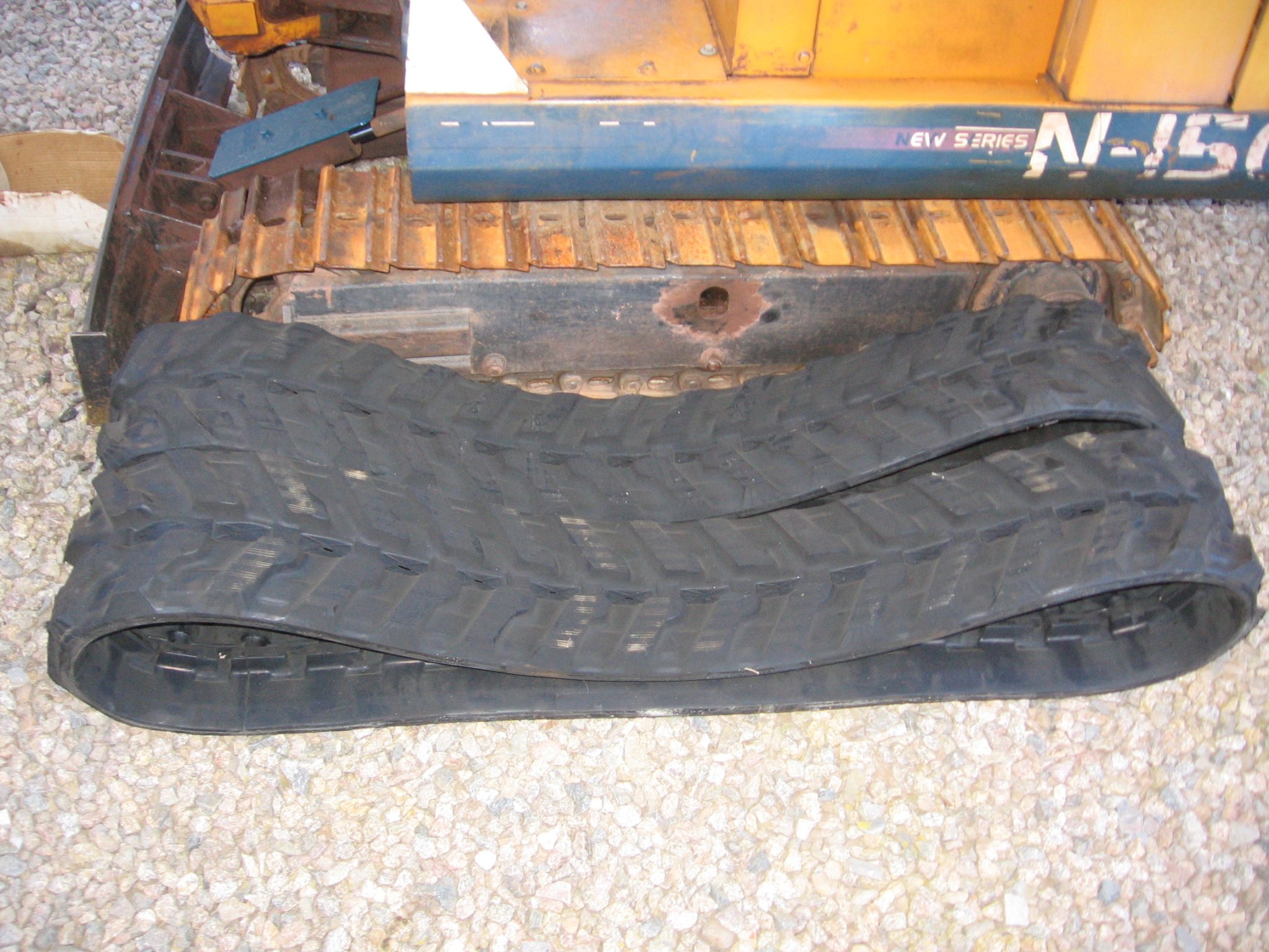

Went up north Thursday afternoon, my neighbor (who sold me the B7100) has decided to move, and was going to have a multi day garage sale. Thursday night a storm dropped 5" of snow, so he only had a half day sale on Saturday.
Anyway, I came home today, (Monday) so I could be here when my tracks are delivered Tuesday or Wednesday.
As I backed into the drive, a semi pulled up & delivered my tracks early.
Thankfully, I was there to receive them, as no one else was home, because my wife was at the emergency room with her mom.
Not sure when I will get to them, with the MIL situation, but I used the mini X to drag the pallet into the backyard.

Note: Tracks are heavy; shipping invoice says 296lbs.
They are going to be a lot lighter than your steel tracks so keep that in mind. those steel tracks are acting as a counterwieght.

Gotcha.
It's going to be so nice to move this thing without having to worry about the tracks breaking of falling off.
The last 4 times the BIL (or actually his neighbor) used the excavator a track pad broke, a track pin broke, & a track came off twice. The steel tracks are shot.

i had some old 90s rubber tracks on at first, then i got new ones and the thing became way smoother and easier to drive.. no more lagging or grinding.
..i can only imagine how it is with steel tracks :D

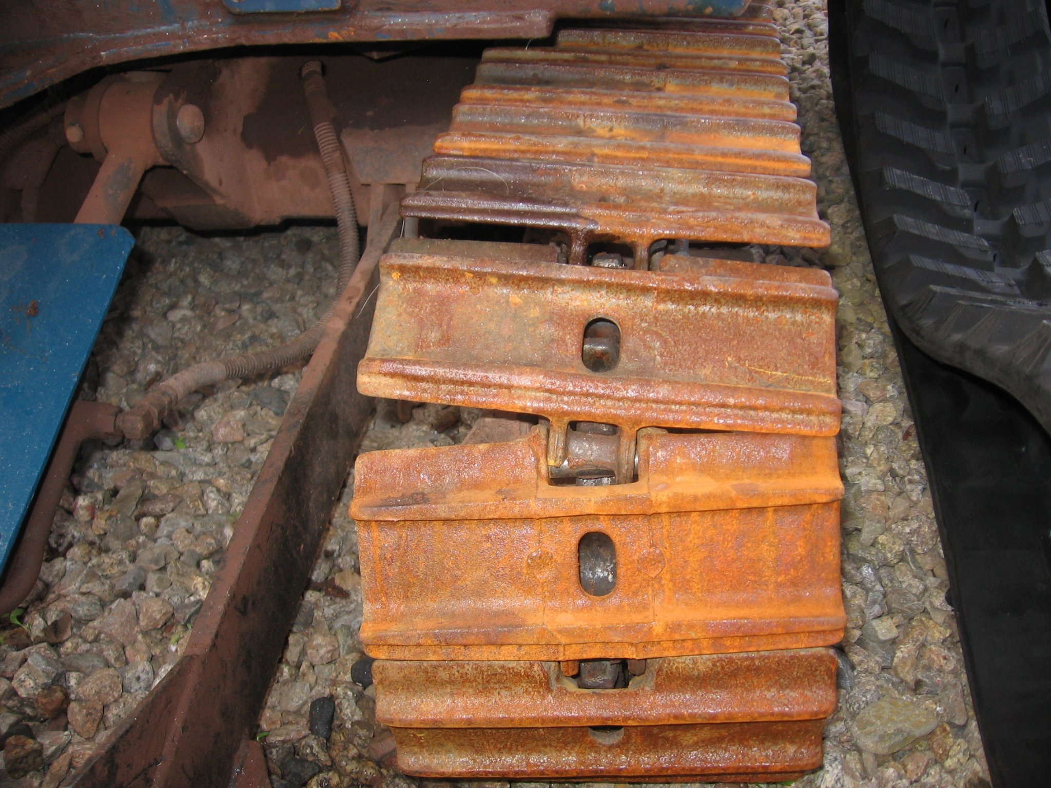

The new ones look like the right circumference, anyway.

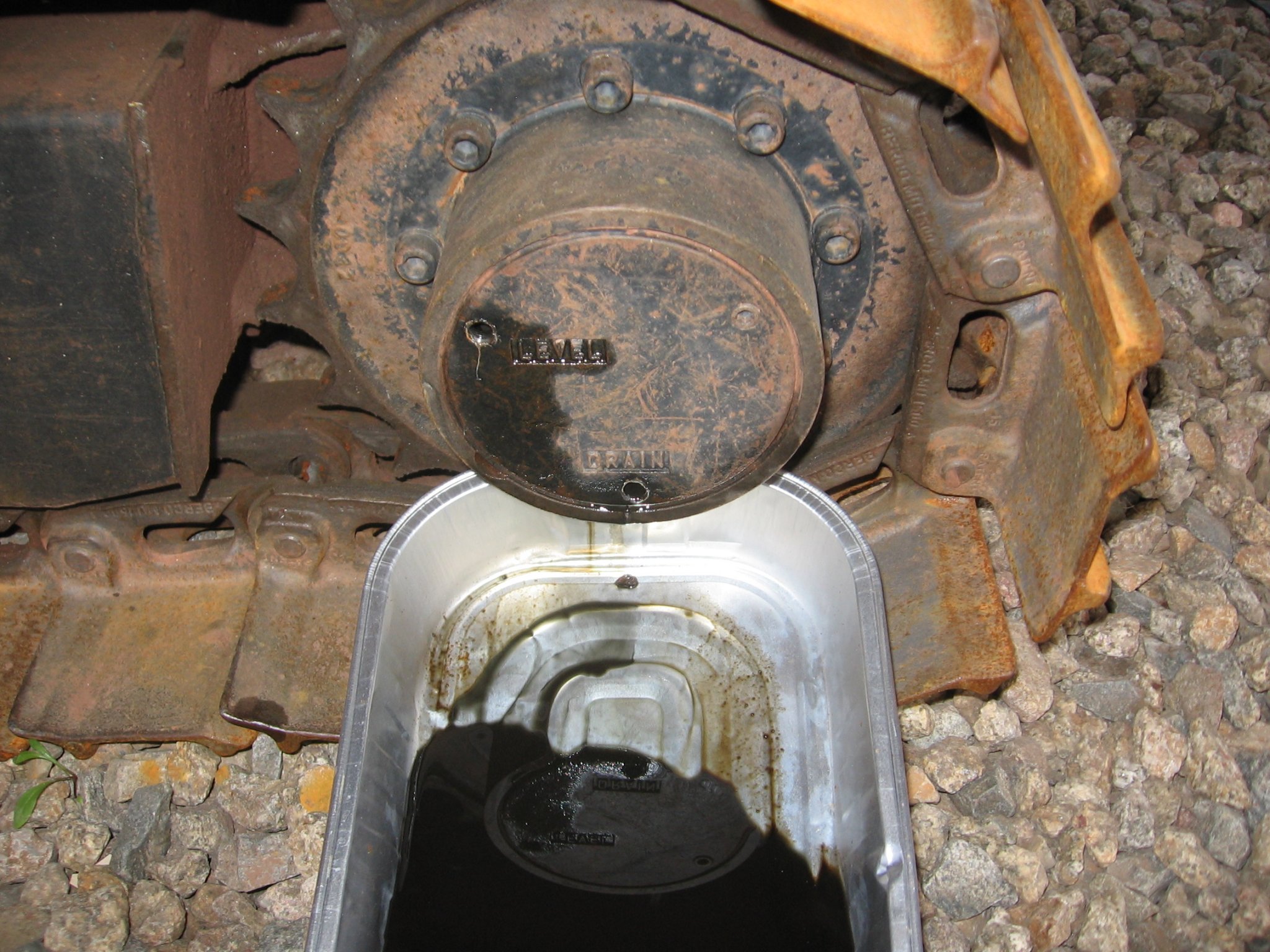

Changing the oil in the drive's planetary gearboxes IMG_0003.JPG .

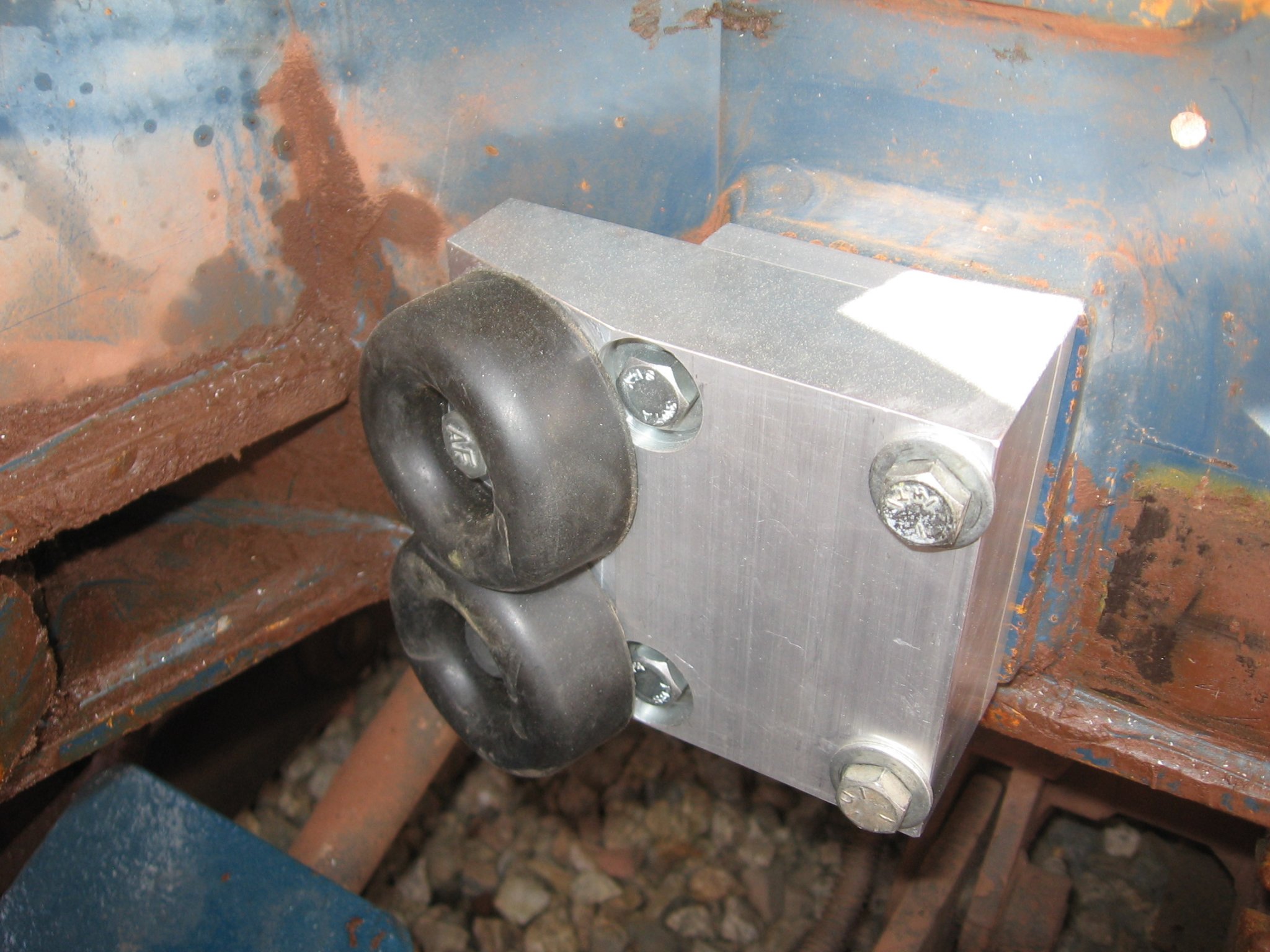

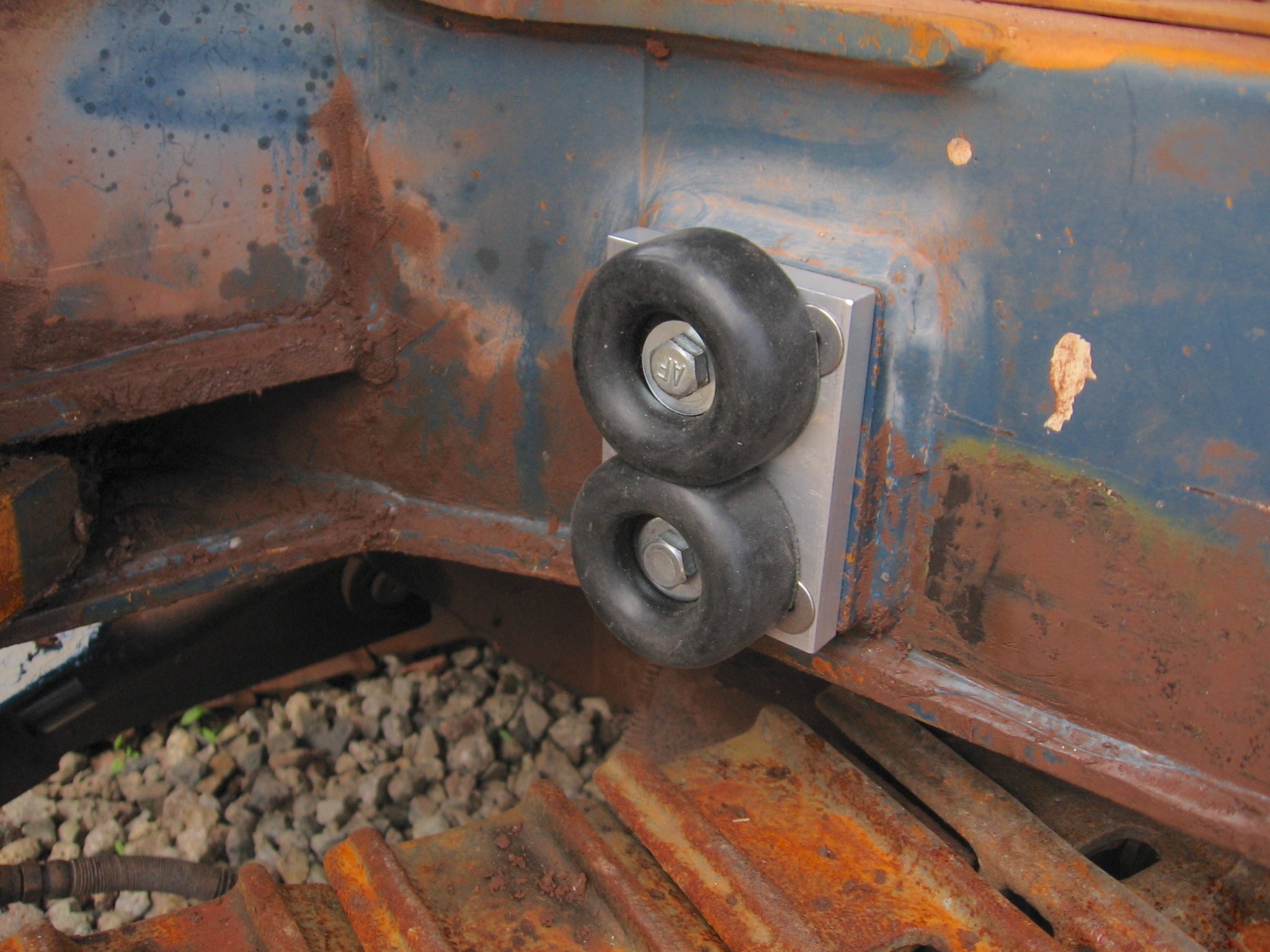

Boom swing stop modification:
Swing was still uncomfortably close to the end of swing travel with the first stop, so it got modified.
1st stop:
