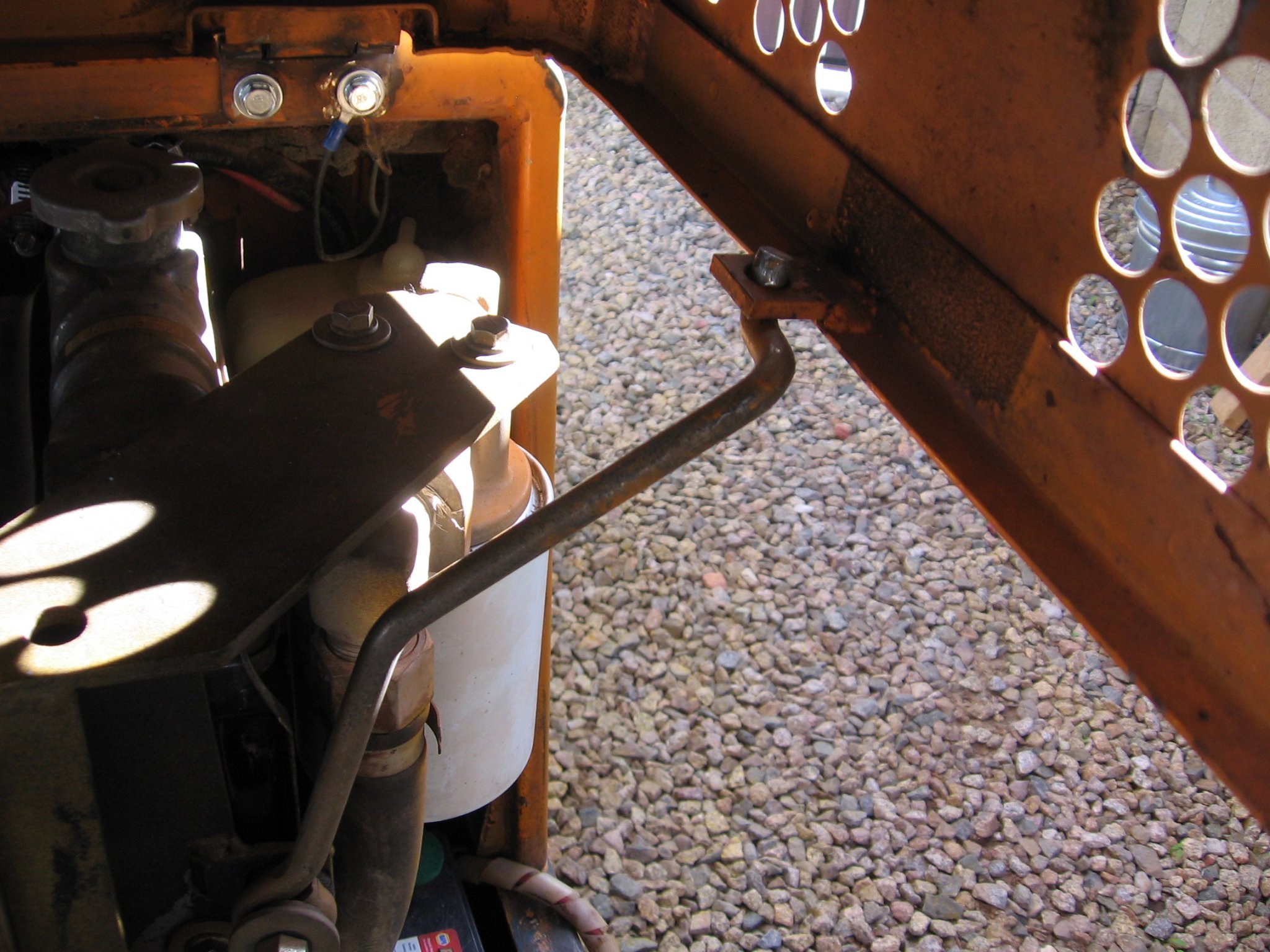

After bonking my head on the engine cover several times, I grabbed a piece of stock from the stash and made an extension for the engine cover prop rod. It raises the engine cover 7+ inches over stock.
Maybe I'll have less a less lumpy head in the future.

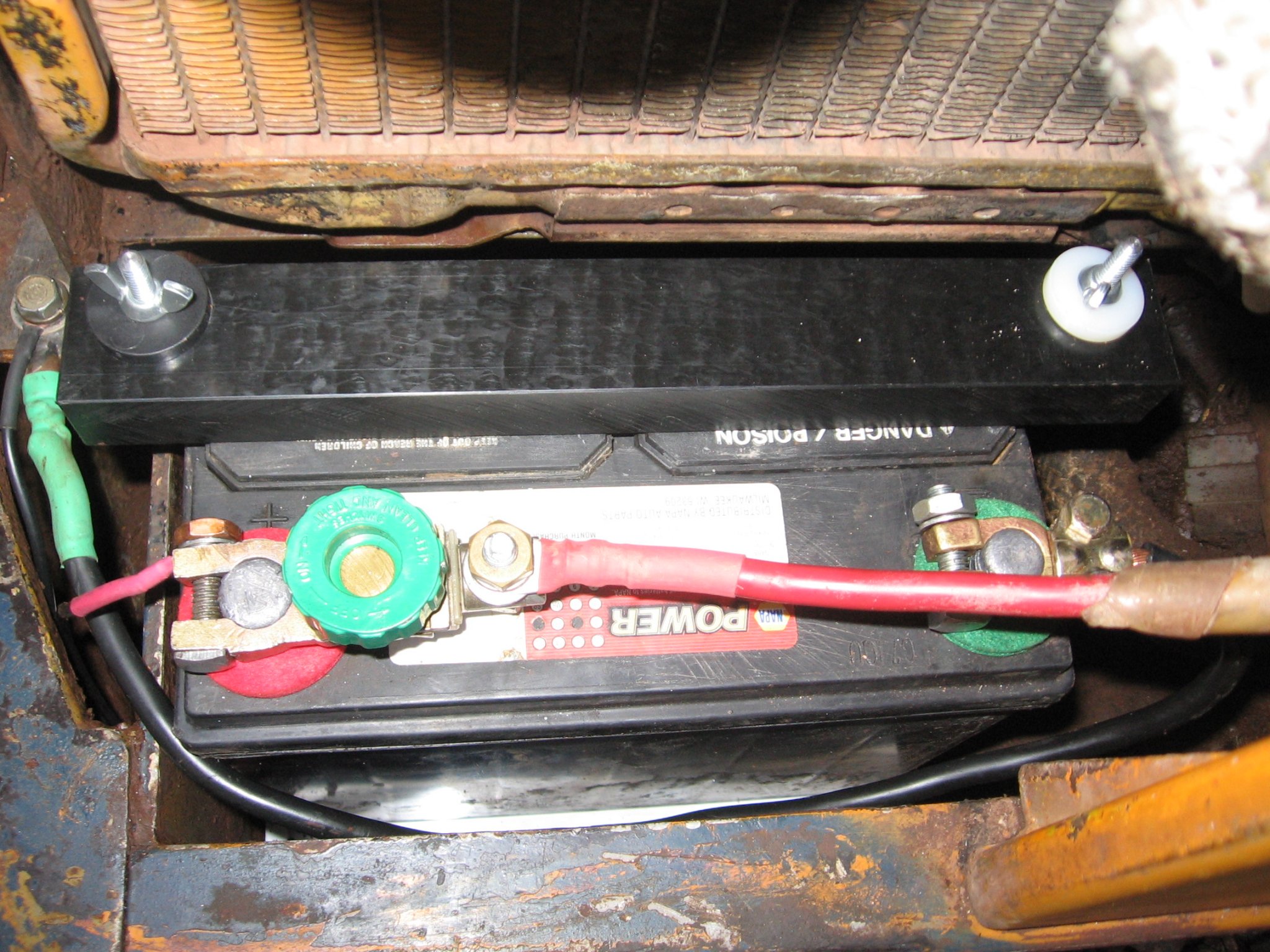

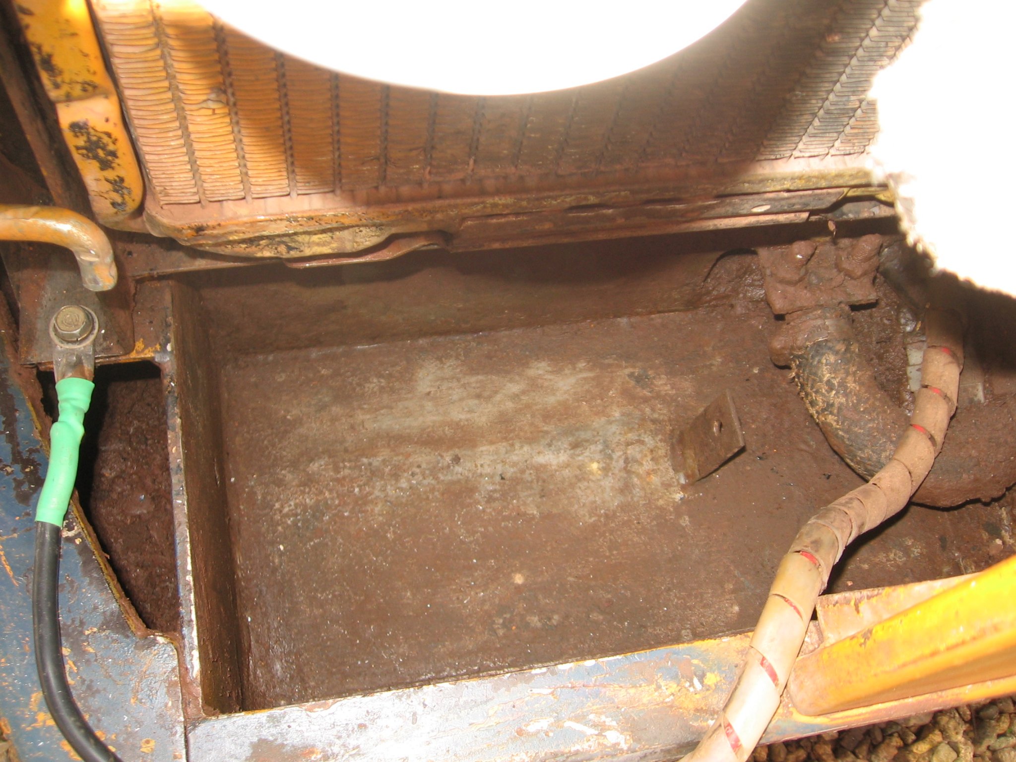

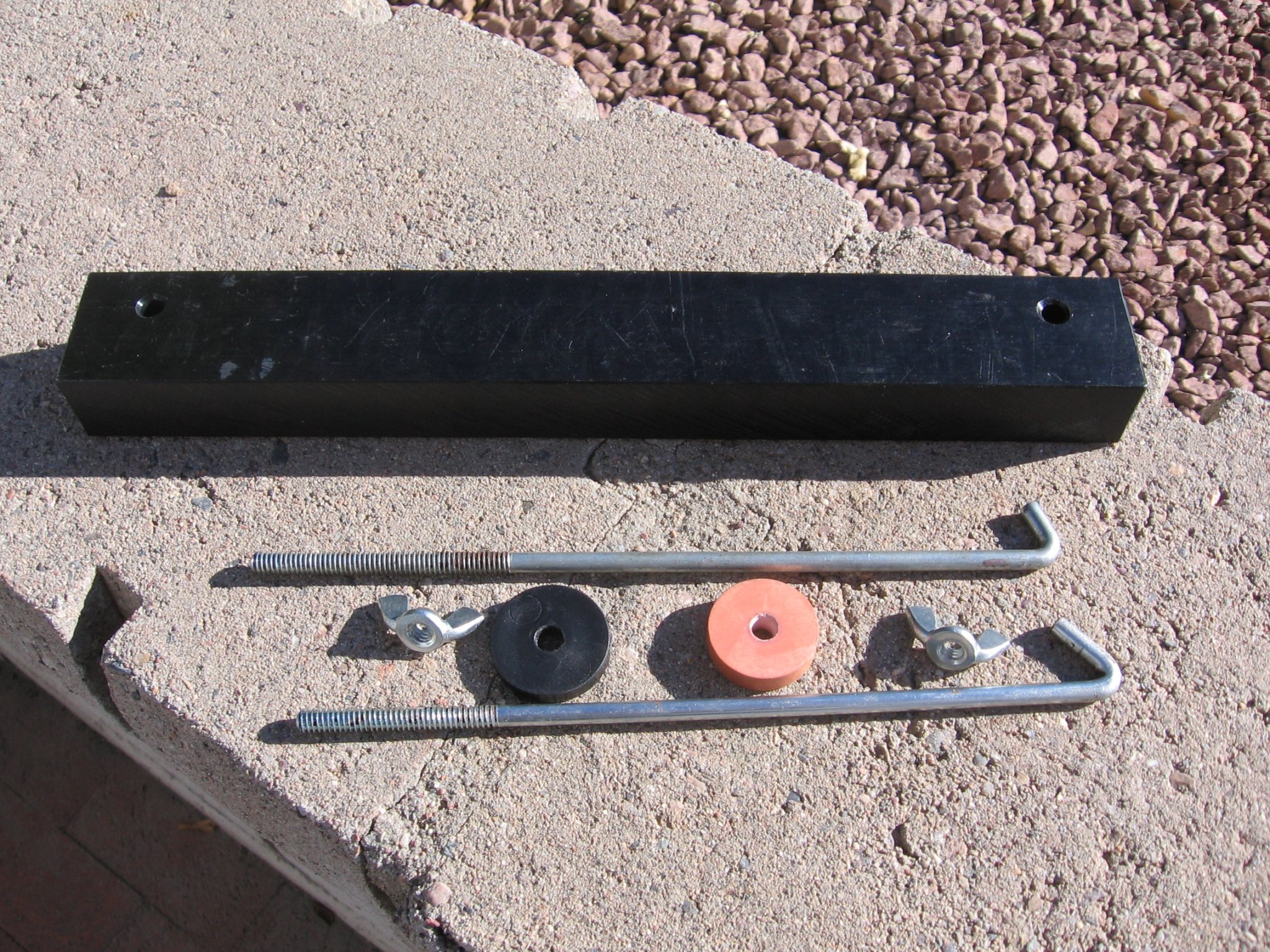

When I got this machine, the battery was not secured in any way, except that it was stuck in grease, dirt, & oil. The battery cable ends showed evidence of having been rubbing on the frame & radiator support, and worse yet, shorting also.
I took some 1/2" white polypro and cut it to fit the battery "tray" area, then milled a 1/4" DP recess the size of a 52R battery. This will keep it located where it needs to be. Had some 1/4-20 battery hold down posts in the parts stash, and drilled a piece of black polyacetal for a hold down strap.

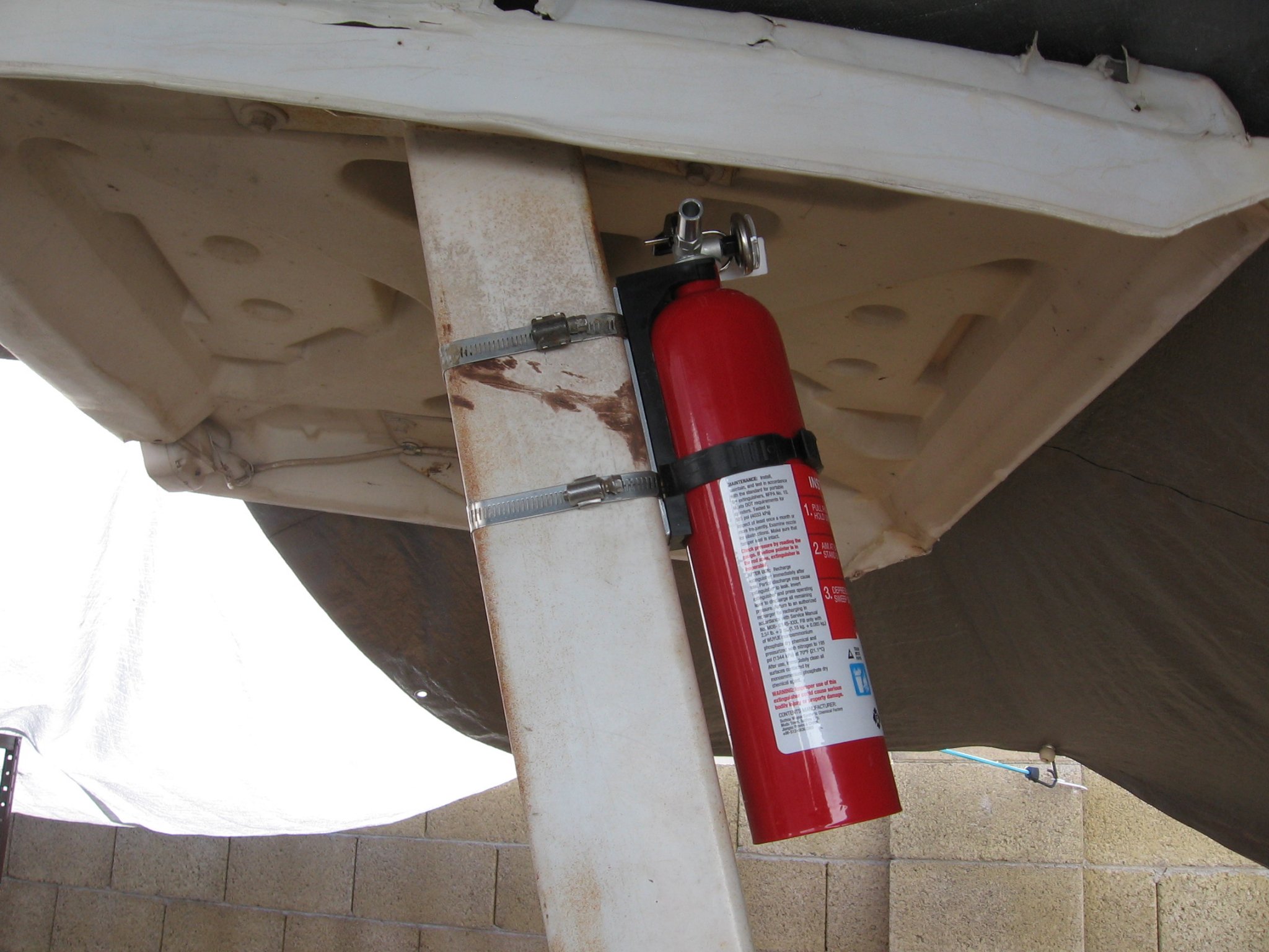

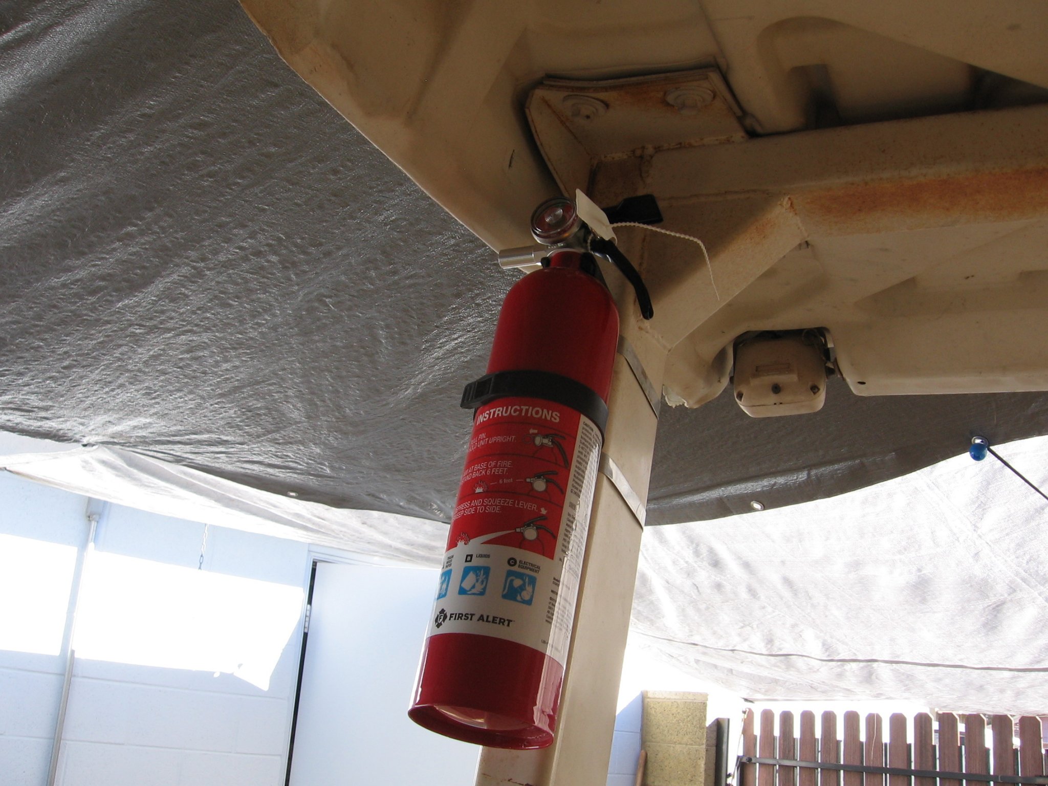

Added a little insurance:

8,001
5,188
The plastic handle on that extinguisher is truly only a "little insurance".
Plastic valve or plastic handle extinguishers are prone to breaking/failure, but........NOT until they are actually needed to extinguish a fire.
That sweet little Hanix deserves an extinguisher with an all metal head!
8,216
3,600
The plastic handle on that extinguisher is only a "little insurance".
Plastic valve handle extinguishers are prone to breaking/failure, but........ONLY when they are needed to extinguish a fire.
Yup, it's only temporary, until I can get to my usual supplier, on the other side of the city. (130 mi rnd trip)
At least the head isn't plastic.
This thing has such huge amounts of grease/oil/dirt/sticks/leaves/dead possums/etc on it that if a fire ever got rolling, an airport truck with a foam cannon couldn't put it out. So I have that extinguisher and 3 others (bigger) within grabbing distance, and whenever I have time, I scrape, trowel, shovel, spray, and wash greasy crap off of it.
I think the only way it will ever be fully clean is if I can beg, borrow, or steal a hot water pressure washer.

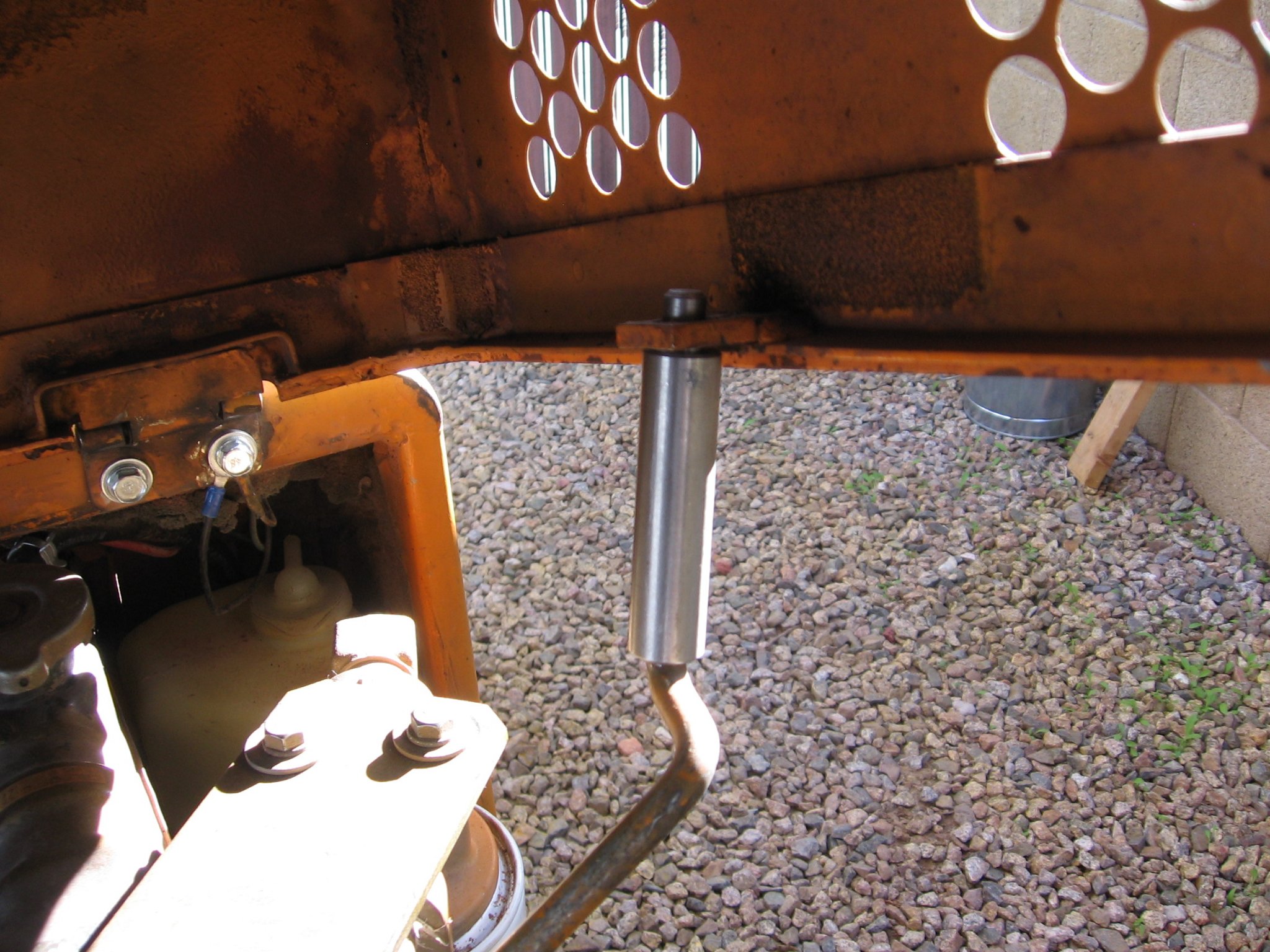

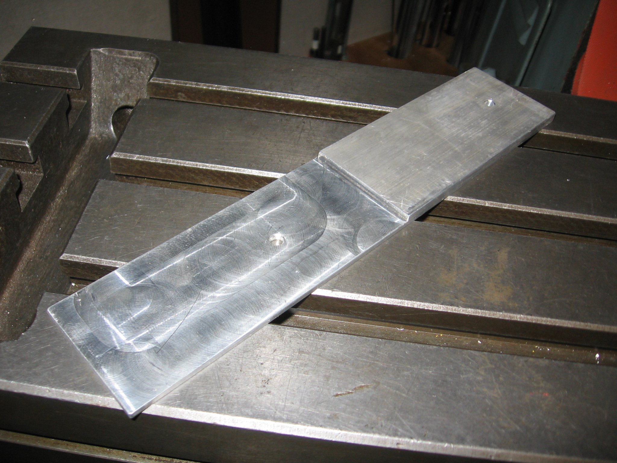

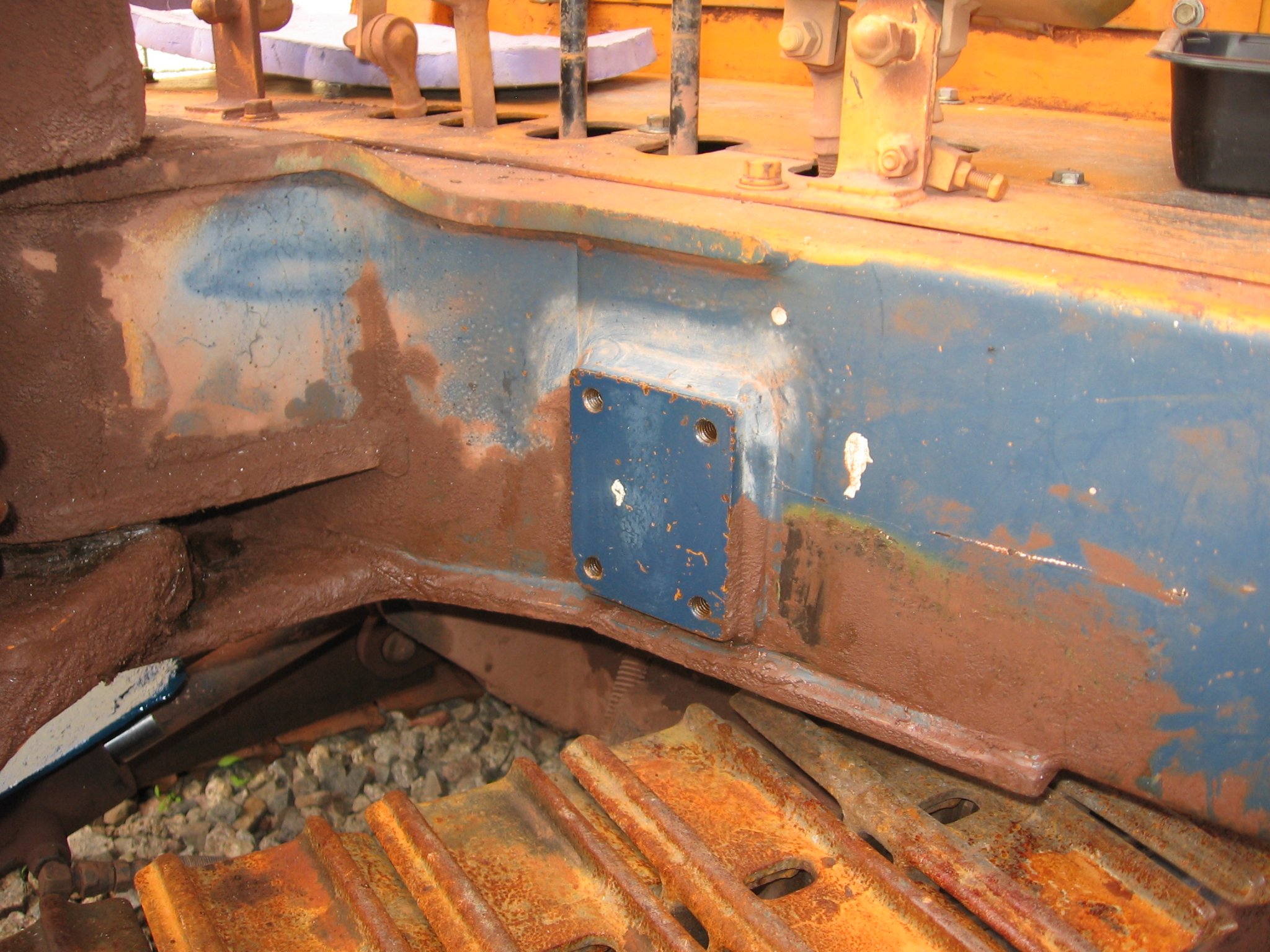

Swing bump stop missing, grabbed a piece of stock from the stash, and a couple extra bumpers from my toyhauler door.
Another odd point- the (4) threaded holes where the stop bolts on are 3/8-16, not metric. Only SAE threads I have found on the machine so far.

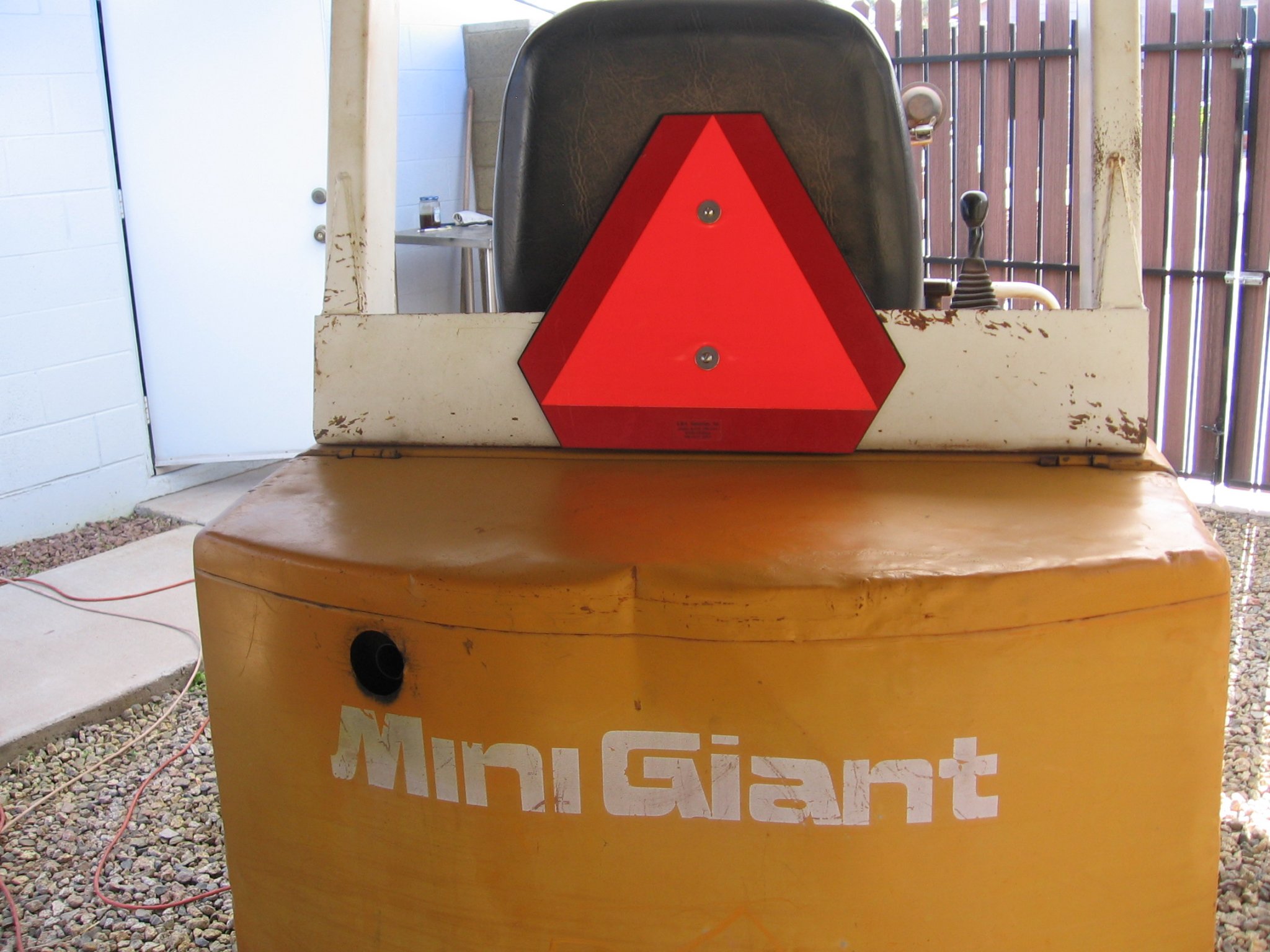

Grabbed another piece from the stash and an extra SMV sign.

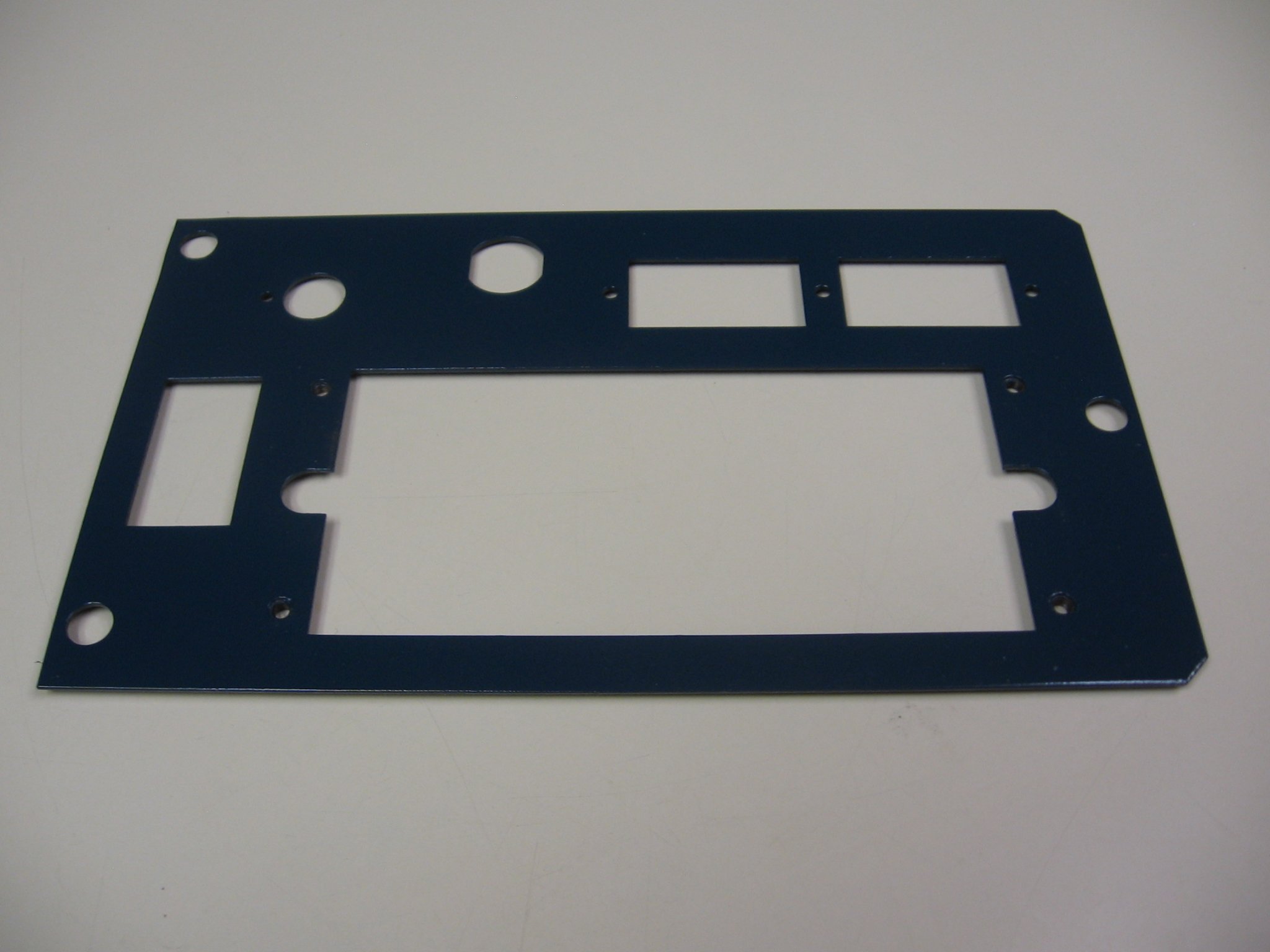

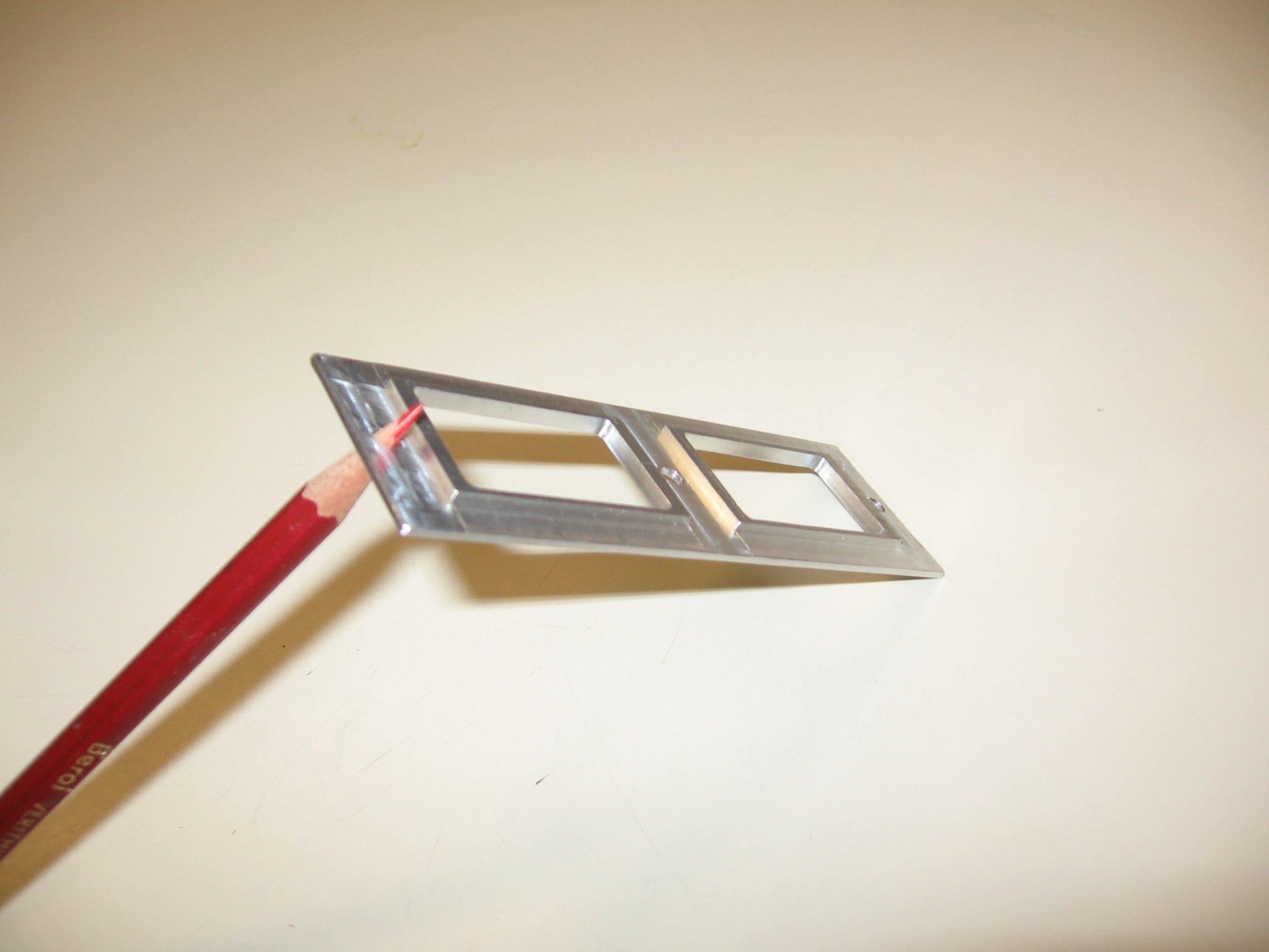

Finished the dash.

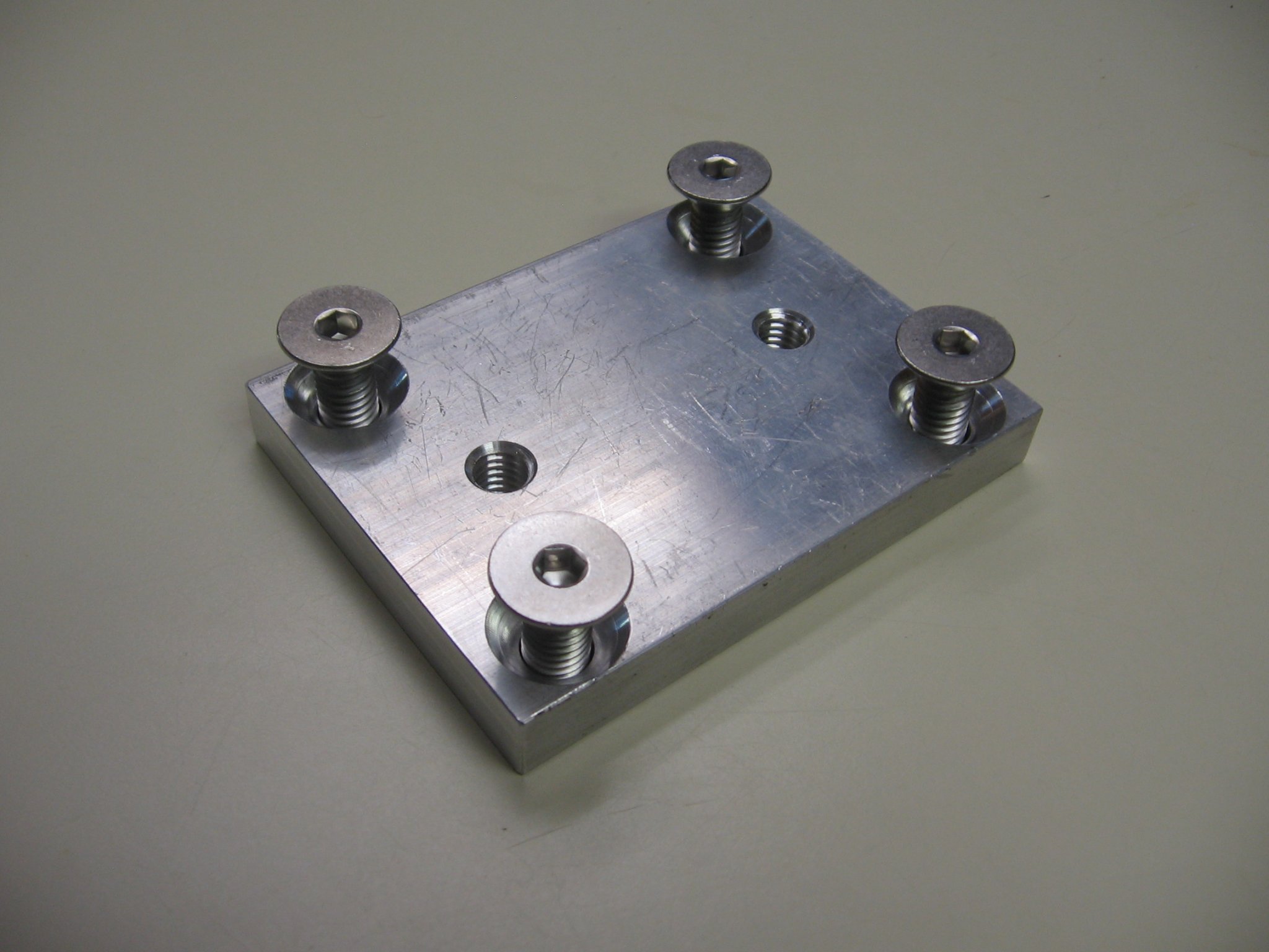

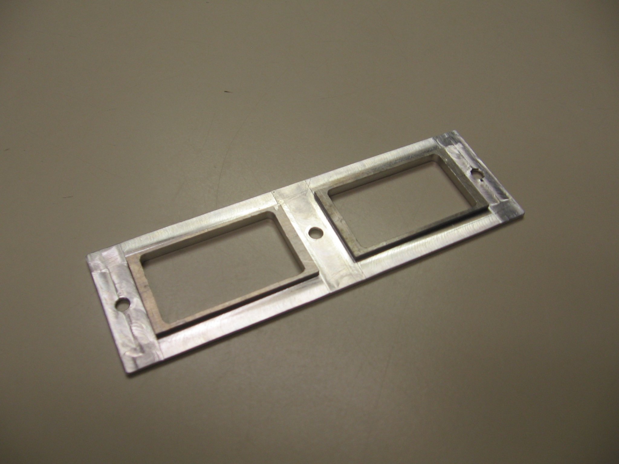

First, some parts that needed to be made:
Adapter to use modern switches in old, oversize holes:
8,216
3,600
Blank out plate for dead fuel gauge:
