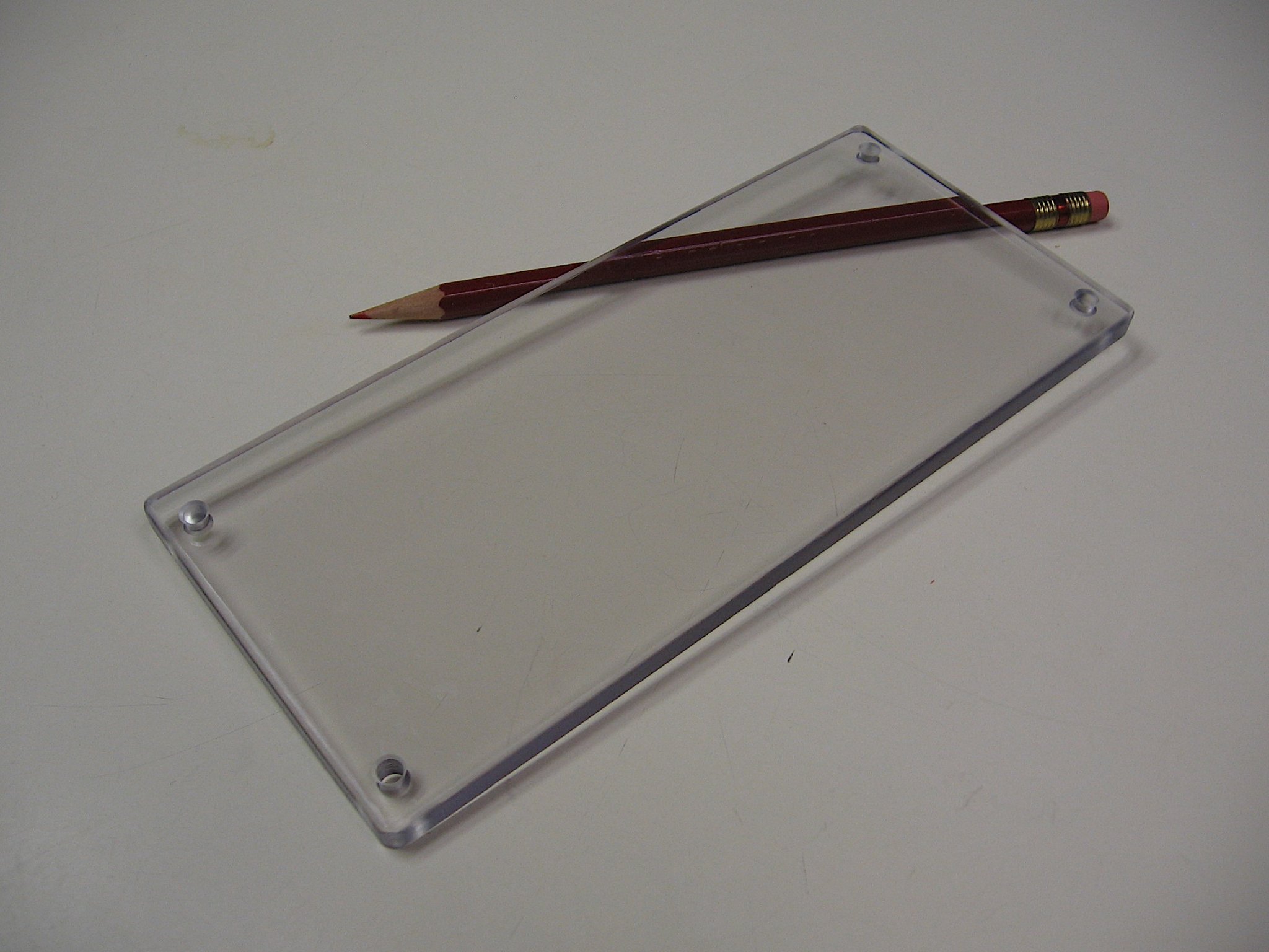

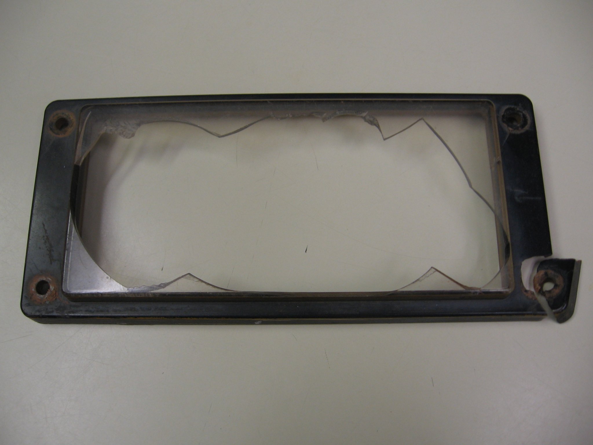

Clear Lexan (polycarbonate) "glass" bezel:
8,217
3,602

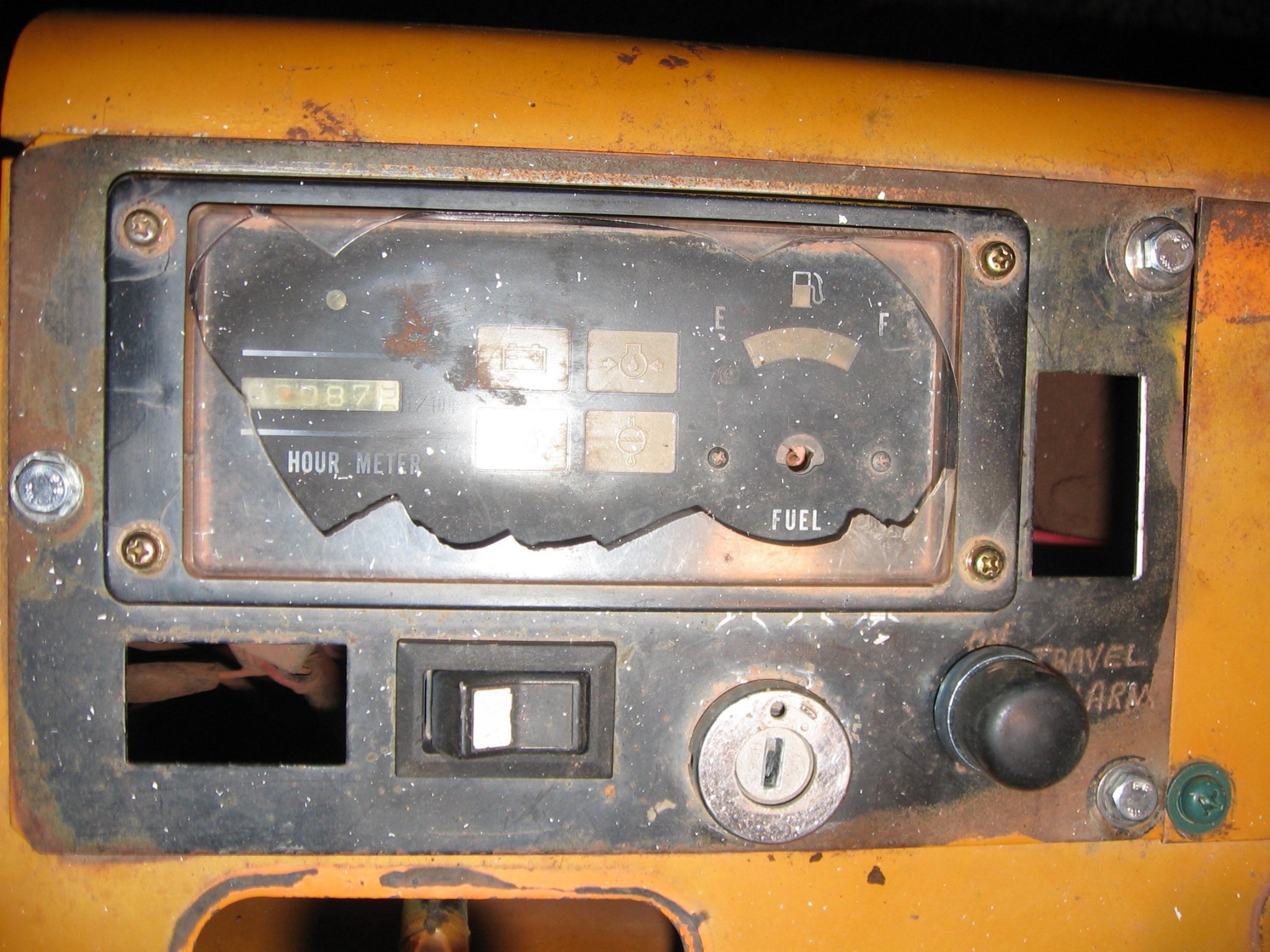

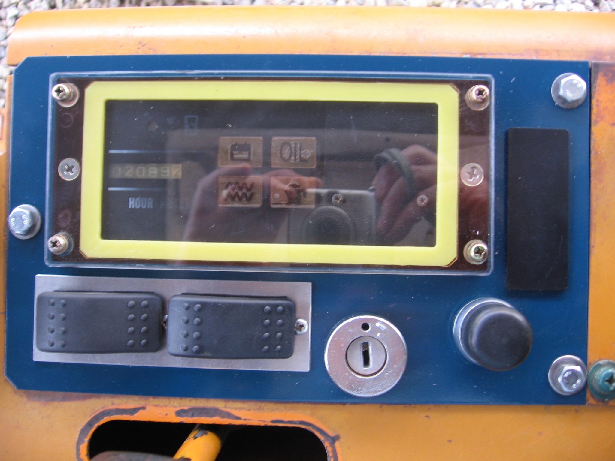

The before pic, and a couple after: IMG_0015 1.JPG IMG_0002.JPG IMG_0004.JPG
8,217
3,602

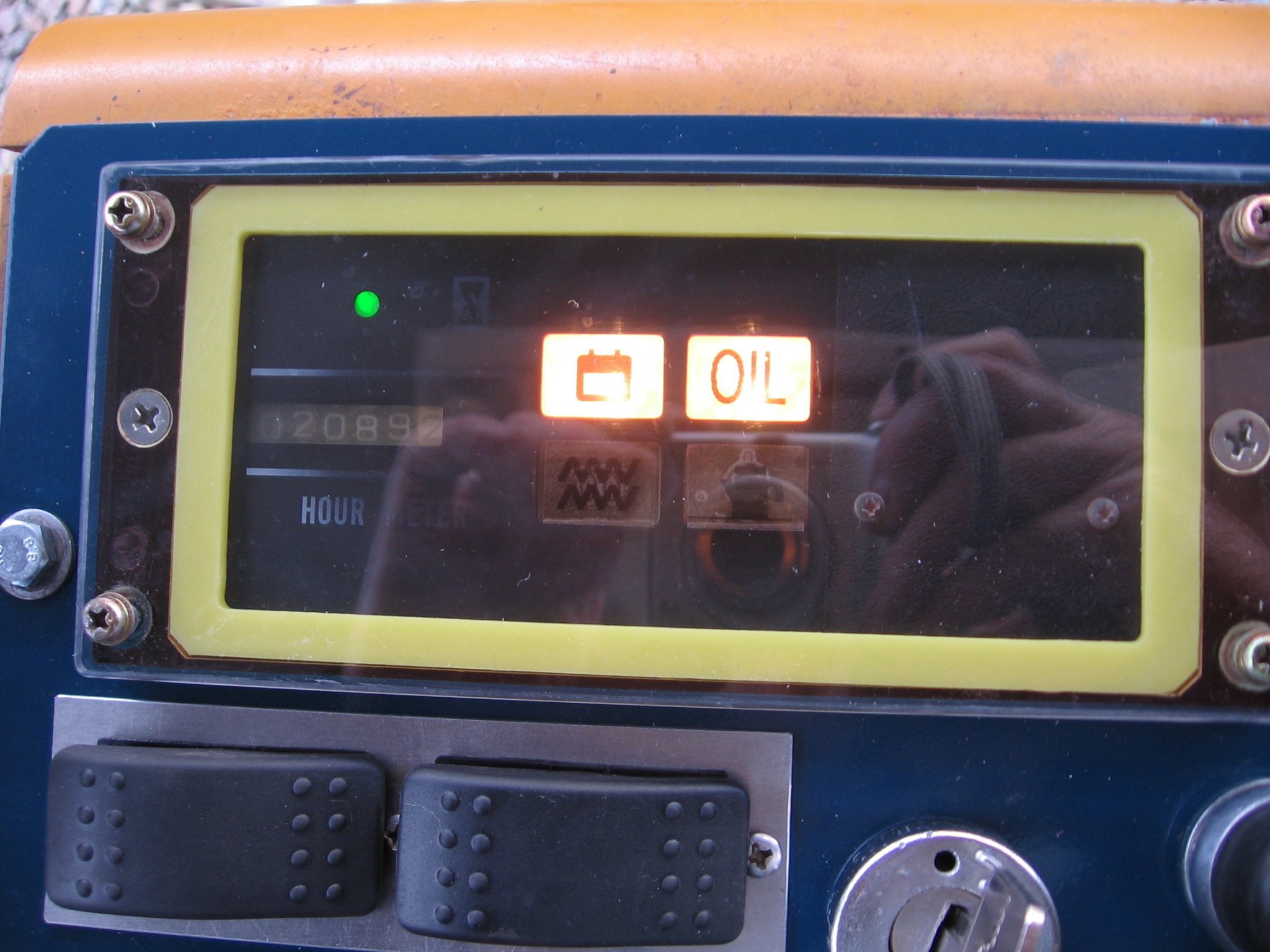

The blue paint is Rustoleum Night Tide, a pretty close match for the blue trim on the excavator, maybe a little darker.
Leftmost rocker controls boom light, the other the OH lights in the front of the canopy.
Large pushbutton is for the glow plugs.
Black plate to the right is a modified circuit breaker blank off plate, just fills the 3rd switch hole.
Glow plug indicator is below the battery symbol, and coolant over temp indicator is below the oil light.
Green light flashes whenever the ignition is on, and the hour meter is counting.

I would have finished probably 10 days ago, but I was fighting a problem that seemed insurmountable.
The 4 idiot lights (glow, oil, battery, and coolant over temp) actually have the symbols embossed on the plastic plate, and used to be black, probably silk-screened on black paint.
But the black paint was completely worn off.
I tried to get a pic, but my camera just would not pick it up.
The raised area was .003 to .005 tall, rounded on top, and very smooth.
I tried every type & style felt marker, paint marker, art marker; chisel point, fine point, ultra fine point, etc.,
(did you know you can buy markers down to a .005 dia tip?- average human hair is .003 to .008)
It was almost impossible top draw accurately enough to stay on the raised area, and on the rare occasion that I did, the ink bled & spread, requiring a quick alcohol wipe cleanup. Crap.:(
Then I hit upon the idea of a rubber stamp & ink. Same problem, plus you could not hold the stamp parallel enough to the raised area without hitting somewhere else outside the raised area. Crap.:(
Finally it dawned on me that I could use my Brother Label Maker with clear tape & black ink and just ignore the almost invisible original symbols. Worked pretty well. :)

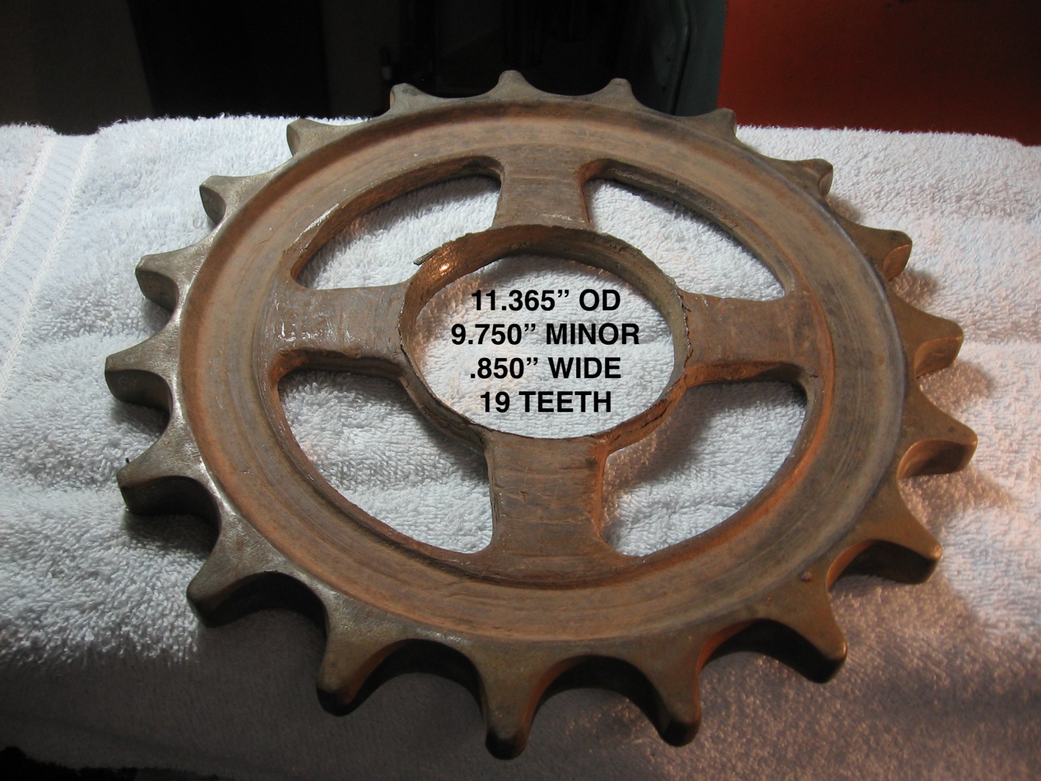

Do your drive & idler sprockets look like and have the same dimensions as this:
(this is an idler sprocket that lost the center bearing)

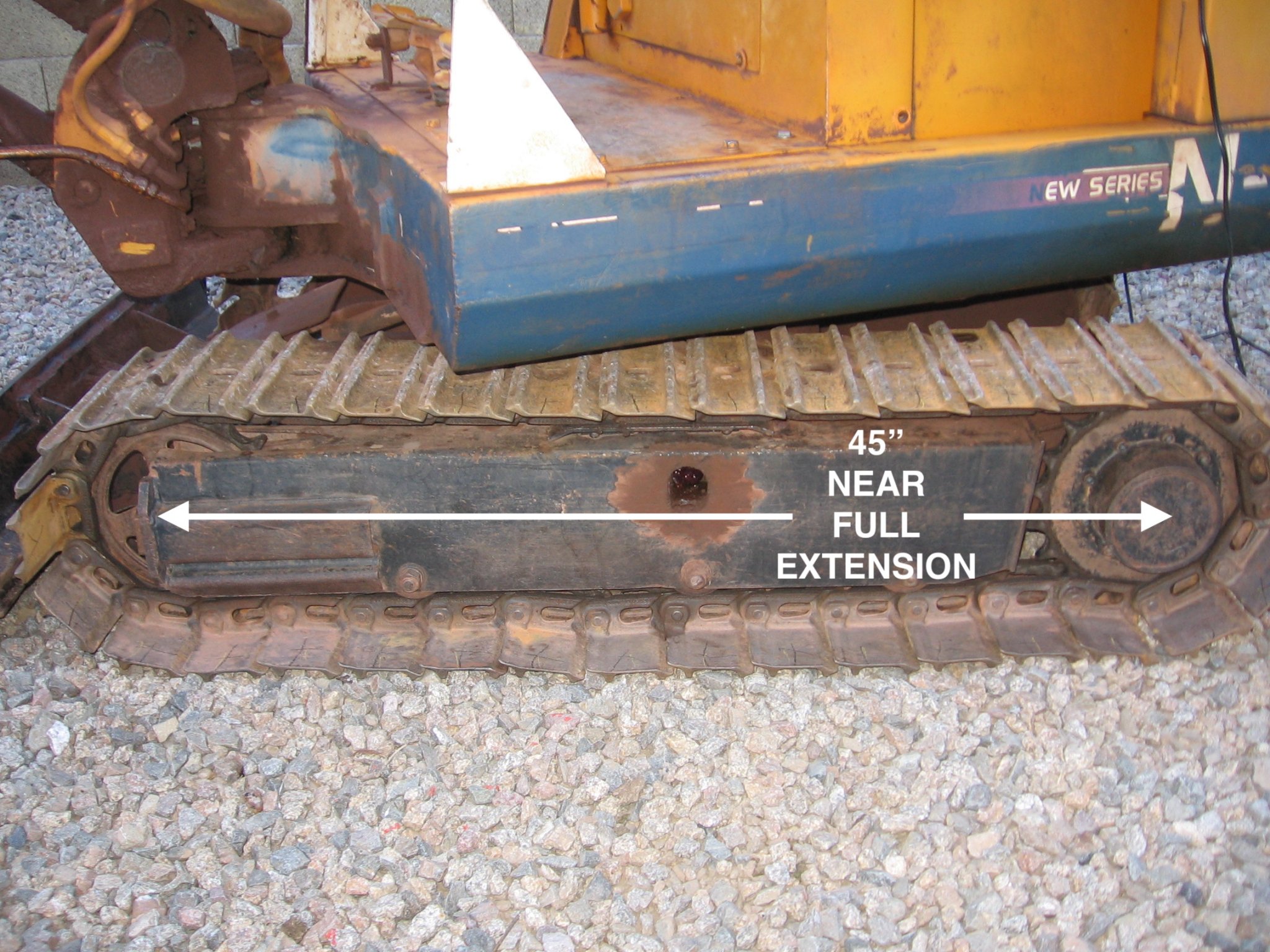

Could I trouble you to take some pics of your tracks?
