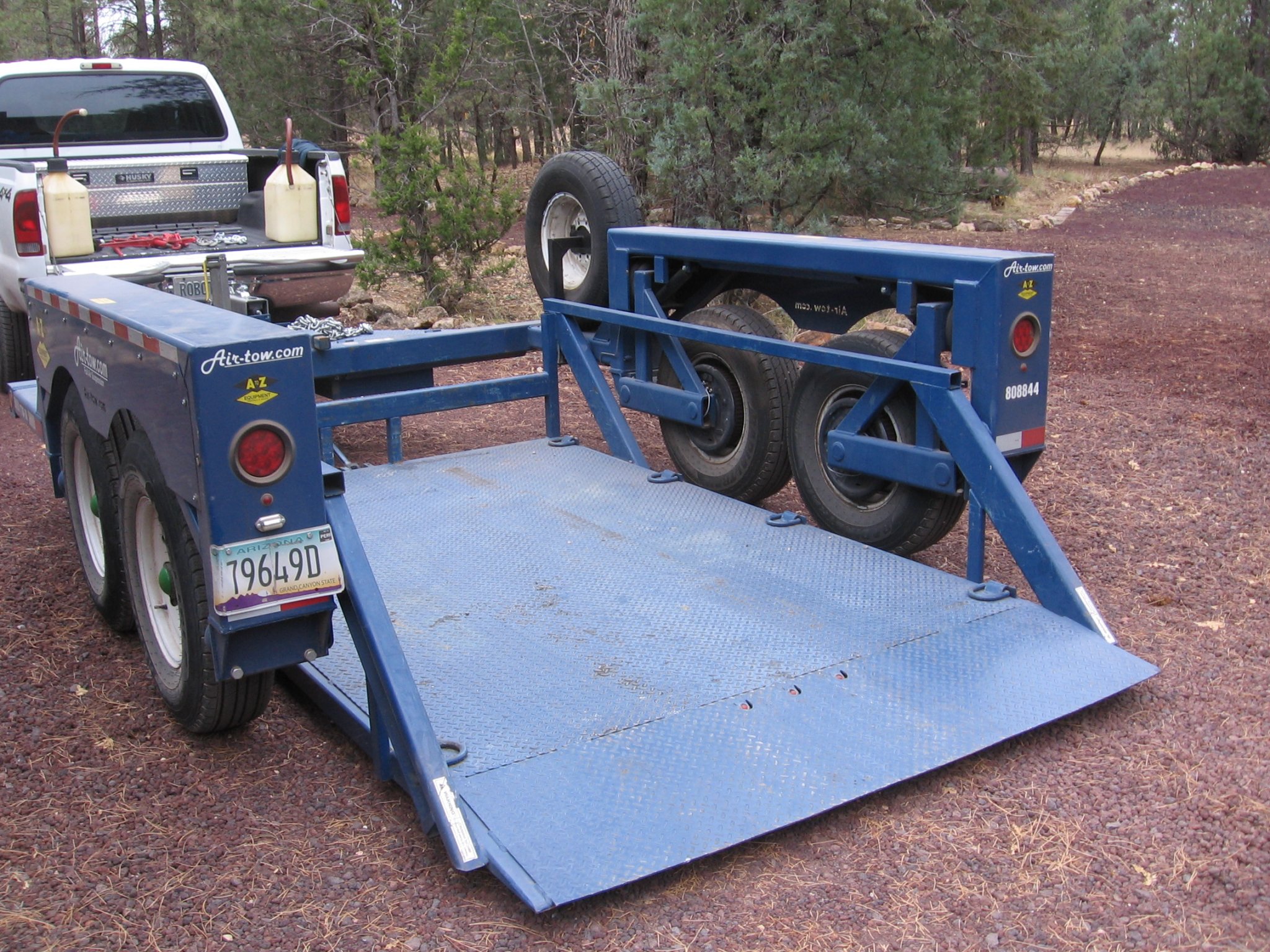

On the second day home, tried to rent a wood deck lowboy trailer, and found NO trailers available (at all) at the 5 nearest rental places. Finally found a place (35mi away) that had a drop deck trailer, which they recommended for steel tracks. $170 per day, but at least I would be able to move it. Pics in the above post were taken after an hour of pressure washing. It was so dirty, you could barely tell what color it was, and you could not even see the model number on the side. I never even attempted to clean the boom/stick.
Loading, hauling, and unloading went smoothly.
The owner could not find the manual, but finally I found one online, digital download for $5. After download, I find it is in norwegian, not english. THEN the company admits they don't have an english version. Since then I have found about 5 companies that sell the manual, but it is the same norwegian manual, from the same guy, using different websites. I will keep searching.

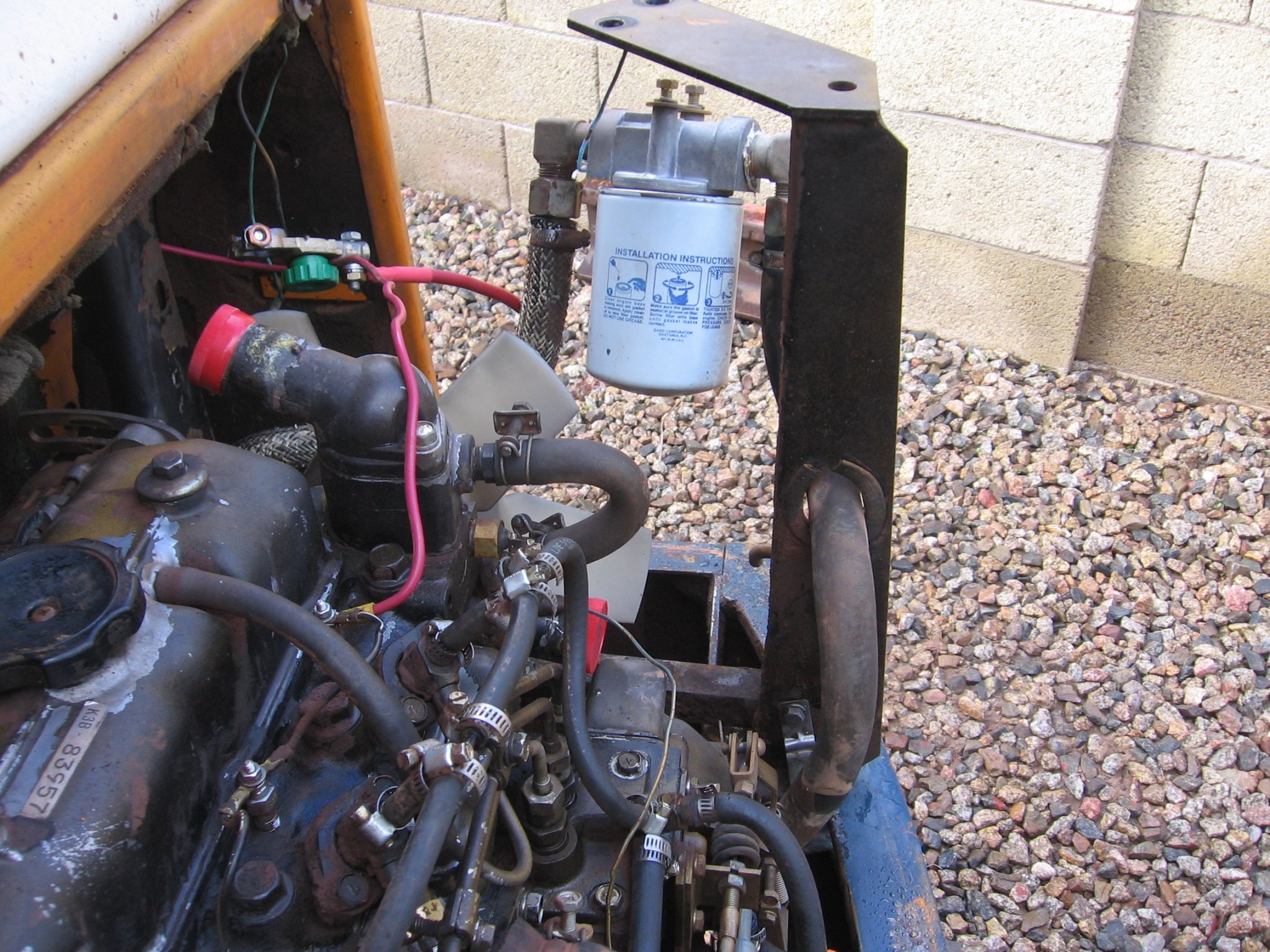

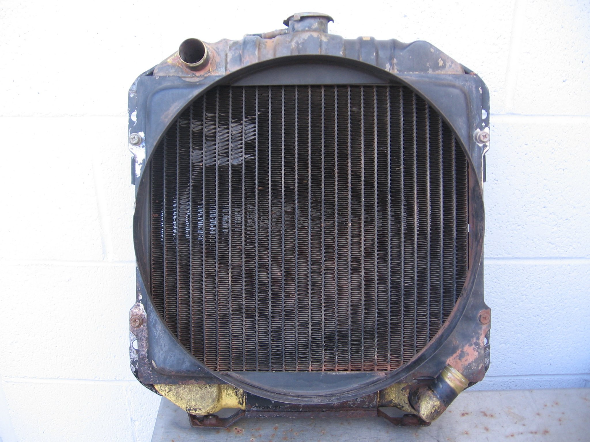

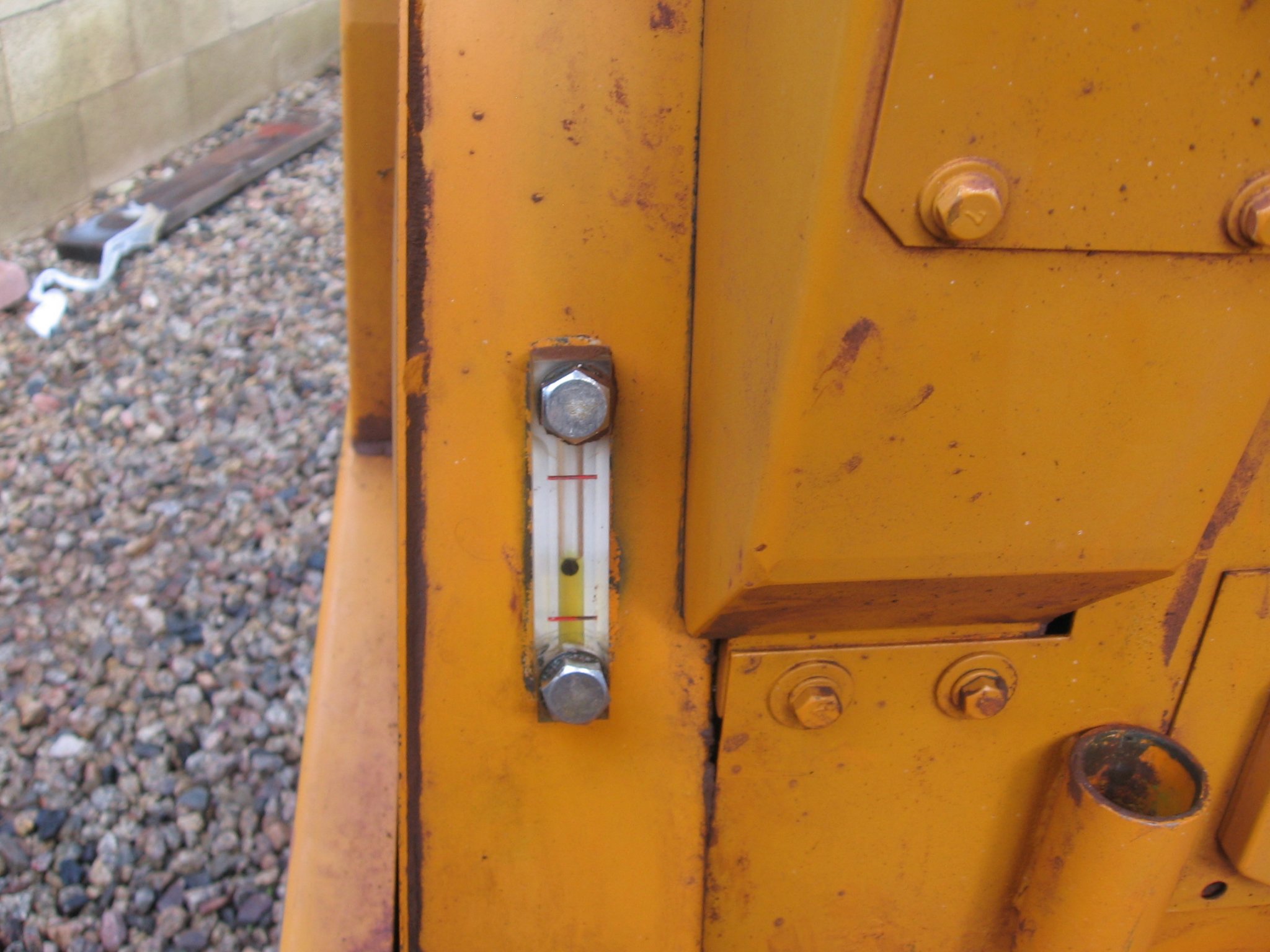

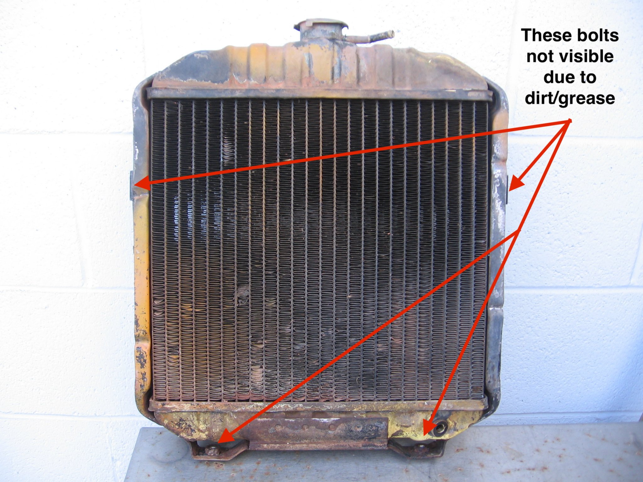

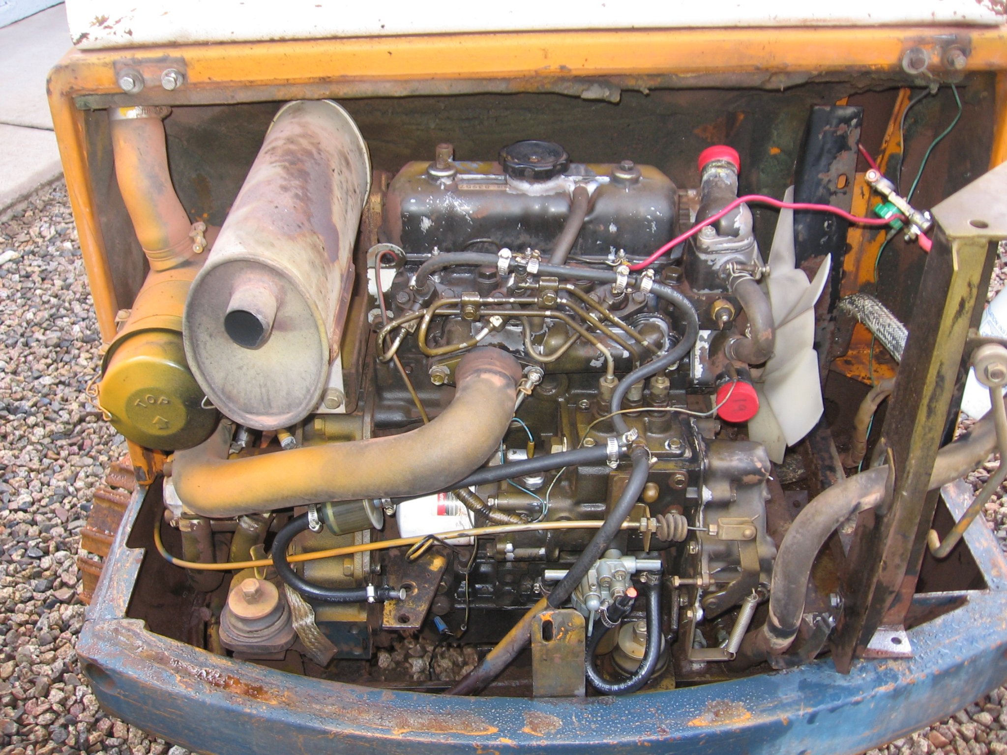

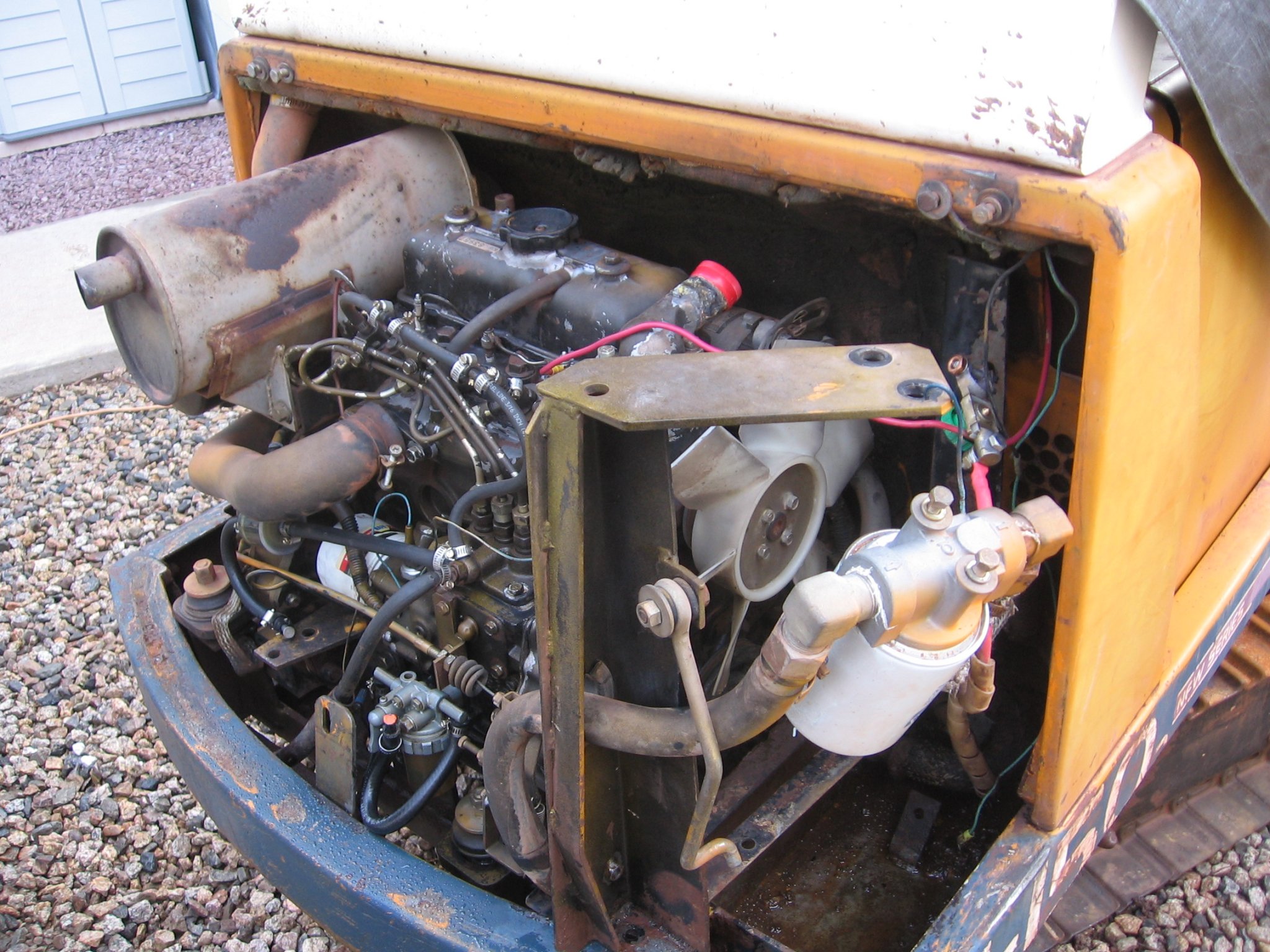

Pulled the engine cover for better access. Spent hours trying to figure out how to pull the radiator, finally succeeded once I figured out where all the bolts where. The radiator support, held in with (4) bolts, none visible under all the dirt, also supports the hydraulic filter. Hydraulic line goes through the support, (poor design, can't pull the support without breaking the hydraulic circuit) and the radiator & shroud is bolted to the support with (4) bolts, none visible under all the dirt. Radiator drain cock was broken off as I suspected, but came out easily with a LH drill. I had a couple new ones on hand, so easy fix there. Radiator has no leaks. Upper, lower, & bypass hoses all recently replaced, but clamped with wire hose clamps, which will be replaced with worm drive band clamps.
Now if I could only figure out where the block drain is.
Fan belt was not much more than a few cords with blocks of crumbling rubber, so have purchased a new one along with new hydraulic, oil, fuel, and air filters. Air filter happens to be the same one my B7100 uses.
The pics below showing the engine, radiator support, & radiator are all AFTER (5) rounds of engine degreaser, putty knife, scrub brush, and pressure washer.
Electric fuel pump is currently not installed, waiting for time to change all fuel supply & return lines.
PO did not know there was a hydraulic level gauge, it was leaking & covered with approximately 1/2" of dirt & grease/oil. Simply tightening the two chrome bolts & PWing and it is working & visible.
