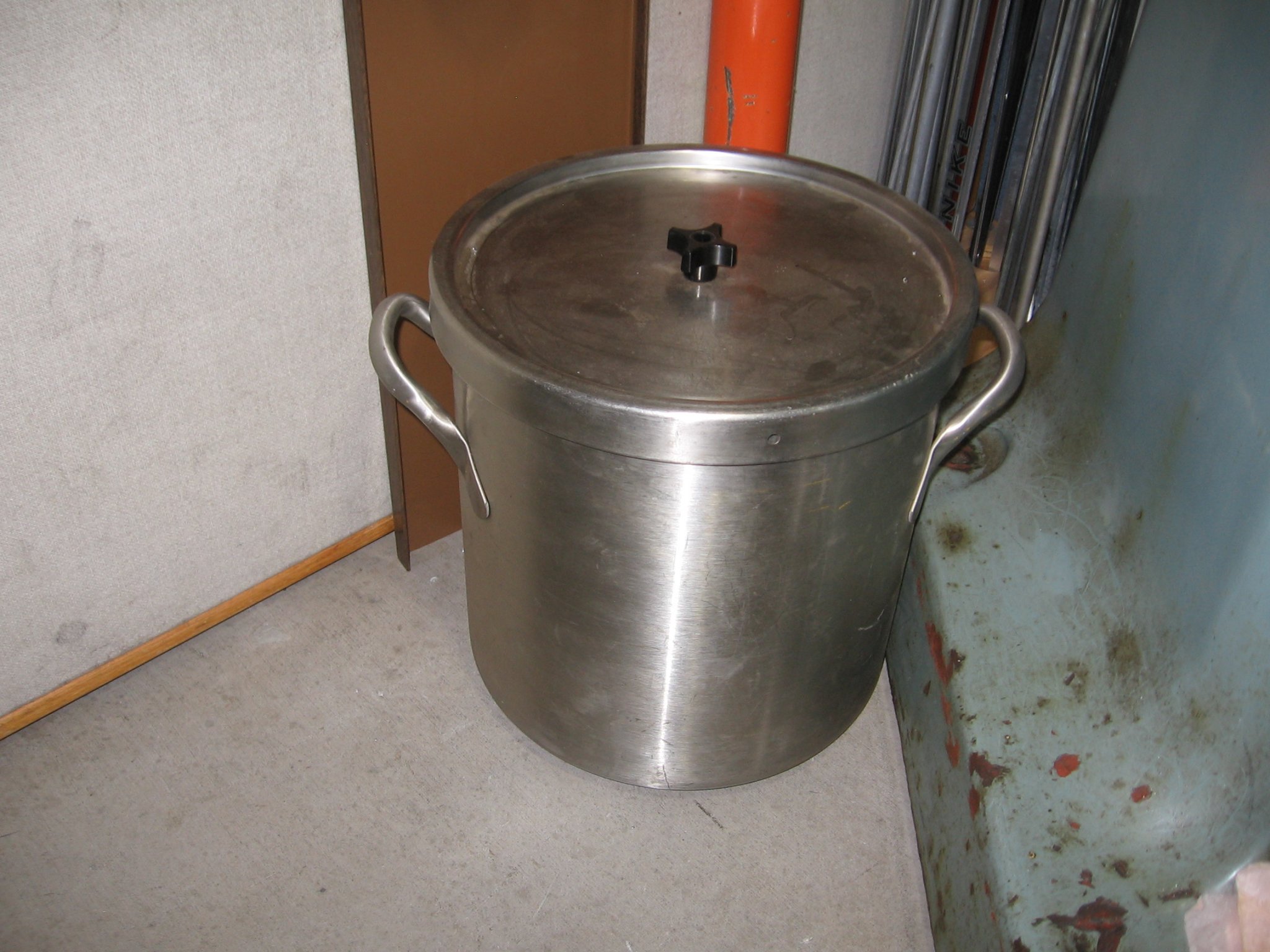

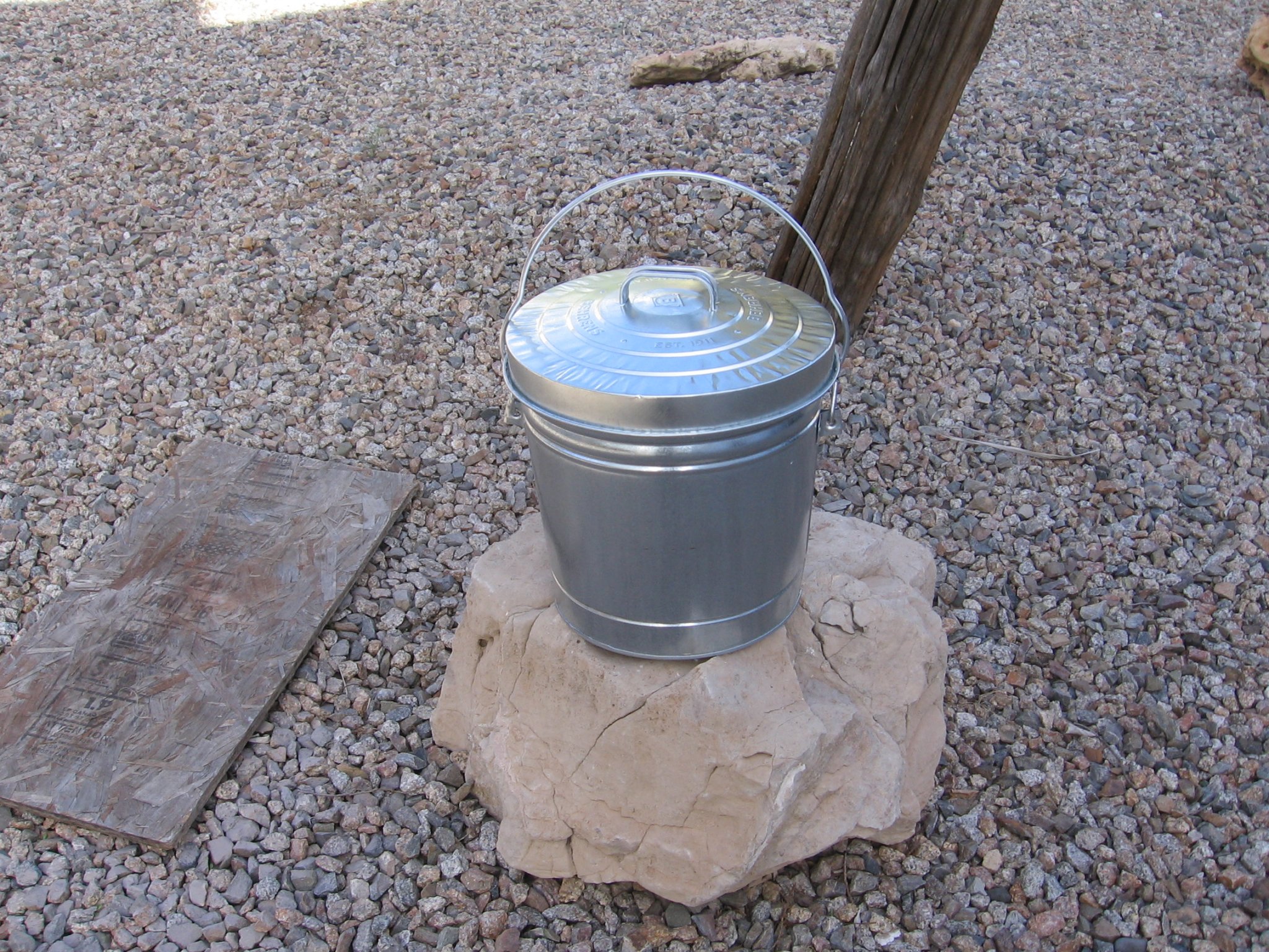

Recommend daily proper disposal of those greasy rags/towels.
1st pic is the can I use in the shop for oily shop rags.
2nd is the new 6gal can I will use in the back/side yard. I had been just bagging up the greasy/oily rags & paper towels, and just leaving then in the side yard (block fence & gravel) until trash day, but now they will go in the can till trash day.
View attachment 73176 View attachment 73177
I usually just throw my oily rags and paper towels outside my buildings, at the edge of some bushes.
Then, when it begins to look ugly, I pick the mess up on whatever day that I go to the dump,.....or I burn the mess on the ground myself.
No oily rags/paper towels will ever stay in any building of mine ever again!
I just barely dodged the spontaneous combustion bullet once!

I have only had two incidents.
1) I changed oil on one of my vehicles and the guy I rented from wanted it poured along a fenceline to kill grass/weeds. (Yeah, I know, neither one of us knew any better back then. '73?)
It was about 118, and within 5 minutes, the oil had ignited and was burning all the weeds. Got it out, never did figure out why it lit, but that stopped me from dumping it on the ground anymore.
2) That stainless steel can I use in my home shop (above) was from my egineering shop at work, where it was used for the same purpose, storing dirty/oily shop towels/rags. One start of the new year after the Christmas holiday, I came in, did some work, and went to throw a rag in the can. The rags were lightly charred, (google charcloth) but mostly still usable. Got a commendation for using the airtight can, saving a fire.
When they closed that shop, management insisted we throw everything away. After much arguing, I threw everything away. wink wink
