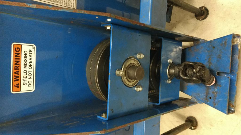

  2. There is room to play with pulley sizes. On the blower, the PTO input is currently on a 6" dual v-belt pully. The upper driven pullys connected to the actual fan is 5.5" I could swap some pulley(s) to make it so it spins the fan disc a bit slower thought being reducing the net hp required. Pushing air goes up cubed as RPM goes up , so this could potentially help it quite a bit. I wouldn't get the full rated CFM from the blower, i dunnoo what it is but that blower will blow you over, so a little less is fine for my needs. Thoughts on best pully setups to reduce load on the engine?

It appears the pulleys on the implement can simply be swapped upper for lower. That'll put the fan disk @ 2575 RPM which according to the math should require a 11-11.5hp motor to operate. That's free and fairly simple to try out. I'll give that a go when I get some time.

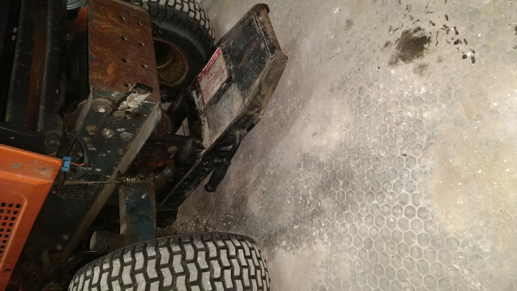

Is this a front or rear mount thing? Just curious what the quick hitch is.
Can you post photos?

It's a front mount hitch as per the title of the post. Factory option from kubota to mount a snowblower, blade or sweeper of which I have the first two. The male hitch part itself ( Kinda like a 2 inch receiver for a truck .....the part that attaches to the truck is custom, but the 2" receiver part is standard. In this case, the male quick hitch part is fairly standard across manufacturers. ) is somewhat std across many manufacturers. So other attachments with the female quick hitch from other manufacturers can fit on, like this debris blower, making them work properly is another story. My G5200 also has a cat 0 3pt. THis link has another pic with the snow blower on it.
So..I swapped the pulleys. ....i'd be the first to admit defeat. But..in this case. Swapping pulleys worked.....PERFECTLY! I can spin to full engine RPM, no more rolling coal!! According to my chart I'm probably on the low end now, but I can swap out one of the pulleys for a specific size to bring it into the 12-13hp required range.
And an idea of what the female part on the implement looks like. And the pulleys in this implement. WP_20191212_22_14_22_Pro.jpg
