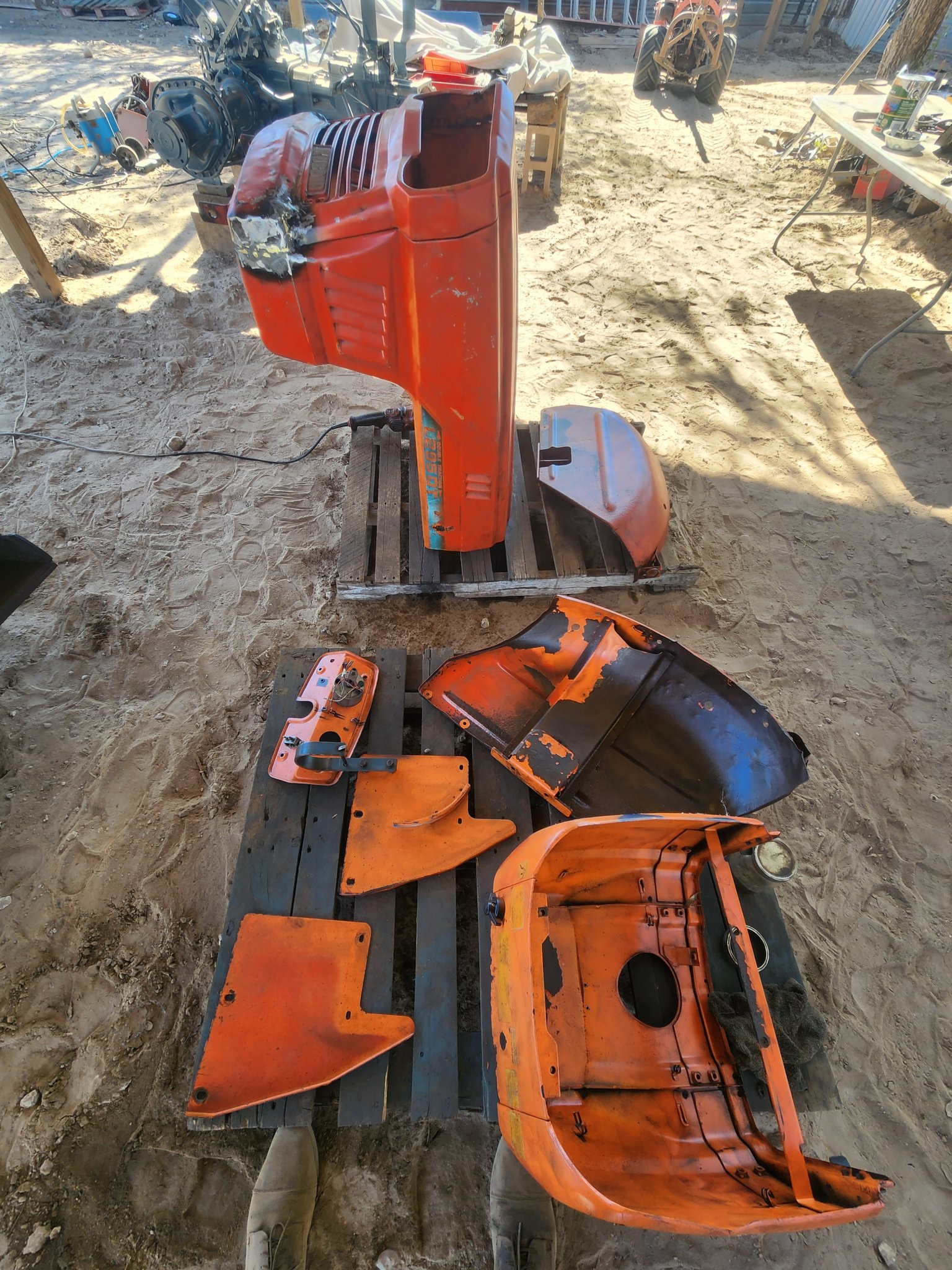

all part hit hard with diesel/air/wire wheel, even hit entire loader with fast wire wheel on polisher
now: hit everything with solvent, then hit with perfect paint

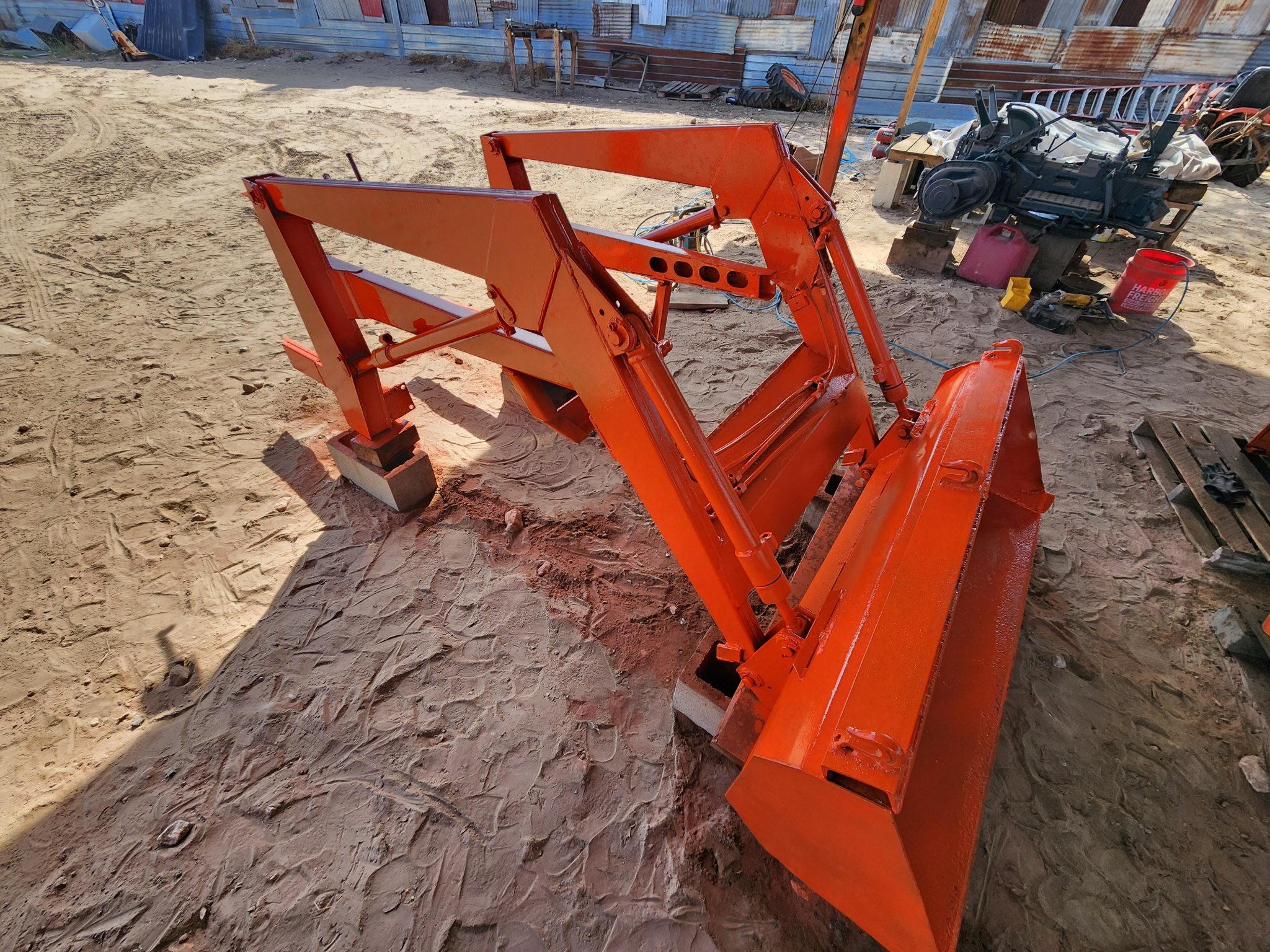

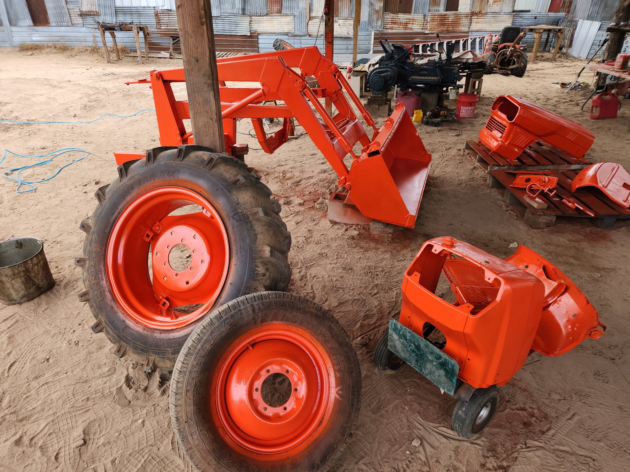

More coat paint, carefully flip parts
you do not realize how much steel there is to paint until you do it
almost out of orange paint one gallon
thinned down, I have sprayed 1.5-2 gallon paint
the loader alone take so much more paint than it look
paint both side wheels, move them carefully, drop one wheel in the dirt with fresh paint, use brush dip in sovent, remove the crud, spray again with orange,
went through up close for 2-3 hour hitting every surface, twisting the nozzle adjusting your target,
let parts dry somewhat, then carefully flip them over and do other side
now: keep scanning through and see if you miss anything until you run out of paint
walk away from fresh paint for 15 minute, let it cure, come back and finish off rest of kubot orange paint
"I ran out of kubota orange"
no you didnt, pour solvent in the gallon, shake it up pour that into your gun, spray that last bit
make $75 dollar investment into $750, squeeze every bit of value out of your investment

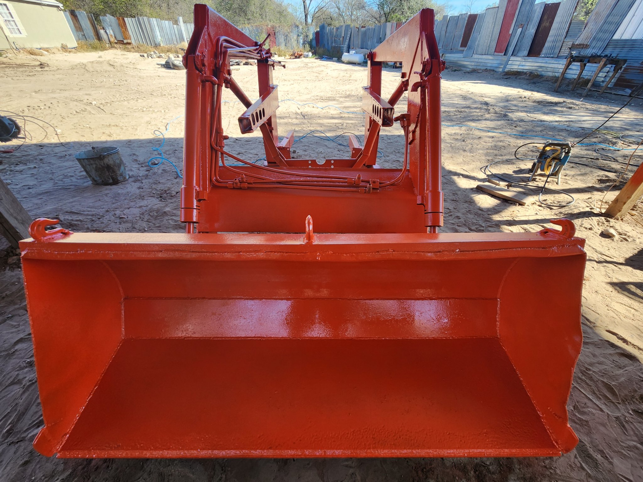

ok now, completely out of paint, this loader alone take gallon and gallon
the rest of the panels use up 25% of gallon, loader use up 75% of kubota orange
I underestimated how much steel there is to cover, it is more than painting a car

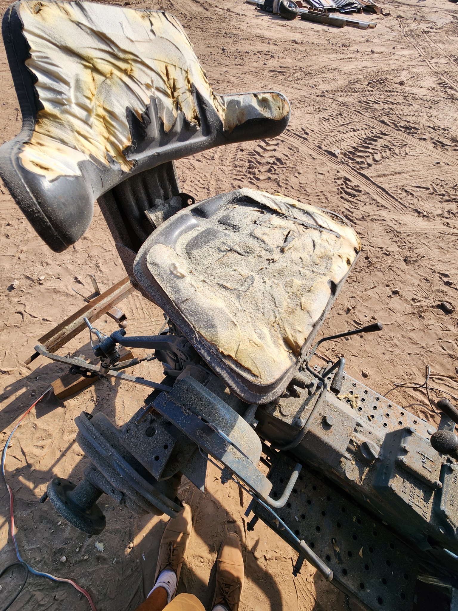

the seat is not sitting right on the chassis, it need to come out and I need to realign those bolt hole or drill new ones
take out current bolts, see if you can align the bolt hole and fasten it straight

Joe when you paint your wheels carefully smear a thin layer of grease up to the steel on the rubber of the tire. When the paint is dry, wipe the grease off.

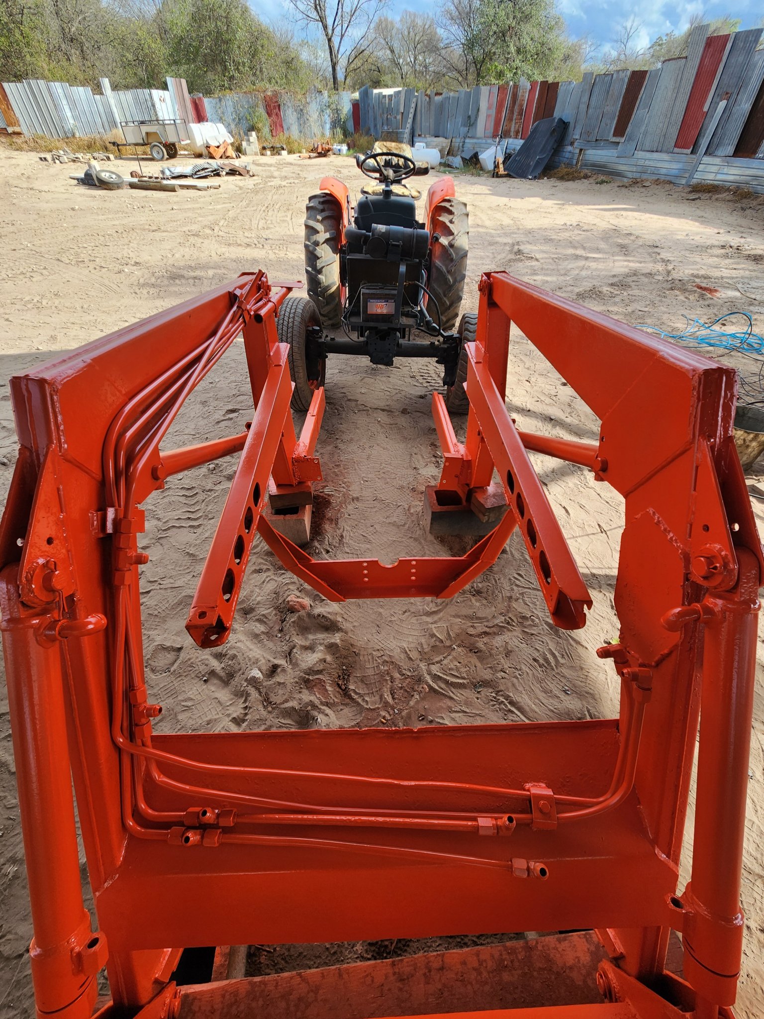

yes, reinstall orange parts, get L295 attach to its freshly painted loader, and other many tiny task
ton of task going through your mind: fix the seat, put on the fenders, take off steering wheel, reinstall the dash and components, cant put the hood on because I need access to the decompression lever, somehow fix that later on so you can put the hood on,
simplify plan and be practical:
fix the seat, put on the fenders, put on all wheels and get it off block, raise the loader, get L295 attach to the loader,

grind down seat, hit with compress air, got 2 or 3 bolt on the seat more straight, good enough for now, put towel over it, keep show moving
install fenders, seat no longer sharp, all it needed was 5 minute grinding wheel

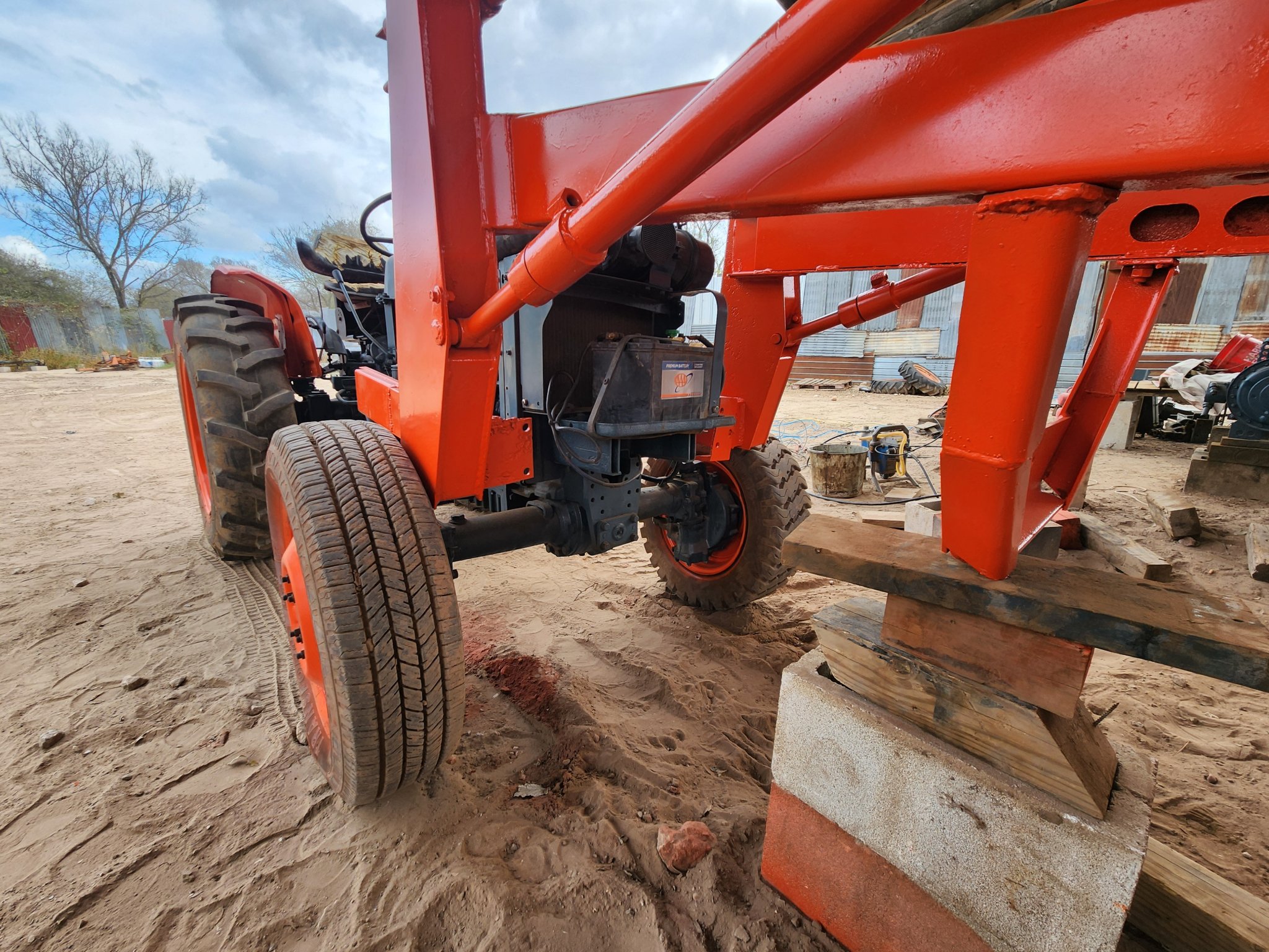

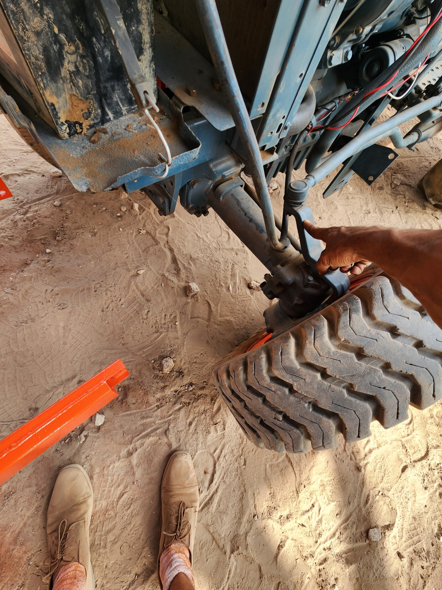

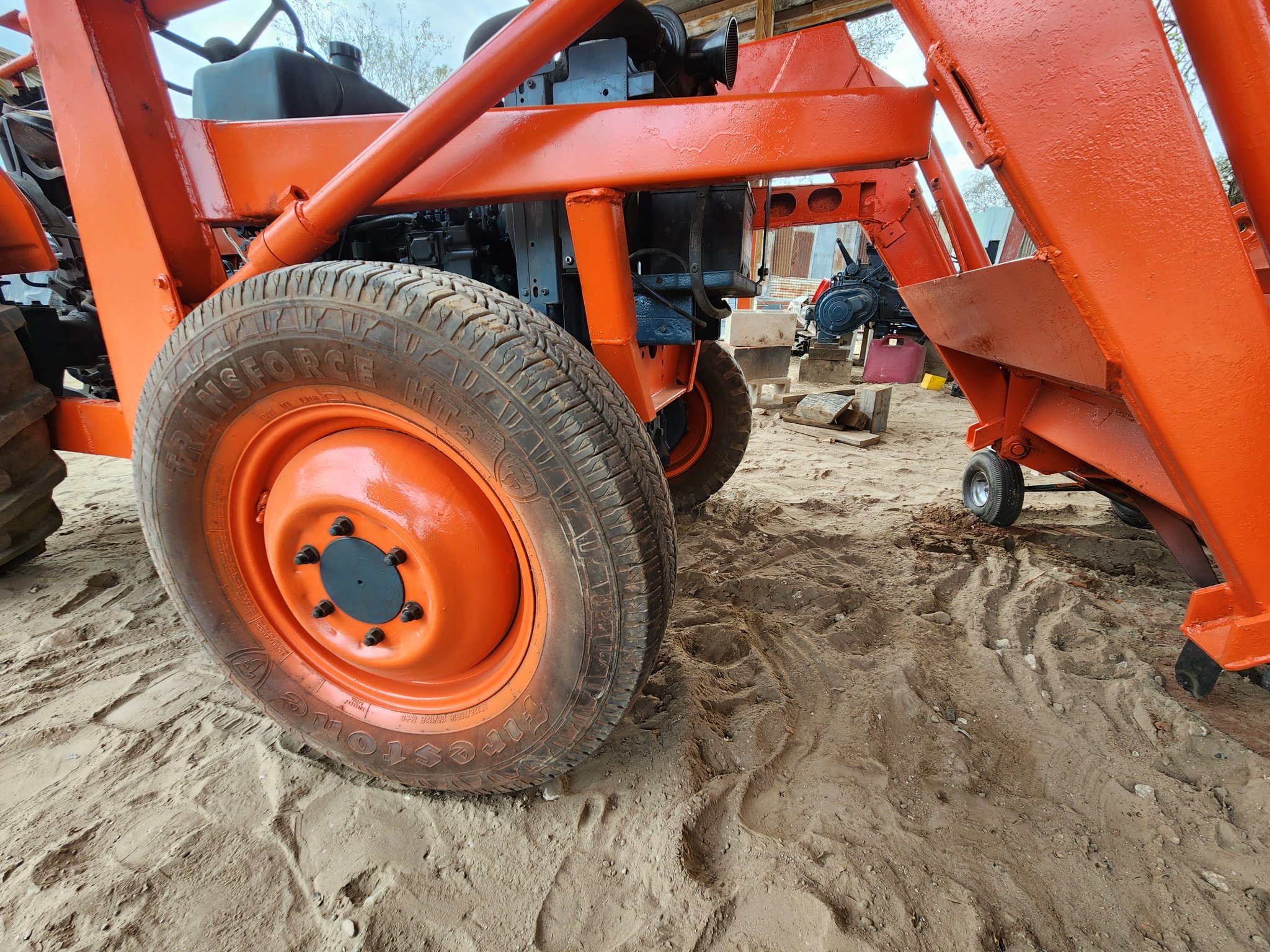

put on all 4 wheel, get L295 off of block, lift up on loader, ease L295 into position to get bolted to its loader...
get the wheel on, lift up on tractor, take out all blocks, she back on her feet
dont scratch paint too much when putting wheel back on
assess the charging/hillbilly ignitiioin situation, get her started, go get her connected to the loader
i wish bx1500 was not fully seized, I would lift up and down on loader using its 3 point hitch,
as I get L295 chassis bolts to line up with the massive freshly painted loader
small win: the hillbilly ignition work. It killed the battery, recharged it, and started without a jump, and
seat actually comfortable in the state it is in

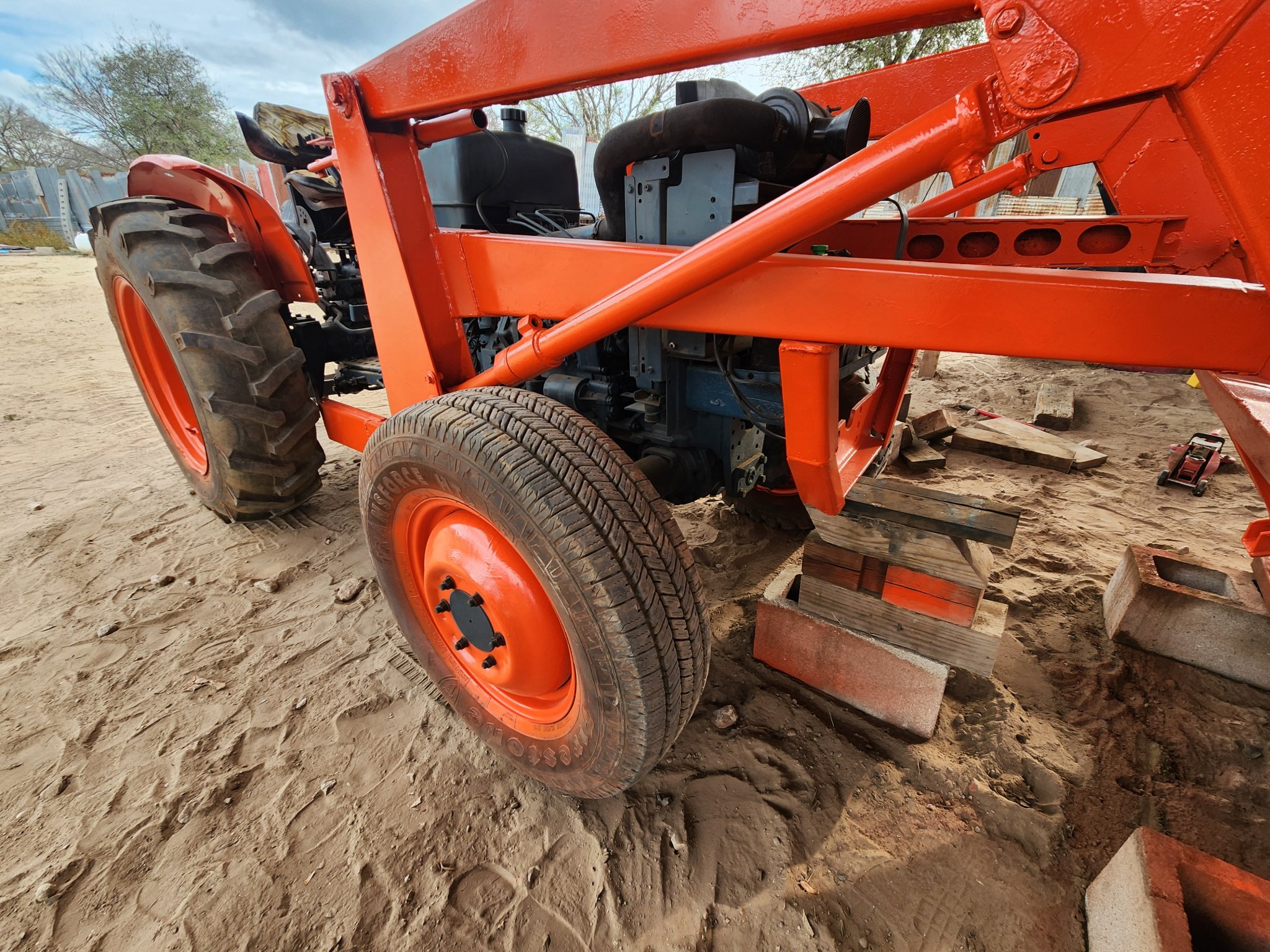

move L295, line it up with rails on loader
rails have to be lifted where I point to clear chassis,
lift up on the rails using cheap jack, get over the hump, move L295 forward, drop loader rails, align all bolt hole, get bolts in there
keep lifting up on loader until axle goes past the brackets, then drop the loader, move L295 forward, line up front bolt holes, then rest of bolt hole
wrestle around in the dirt getting blocks in place, get up maneuver L295 slowly forward, get back in the dirt, lift up on certrain areas, almost got bolts lined up
somehow got 2 bolt in one corner, lift up on bucket with cheap jack, get your dolly underneath, now
use dolly to pull left/right, use cheap jack to lift up/down, get your bolts in, make sure you put washer, fasten them tight
Finally got the six bolt that hold front of loader, and got a mock bolt into the four corners holding onto tractor
I agree, for what little effort it takes to mask off the tires from the wheels it makes a HUGE difference in your paint job. Nothing worse than overspray on tires.
this task take way more out of me than all the engine/piston/gear work,
underneath machine, covered in dirt, one wrong move and you injure yourself especially head,
in the dirt, dragging blocks all over, going deep underneath to fasten a bolt, dont forget a single detail or you wear yourself out from too much motion
unable to move single muscle, covered in dirt and kubota orange, narrative ask:
"now you see how deep you were in that engine and how much work it take to get to it?"
I would think those miss matched front tires are going to be hard on your 4wd ratio.
