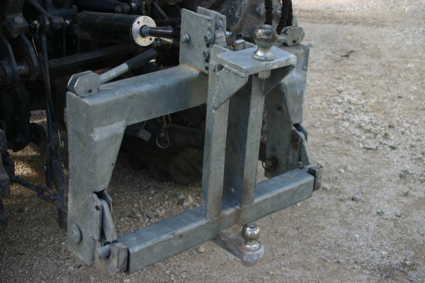

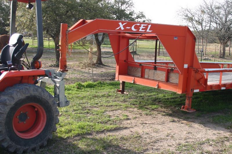

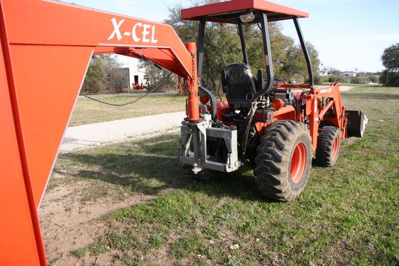

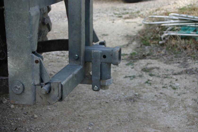

I noted the nice job jb62901 did with his drawbar and thought I'd show the one I constructed about 6 years ago. Since I had the quick hitch, I built the drawbar to fit it. And since I hate to paint and only lived about 15 miles from a place that galvanizes steel, I had both the quick hitch and drawbar galvanized. I realized later that I had no way to hook up my 8,000 lb Warn winch, so I built the hitch receiver to fit over the 2" ball. So far the only thing that has broke was the winch when I tried to winch out a 20" log and it caught on a stump.
