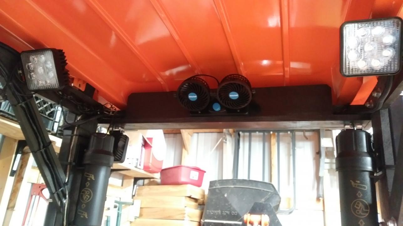

I equipped my home-made cab on my B7100 with one of these 2-speed metal fans:
https://www.amazon.ca/dp/B00065JM8U
Hung it from the roof. 8" diameter. Draws 1.2 amps on high, 0.6 amps on low so no problem with the charging system. Ball socket base allows it to be aimed where I want.

Yesterday I was using the tractor (with the fan on) and suddenly noticed it was hanging from the wires! The ball socket joint broke. I hope it's just a fluke -- it was a great little fan until now!
