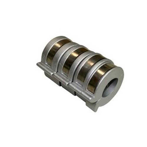

Technically you can do it if it's on the stroke where the rod is internal, you would have to take the cylinder apart and add an internal stop, for external stops, D2CAt put them up.

you 'could' cut /hack off the mounting trunnions, make new ones, weld them onto the bucket. usually by the 3 rd or 4th attempt the sky goes gray ,being filled up with #&^%(four) letter words......
there's 3 or 4 other ways ,all involve money, time and effort......
hopefully the 'spacers' will do it though....
