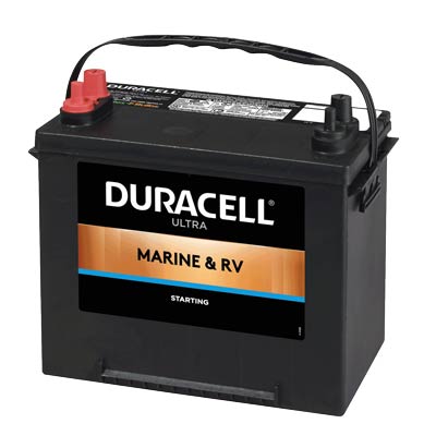

Kubota seems to go out of their way to keep the group size a secret. The parts manual for your tractor has the following in Remarks column: 55B24L(s). I suspect that is the JIS designation Fordtech asked about. A Google search returns that battery as
9 3/8" x 5 1/16" x 8 13/16"
410 CCA
20aH
Here is one source - apparently used in and available from Honda. Should not be too hard to find.

My CNH/Kubota dealer sells CNH and Kubota batteries but the overwhelming majority of sales are Deka, which is what I have been buying for the past several years with very god results.
I bought a new battery for my B1750 about 2 years ago for $88.90. Yes, my parts guy gives me a good customer discount and prices have gone up.
The battery in my B1750 is used in many Kubota models and may be the same as used in your 2620 because it is made with both regular and "reversed" terminals. The reversed terminal model fits some Honda Civics of years past.
I bought the extra capacity HD reversed model, which is a 651RMF. This is designed for HD applications ahd also has a higher CCA rating. This is not a common battery so my dealer needed to order it for me but the truck from their battery supplier visits each week.
I do not have the measurements in front of me but believe that this is the battery that you need. The 651RMF (extra capacity) version is the same dimensions as the standard version, reversed or otherwise (the R in the model number indicates reversed) it simply has a higher CCA rating and costs a bit more. It is intended for high vibration applications such as tractors rather than automobiles.
Any decent battery supplier can look up the 651RMF group number and tell you the dimensions as well as CCA and price.

It may well be a Group 51R
About 450-500 CCA
Very popular Honda battery.
Good Luck!
Bingo.
Most likely.
This battery is available with both standard and reversed terminals and the dimensions are the same as batteries used in many Kubota models.
Both HD and extra capacity versions are available from Deka and (probably) others.

I didn’t double check old hokie, but if the jis number is 55b24L then it converts to a group 51R.
Must be it maybe. Even my parts book for my tractor, it has part numbers and prices for every piece, the cables, the hold-down's etc. But where it shows the battery, all it says is "battery" LOL
Here is all that is on it.
