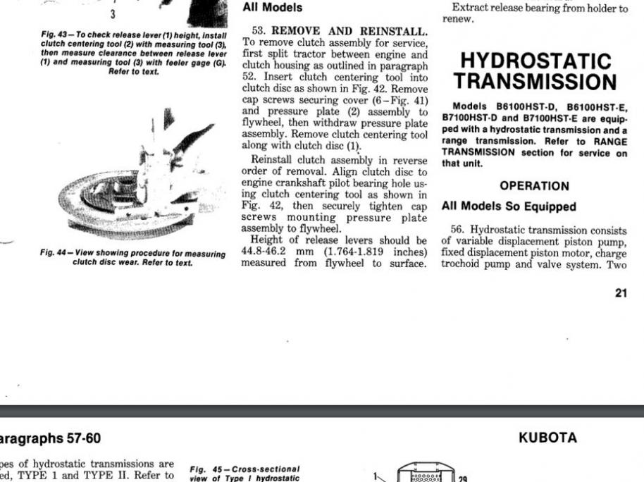

Torch.....
check out part 2 .....pages 21 through.....well till you are tired of reading! All the HST is there ......:)
Hokie,
No offense intended, but the links you provided are for the Intertec aftermarket manual. Kind of like a Clymers or Haynes. Part 1 is 18 pages, part 2 is 12 pages, part 3 is 16 pages. A total of 46 pages. The index in part 1 references up to page 100, so something is missing from the set.
The link I provided is the complete Kubota FSM for the HST version. 355 pages, all present. Plus I added bookmarks to each section. That's what I meant when I said "If you have the HST version, then you want this one".
Actually, peaking inside, I see that it actually includes the gear transmission too, and that the gear transmission is actually one of the sections missing from the Intertec manual, so I guess I should recommend it for all versions of the B6100 and B7100. Doesn't cover the B5100 though, so the Intertec manual is still necessary for that model.
Good point - looking at the 3 part series, some great info and some not so great info - I down loaded your version again...only to find I had it already;):)
thanks for the mo' better book:)
