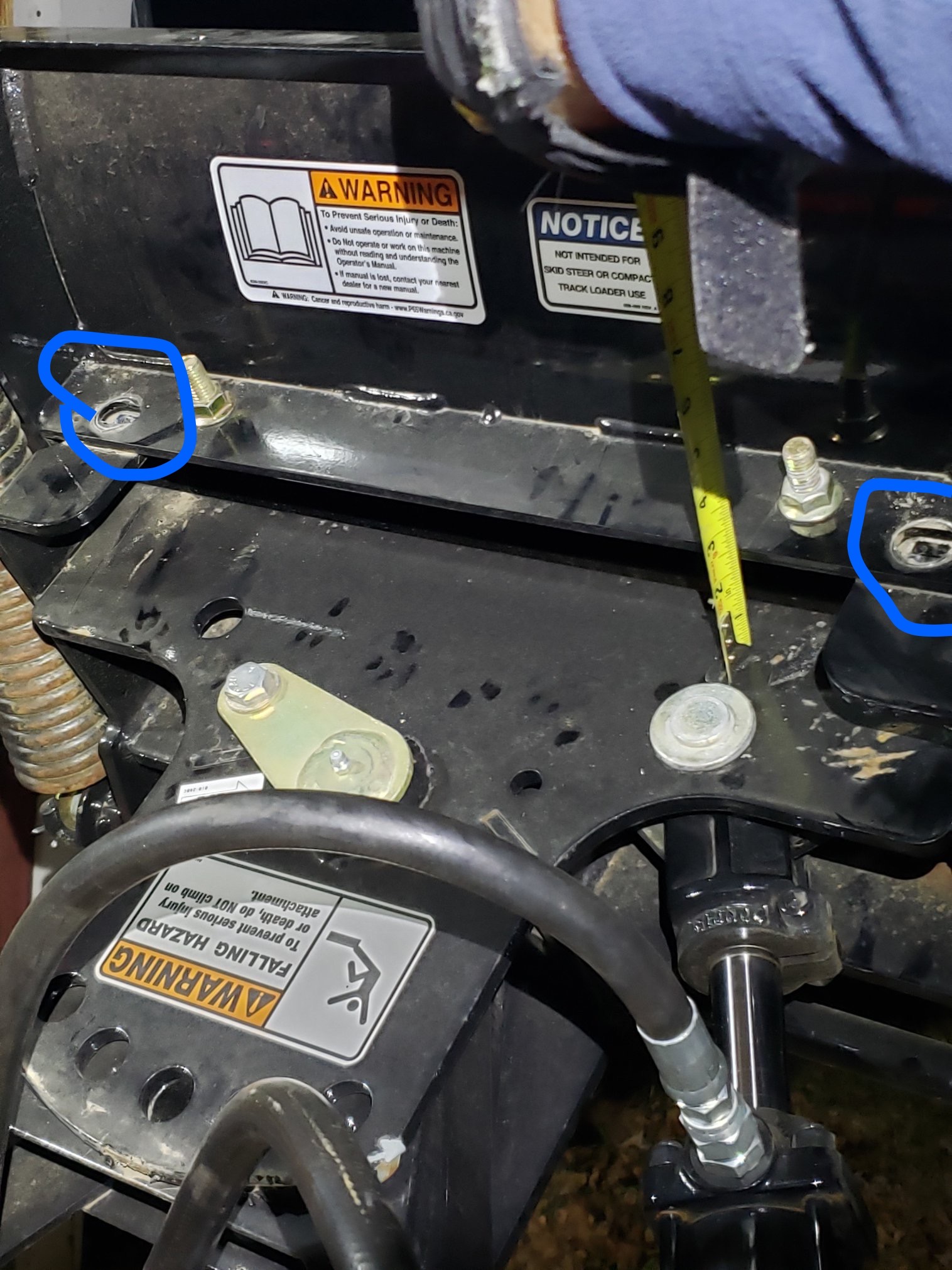

from the parts manual It looks like the 'blue circled' holes ARE the real mounting locations for plow to hitch and pivot assy.
also curious as to WHAT the right bolt/nut is doing !!!
OK makes sense, you type a lot faster than me.
With the bolts in the locked location, trip springs to nothing.
gets even more curious.....
You don't have one of the skid shoes higher than the other ??
Maybe remove the blade from the H+P assy. Measure the 'pivot'/ 'mounting ' holes. From the maunal they look the same....... With blade off you can also measure a few other points.
I'd help but I've lost my YELLOW tape measure in the garage,arrrrrrgh..
