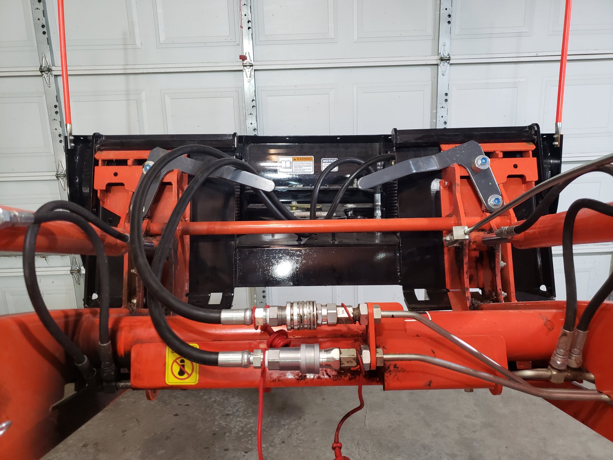

Maybe this picture will show what I am seeing. You can see the qa plate against the white background. Left side is just above. Right side is much higher. So the qa plate and the blade are not on the the same plane.

I posted a another picture showing the qa plate crooked to the plow blade.
When I looked at the photo I thought the left side was higher than the right, if the garage door is level...as viewed from the operator's seat.
Regardless, you need to be sure the tractor is level with respect to other measurements you may take. Need to reference everything back to he tractor to get the truth.
The garage door doesn't really matter its just a white background. The top of the qa plate on both sides should line up on both sides of the plow shouldn't it? Edit: re-read your post. Yes the plow is higher on the left side.

Take the blade off and check your SSQA to see where it sits on the floor. Looking at the picture it appears that your SSQA is racked and out of level. Check the top with a 2x4 across the two arms and a 4 or 6-foot level. I kind of doubt that the plow blade is the issue.

Added some pink tape to the top of the qa plate. Maybe can see it better now. The qa plate sits straight to my loader arms. The plow is what seems to be crooked.

Looking at the difference in how the qa plate planes out with the blade, not how it lines up with the garage door. This pic may help to explain. See the pink tape sticking above the plow on the right while the left is "flush". The pink tape is on the qa mount corners.

How do things look when the loader bucket is installed? Same or different?
This may give you a hint about what is going on. Just trying to help, nothing more... (y)
After though: Don't write off the previous suggestions by others to check rear tire pressure. A slight difference can make a much greater difference at the end of the loader arms.
Also, there could be an actual difference in the diameters of the rear tires. This has been reported before and has the same affect as different tire pressures at the end of the loader arms.

OK, I like pink as NOW I can see the black plow way above the black QA part of the plow frame.
Something ain't installed correct on the 'plow package'
BTW my garage floor is not level or flat, has dips in it so LOUSY as a 'reference'. Concrete pad outside is 'flat'

The SSQA plate is not welded parallel to the blade. P-poor quality fabrication. I can eyeball closer than that with my eyes closed!
