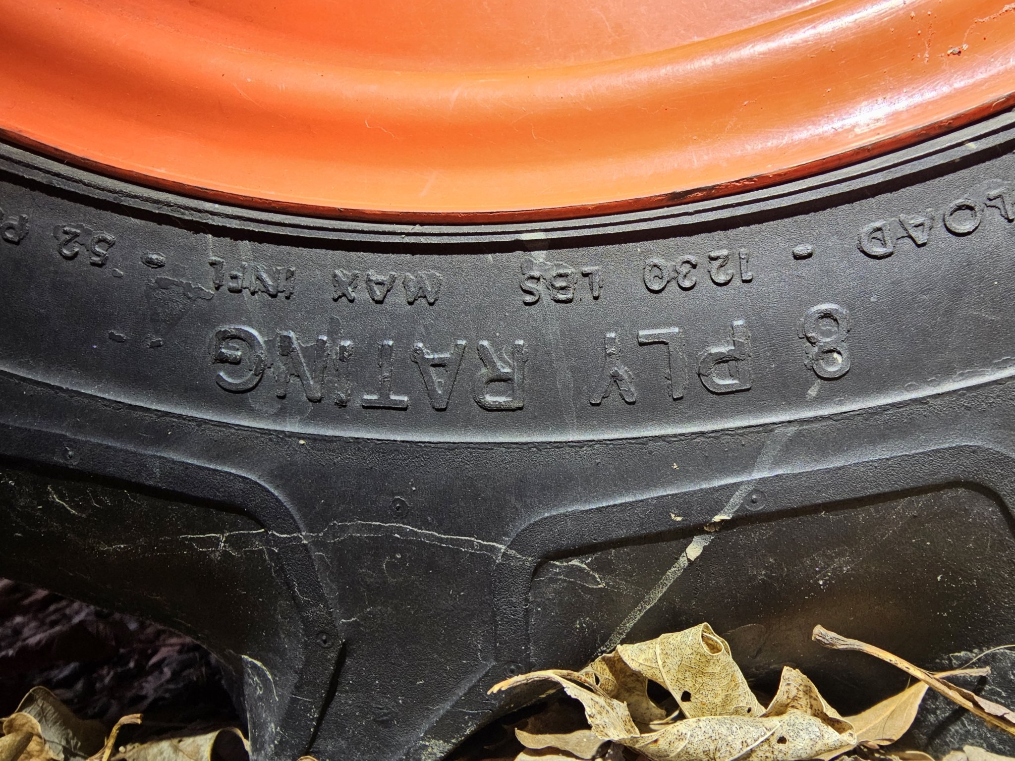

I stopped at NAPA, Dawn couldn't find one for liquid so off I went and stopped at car quest they had sold the one he keeps in stock so order me one and I'll pick it up next week.
My tires are R1 and heres the sidewall specs,
29,360
5,646
My tires are R1 and heres the sidewall specs, View attachment 98795
That explains it, 8ply.
Manual show only 4ply tires.
