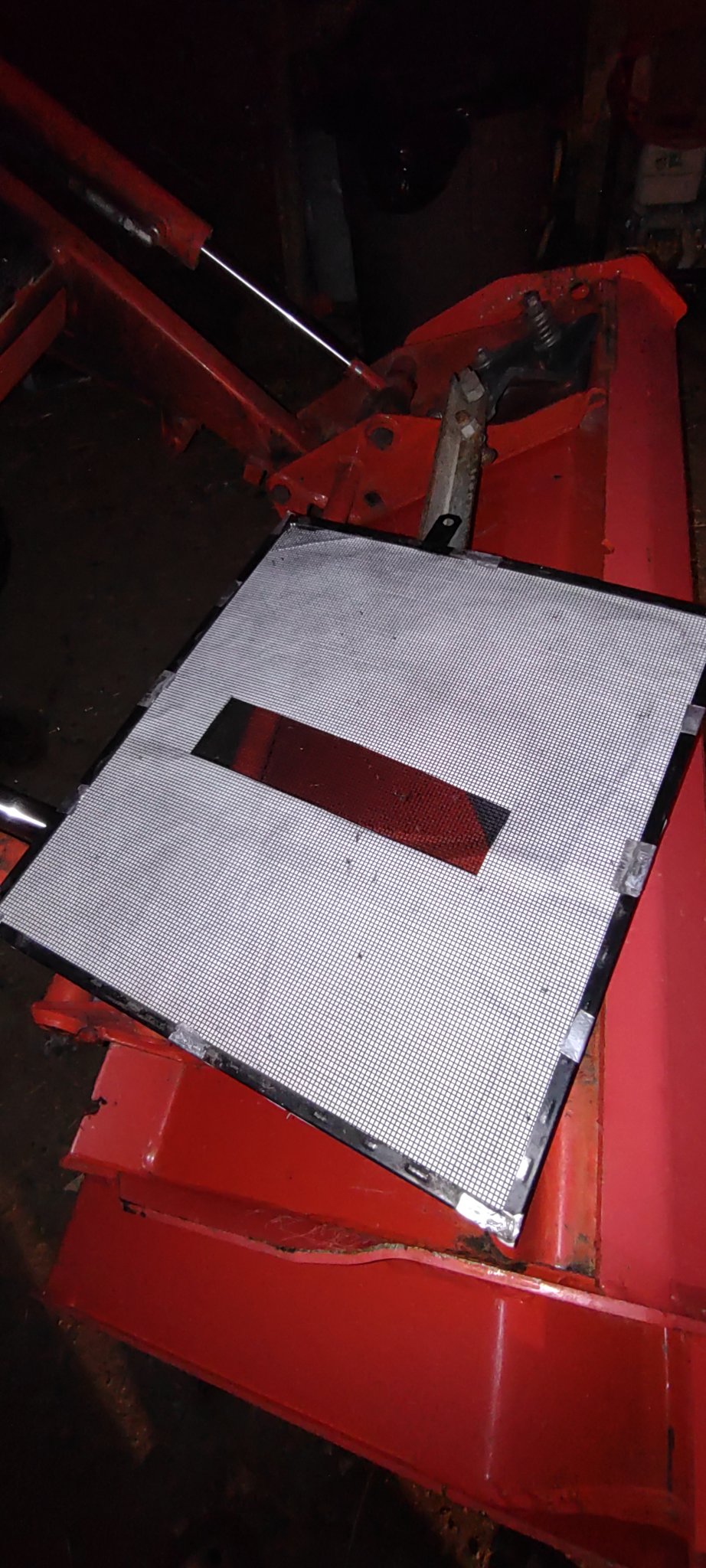

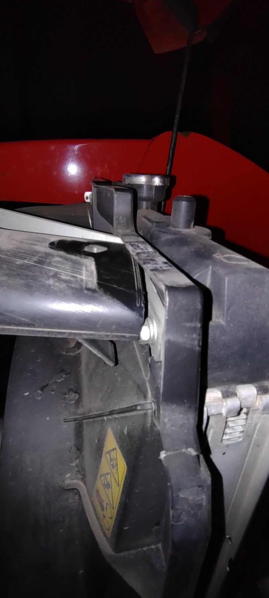

i mad some mods to my tractor's air inlet and rad screen to help deal with this very issue of the air filter snow clogging and rad ice and snow buildup with fluffy cold snow. Costed only a few minutes of my time, works fine so far.
Note how I notched the bottom lip of the air intake end. Allows for unrestricted air flow when tucked behind the rad, pic 2.
Warm weather position:
Snowblower weather position:
Tyvek rad screen winter cover:
