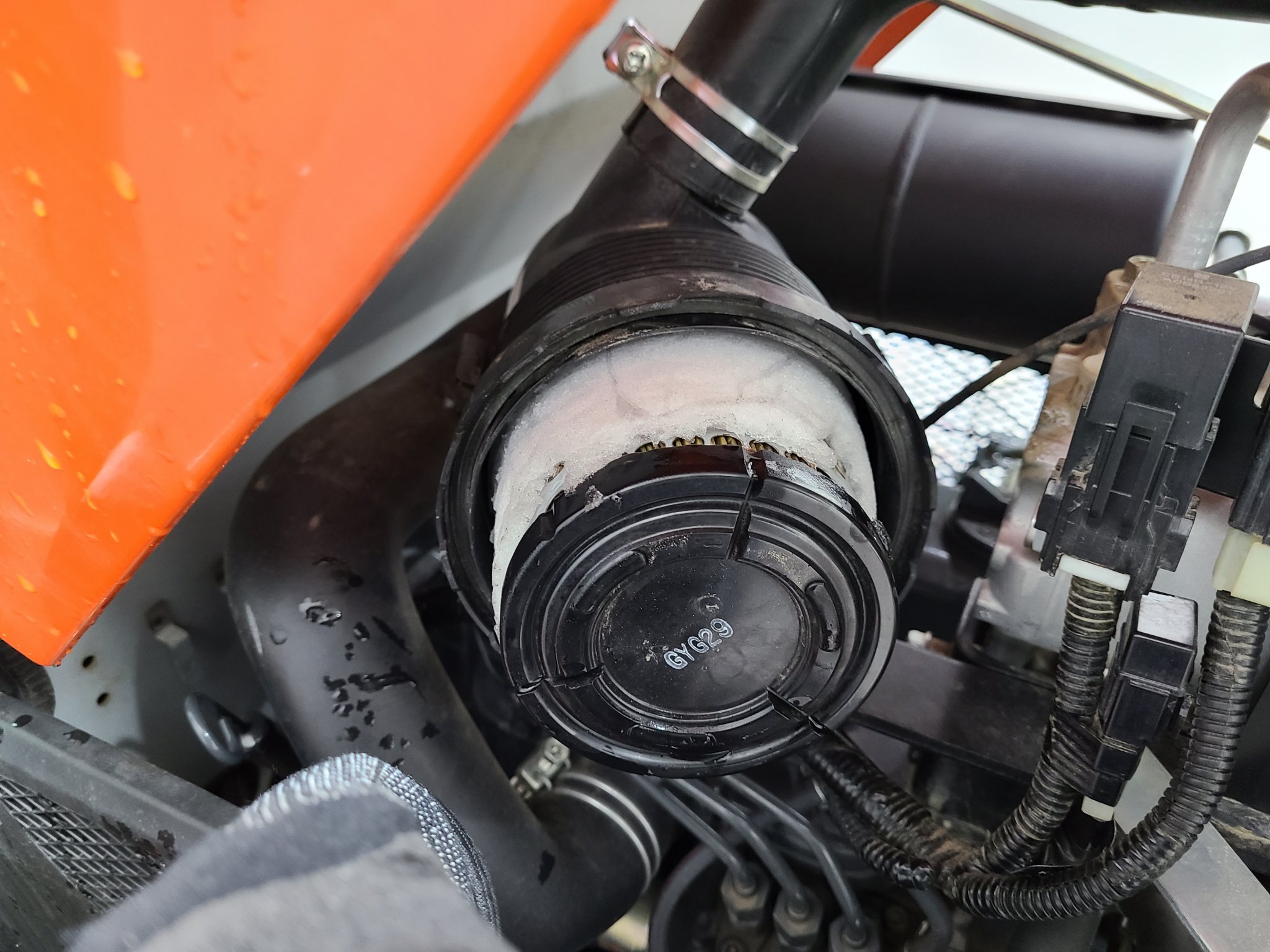

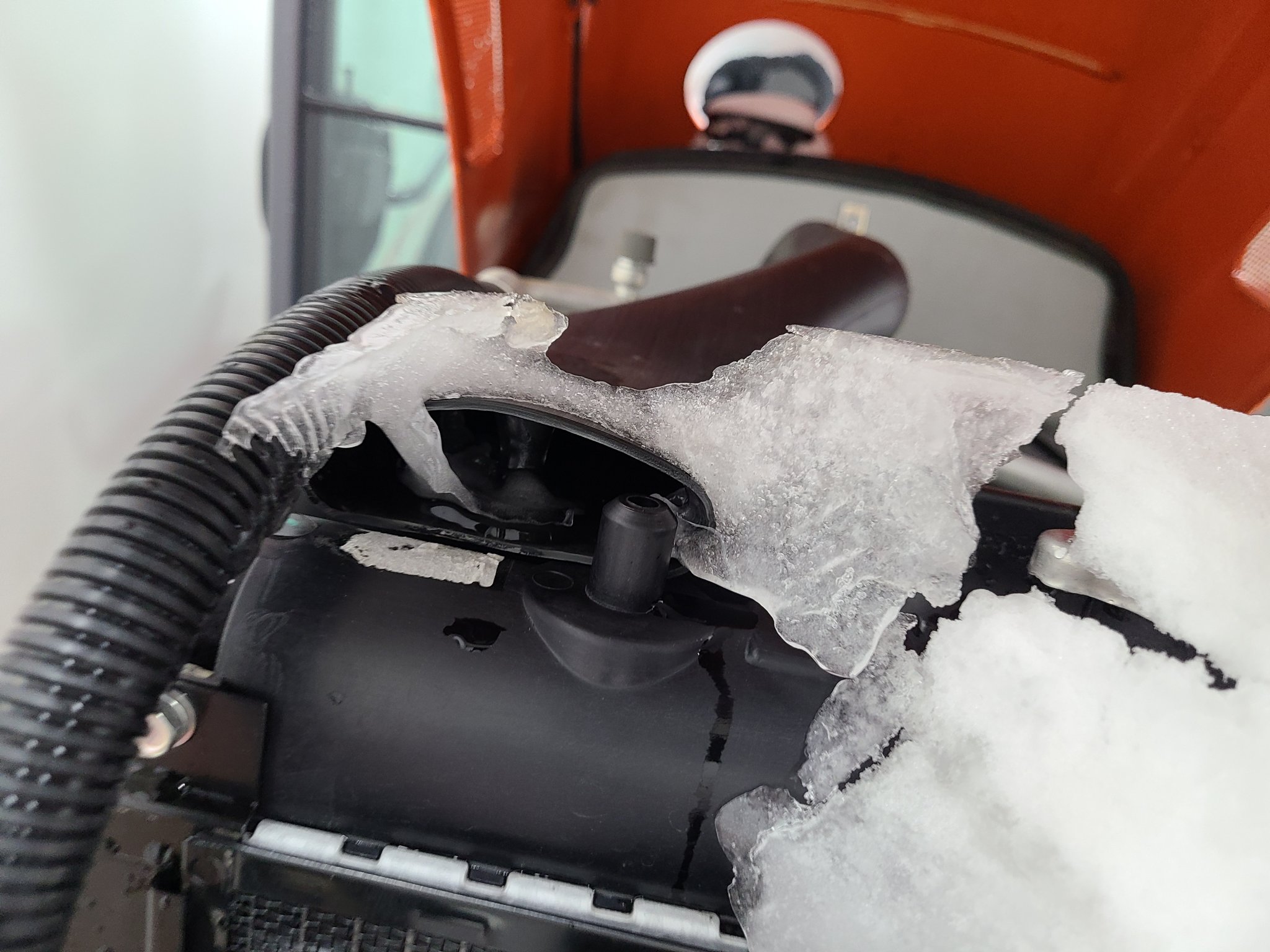

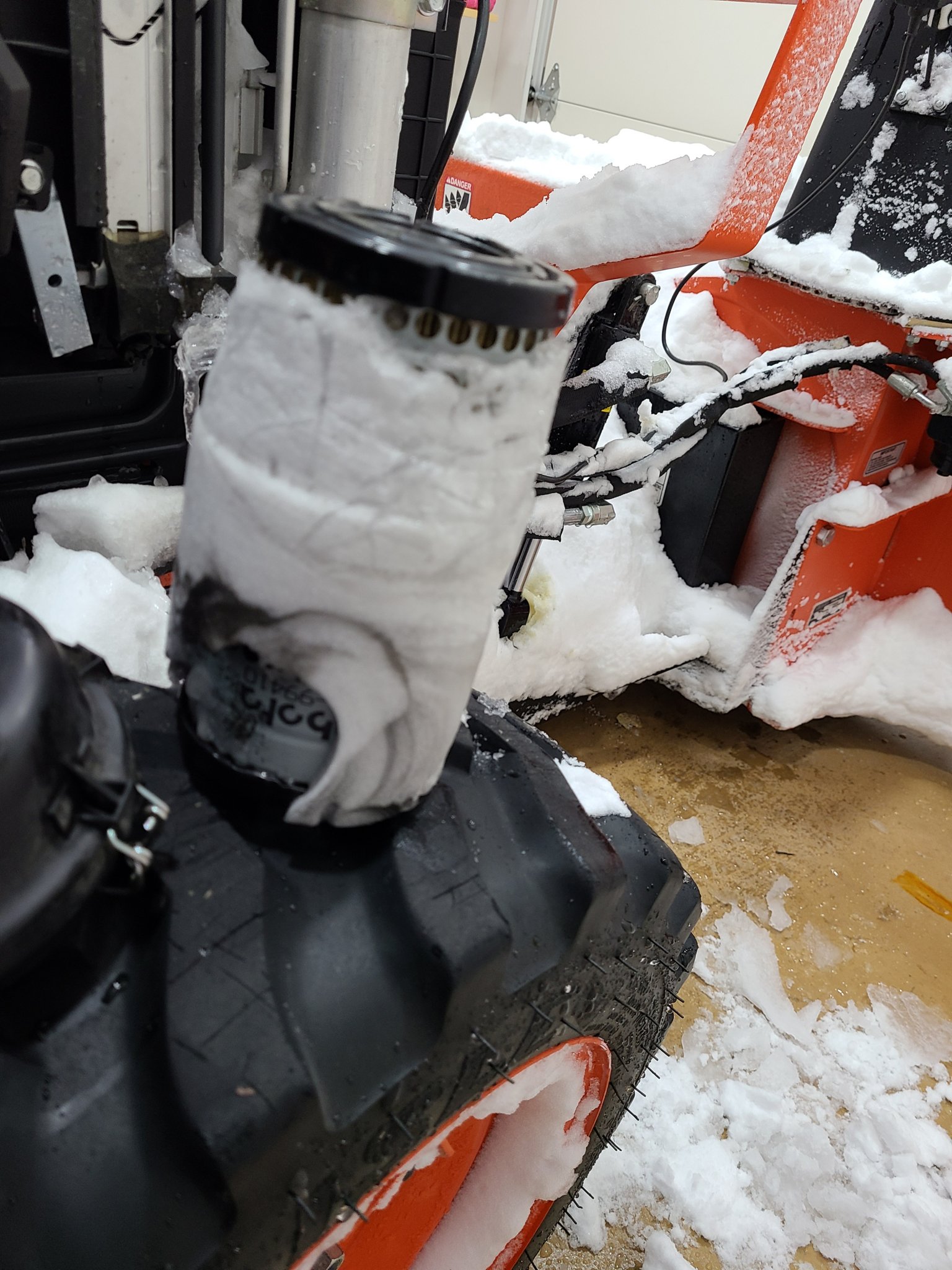

I have a B2650 and for the last 4 years have struggled with snow clogging my air filter. The symptoms are while blowing snow always at around the same area of my driveway my engine would start to lug and blow black smoke. I would then have to bring the tractor inside and remove the air filter and let the snow melt then dry out the filter.
Then I found my new best friend David. David created a solution that my dealer could not.

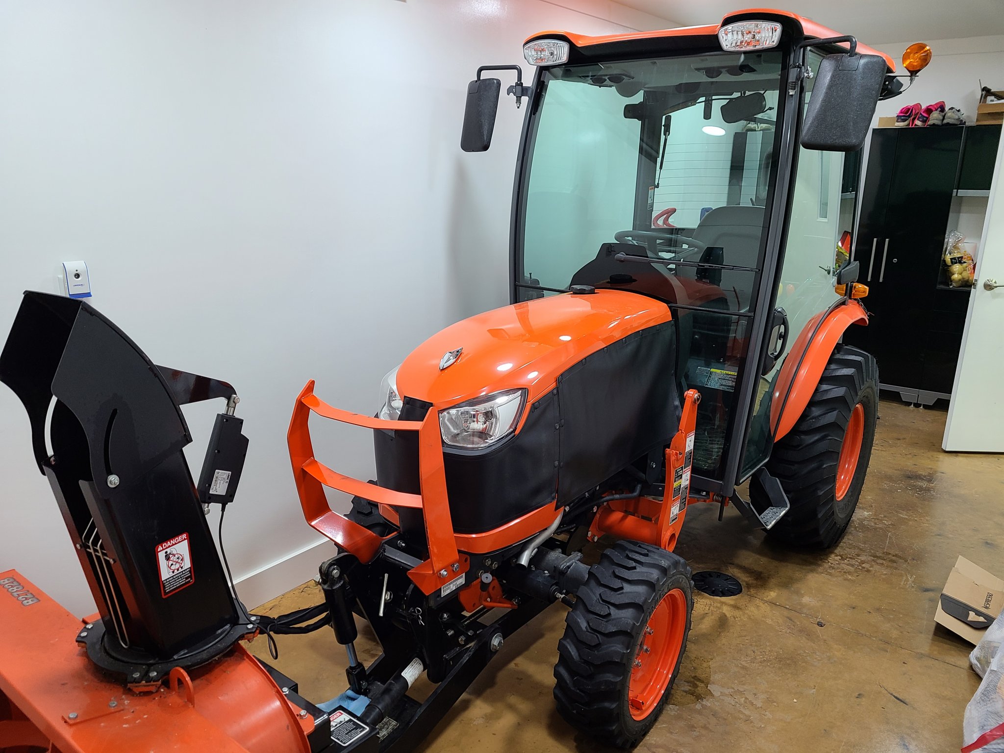

here are my before and after photos.
David manufacturers a set of covers for the front and sides that attached with magnets. David can be found within this forum and he makes a great product and provide excellent customer service..

looks fantastic - any trouble from not enough air getting to the radiator for cooling?
Or is that not even a problem?
I've used my set and before that an improvised cover (old bedsheet held in place with magnets etc) and not had a problem. The middle one seems to be critical to keep the whole engine bay from packing full of snow. I was also trying to deflect snow with a feed sack over the brush guard.
You can contact him at.
dbratager at midco dot net
View attachment 51175 View attachment 51176 View attachment 51177
Zach, after looking at your photos again, it appears that you may have a hydraulic leak on your hose or cylinder for raising your blower. There is a yellow patch of snow right under the cylinder in your first picture. You may want to check for leaks.

Zach, thanks for the kind words! (I’ll send you the coupon for the free steak dinner later!) Just kidding! Your air filter pictures look pretty nasty and the covers should really help to alleviate that! Post pics and the results after you use them in similar conditions.
To help answer some of the questions above…..here’s what I know so far:
I initially made my covers to help my B2650 warm up to temp and retain the heat in our sub zero ND weather while blowing snow. Since the area underneath the tractor’s engine is not enclosed, there’s never been a problem with not getting enough air circulating from the fan which most likely mixes air drawn in from below with that which is already warmed up around the engine. And when the outside air temps warm up enough it just takes a moment to first remove the side cover(s) and finally the front one.
I also noticed that without the covers on in cold sub zero temps my hydraulic oil must’ve been cooling down enough where I couldn’t keep the RPM’s up to speed. Using the covers fixed that as the hydraulic oil cooler sits just in front of the radiator also. Enough heat gets retained under the hood to melt the snow off the top of it so you know the fuel in the tank is being kept warm too.
The problem of the snow/frost being ingested into the air intake was unknown to me at the time as I use a rear mounted snow blower. That the covers helped to alleviate that problem was an added bonus that the first users commented about. Because of their ease of use compared to shifting and remounting air intake tubes, quick warm ups, keeping the engine temps in the “normal” range, warm fuel, etc., users in these colder climates like using the covers.
Regarding the possibility of routing the air intake tube into the cab of the cabbed models for a “warm air supply”: The calculations of how much air moves through the engine (especially at rated rpm) and the required fresh air breeze of cold winter “make up air” entering the cab might make it too uncomfortable. That would be an interesting/worthwhile experiment to find out.
