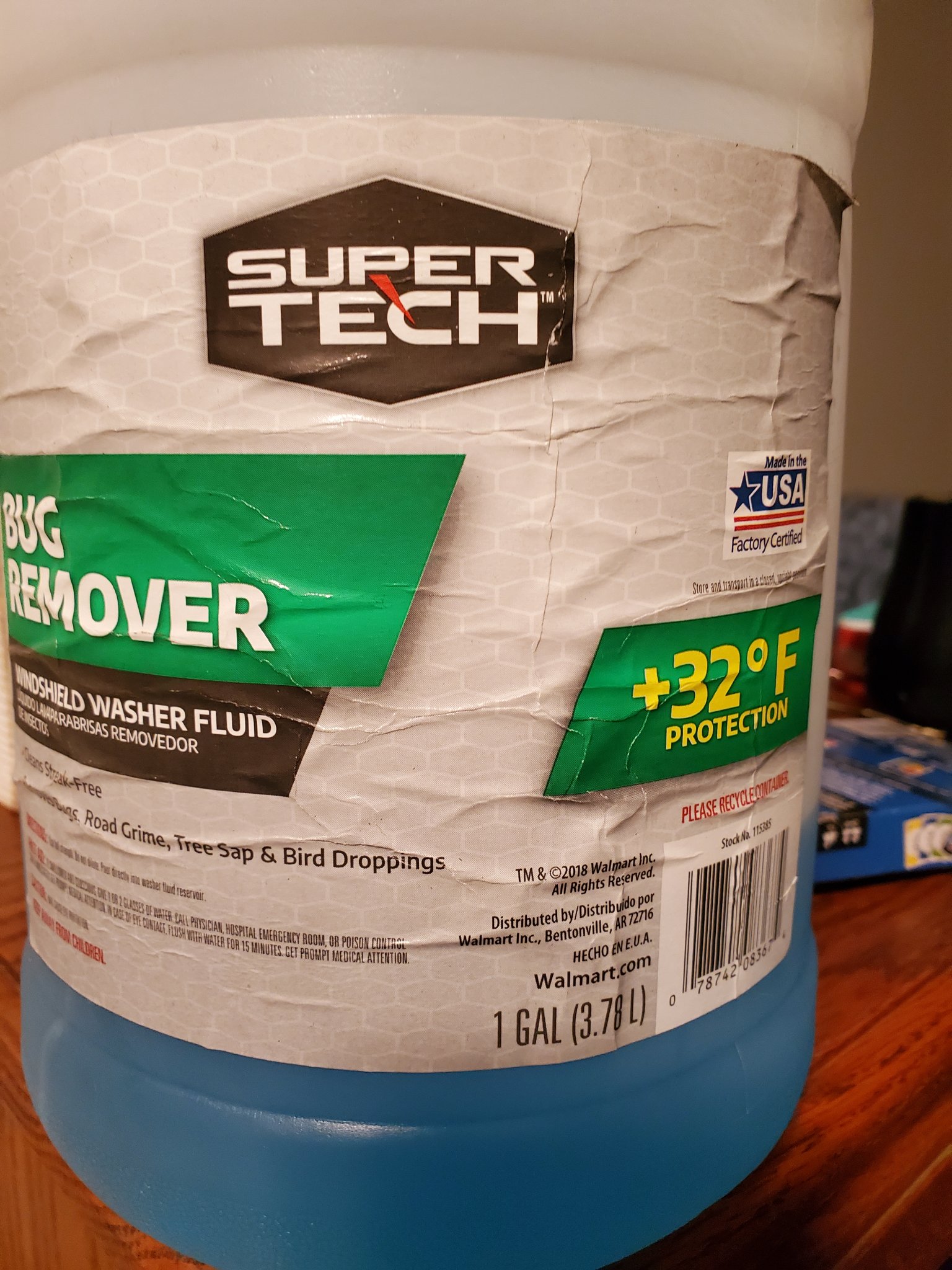

Full disclosure: I didn't look at the jug when daughter filled the reservoir the other day, nor last night prior to posting. Only this morning to take a picture and post it. Had I known it was only +32⁰ stuff I would have made her exchange it and never put it in the car. I took another hit of the stuff and it smells just like propane gas....rotting cabbage smell.
5,178
3,842
Contact the store where it was purchased and tell them. I would also ask for a refund or replacement. Most stores and manufacturers want to know when a product goes bad on the shelf, so they can pull it and replace it with a fresh product.
Magicman
Oct 8, 2019
5,098
6,538
80
Brookhaven, MS
knotholesawmill.com
The wrinkled label indicates that it's an older jug, but I question why +32 would ever be sold in MI ?? I know its for Summer use, but the seasons & weather change. I avoid using +32 and I am in the Deep South.
13,010
4,391
That label says 2018, so the product was made that year or later. Can't imagine those ingredients causing a stench like that, even if it set on a shelf for that time.

They use methanol in some washer fluids
Borane4
M4-071
Dec 16, 2020
105
+32F washer fluid is water, some type of detergent, and dye. It can grow algae or bacteria. In this case probably contaminated with SRB bacteria that smells poopy. Washer fluids that freeze below 32F will have some level of alcohol in them, like methanol or ethanol that usually protects them from microbe growth. If very old, they can lose the alcohol through evaporation and then get funky. Lesson is to always buy WW fluid with freeze protection.

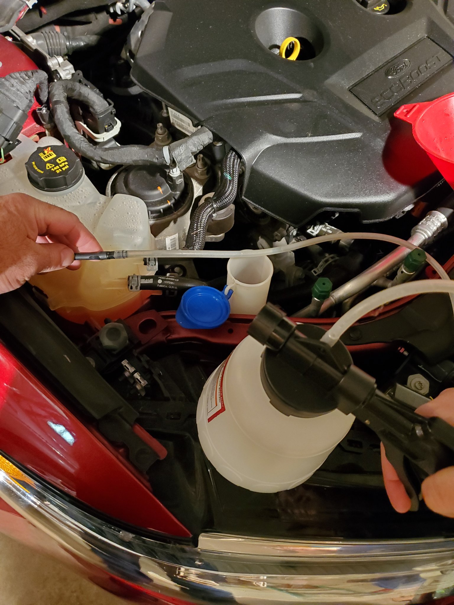

Yeah the wrinkled label is suspicious. I didn't buy it, but I think it was that way at the time of purchase. Anyway, I found a connector in the line that was right out in the open so I hooked up the trusty Harbor Freight pneumatic brake bleeder up to it and sucked all the stinky stuff out. Put some fresh in and sucked it through the pump. Hooked the lines back together and we're good to go.
