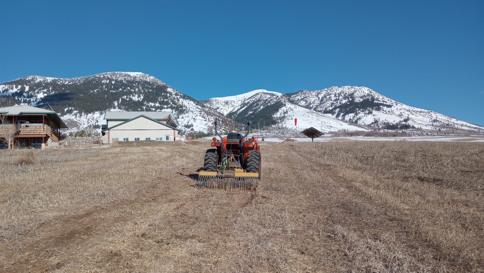

I put all the heavier scraps of iron I have laying around on the landscaping rake and ran it up and down the runway plus the trails I ride my bikes on. The extra weight really helps in getting the results I'm after. I also have a 100 year old harrow that I can drag around, but the rake is easier to manuver. View attachment 125704
Quick right trurn after TO?
Heavy, heavy Spring snow, 15-17", blowing hard to tell. I had to bust out of the 450' driveway. It was tough going on the uphill.
Hell,......It is already melted!
Summer is coming!
Summer is coming!
No turn required, as the mountain drops away for 1200' vertical before the valley floor, it's much easier and safer than taking off a flat and level runway.
8,005
5,181
"mountain drops away for 1200' vertical"
"much easier and safer than taking off a flat and level runway".
Kinda depends on how close end of runway is to 1200' drop off.

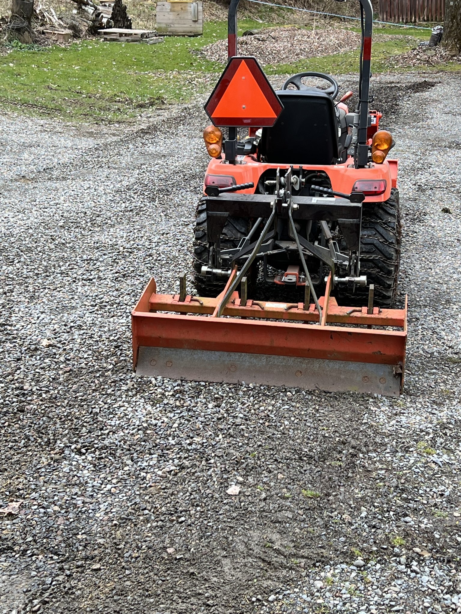

Driveway was in decent condition, but needed some high/low spots smoothed out.
Boxblade with a long top link is my go-to. We’re at the bottom of a hill, so controlling sheet flow of water is paramount to avoid washing the driveway out.
Profile of it has proven pretty good, so I try to do just a little bit a time to prevent changing the drainage pattern too much at once.

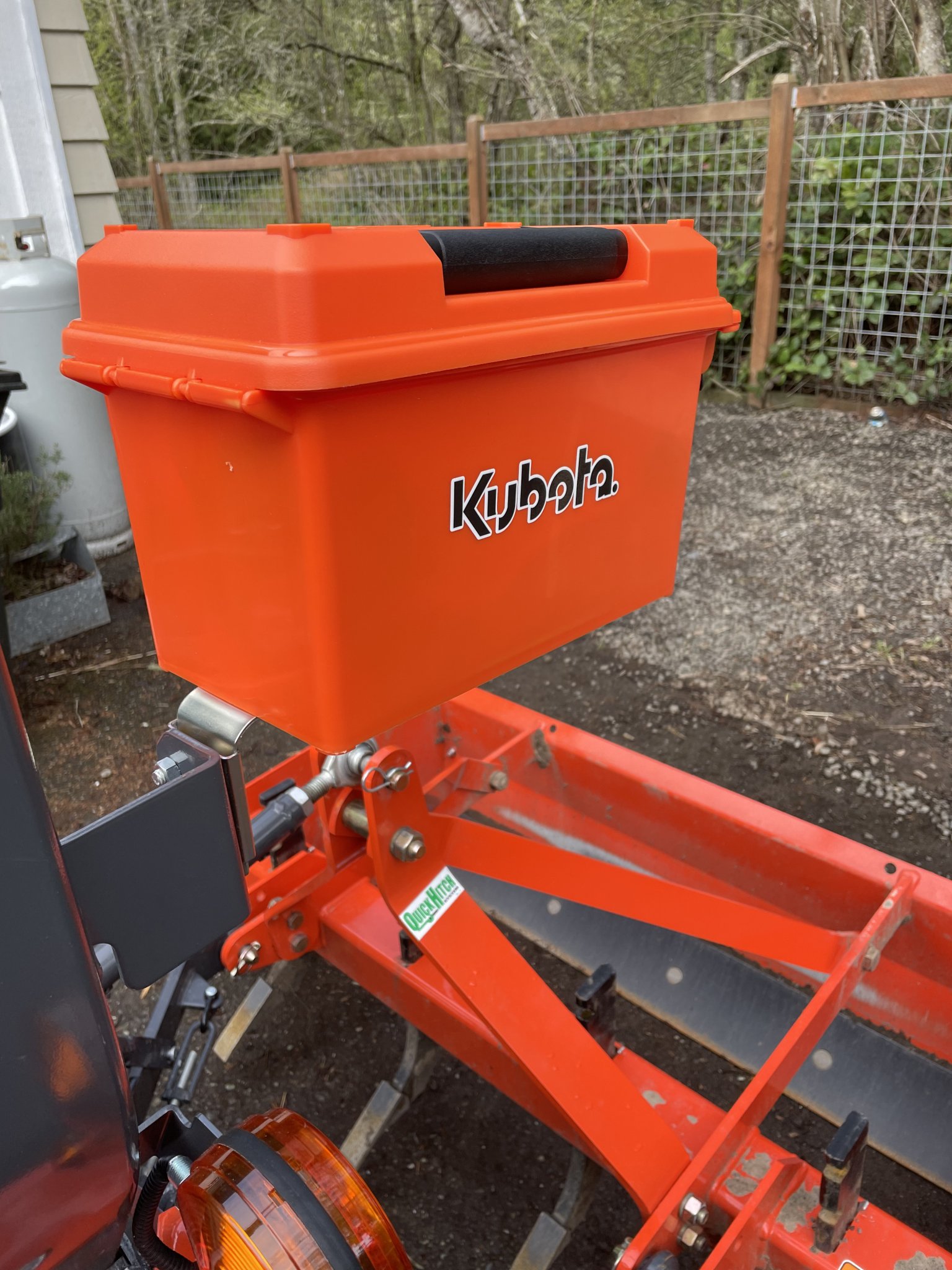

Mounted a little toolbox to the BX using the SMV hardware. Turned out pretty good. Time will tell. Nice to have a place for some channel locks, gloves, rags, grease, etc.
I used a similar (50 Cal) box on mine, but removed the SMV hardware, bolted the box sideways to its bracket, and remounted the SMV hardware to the outside of the box. Mine's gray to match the ROPS.
DirtbagSurfer
BX1880, LA344, BB1248, F-350, Red Heeler.
Feb 14, 2024
9
42
Pacific Northwest
If my SMV bracket ends up bending, I may have to change plans and do it your way. Your set-up can probably handle more ice and cold beverages. ;)
