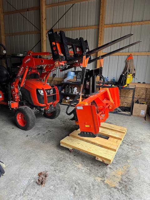

Got creative this weekend to get the blower off the old pallet from the service dept that was then on top of my rolling dolly. Wife spotted for me and was a coconspirator with strapping the unit to the forks........
Was able to place it back exactly where we needed it on the rolling dolly to mount. Forecast doesn't include any real impact snow for the next couple weeks so I am holding off on mounting the blower.
Whole thing went amazingly smoothly........working smarter not harder......

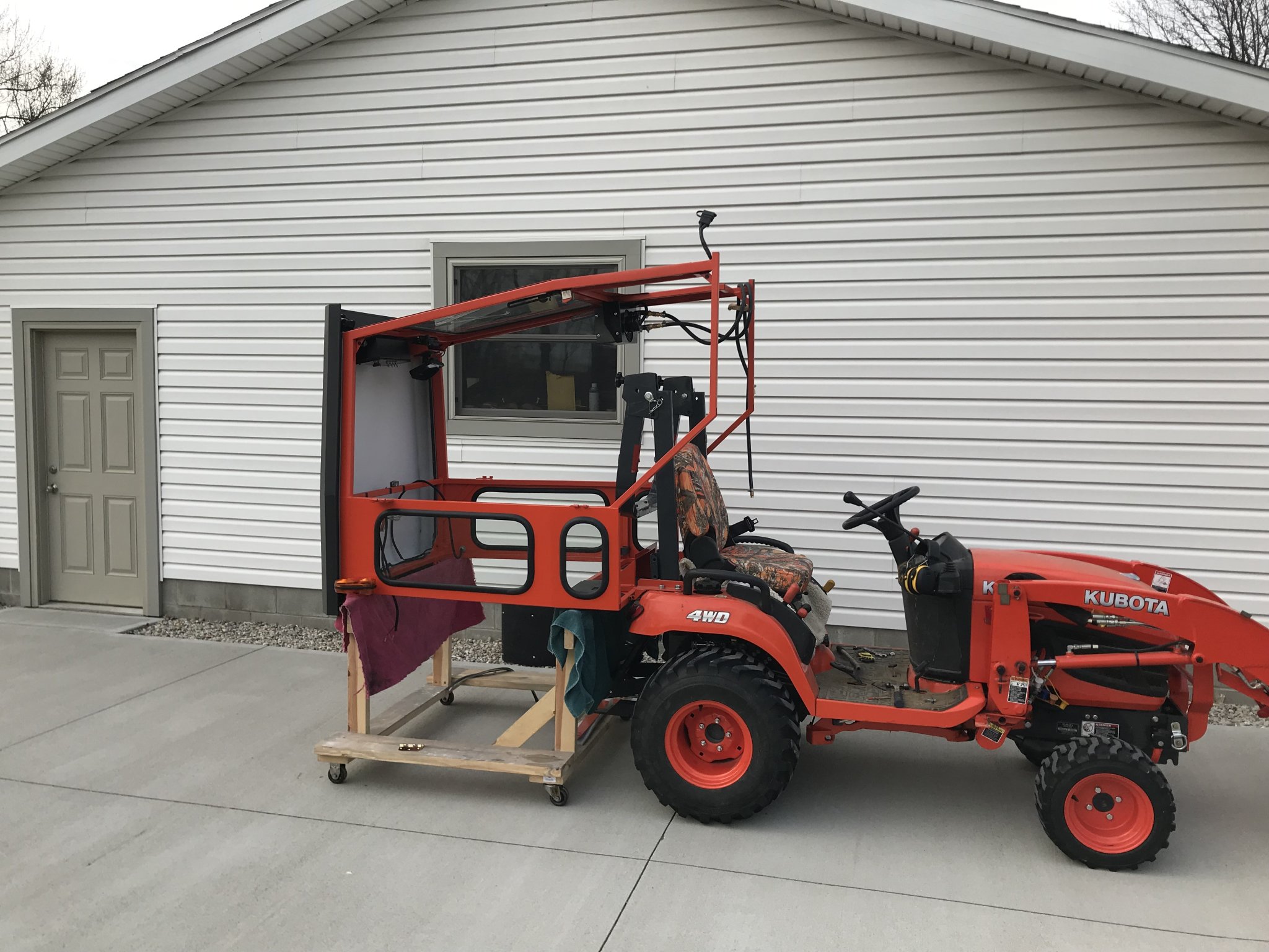

Put the winter cab back on yesterday. Finished hooking up the lights, heater hoses and weather stripping along with the front and rear blades this morning.

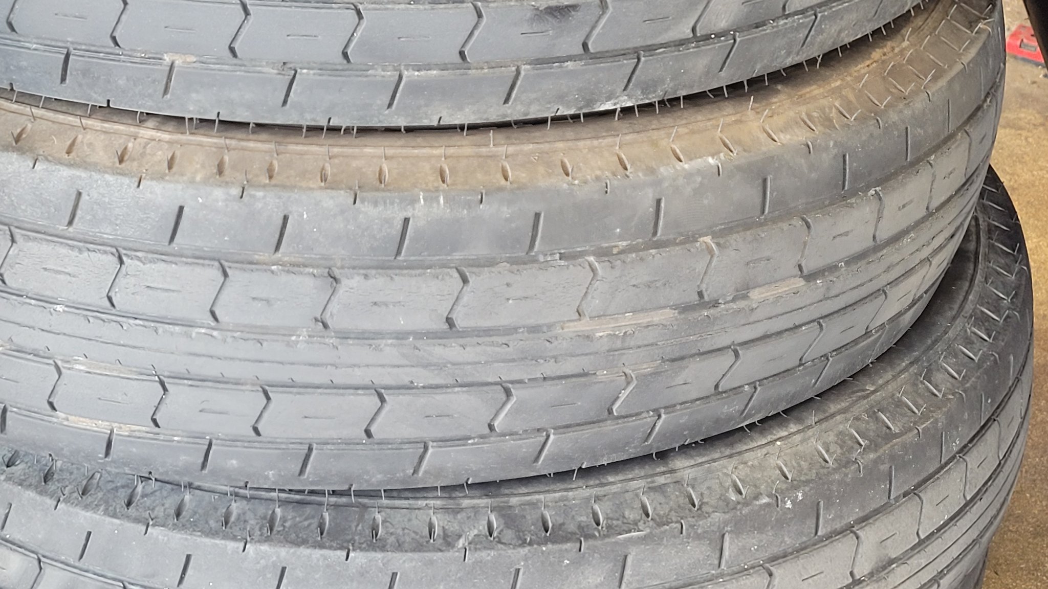

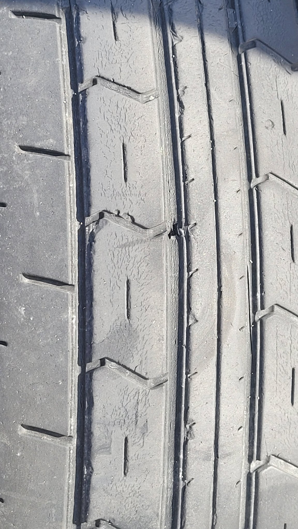

Had the MX loaded on the tilt deck equipment trailer this morning, one tire kinda looked funny, thought they lost pressure from the cooler weather. Nope, they were 10 to 12lbs low, airred up all tires to 80psi and tire still didn't look right, inner belt separation is my best guess. The tires are less than 4 years old with about ~9k miles on them. Unloaded the MX and an hour plus drive to the tire store later. Yup, after valve stem and air was removed the Trail Quest tires are no more, belt separation has begun. Upgraded the tires to some 16 ply tires, Cargomax RT809, ST235/80/16.
Check your tires before every trip!

Is it just the quality of rubber being used these days? In days gone by you could wear a tire down to the nubbins then put in on a trailer or a wagon for off road use and it would last for years.

Like everything else these day, nothing is made to last! Miss the good ol days.
