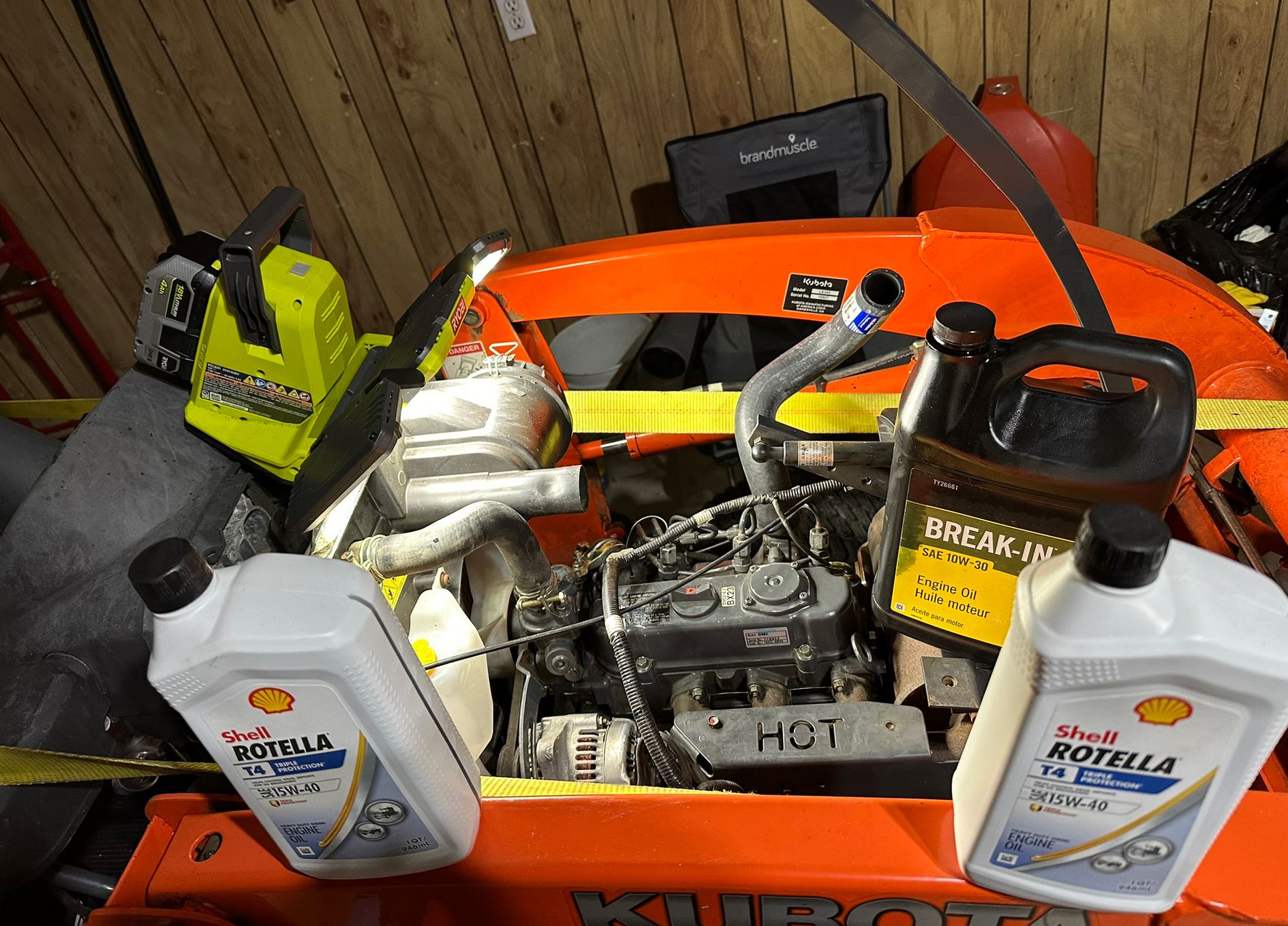

The engine is buttoned up last night and with fluids. In the final run I was cobbling a few things together, used a vacuum plug on the radiator drain, and an AC delco hose will be my intake for a short while. It will breathe fresh air until I cobble together a real hose to the filter, or order the OEM parts.
Now i'm being held back by the several safety switches. I hear the fuel pump clicking, fuel solenoid seems to be working. Checking all sorts of things, operators manual and hitting the forums.
I would try to bypass whatever you can to determine that the engine starts and runs well. After that, you can reconnect one safety switch at a time. This way you can easily identify if there is an issue with one of them. I would also put in some fresh diesel if it's been sitting for a while and take a look at the fuel filter(s) as well.

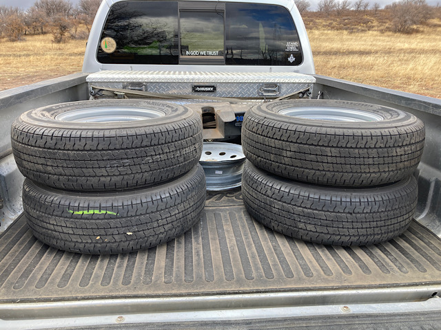

Not totally tractor related, had Winnebago Minnie 26BHSS travel trailer. 9500lb GVW. Bought it new. Had stylish 16” aluminum wheels and of course new tires. Stupidly think “It’s a decent name brand, no need to check tire or wheel ratings. They wouldn’t spec crap tires on a $35K camper with a name like Winnebago. Trust the engineers.”
First trip out was about 50 miles total as it was the shakedown run. All good. Second run was 250 miles out, 250 back. Check tire pressure pre-trip every time. About halfway back, less than 500 miles total, on a cool, rainy day the right rear explodes. Totally shreds to nothing. Pull off and see the tread is missing, sidewall is just a spaghetti of wires and rim bead killed by hitting the road. Change tire, pray we make it home (we did).
Start looking at tires and researching rims. Rims are rated for 1750lb each. Tires made by some no name Chinese manufacturer rated for 2000lb each. On a 9500lb GVW trailer that weighed almost 8000lb dry weight, well over 8000lb as outfitted and loaded when in use. Bad tires? Bad rim? Bad engineer? Maybe some combo? Regardless: bad.
Replaced all five (including spare) wheels and tires with black steel wheels rated for 3500lb each, shod with Kenda Loadstars rated to carry the full weight of the trailer. Have used Kenda Loadstars on campers, equipment trailers, and cargo trailers for many years. I’m sure they’d blow if I ran over a box of nails or something but thousands and thousands of miles without one failure.

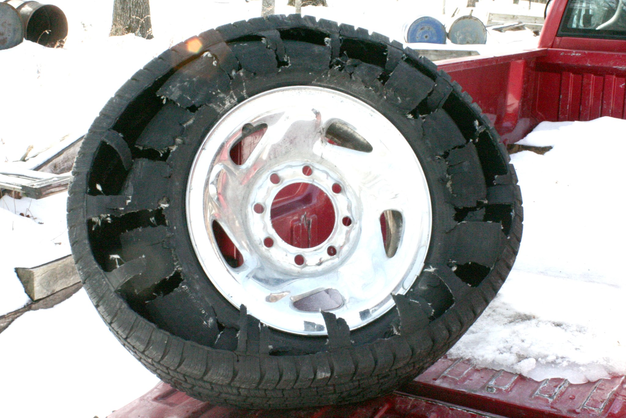

That looks a lot like a tire that was on my Dodge Ram back in 2009. It was snowing and snow on the roads when I notice something wasn't right. This was on a 2 lane county road with now shoulders. I stopped and got my flashlight out and took a look. It was the passenger back tire. It was ripped to shreds. I got the spare down first and then took the flat off. The tire was pulled behind the brake drum backing plate and I had a hard time getting it off. I didn’t want to pull on it to hard so I didn’t pull it off the jack. When it came off it hit my left knee and I wound up with a nice bump. Someone in a truck stopped and came over and asked if I needed some help. I ask if he could help me put the flat in the bed of the truck. He asked me if I had good clothes on, I told him yes, he said that he had work clothes on and he would put it in the bed for me.

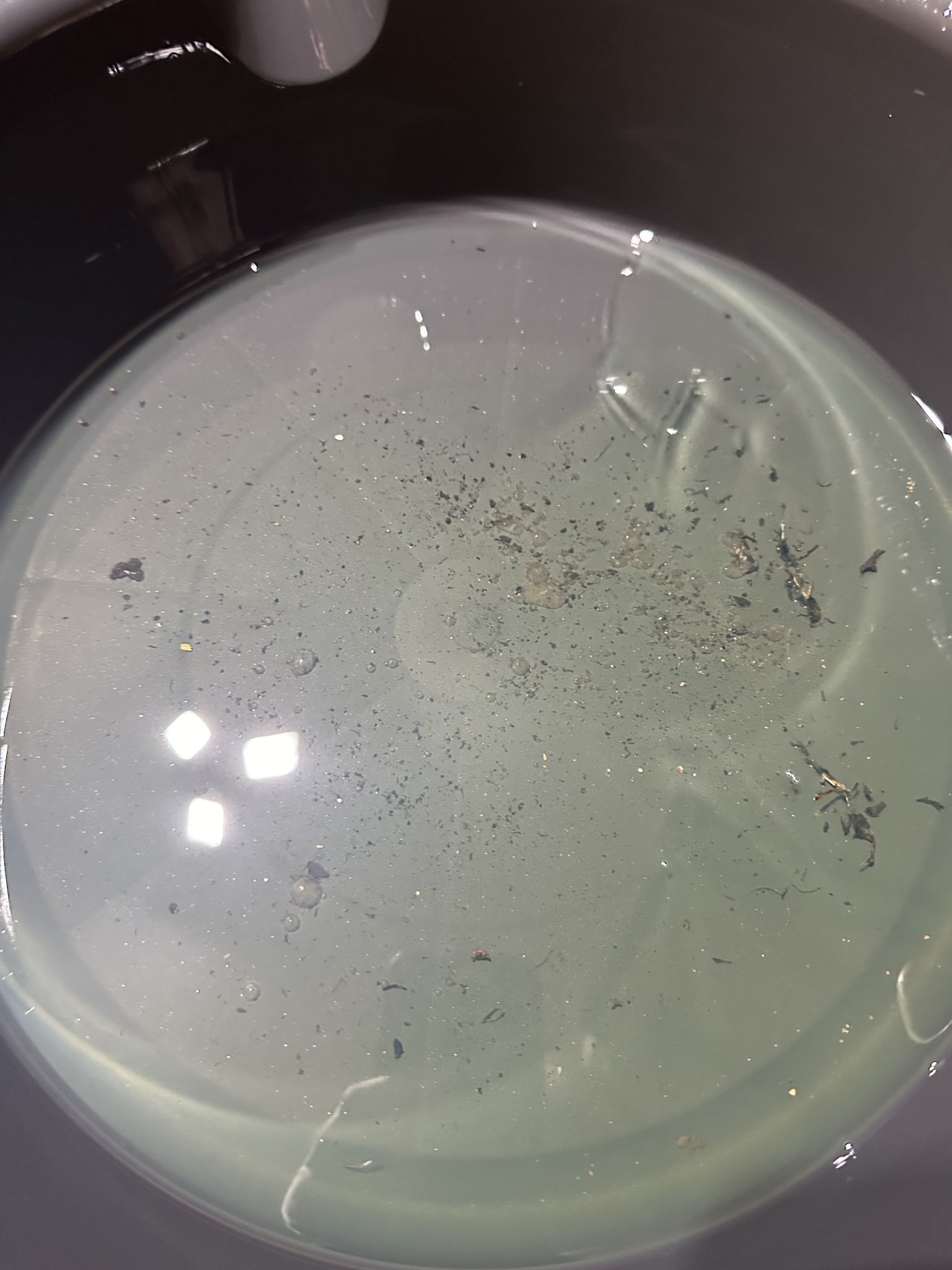

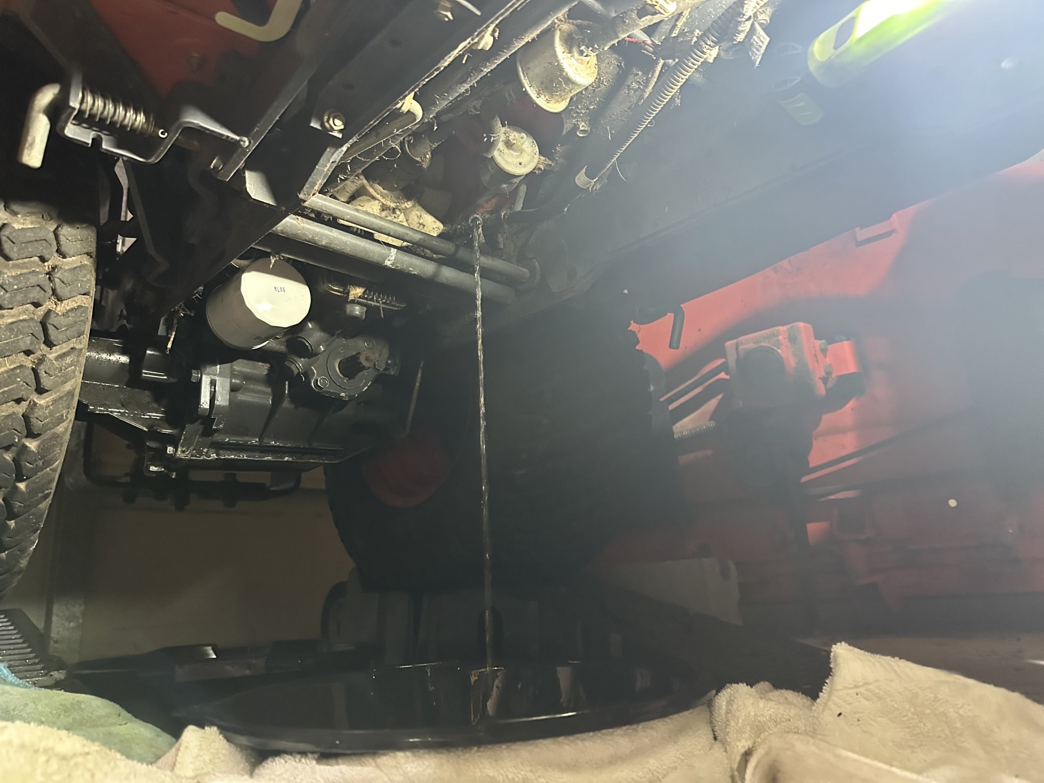

More progress today, confirmed one of the safety switches is bad, now just a matter of which one. Engine turns over and sounds like it has good compression, used a remote starter switch. My initial guess as to what is really wrong was confirmed as well when I removed the fuel line after the first filter and diesel barely dribbled out. The seller complained it was bogging badly.
I drained about 2.5 gallons after disconnecting the other side of the filter. It was fascinating to see the water contamination bubbles. I am putting a new filter and pump on tomorrow. Getting excited!
Is that metal shavings I see in the top photo? No bueno, amigo. You're gonna wanna know where that came from.
I saw that as well, but I assumed that the metal shavings were in the pan before he drained the fuel into it. The pump could have grenaded as well though, resulting in a bunch of plastic and metal debris in the fuel system. If that's the case, hopefully the filters prevented any of it from getting to the engine.
Barely anything came out after the first filter, all that came directly out of the tank thankfully. Brand new drain pan. I am replacing the pump anyway out of mistrust.
