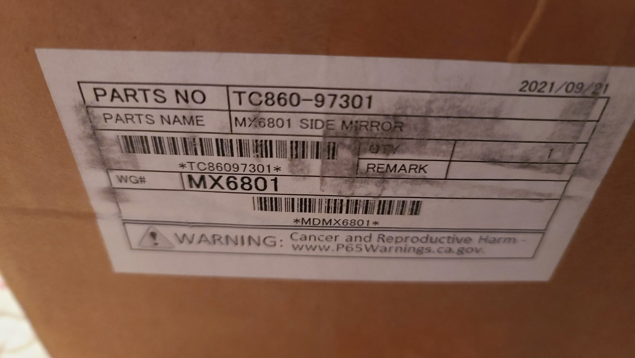

Got my kit yesterday. Installed today. This had everything in it.

Thanks, I forwarded this off to the dealer. Looks like it if for an MX, but was able to track it down and the parts list looks the same between both models.
The difference is the holder for the mirrors are welded on our cabs. Looks like MX bolts on. The round housing. I have 2 in the box. When I bought my tractor off the lot I said I never thought of Mirrors as a deluxe thing. The sales guy told me after looking in his book would be 140.00 per side. I said you'll throw that in right ?
So Friday he called and said they came in. I drove 40 miles each way to realize I had 2 kits. So I took 1 back Saturday after installing the other. This is my first Kubota and my dealer sells a lot of stuff to businesses. I was attempting to be honest, but he was frustrated by the situation.

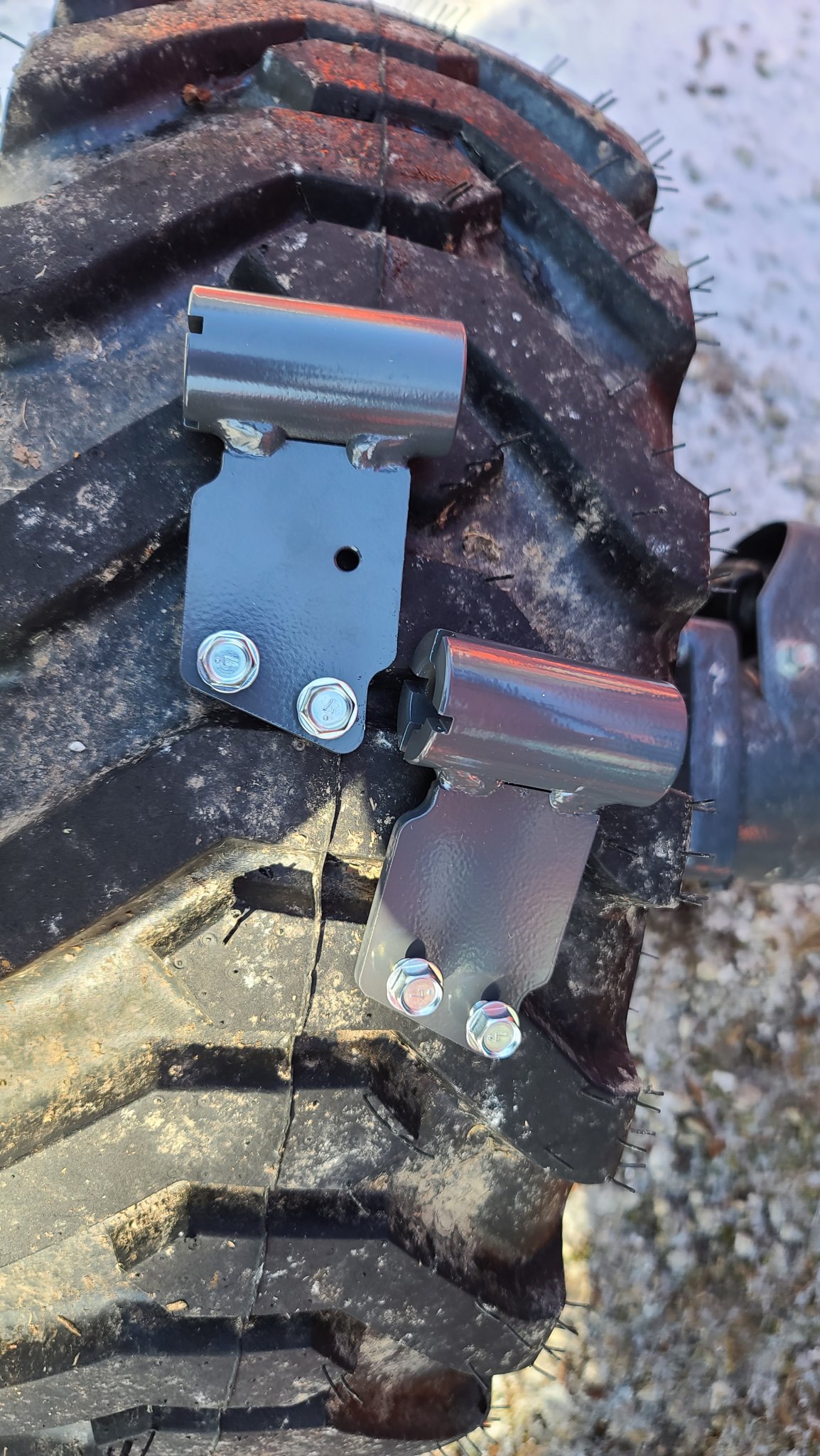

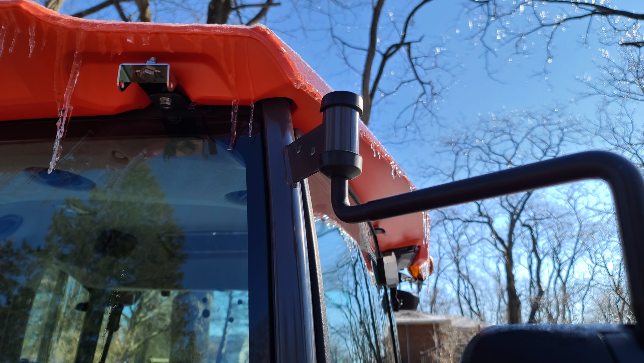

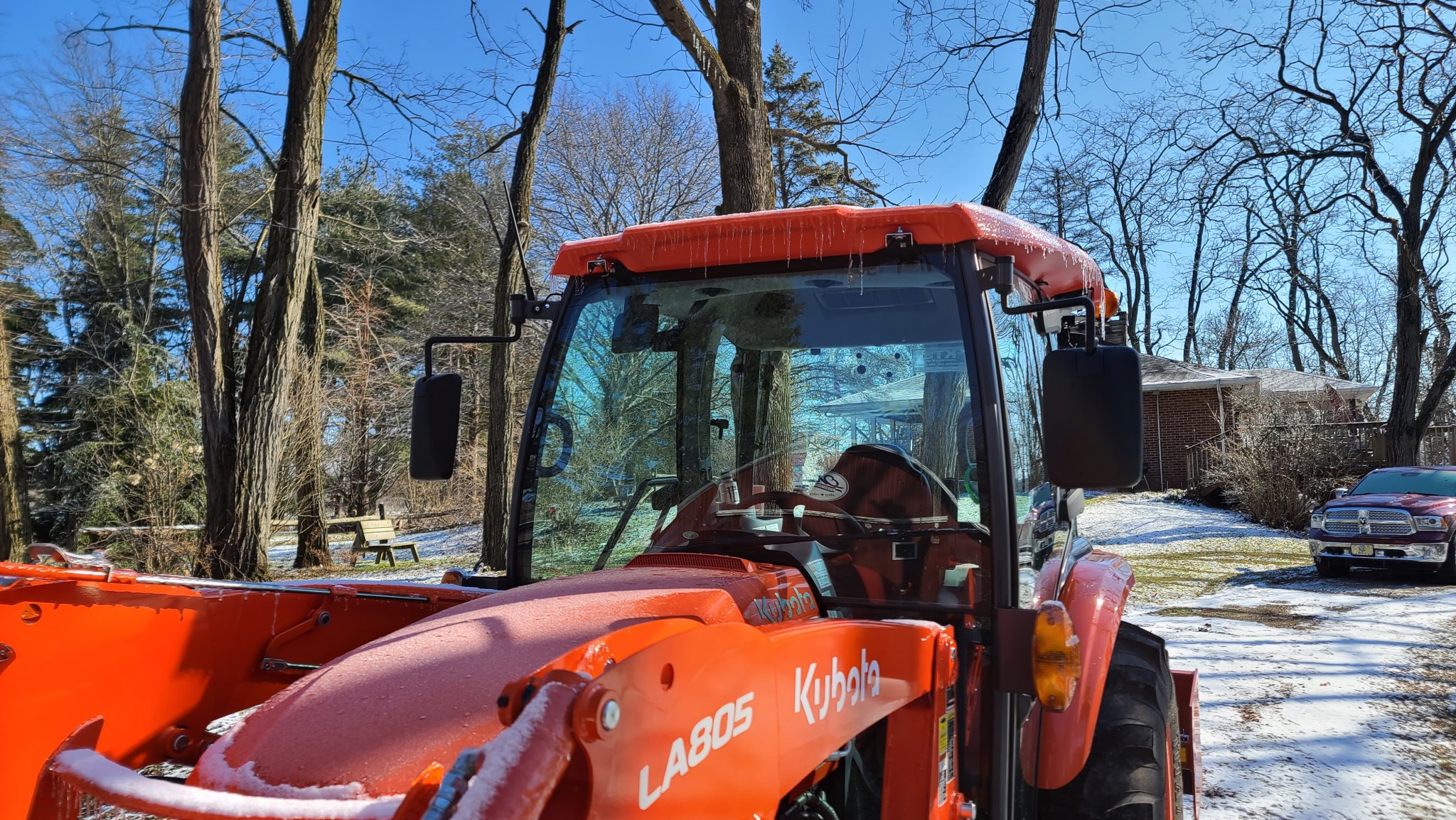

Here is installed Mirror, 2nd pic is the bolt on type for the MX in that kit. If you looked up separate parts the cost is way more expensive piecing to get for the same parts. I just put these in my drawer of stuff I may need someday. I also attached pdf of instructions. Image 5 is our cab.
The bearing on the bottom is a very tight fit. I tapped in partway then put the stem in and tapped as a unit till the roll pin sat in a notch. Tightened the rest down from the top to 25 ft pounds. Mirrors nice and tight and pop when folded to the next groove.
We had those sweet Ice storms last few nights. Have front leds still wiring for the Kubota plug.

Good info. I will find out on Monday how long it will take for them to get the kit. So that top number is the Kit number and includes 2 mirrors and brackets? When I look it up I find TC860-97310 and TC860-97320 So I wonder if the TC860-97301 is for both mirrors.

Not sure but that kit number I gave you had both sides. I don't know where dealer got the number. I never saw online while I was waiting.

Yes ....sorry on phone outside. That 97301 is for both. Like I said the dealer absorber the cost, but he ordered 2 think 1 per side. I had 2 full sets then. Im not dishonest so I took tje 1 back. Now I think he did chargé me with how he acted strange. My receipt is the out the door price after tax for the tractor.
