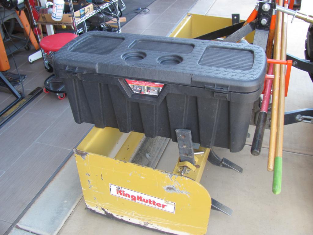

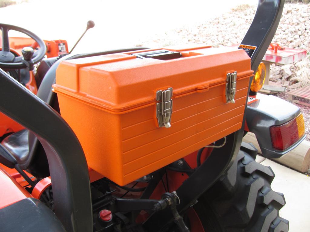

Long overdue upgrades:
Needed a new tool box that actually holds some stuff and is waterproof. Hadda enlarge the mounting location with some sheet stock. Much more useful.

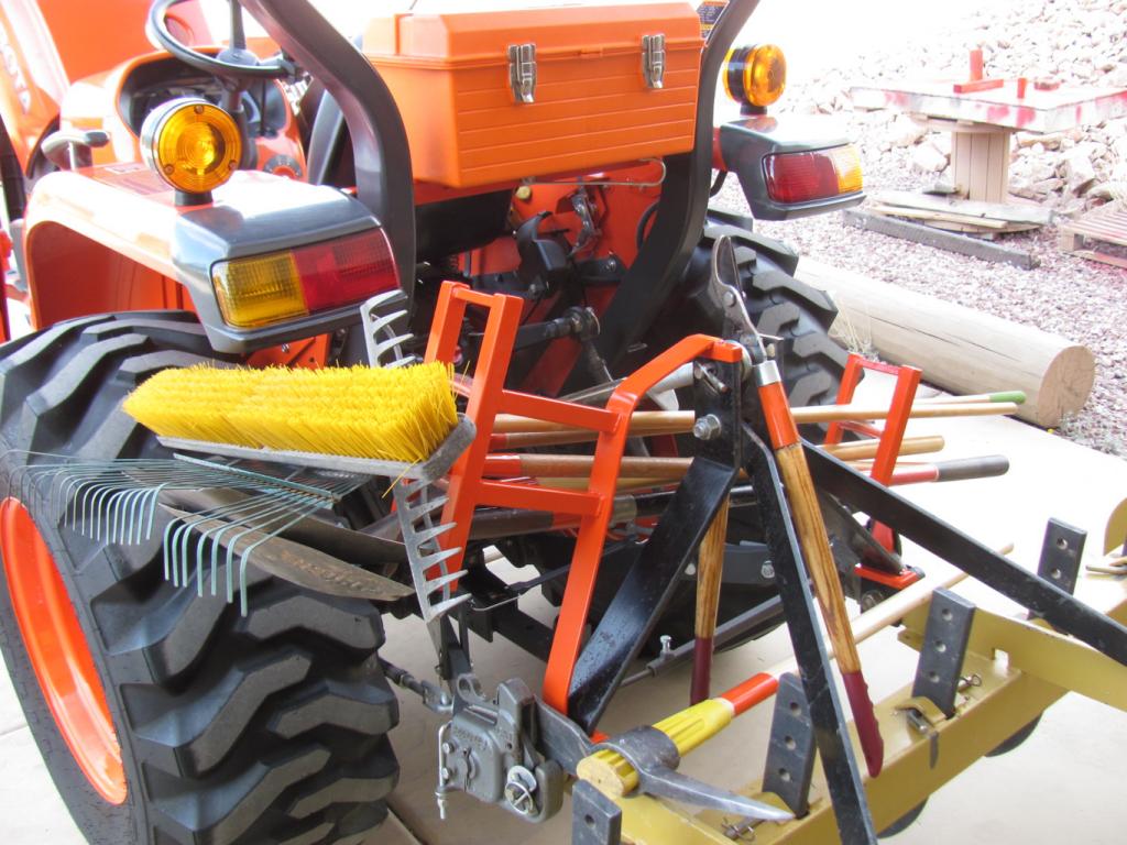

Tired of carrying my tools slotted through the support arms of my box scraper. So I made a tool rack...
Holds a kaboodle of tools...
Now, I have to make a small frame up for when I want to haul my equipment box -for chainsaws or blowers...
90% of the above made up with scraps from the recycle bin.

Ray, where did you get the tool box (orange one)? May be a little big for me to mount on my relocation bracket, but I need to get something bigger.

Yooper,
The work box will serve as a sink if I can seal up the holes the prior owner drilled in it. I hate having to run for a tool. Now I am loaded for bear.

FT,
Like the workbox, I got the tool box at the Kiwani thrift store used -for $3. It's a nice box that had a hard life. I worked on it for an hour or more to get the insides clean. I just couldn't pass up the color. I bought an old metal tool box a couple years ago from the 50's at the same store thinking I'd paint it to match the tractor but this one popped up.
The mounting bar on my L3800 is only 1" angle iron between the side mounting plates. Plenty strong but not so strong in torsion. With a bigger box, the mount will flex a little but I don't think it will be an issue. I have 2" washers inside the floor of the box to spread out stress. For a tool box, it's pretty lightly loaded.

Thanks Ray. My tractor is the little brother to yours. When I added the back hoe, that bar where the tool box is has to be removed. There was a bracket included to relocate the tool box that mounts to the ROPS.

FT,
Yeah, that bracket might get in the way using a backhoe...
