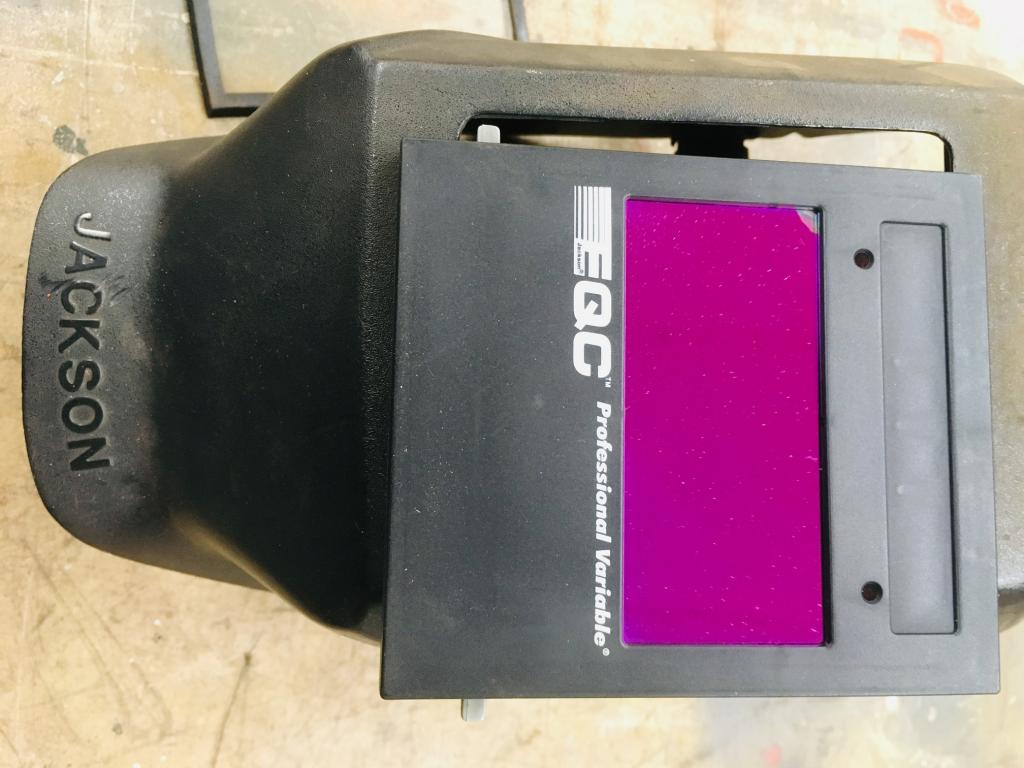

My second helmet, the Jackson, also an auto darkening helmet but without the solar cells. But notice it does have the two photo diodes for sensing and again, they're what does the highspeed switching to save your eyes. (Not the solar cells)

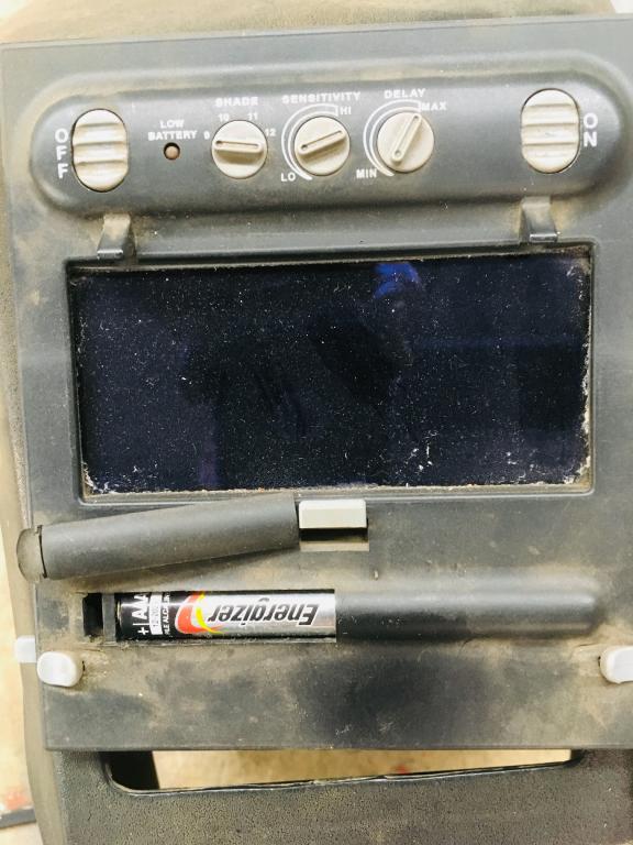

Here's the control panel: Notice the batteries in this one. Two AAA batteries for power. Why? With no photovoltaic (solar) cells to aid the battery's voltage, much larger batteries are needed to keep power to the auto darkening sensor circuit. If this type of helmet only had button cells your actual welding time would be drastically less. Again, with this helmet, the power on button is also the test button and should be the first thing on one's mind when you pick it up. Especially if it hasn't been used for a while.
