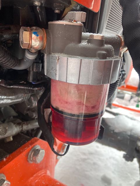

The great freeze was beyond the gel point of my diesel(apparently). Tractor(L3902) has been a bit grumpy. Ive got a dose of antigel in the tank and pulled the fuel filter. The water separator looks like a cottage cheese slushy, Id like to pull and clean it. None of my oil filter strap wrenches are working to get it loose, and it's bigger than all my slip joint pliers will accommodate.
I'm looking for recommendation on a specific wrench(style) to engage the retaining ring.

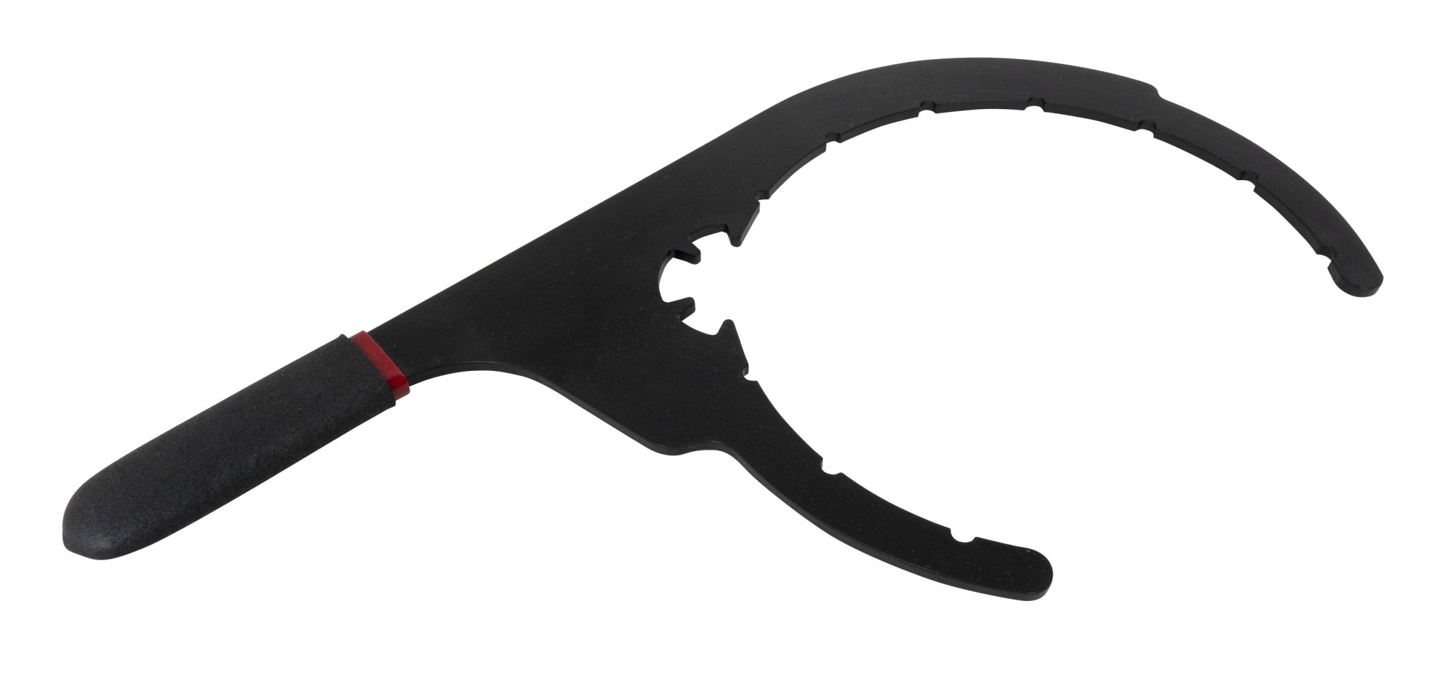

Something like this or I also see adjustable versions?

I have had great success with this type of "wrench"
this has "sand particles" for grip and works well - you will need to make sure overall diameter will grip.
My big set of Channel Loks open to 4"
Not big enough?

I wonder if there's just enough swelling of the bowl that it's preventing you from turning it. Can you get some heat blowing on it to thaw it out?
There's abit too much stuff going on around the area to fit that type on. I have another style where I can disengage the 'strap' and even that doesn't quite work.
I didn't measure mine, but they gotta be close to 4" and can't get a good purchase.
I was kinda wondering that too.

If it's not coming loose with a strap wrench, I'd be cautious of using anything else with more force. That could break something.
Get a heat gun or hair dryer and give it some heat to liquefy the fuel again.

I'll second The Evil Twin, warm it up before you even try and remove it.

I dont have a true strap wrench. The oil filter wrench doesnt quite fit. Im going to try the suggestion of a piece of belt in the morning and see how it goes. If that doesnt work, I’ll consider warming it up.
I'll third the idea of gently warming up that region. There are a bunch of plastic parts in that region that judging from the frost all over it are really cold. Plastic is brittle, and force may cause more troubles. It normally doesn't take much force to get the water separator off.
There has been at least three folks suggest heating BEFORE attempting removal. I take it you like to gamble!!
