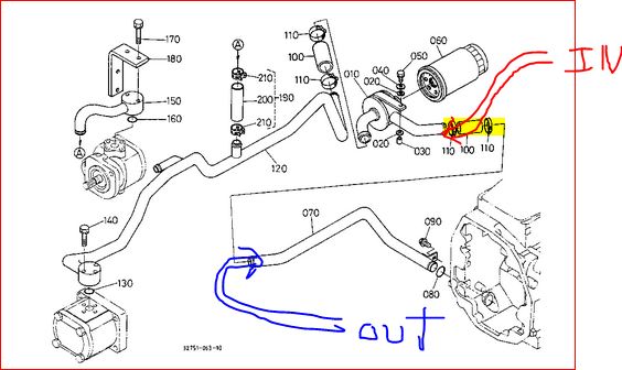

Next on your model (doesn't work on all models), if you want to flush it out, you can break the suction line, (there is one that feeds both pumps, and yes the pump behind the injection pump does the Steering, GST, and three point hydraulics) drop one suction side into new fluid bucket and out to empty bucket, or drain pan, and it will spit out whatever is in there! ;)
Secure the hoses into the bucket as it will move 17.3 gallons per minute!
