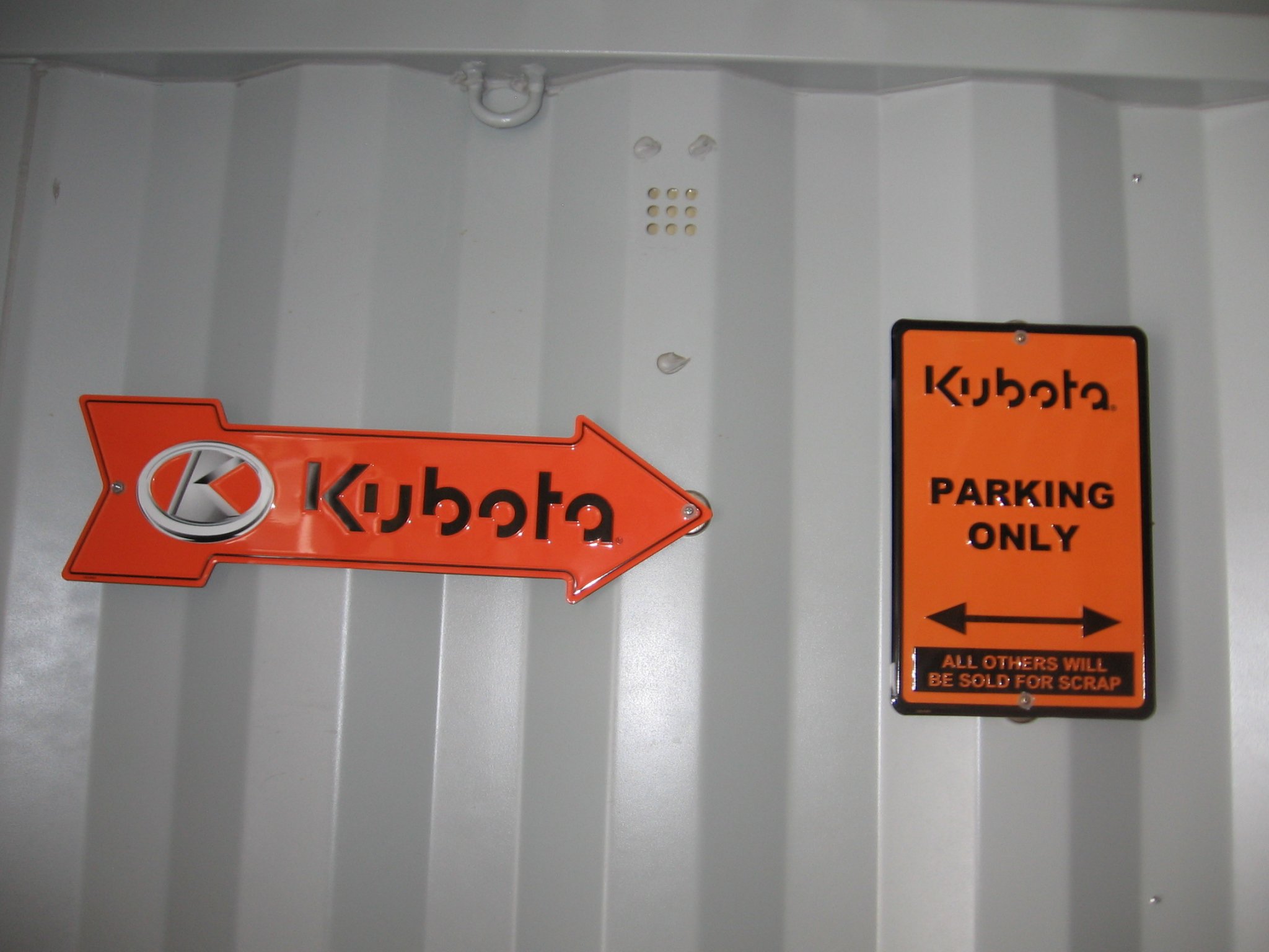

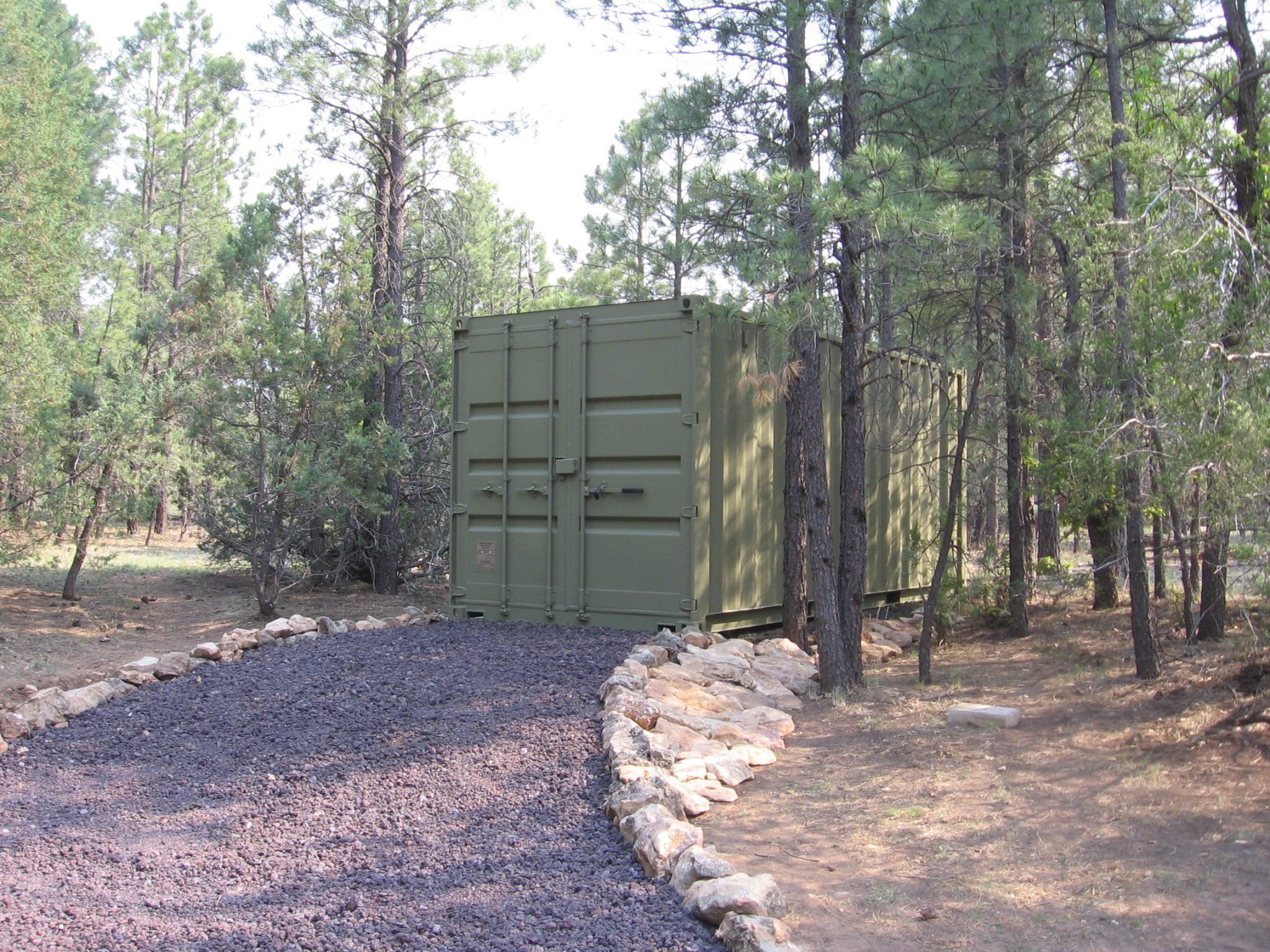

My 20ft container has 8 factory vents, it is in the Arizona high country, and I keep the tractor, fuel cans, oils, spare parts & implements in there with absolutely no problems.

I’ve got one like Bill has and it works well for storing my tractor. But I have it parked on the north side of my shop to shade it during the summer heat. They do get hot when the sun beats down on them. Do you have some trees on your property maybe you could park it under?
