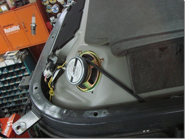

I ended up in the city yesterday and came back with a new set of Infinity Reference two way speakers. Wow these things are top quality compared to the ones I'm taking out that Kubota had in there. The first photo will show you the new speakers on the left and the old one on the right.

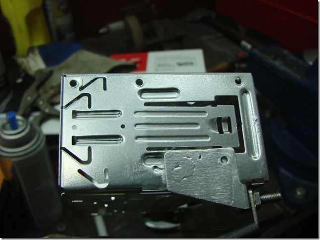

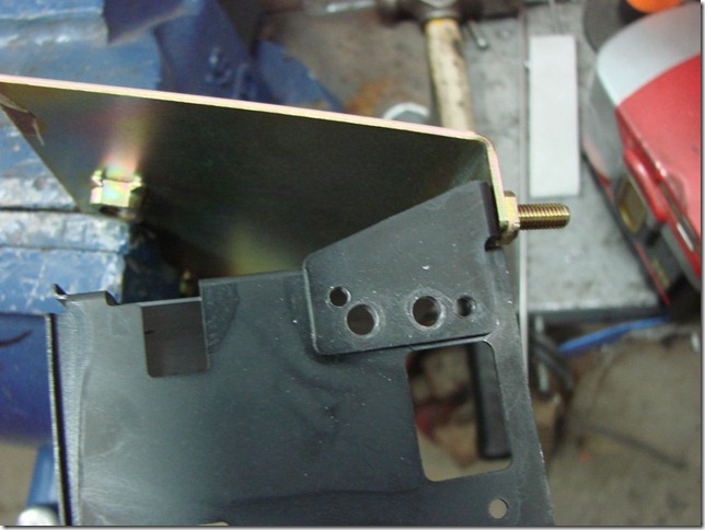

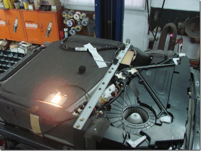

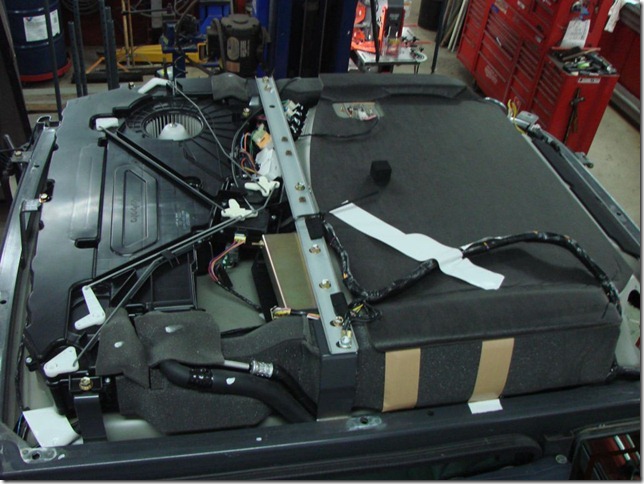

The next thing I had to do was remove the light bar on top of the cab and then remove the roof. All work has to be done underneath the roof. Once I got that off I removed the factory radio bracket and realized I'm going to need to drill out the spot welds for the two small ears on the factory bracket and weld them to the new bracket for my new stereo.

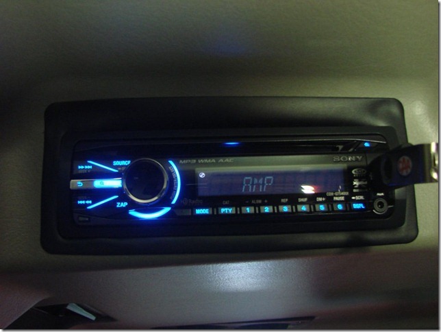

After I did some careful measuring the new Sony CDX-GT5400UI fit right in place. I had to figure out Kubota's wiring and used my DVM and labeled the wires then soldered and heat shirked them to the new harness.
I installed the new speakers and turned on the system and could hardly believe the awesome sound that came from it. Crystal clear and no distortion at any sound level and it's loud. I won't have it up very loud while operating the tractor but it's nice to know I could if I wanted to.
The unit also comes with a remote. I had the extra Ram mount so I put the remote on that. What I like about the remote is If I want to play a few tunes while the tractor is in the shop I can select the tunes from the shop floor. How cool is that.:cool: The Kubota radio with the CD played and weather station was fine. Worked well but I just wanted a few more bells and whistles in the cab. Here's a few photo's of the day.

The model number of the speakers are on the first page. I don't remember their actual size but they are the same as the factory ones that came with the machine. If you use the same type you'll just need to shim them away from the factory speaker grills because they are two way speakers and the center cones will hit the grill so using small washers makes easy work of that. Yes you have to remove the top cap cover to change but that's only a ten minute deal. Easy to do.
